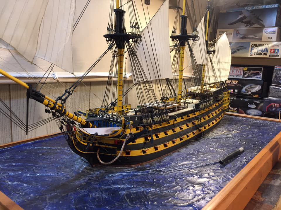

PostPosted: Sun Jun 11, 2023 4:40 pm
Posts: 657
Location: Michigan
done with the foremast and bowspit,, going to set her aside and work on revells small 1/570 scale Titanic for my daughter.. Ive never attempted to light up a model kit before..should be interesting !
