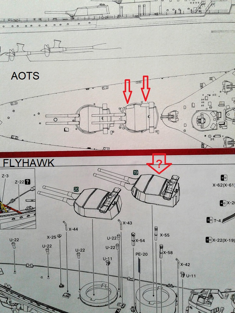

There is a small but glaring omission in the Flyhawk Hood and can't help but wonder how this was missed!
The remnants of the flying off platform on the port edge of X-turret are not included. So....that will need to be rectified.
See pic below comparing the AOTS line drawing to the kit instructions.

PostPosted: Tue Sep 14, 2021 1:24 pm
Joined: Thu Aug 04, 2005 2:50 pm
Posts: 342
PaulC wrote:
Hi all,
Yikes!
Which version of the kit did you obtain (standard or deluxe)? Any chance they included the platforms in the deluxe PE but forgot to put a call out in the instructions? I am unable to check on this end because, strangely enough, I (who should've been among the first to receive the kit) am still waiting on the proverbial slow boat from China, LOL. I run outside every day to see if something has arrived, but so far not a sausage! I'm starting to get worried...
For our part, I can confirm that we definitely sent FH some detailed photos of the "X" turret frames (in fact, I specifically recall going back later on and sending photos showing how the corner/edge and corner supports had changed). I have a vague recollection of possibly recommending these be considered for photoetch as well. Luckily these should be pretty easy for folks to recreate, but it would still have been better for the kit to have come with them to begin with.
Additionally, we also sent various images of the tiny bridge attached to the rear of "X" turret's rangefinder. I don't see that in the image you attached. Did they include that structure?

PostPosted: Tue Sep 14, 2021 8:09 pm
Posts: 342
Follow-up to my previous post (immediately above): Fortunately someone placed photos of the deluxe kit online. I see that the X turret frames and foot bridge are on photoetch fret B.

PostPosted: Wed Sep 15, 2021 8:38 am
Joined: Tue Jul 07, 2020 3:55 pm
Posts: 5
Hi Frank
yes I was just going to mention the X turret platforms. It does seem strange to put them in the PE but leave them out of the basic kit.

PostPosted: Wed Sep 15, 2021 11:39 am
Joined: Sat Jun 14, 2008 9:27 am
Posts: 849
Location: Kingston, Jamaica
It's the standard - I guess you figured that out. I checked the small PE fret that comes with the kit, but there's nothing there that looks compatible. Still Flyhawk is more than capable of doing those parts in plastic! It is not mentioned in the instructions - neither is there anything with regards to the "tiny bridge" on the back of X-turret. :(
The only thing I see to be fitted on the back of X-turret is a PE ladder.
But....I guess I'll try to put something together.
Can you post a picture or diagram of the X-turret "bridge"?
Thanks!
Paul

PostPosted: Wed Sep 15, 2021 1:09 pm
Posts: 342
I know this isn’t much, but hopefully it will help (these are from our review of the Trumpeter 1/200 kit):
