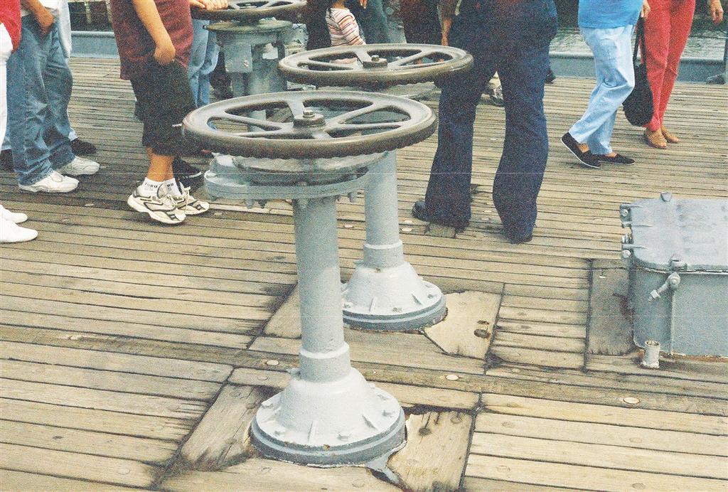

I'm not sure, but I think the main deck is also 4" wide. Here is a photo I took of the foc'sle in 2000 at our 1st reunion aboard ship way before the deck renovation project began, so you can judge for yourself the width of the normal boards -
This decking may have been replaced by now, it wasn't in the best condition at that time. As for your comment re. the LITTLE ROCK's plastic deck replacement, I recall many years ago on NORTH CAROLINA that there were spots where the deck was replaced with tan concrete in place of the rotted teak boards. A very cheap and ugly solution at the time. Her deck has (I believe) since been replaced as photos I've seen of her seem to indicate a nice, clean, teak deck throughout.
PostPosted: Tue Oct 18, 2022 2:05 am
Posts: 1677
Hank,
The planks look about the width of a shoe, so probably 4 inches. It would make sense for purchasing and stocking deck materials to have a navy-wide standard width.
