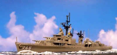

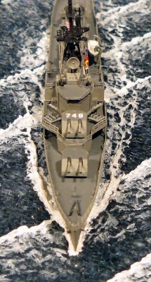

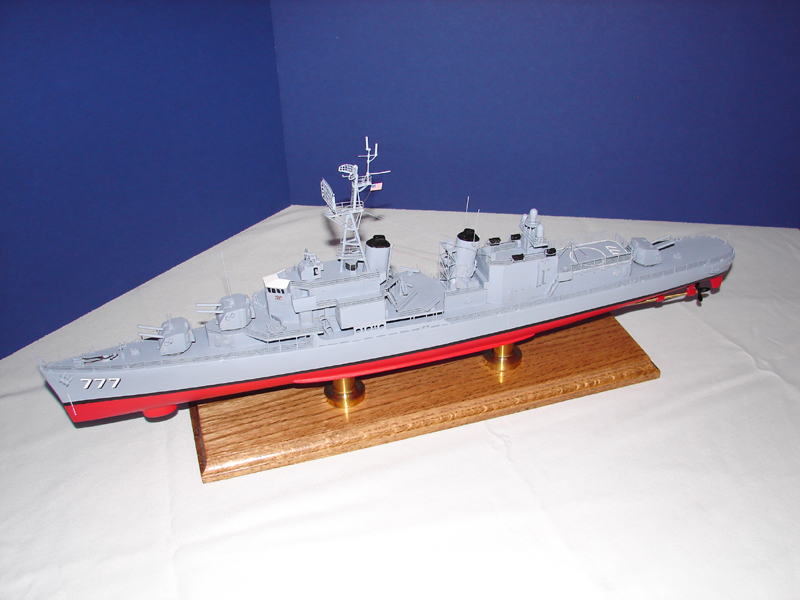

I think I'm done with it!

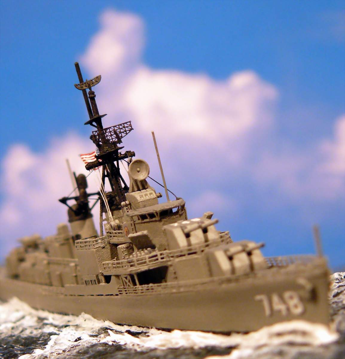

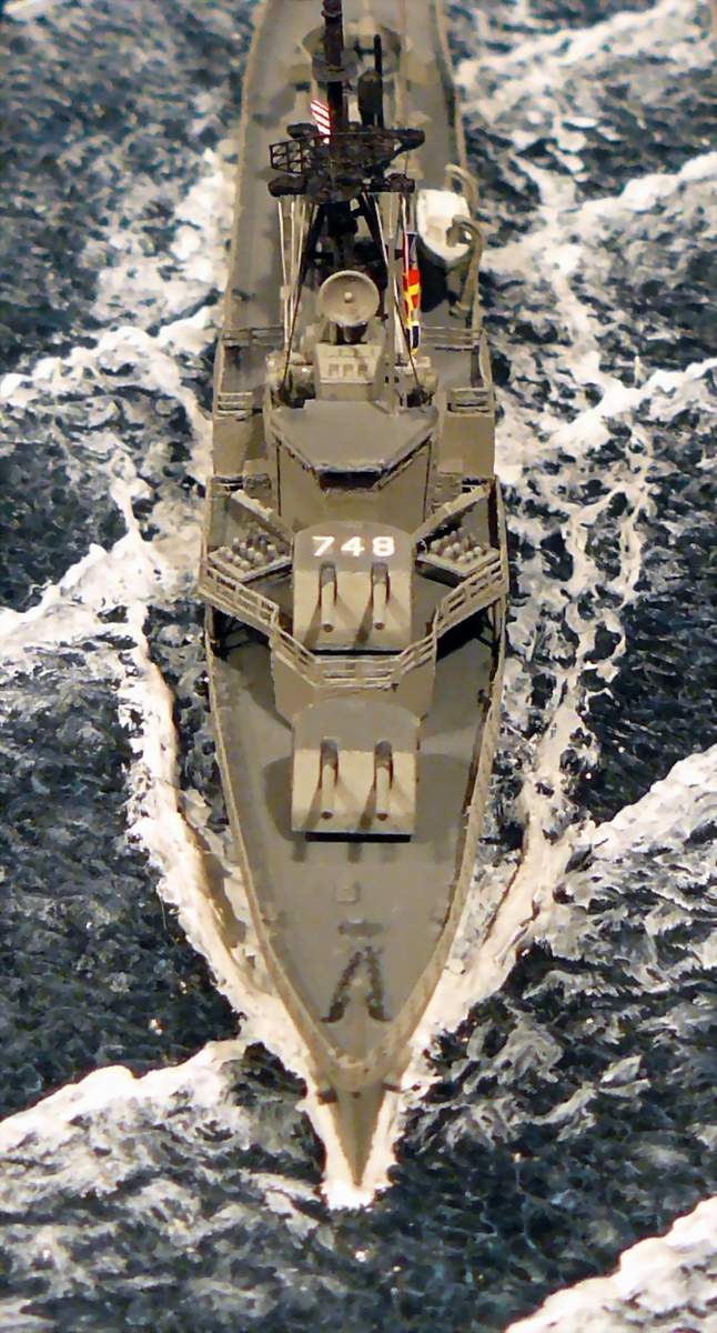

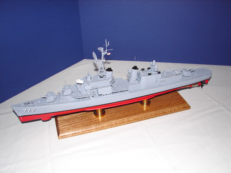

Here's another nice view.....

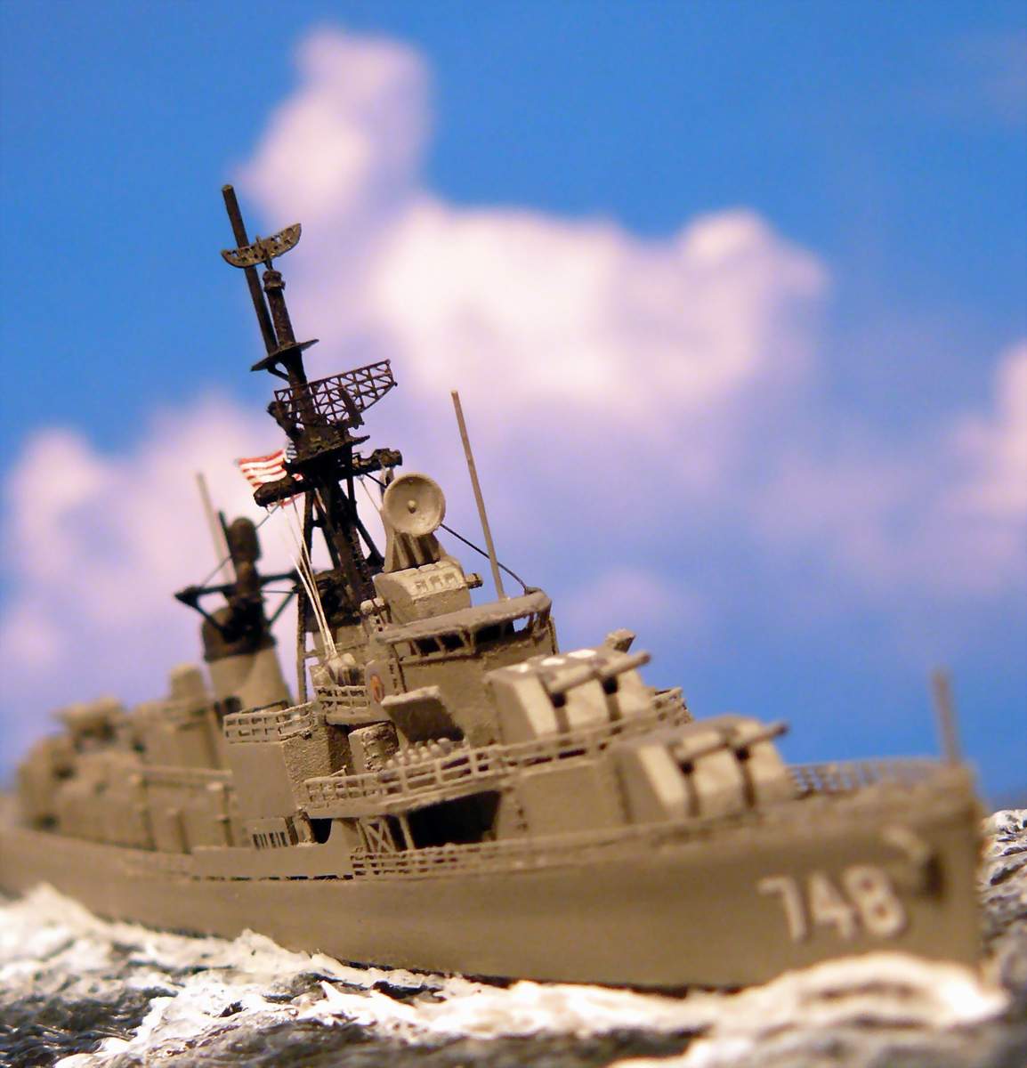

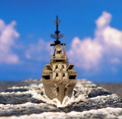

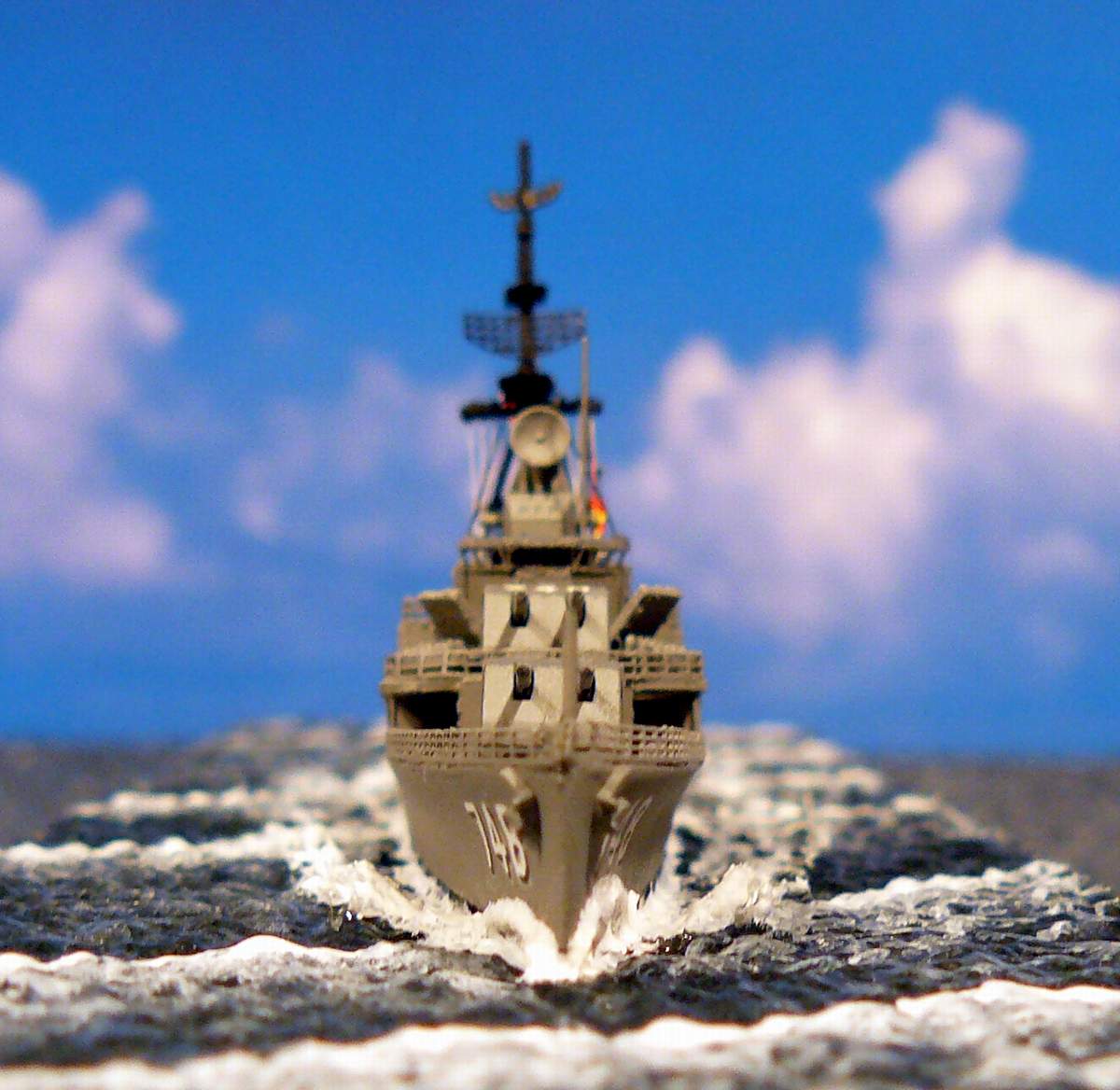

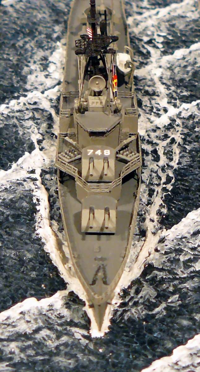

Just one more, for now.
"LEFT FULL RUDDER!"
"LEFT FULL RUDDER!"

NukeMM wrote:How is this effect, Jimmy?
Ah�a, cool!
You put a strong ship in rough seas!!!
Nice you modified the sea. Is it digital or modelled in gel? I can't perceive!
Nice regards: Jimmy
p.s. you right gonna deliver the ship to the veteran???

Jimmy Conway wrote:NukeMM wrote:How is this effect, Jimmy?
Ah�a, cool!![]()
Nice regards: Jimmy
Jimmy, I didn't understand your last question. I am going to double pack the model really well, a box inside a box, and it will be in an IMEX plexiglass case mounted to a wooden base board with a brass name plate.
I used Liquitex heavy gel to fill the gap between the water and the hull, and then experimented with building up some wake waves with the gel, as well. I think that I painted too, many perpendicular waves, however.

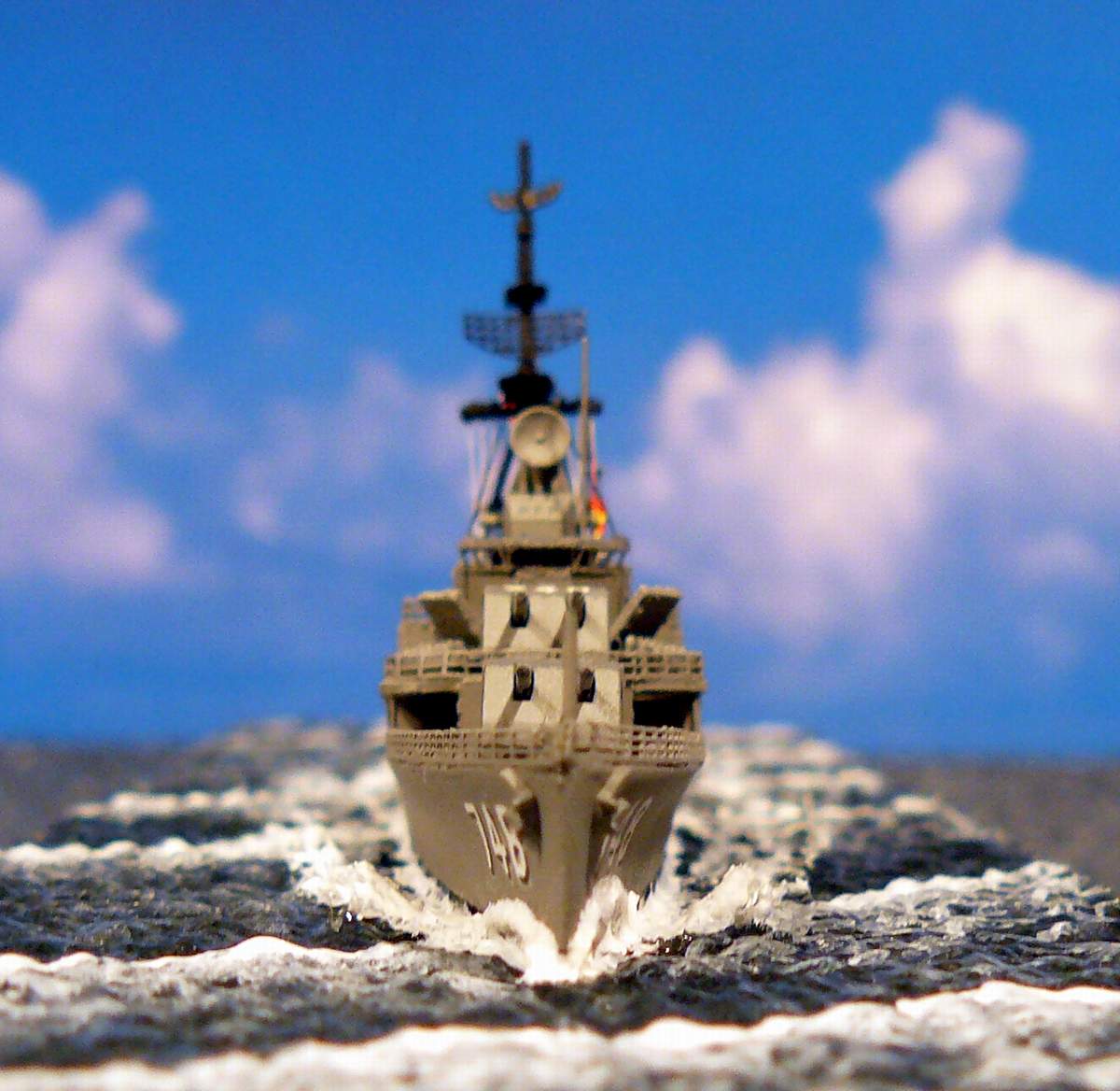

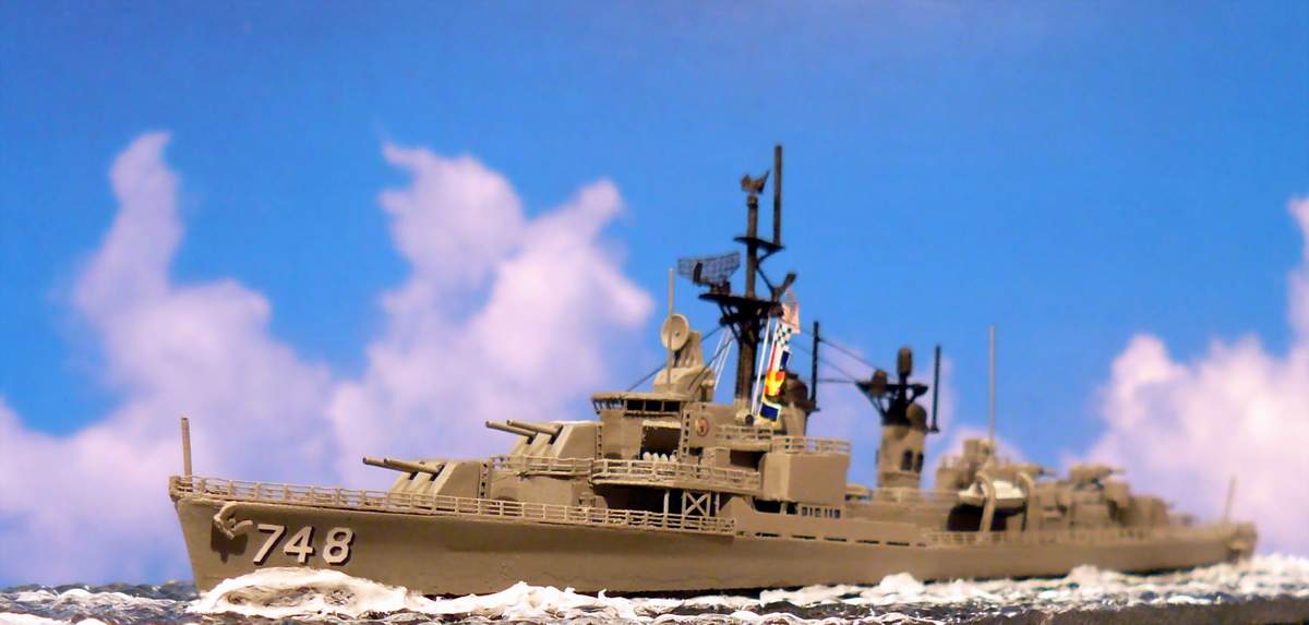

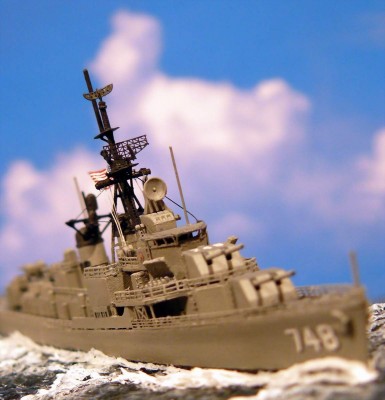

I like how this one turned out.......

Re: Calling all USS Sumner/Gearing class (DD) fans
NukeMM wrote:I like how this one turned out.......
Nuke, this last is the best picture!!!

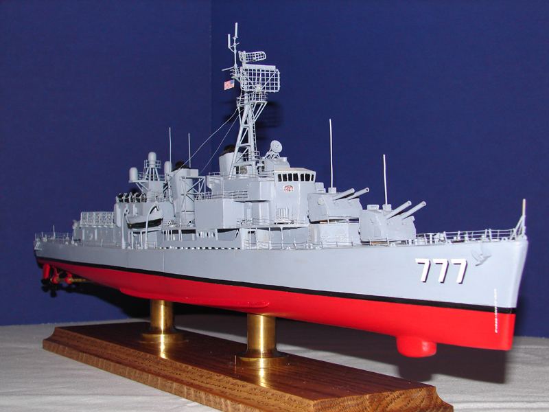

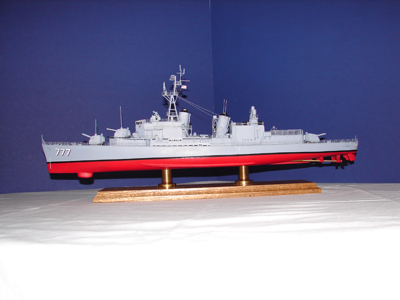

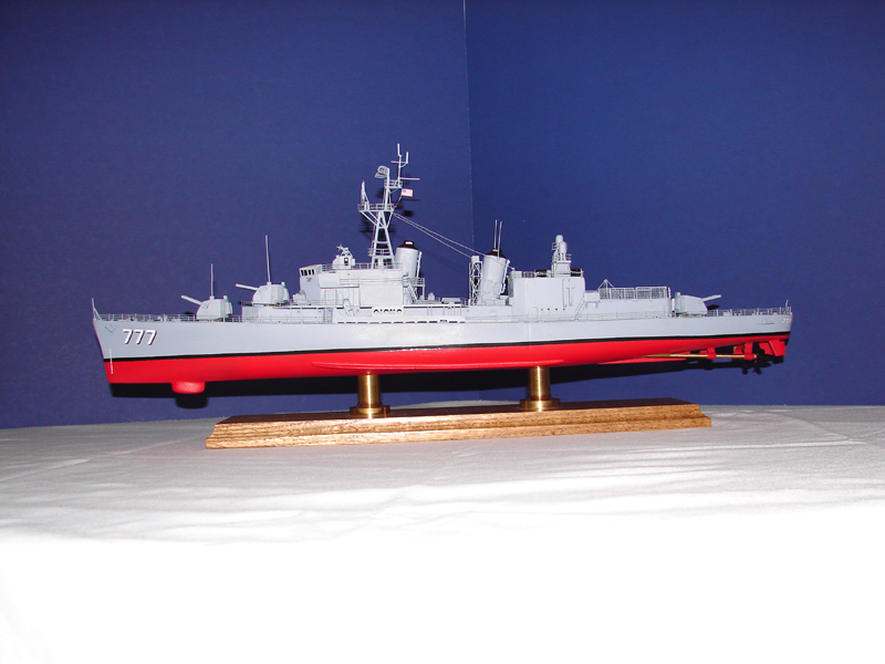

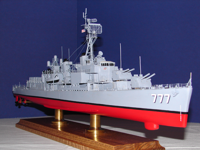

I'm relatively new to this forum but thought I would share. This is my first attempt at scratch building. I made a 1/192 scale USS Zellars DD-777 circa 1960. My brother Ralph (E3) served onboard from 1961-1963. I used the BOGP plans of the Allan Sumner DD-692 and the Laffey 724 as a guide. I completed it in September of 2007.
You can check out more photos and her build at my website http://www.howefamily.com/zellars_progr ... ellars.asp
Navarone:
Nice build on the Zellars in a perfect desktop scale for a DD, 1/192! I went to your site and checked out your step by step build. All the details are nicely rendered and aligned very good. Truely impressive. Did you ever think of buildling one in this scale for RC? Would have to be sealed like a sub, but what a unique project if you could pull it off.
I checked out the Enterprise on your site, too. Very nice work, everything square and well fitting. I hope to build a Baltimore Clipper some day, Likely the Model Expo kit of POB2. There is a nice German kit of Harvey that is tempting.
Mr Wizard
Mr Wizard

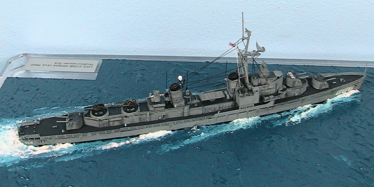

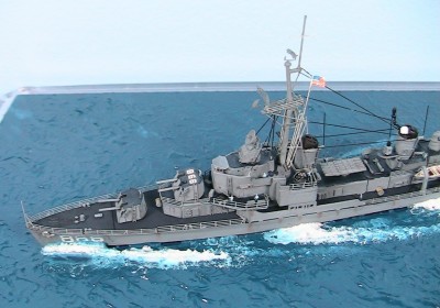

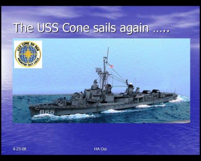

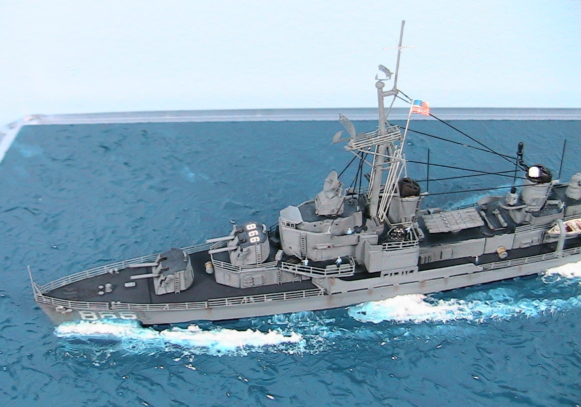

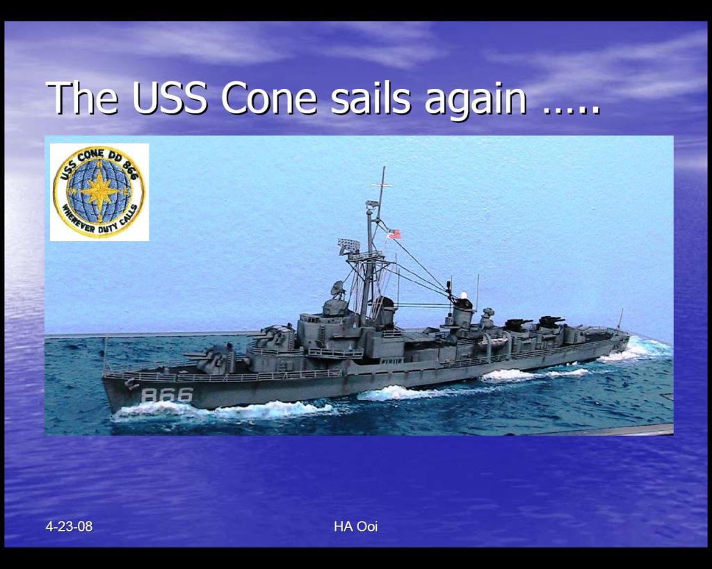

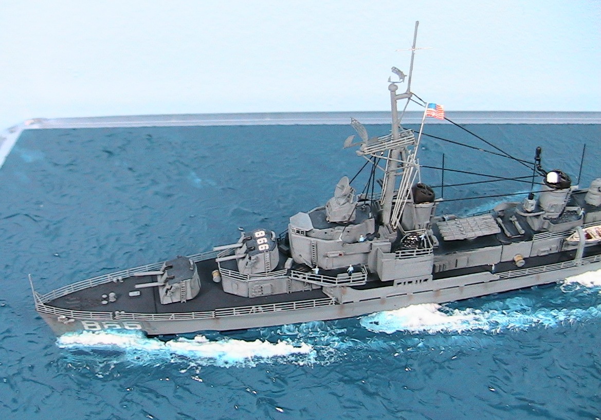

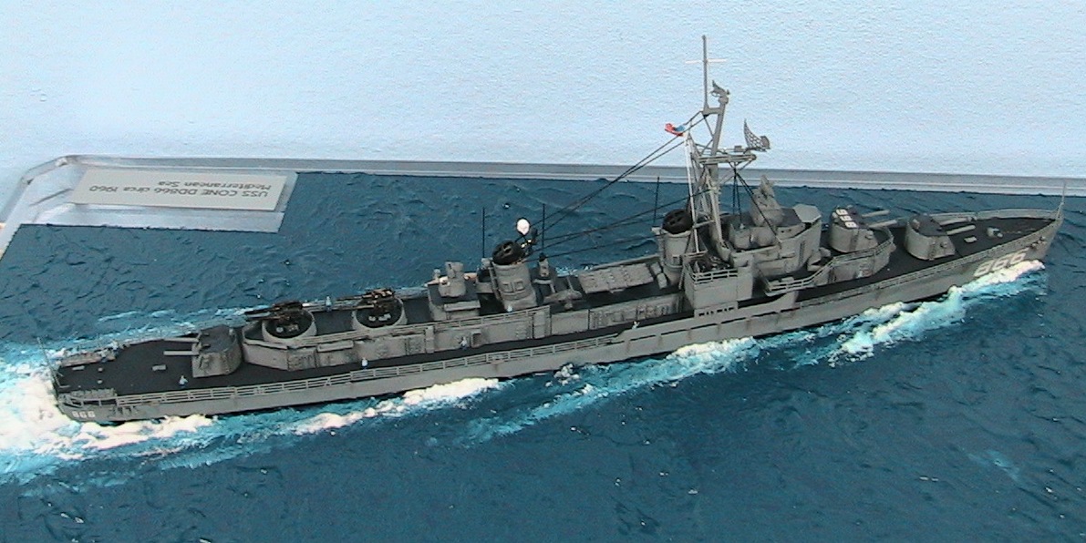

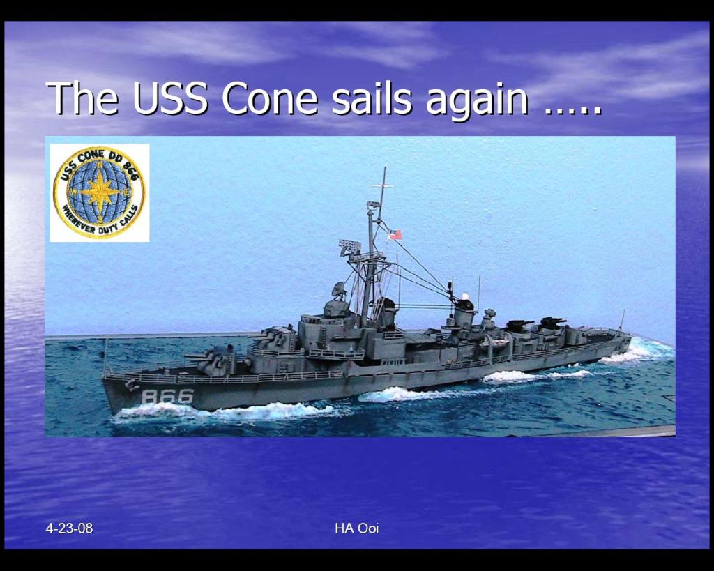

USS Cone (Gearing Class) DD866 in 1960
Hello everyone,
Took some time out from my own list of projects to build this on as a special order for a customer.
USS Cone comes from the "Lost Years" of ship kit-building, the period between 1945 and 1965. Very few kits accurately portray ships from that period because historically the Korean conflict was not known to be naval although the USN did maintain carrier operations and shore bombardment in support of UN troops. Following VJ Day in 1945, the Navy scaled down dramatically and many destroyers ended the war after the Magic Carpet operations to send troops home by being mothballed in home ports along the West Coast. This changed with the Korean conflict and the advent of jets required AA retrofits to keep up with the new speed of the aerial threat. This is reflected in the USS Cone with radar guided 3" guns which was really a 10-year stop-gap until the introduction of the first seaborne AA missiles starting 1960. The other new threat was silent running Soviet subs that required a combination of old-fashioned depth charges, new homing torpedoes fired from WW2 quad tubes and "hedgehog" launchers to neutralize. These too were stop-gaps until the introduction of ASROC launchers and helicopter-borne homing torpedoes in the 1960's. Building this ship required a lot of research, some guesswork based on old b/w photos, and asking some veterans about the armament.
Paul Ooi
Paul Ooi

Re: USS Cone (Gearing Class) DD866 in 1960
The whole thing looks excellent!!
Try to put them side by side with Nagato
Paulooi,
Your Cone looks nice, nice, nice! I wish that I had had it to refer to when I was doing my Harry E. Hubbard Sumner class. Looks like we had to do some of the same modifications i.e. bridge area, 3" guns, tripod mast, etc. I too, made my Hubbard for someone else. It was hard to let go of it.
My Harry E. Hubbard is depicted in her 1962-1966 configuration.
