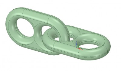

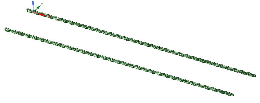

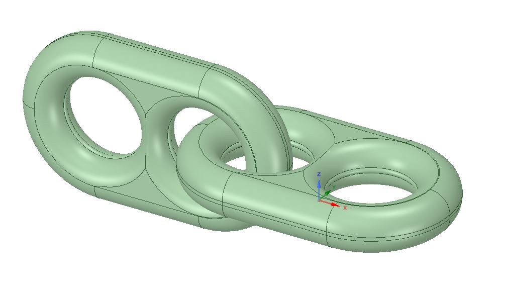

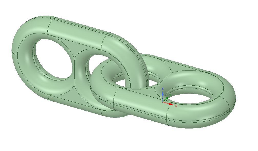

Today I designed the anchor chain as I was not pleased with the kit offering - mine is a complete chain, not just the top half :doh_1: . I printed and edited, the 4th edition came out to the correct scale. While I direw it to scale, the printing process somewhat shrinks the part (George Costanza knows Shrinkage!!! :cool_1: ) so I tried to match the kit part and now I'm satisfied that mine is a better item than Revell's. Take that Revell :Mad_5:
Also, on the 4th edition I tilted the chains 30� to stbd and I think the result was positive. More drainage and less shrinkage!! :cool_2: Anyhow, here's what the design looks like and then the final part after printing:

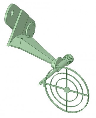

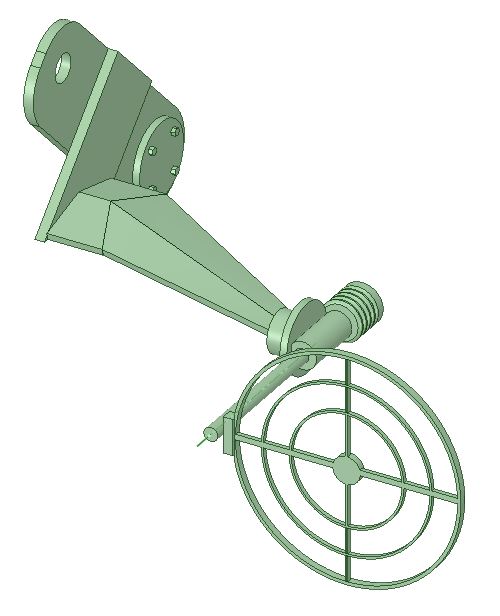

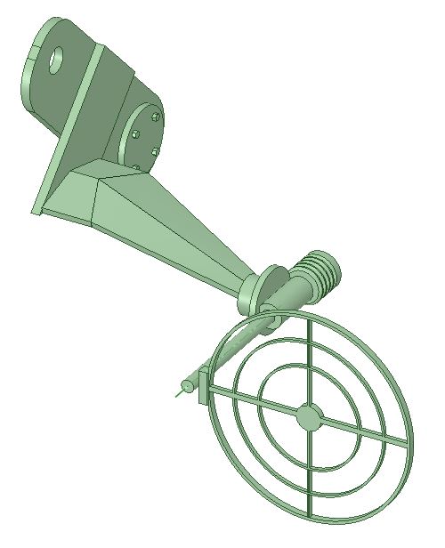

So, tonight I'll be working correcting the design for the AS-571/SLR RADAR antenna & support structure and get it ready for printing.

OhMyGosh Hank, that chain is incredible!! I don't know how you do it! Is it flexible, or is it just in one straight piece?

I appreciate the kind words - thanks!! At the moment, this is a fairly solid part - it's not individual links. Now, by my design, it would be separate, but I think if I were to scale it up and then print I might be able to get an actual chain. The individual links are not joined in the design file - but, the printer I guess at this smaller scale sees it as one long piece and prints accordingly. Now, at the far end of one of my two chains the opening in the link is there, so I know it CAN print these openings, it just doesn't. The computer software gurus can explain it better and in more technical (non-understandable!!) terms, right? :big_grin: One other thought on this - I may print out another set of these and while they are still "limp" (right after removing from the printer), I may try wrapping one of them around the capstan in order to get it to solidify in the right shape. All these parts get "cured" under a UV lamp which hardens them up (no pun intended :doh_1: )
I am amazed at what prints at times and what doesn't - it's a crap shoot, at best!! However, on average most of the details in my designs are printing and quite well.

As Hank found out with his chain, and myself with barrel springs, these small but geometrically complex shapes bring even a decent computer to a molasses on a cold day state. Make many curves in many orientations, constantly varying, and the machine literally screams at the surfeit of required one's and zeros. In the past I have gotten padeyes and sheaves to remain flexible at the joint, sometimes...

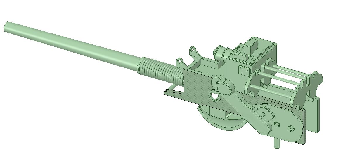

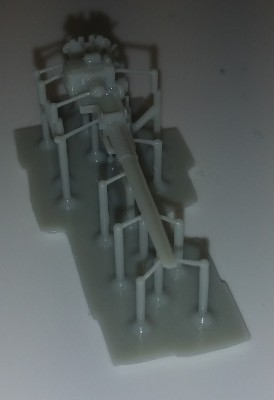

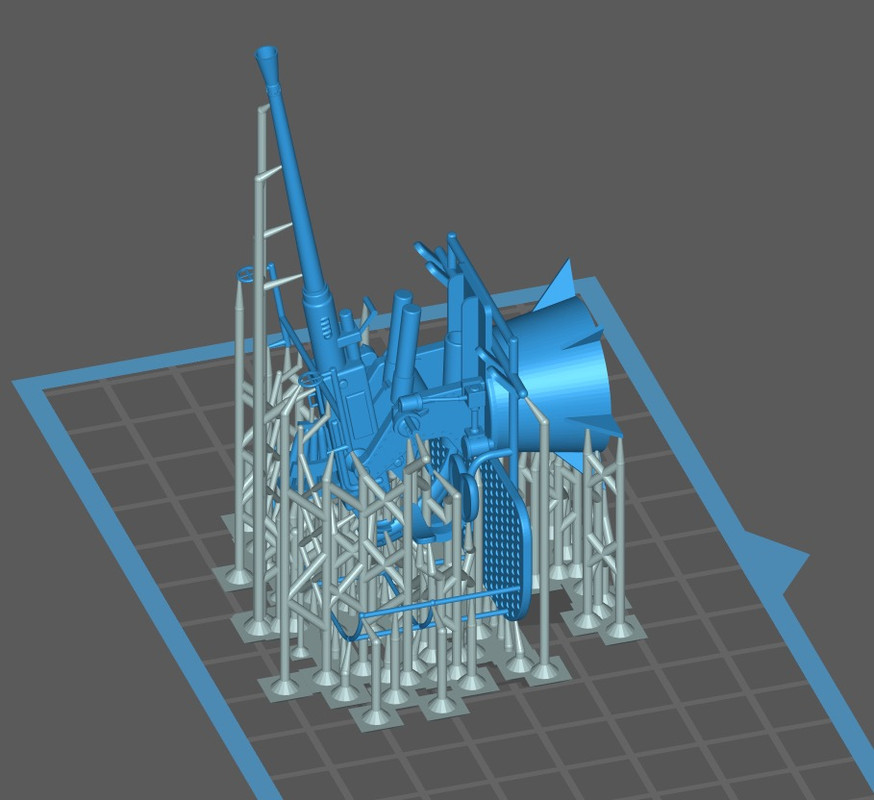

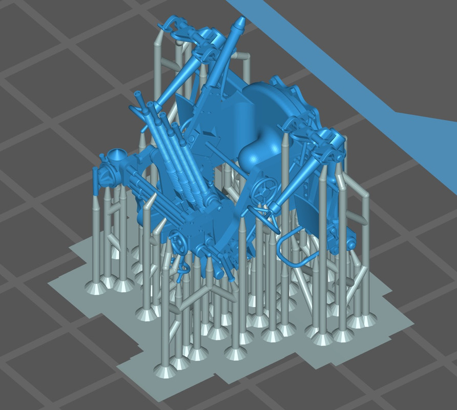

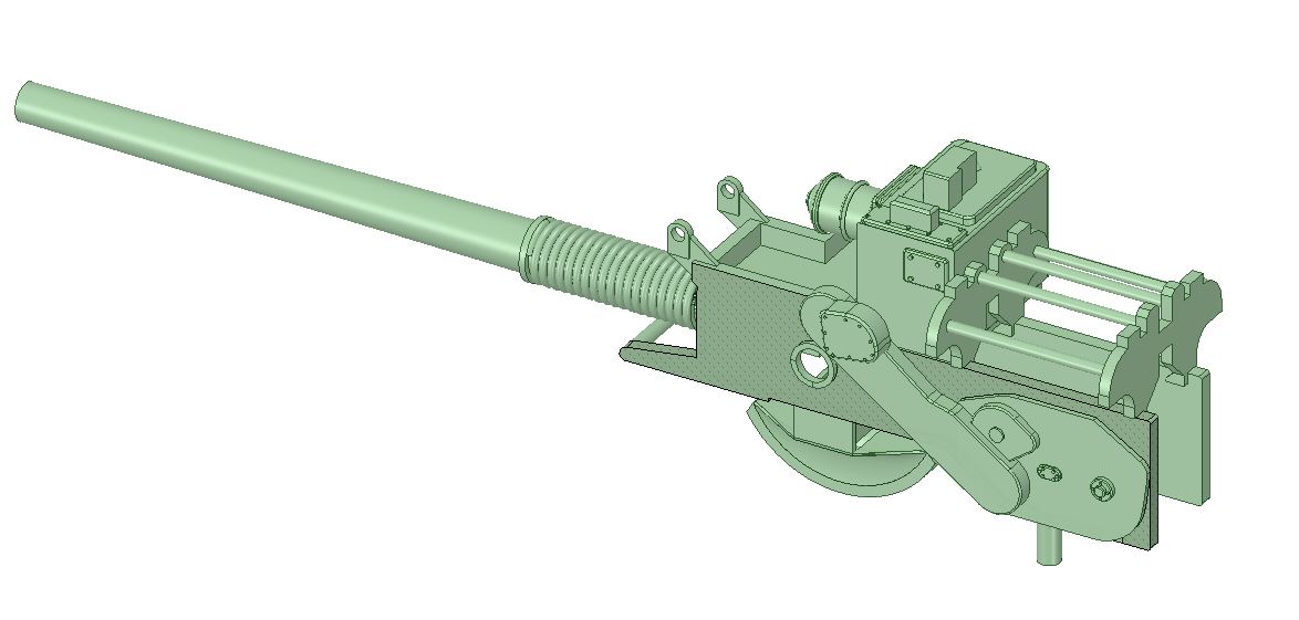

After 4 days of designing, I am printing a 1st edition of one gun assembly & barrel to see what does or does not print. Here is a shot of the design without a few other details I have completed (turned them off), but aren't relative to this post:
There is quite a bit of equipment on both sides of the assembly yet to add, and as this is a dual mount, all equipment is not the same for both gun units. So, quite a ways to go - and I still have additional work to do on the mount foundation before it's fully completed.
I should know in an hour whether this has printed acceptably or not!
BB62vet
Posts: 3145
Location: Mocksville, NC
Re: 1/144 Scale USS STODDARD (DD-566) - Kitbash, Revell FLET
Post by BB62vet »

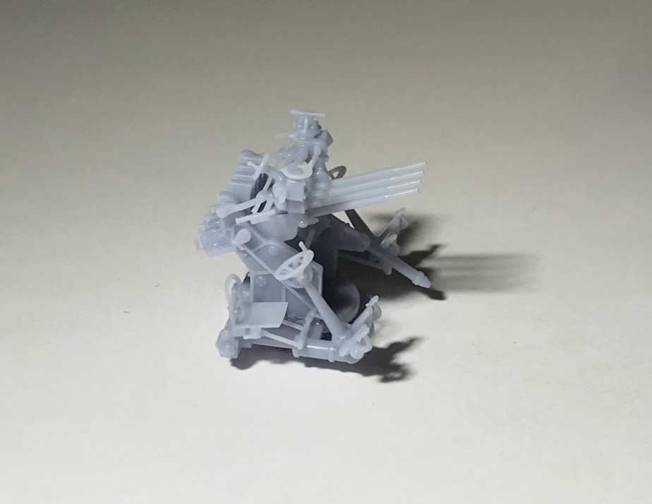

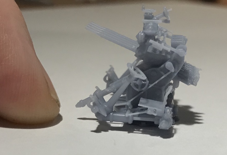

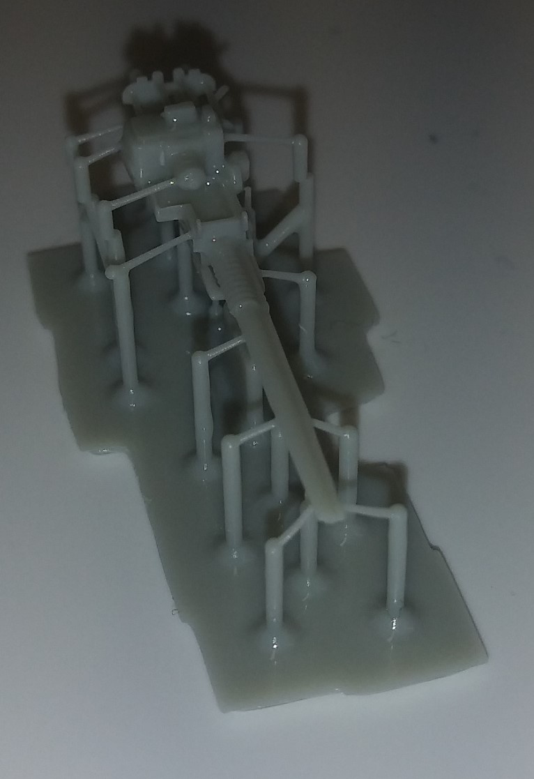

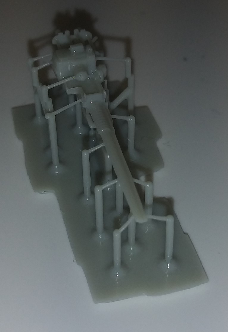

Well, the last printing came out so-so - there are issues still with this printing jog that comes & goes - we haven't determined what causes it. So, the orientation of the part for printing is rather critical as to the outcome of the part.
(Sorry, but the resolution/clarity of this photos is not the best)
Actually, I'm surprised at some of the detail that DOES print well and also at some that does NOT print or prints poorly. So, this is something to try to figure out and improve. The spring coils are now nicely visible (thanks to Fliger747!!).
After some further equipment additions I will run another test print and see how that comes out. I'm also considering switching resins and see if that has a positive result on the details.
Iceman 29
Posts: 1945
Location: Bretagne, France
Post by Iceman 29 »

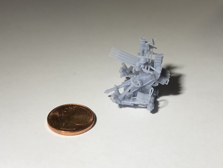

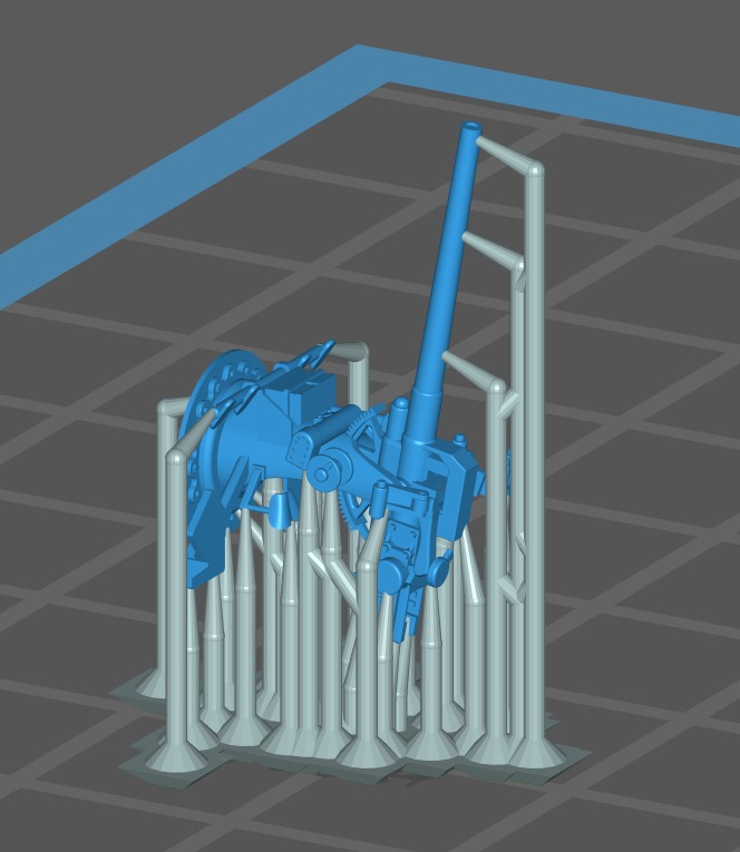

I tend to print the guns vertically, this is the position that has given me the best results.
I have not reprinted Bofors guns or 3 inch 50 since I got the new printer which is much more accurate, I would have to do a test.
13,2 mm Hotchkiss:
https://i.postimg.cc/rp1GTcZZ/Screensho ... 39-503.jpg
https://i.postimg.cc/Y9814RH1/Screensho ... 37-741.jpg
https://i.postimg.cc/PJRYyqNJ/Screensho ... 21-517.jpg
https://i.postimg.cc/7YjSTbpQ/Screensho ... 13-568.jpg
https://i.postimg.cc/RVxtTqS3/Screensho ... 43-020.jpg
https://i.postimg.cc/pXQFcxrs/Screensho ... 36-228.jpg

Thanks so much for the printing advice. I will try this orientation on my next print run. I also like your inclusion of photos of the Chitu setup - that leaves no doubt as to how to orient the part on the plate.

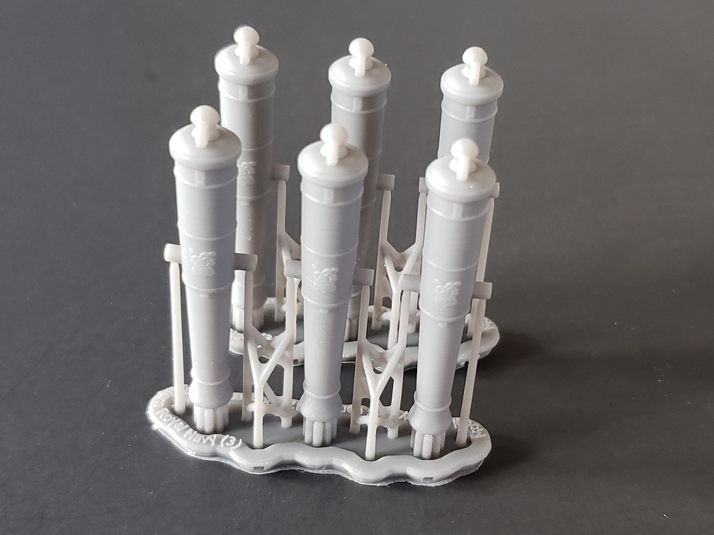

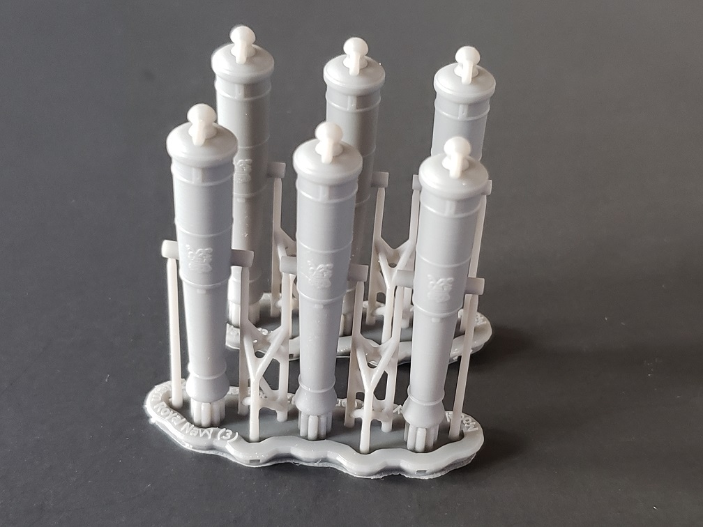

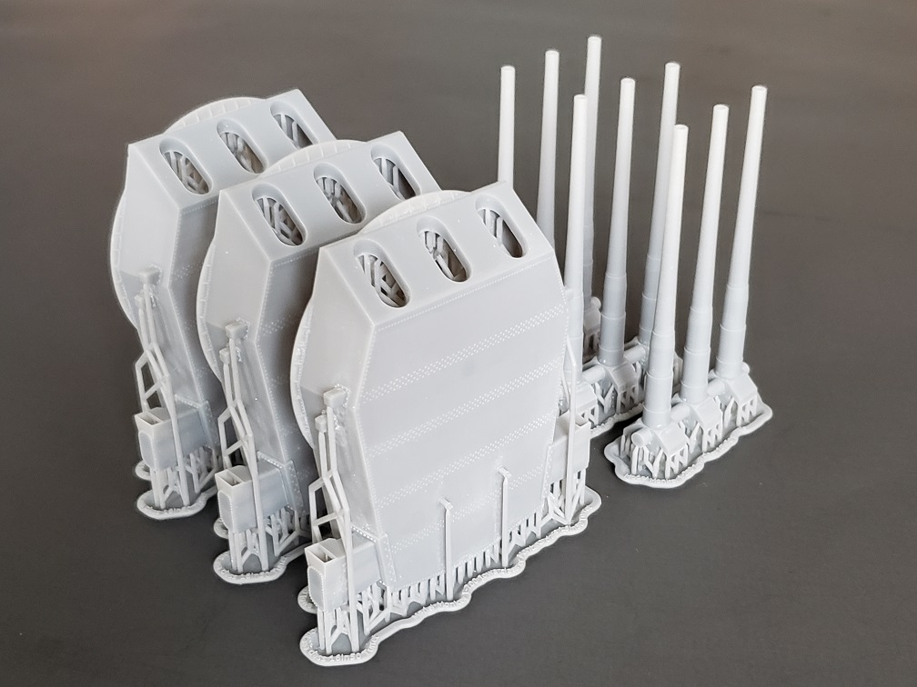

Posts: 4104
Post by ModelMonkey »

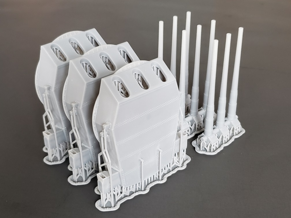

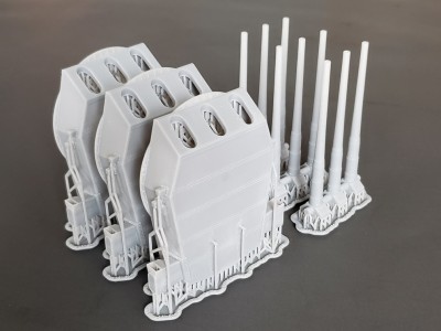

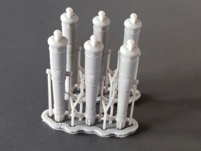

Concur. Try vertical. Takes much longer but prints like cannon barrels tend to look much better.
Model Monkey 1-200 Iowa class and Montana class 16in50 Turrets with Barrels a.jpg
BB62vet
Posts: 3145
Post by BB62vet »
Steve,
Thanks so much for chiming in!!! :thumbs_up_1: I will take all advice into consideration!!! I find it interesting that you don't support the barrel along their vertical length. I have been doing that when I've printed vertical items.
Glad you're following this - stay tuned....!

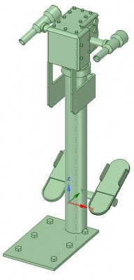

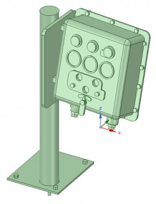

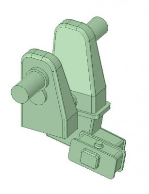

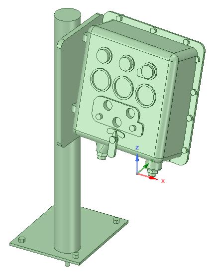

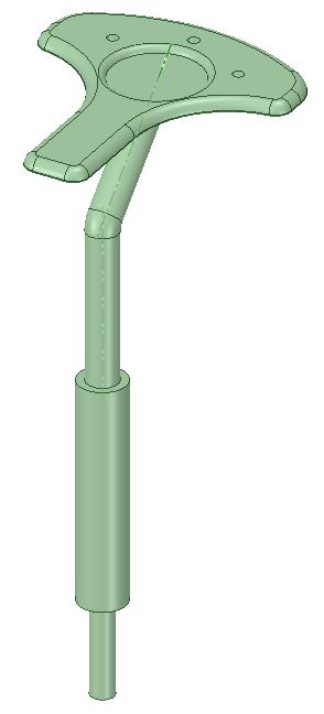

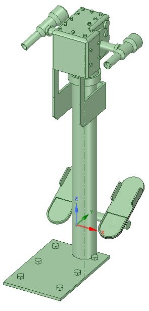

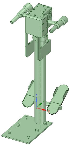

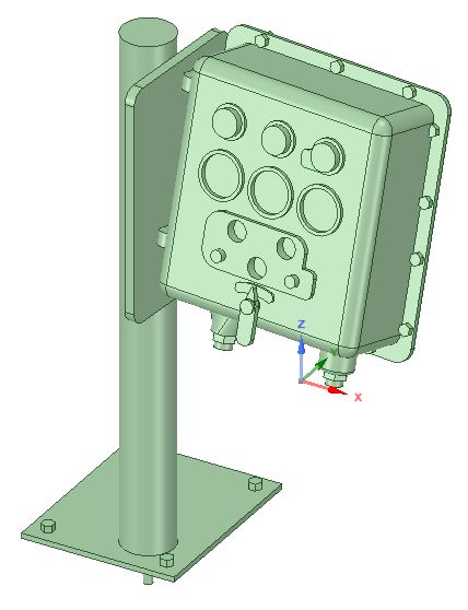

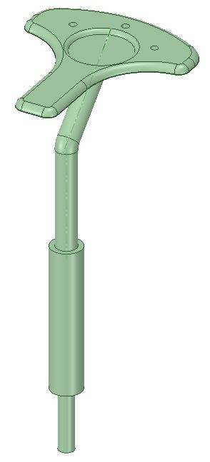

Oh, I did a bunch of separations (into individual design files) tonight and also some additional work and improvements. Here are some of the sub-assemblies that will go on the mount deck:
I hope to do some test printing of these parts tomorrow after I switch resins in the vat. Never did like Vat 69 :rolf_3: :rolf_3:

Some models of Quad Bofors also have a similar set of hand controls, though smaller. Their's are interesting in having a "deadman" switch in the handles which interrupts the command if the pressure on the switch is released. Looking at the complexity of these weapons (Including the 3' 50) I would expect that a lot of continual MX work was required for reliable operation. For my Bofors, I have had very good luck with printing at a minor angle, 20 deg or so. Experiments at near verticals did not improve the barrels and spring rendition, but severely impacted some ancillary items like the ring and bead sights and the rear of the receiver. Perhaps it is my own foibles of SLA printing and my machine, but attempting to print Missouri Turrets vertically would reveal an aft section that would be very bad and require sanding and filling. My LCVP's have this problem, but as the bottom is the least visible, I am willing to invest a little time with glazing putty and wet sanding to smooth this part, with the reward of the rest of the boat coming out very well.
Your breaking things into pieces does allow best orientation in a situational manner, though with the downside of having to assemble things. So far my somewhat complex Bofors print optimally with barrel assemblies and mount as separate pieces, mostly due to being able to orient the barrels and equipment with optimal supports.

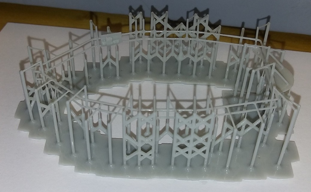

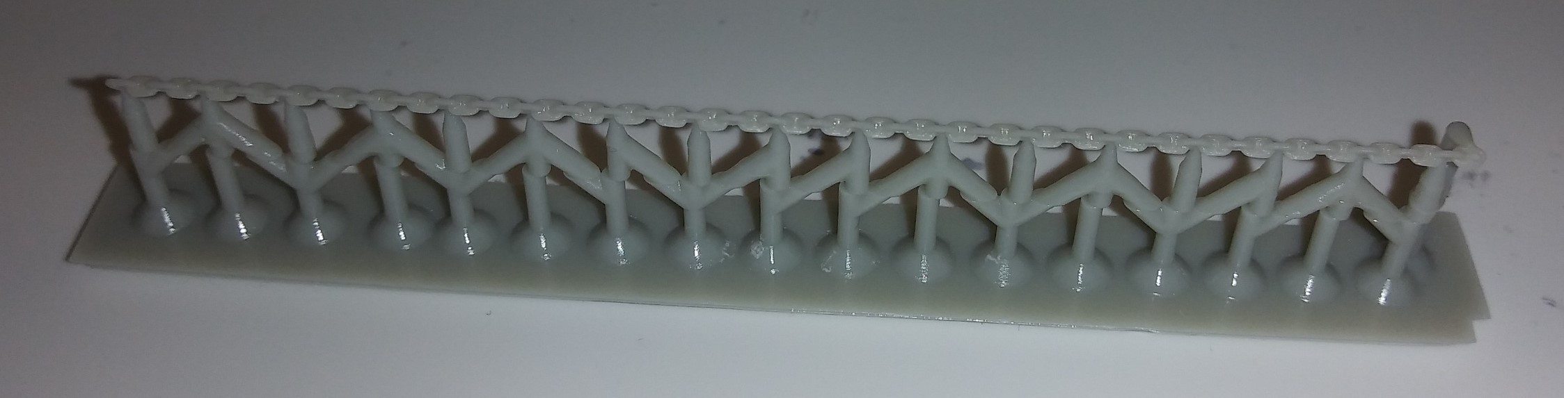

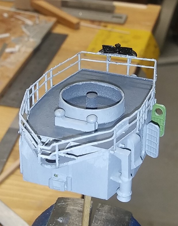

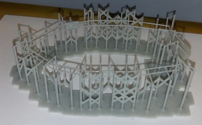

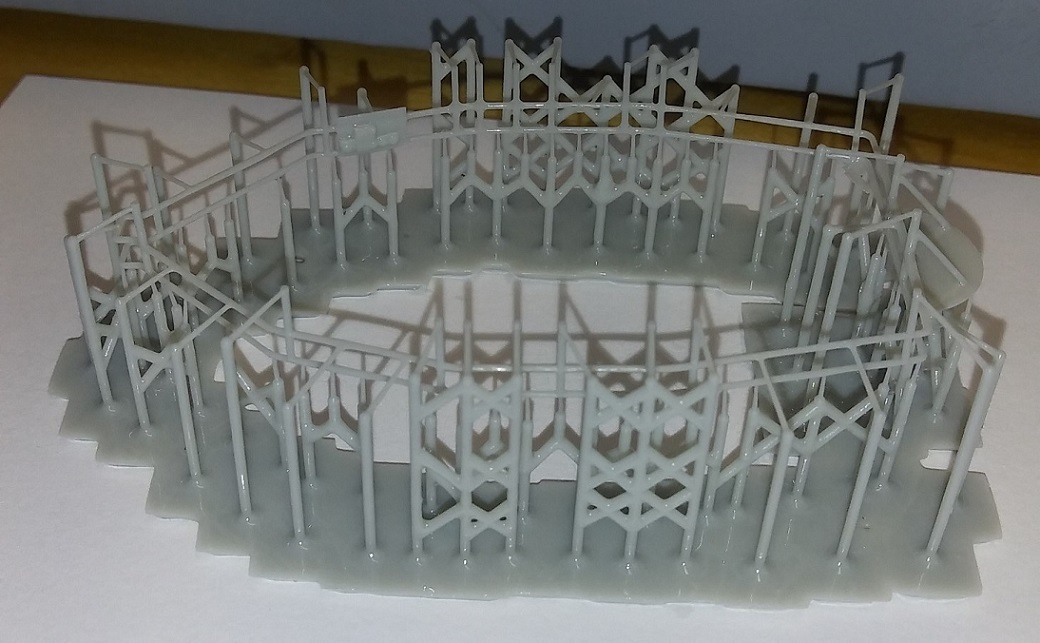

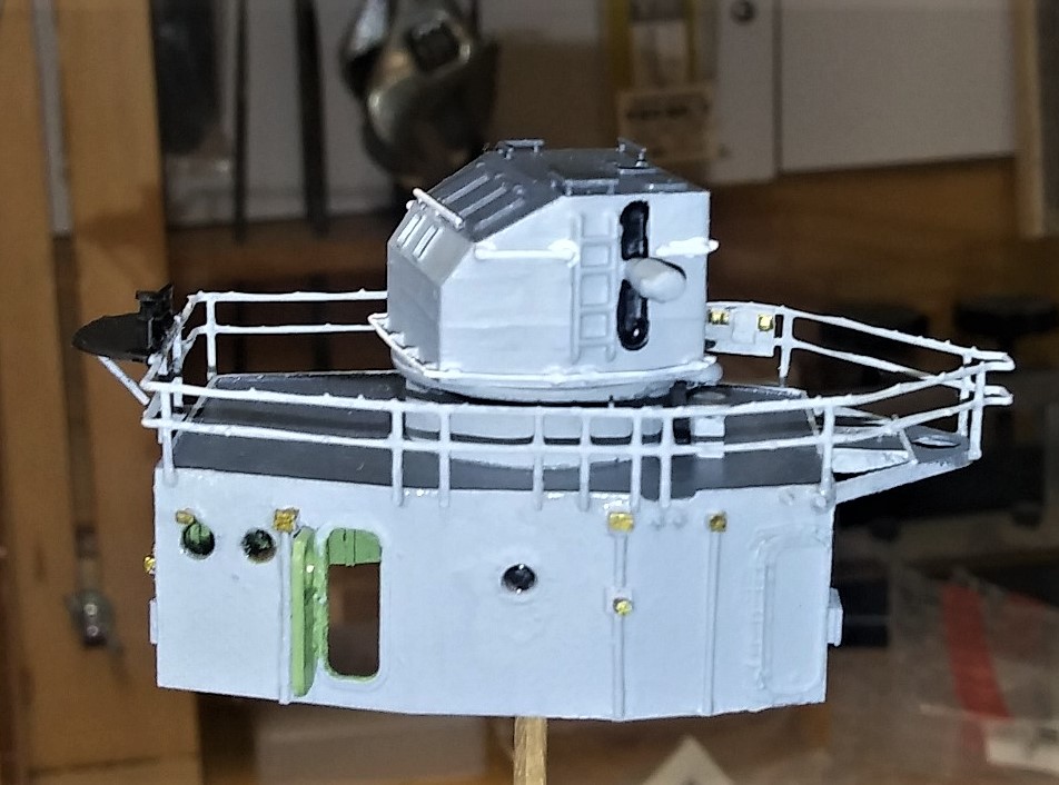

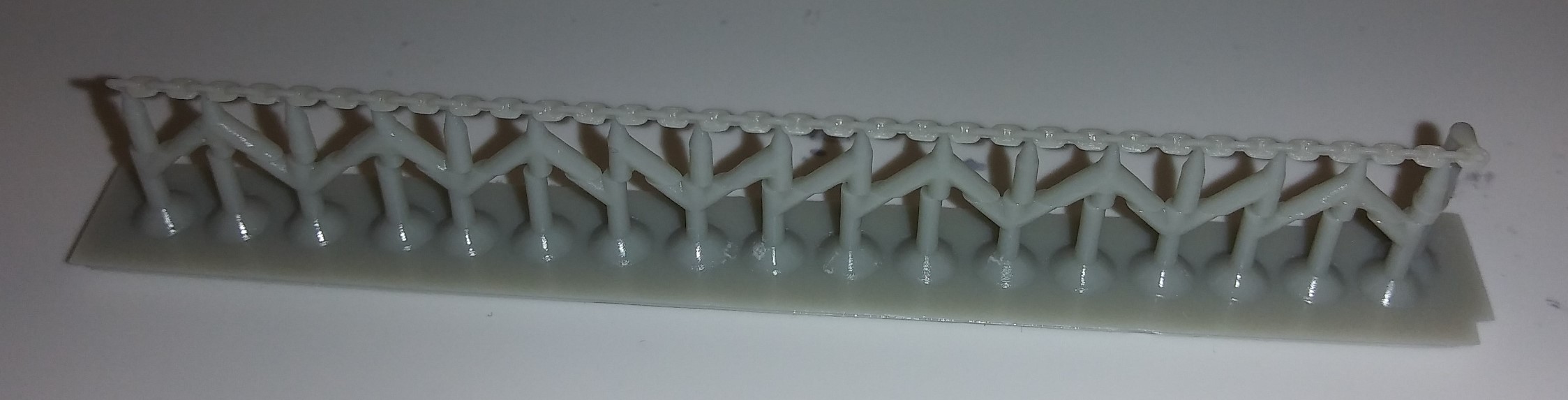

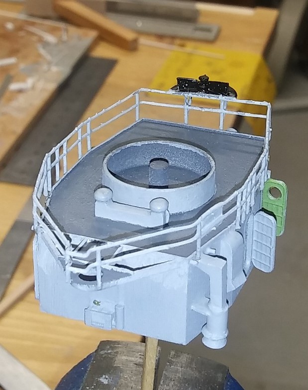

Several months ago I asked Tom to print out the pilot house railings for me as I didn't seem to be able to get a decent print, and he complied - mailing me the finished part. I'm now ready to assemble it on the pilot house and guess what - it's too small - it should fit over the edges of the bulkhead, not side inside on the pilot house overhead decking. So, I set up the printing file again and after 2 unsuccessful attempts, have finally figured out a way to get a successful print - turning the part upside down and extending the supports from 7mm to 12mm. For whatever reason(s) unknown to either of us (I'm thinking software) there is a jog that appears about a 1/4" in height from the bottom of the printer vat surface. So, by extending the supports, I'm essentially letting them take the jog and leaving the part to print out ok. So, here's a pic of the printed handrails (upside down) - I've had it curing overnight and it should be ready for removal and painting today:
The problem I've had with the earlier versions (there were several others from last fall) is that some of the railings were printing flat and were distorted. Turning this over somehow resulted in a good, usable part. So, as I've mentioned before this is a constant learning process. So, later today I hope to remove & paint this item, of course a test fitting is 1st, fingers crossed :heh:
Continuing tomorrow with my 3"/50 Dual R.F. gun mount design (with a bit of Tom's help also!!) - this is a major undertaking for a novice 3D design student such as myself :oops:
BB62vet
Posts: 3145
Post by BB62vet »

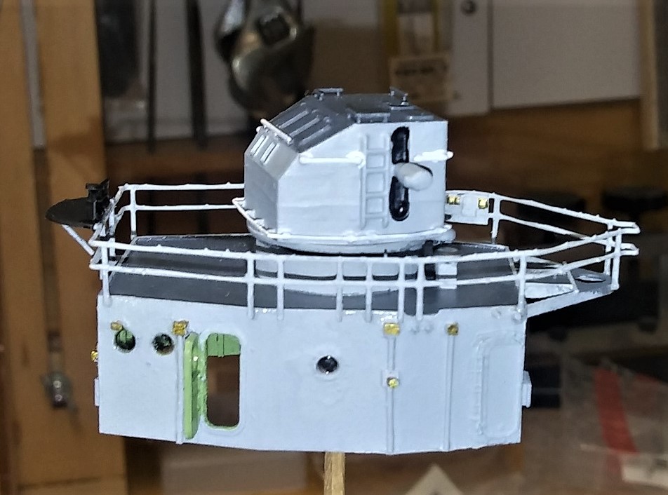

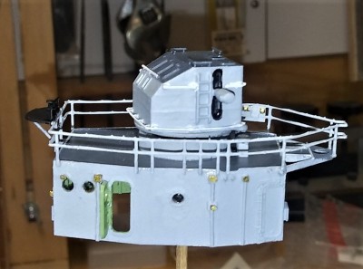

So, among other things today I did get the P.H. railings installed and also set the Mk. 37 in place to see how things are shaping up:
So, this entire unit is comprised of 3D printed parts:
Pilot House (Model Monkey)
Pilot House Railings (hms3/TFalley)
Additional details (hms3)
Mk. 37 GFC Director (hms3/TFalley)
There is touch up painting to do - but, at this point as fragile as the railings are, I have no plans to try to trim any of the little "stubs" where the supports were located as I don't feel like breaking this and having to redo the whole thing. I also have bulkhead handrails & a couple other items to add and then I can call this "probably done" :big_grin:
Posts: 5068
Post by Fliger747 »
Hank:
The support nubs are a little irritating. I had a large number of these on my Bofors, which were repleat with fragile bits as well. The flush cutters get a lot of these, but I wonder if one could take some very fine sandpaper and glue it to a tongue depressor and worry these off?
Looking forward to further detailing of the interesting bridge area, always a focal point of any model!

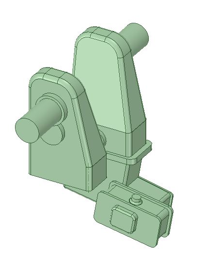

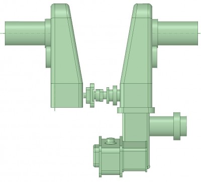

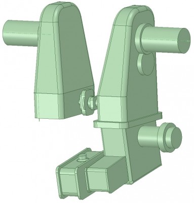

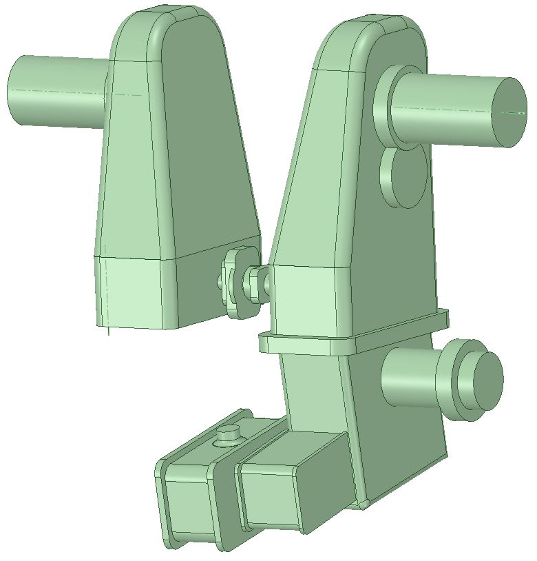

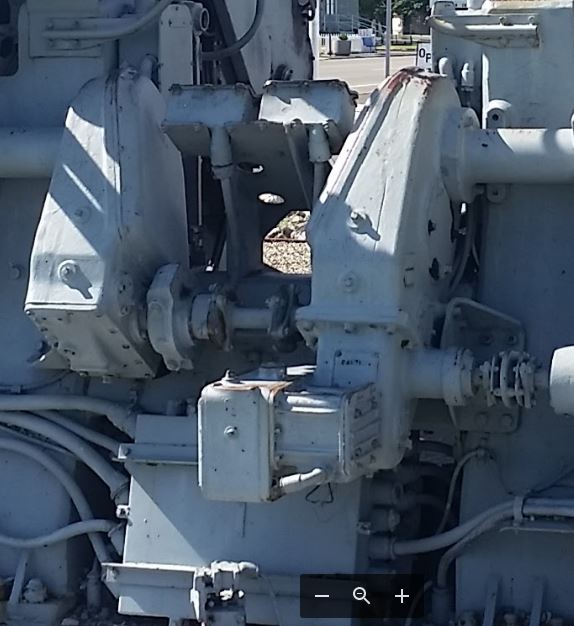

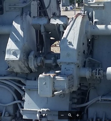

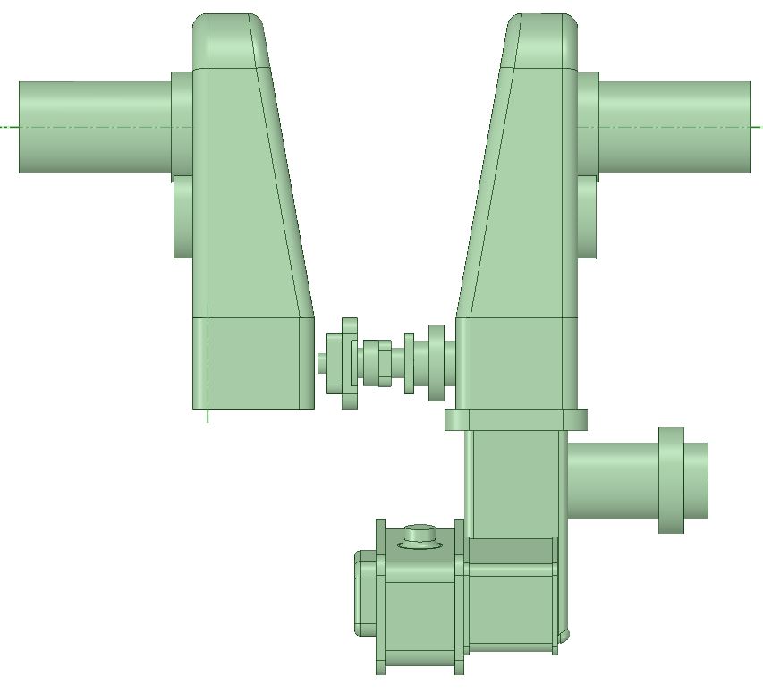

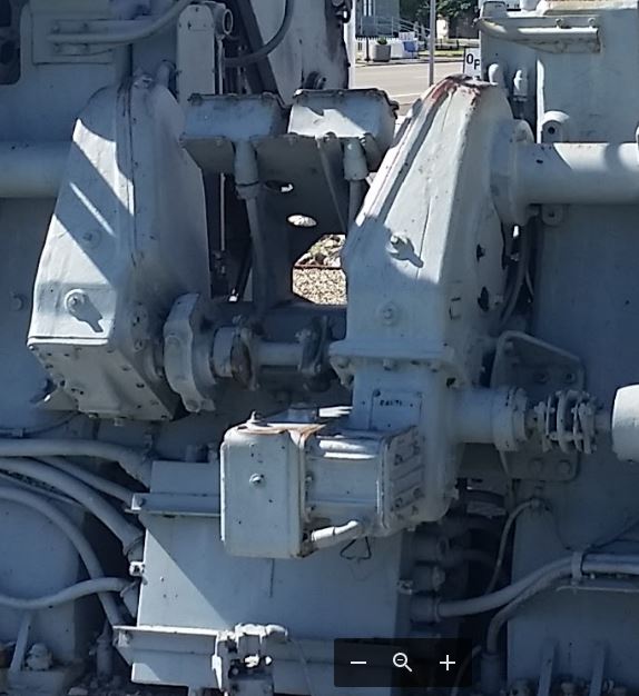

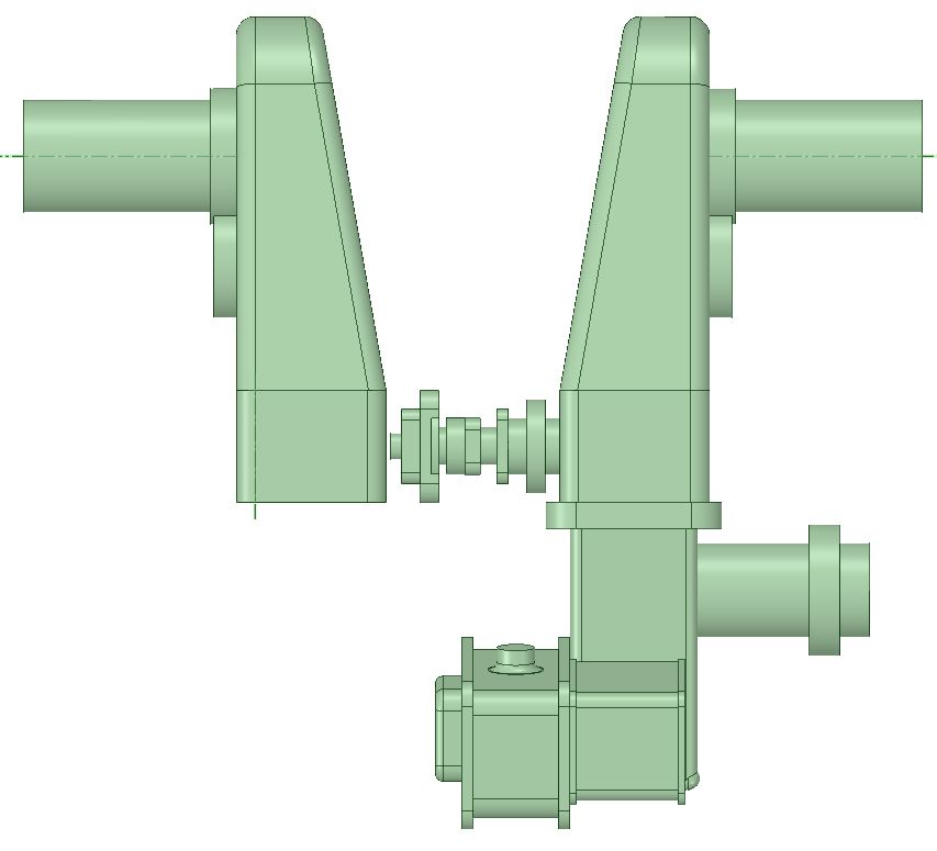

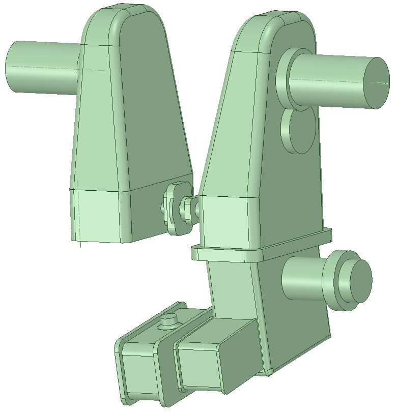

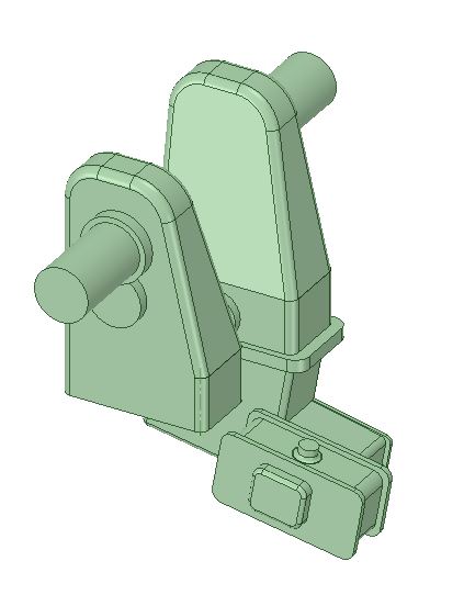

Today's efforts (while waiting for the Extreme Weather to arrive here in the Piedmont, NC area) I've been redrawing the Elevation gear & train for the 3"/50 gun mount - I am about ready to mate this equipment with the main foundation file and see how things fit. Always a challenge, esp. for someone with as little experience as I have with the 3D design, etc. Here are a couple views of the equipment and one of the actual gun mount:
In addition, there is a need to simplify this in order to get a reasonable printed part of the equipment without losing a lot of the detail at this scale. So, this is a compromise in what we want to have detailed and what will actually print.
