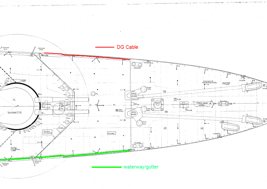

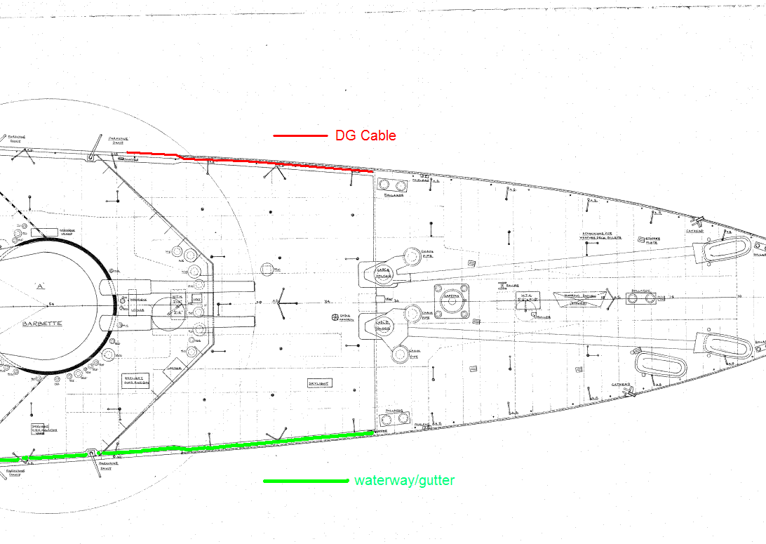

Hi Dan,
Thanks for the reply... and I suspect you are largely correct,
But what "gutter" are you referring to?
Here are the plans for the forecastle:

...these gutters:

Ah!,
I see now.... page 210 R&R...
Another feature magnificently not modelled on the Trumpeter kit!!
(excuse the $.... its from a free scanner driver for the mac I'm trialling!)

Newer information has since proven there were no HMS Hood-style "paired conduits" used aboard Repulse. The cabling ran all the way forward to the bow, held in place by omega clamps, and never did cut across the forecastle ahead of the breakwater.Andrew F wrote: [WEP] have it as a double cable of a similar nature to the one on Hood and have it cross the bow from port to starboard just in front of the Breakwater.
Andrew
This information is actually from dockyard photographs that were taken during the ship's 1940 refit. They were not available to me at the time this post was first made--DB.
