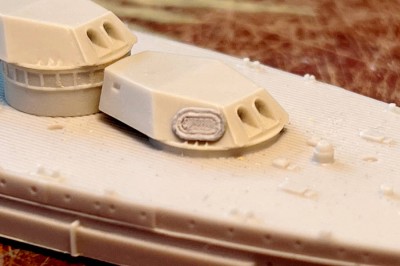

I'm pretty happy that I *FINALLY* figured out how to make a nested pair of rafts. I haven't been able to find this among aftermarket parts. As an example, I include a picture of Maryland showing the rafts on the two forward turrets.
This is my third attempt. I took a 3D printed raft, and wrapped 0.5 mm copper wire around it. I was able to eventually get a good fit. Here it is with a first coat of primer, resting on the side of a turret. I like how it turned out. I'm not so fond of how long it took me to make this one, and that I have a lot more to make.

is the wire on the outside or inside? I would use either a scribe or a pointed blade to be used as a scribe to scribe between the outer raft & inner raft to give more detail depth between the 2 rafts

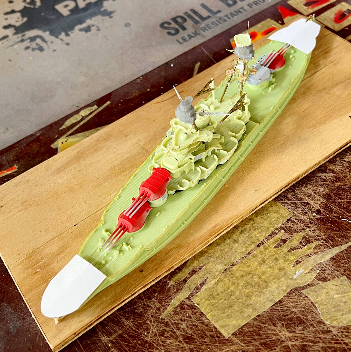

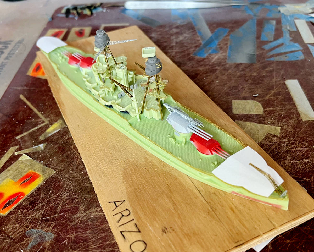

In other news, Arizona is getting closer to paint. I've got the deck edge railings on, which includes the parts that support the awnings. I took this from the Tom's set for Oklahoma and Nevada, since their Arizona set didn't have the awning supports. However, on Dec 7th Arizona had awnings up but Nevada and Oklahoma didn't. I mocked up some awnings by just cutting out approximate shapes from paper. I haven't decided how I want to implement the awnings on the model...either sheet plastic, sheet brass, or something else.
I also haven't figured out how the amidships awning was rigged. It might have been one piece, spanning from one side of the ship to the other, passing between the main mast and turret 3. Or maybe it was two pieces, with a gap on the centerline of the ship.
There are a few things to add to the main mast of Oklahoma and Nevada, and then *I think* we'd be ready for primer.

Sometimes photographs can be deceiving. What’s causing the appearance of two awnings is the overhang of the back of turret #3 along with its aircraft catapult and also the rangefinder platform from the mainmast hanging over as well.
