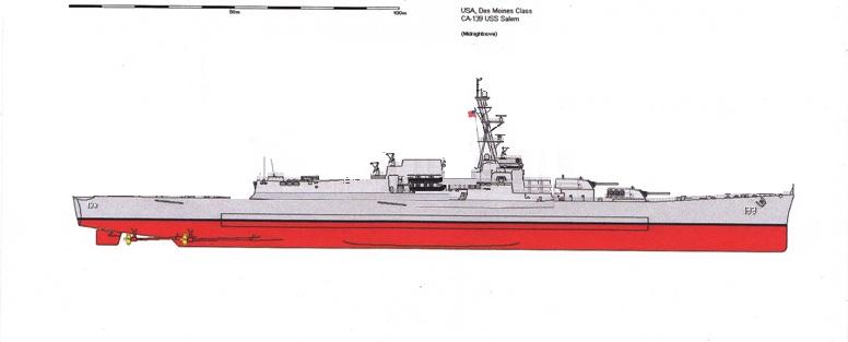

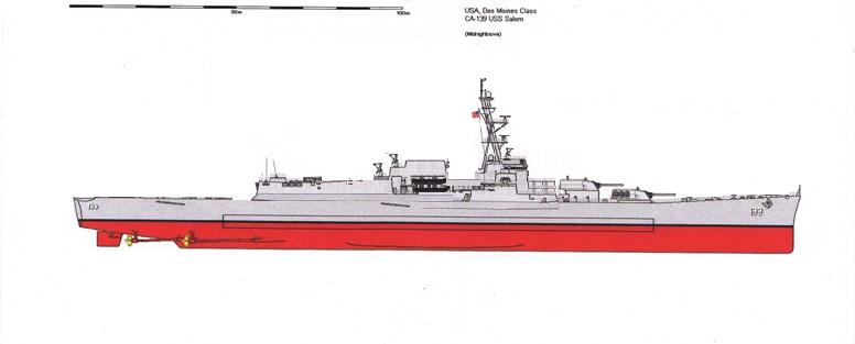

I can tell you are saying the Long Beach is the last heavy cruiser hull. Even though the Long Beach was a heavy ship, and she was a cruiser, she was not a heavy cruiser. The answer is:
USS Salem.

You are going to have to get some real numbers going and get an arrangement drawn out! I think this is a little bit more proportionately correct. The actual lengths of the super structure, helos and hanger, etc. You should be able to get a real nice drawing going!

I will get round 2 drawing up something eventually! ( I draw old school paper & pencil !!) Got sidetracked working on fwd mast of CGN-9 (what a PITA soldering brass is!!) will post a couple of pick's in the WIFF CGN-9 thread shortly.
Your shipbucket effort is spot on that would make an awesome model!(and real ship), you could have a short length VLS in front of bridge for ESSM's,and Harpoon's(if there was a VLS 'Poon)or SM-XX(insert no they up 2 now!!).
Bruce :thumbs_up_1:

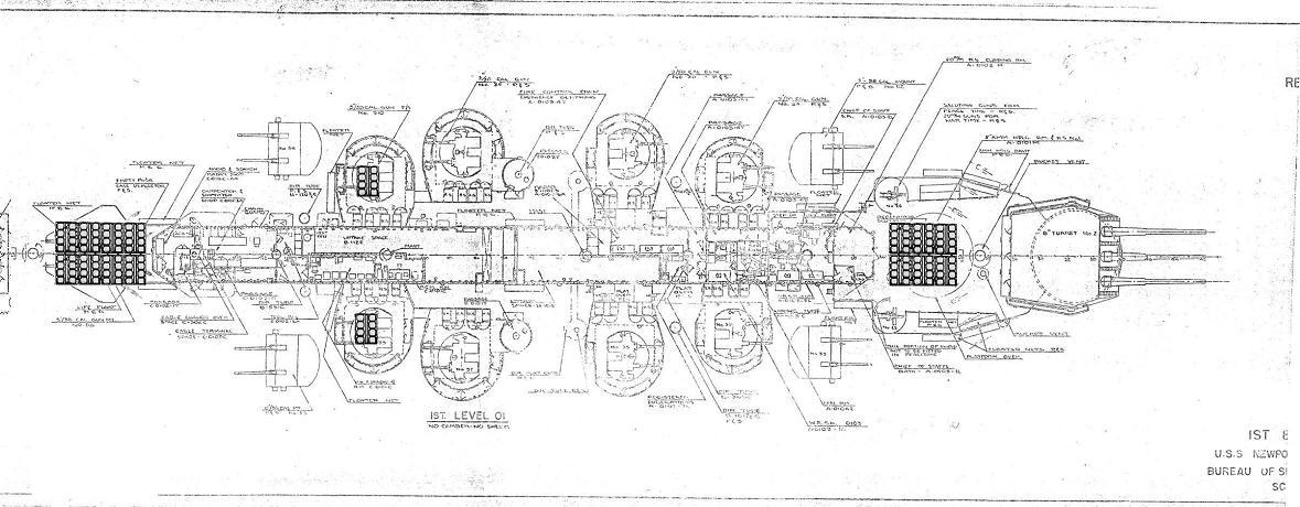

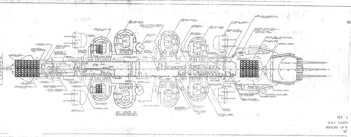

Here is a visual description of the VLS arrangement. Forward and aft would be a total of 112 strike-length Mk41 Mod5 VLS accommodating TLAM, ASROC, SM, etc but would be fitted with TLAM only. The second set of tubes would be two self-defense length (SSD) VLS modules (8 tubes per side) inside of the armored former 3-inch magazines accommodating up to 32 ESSMs.
The 112-cell VLS arrangements along centerline would be elevated to the O-2 or O-3 level depending on how deep into the ship we would want to penetrate. I would suggest the VLS structure...or "missile deck" surrounding the six VLS modules forward and 64 aft would rise up to the O-3 level with some penetrating into the former 5-inch magazines, which at 10' decks is plenty of space.
There is a possible alteration where I would change the SSD/Tactical length VLS from Mts 38 and 39 to Mts 36 and 37 that are on the outside. On the other hand, I may indeed put RAM on slightly elevated platforms on top of Mts 36 and 37.
This permits 112 Tomahawk Land Attack cruise Missiles (TLAM) and 32 ESSMs. Oh yeah. This enables the ship to wage some serious war. This isn't just "reach out and touch someone." This is "reach out and beat someone's ass".
More development to be had!
navydavesof
Posts: 3127
Re: Modernized USS Des Moines/Salem/Newport News
Post by navydavesof »
NOTE:
I committed the horrible sin or editing a post after others have commented. It does not contradict what anyone has said, I have just updeated a photo. :big_grin:
In addition to this, I am beginning to think that two 30mm variants of the Mk38 Mod2 per side instead of trying to jam Mk110s on this ship would be a good choice for small boat defense. 5" KE-ET rounds are a lot more lethal against small boats than 57mm super rapidfire guns anyway. The only thing the 57mm has on the 5" KE-ET is rate of fire. Five-inch fire employed against small craft is a lot different today than it was when the Vincennes tried to fight small boats in the Straights of Hormuz with standard 5� rounds back in the day. The rate of fire and speed of engagement at closer range is where the 30mm Mk38 Mod2s would supplement nicely.
I think a single 8-cell module of self-defense length tubes on each side of the ship would be best. While 16 could be accommodated just fine, the only reason to have the extra tubes is if the ship is going to be an SM shooter...or unless you want to carry over a hundred ESSMs...which is dumb. I would not recommend turning the ship into a CAG, because that changes the profile and focus of the ship. This is a surface warrior, not an AAW platform, so they should focus on surface warfare and NSFS and let the rest of the strike group worry about AAW stuff. The advent of ESSM has also really revolutionized self-defense capabilities to where if you have ESSMs, you pretty much have SM-1s.
SumGui
Posts: 484
Post by SumGui »
I like the layout drawings, but I am continuing to wrestle with the loss of the two superfiring 5� mounts. Those are the best positions for firing arcs, and should give you two twin mounts to either beam while manning only half as many mounts.
My Mk1 mod 1 eyeball makes me think that the space for mounts 52 through 55 would only allow 16 cells in exchange for each, leaving two twin 5� mounts and 64 strike length cells. It would disperse the cells, so you should never lose more than 16 in one hit, but move them closer to the sides where they are more likely to encounter damage (as opposed to your VLS fits on the centerline). Grrr�.
I want superfiring 5� mounts and I don�t want to give up cells for them�.damint�
