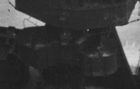

Turret Top color. But Why Is The Number 1 Turret not showing any red?

Looks like some robe and stuff on top covering up the color maybe.

As I recall, the red was a late 30s thing - before that, there was grey, though I don't know on which turrets.
For sure you can see a V patch of light colour on either sides of the centre gun barrel on turret one that should be dark in colour if it had been painted.

No, look at where the rope loops back in the middle. There's no color on turret one at this time.MarkSchroeder wrote:Looks like some robe and stuff on top covering up the color maybe.

See also the overhead shot of the Colorado I referenced a few posts up; having both forward turret tops painted wasn't always the case. I recall seeing somewhere (Tracy's Researcher@Large site, maybe) that a 1940 or 41 order went out emphasizing that both forward turrets were to be painted (thus implying that they weren't always done that way before). I don't have time at the moment to look it up again. Maybe later, if no one else has found it by the time I get a chance.
The original August 1938 orders didn't specify both forward turrets, so many ships saw the division color on Turret 2 only. I believe that the letter that specified painting both forward turrets was from mid-1940. Even after that date, some divisions further distinguished themselves by selecting which forward turrets would be painted.

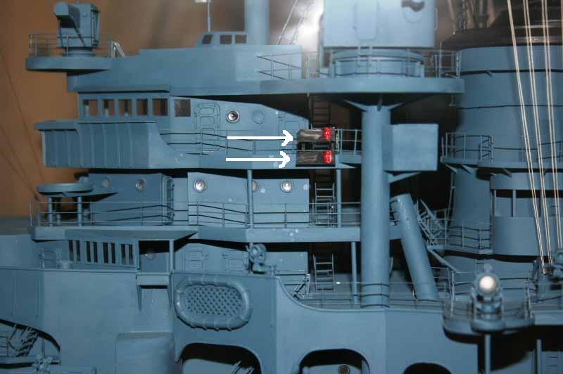

What the heck are the two things attached to the railing on the navigation bridge (shown here in a picture of Don Pruels model)? I can also see remnants of them in the post-attack photos like the one Ron posted a few posts above.

Lights; port: red / starboard:green

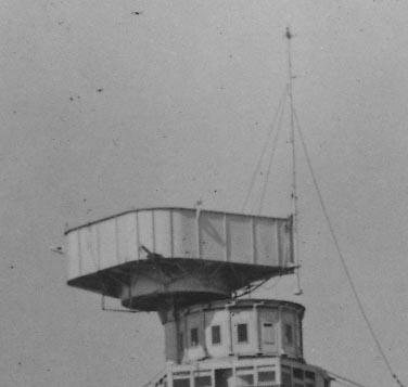

After looking at a couple of scans I grabbed at San Francisco NARA I'm reasonably certain the forward AA guns were .50 cal and not 20mms. Nothing definitive on the aft fighting top, but my gut says no. Note the extra pole on the tub though....SeanF wrote:Note what looks like a long, thin gun barrel pointing up from the foremast's MG platform (along with what might be a metal stop rail around it).
- Aft fighting top

I have to say, those pictures posted by SeanF sure do look like Oerlikons, if they are real.
