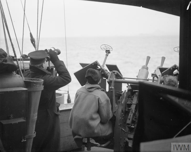

Now the description of the sighting device reads like this: '... Mounted on the top of the six foot fence post were the butts of two double-barrelled shotguns, each complete with twin triggers and set shoulder-width apart. Between the butts was an open ring-sight fixed at an elevation of seventy degrees. Sight and gun could be trained from beam to beam, the movement being transmitted to the weapon which followed the sight. Each of the four triggers fired twelve rockets...'
It would be great if someone could find a picture of this contraption... This apparatus below comes close, but the 'shotgun butts' have already been replaced with the shoulder butts we know of many later USN directors, like the Mk. 41 and Mk 57, or the Swiss Oerlikon 20mm machine gun.
