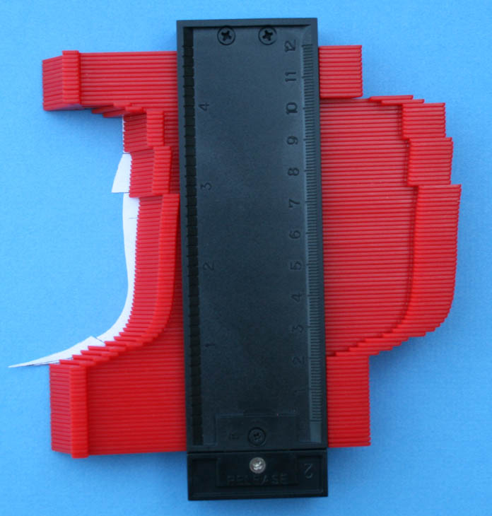

I had completely spaced on the possibility of using a contour gauge until a couple of days ago. Below are comparisons to the same plan cut-outs as I did before.
As I mentioned before, the lower "corner" of this area is too wide; you can see where the hull doesn't cut in enough above and then curves too far out. This is just ahead of the blister, and would complicate re-contouring the blister:

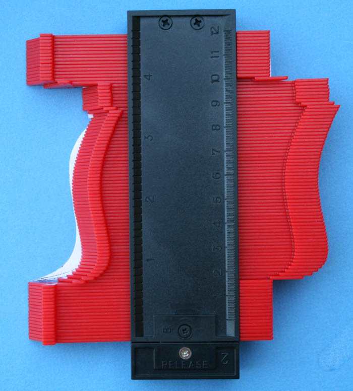

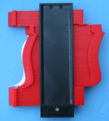

This is Frame 22 1/2, just after the blister begins, maybe 3/4" on the model. It's lined up with the top vertical bulkhead just below the edge of the deck, and you can see how it's missing the jog in, which sets off a whole problem in shape. Notice that the Trumpeter blister is much more slab-shaped and leans out where it should be more serpentine. The fact that so much white is visible in this area means that the blister is much too fat in this area and extends too far down.

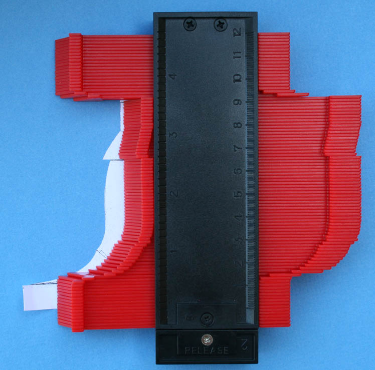

Here's the last of them... Frame 30, or just about where barbette #1 starts. Note again how much white space there is (I did offset just by a bit so that the full shape of the plans is visible), indicating once again that the blister is too fat. But also see how the contour gauge crosses over the plans at the bottom; this means that the blister doesn't extend down enough. My contour gauge wasn't "deep" enough to really explore this area, but you get the gist of it.
Anyone wanting to correct this is going to have a lot of work ahead of them. If I didn't have a set of Keith's brass props I'd be inclined to just do her waterline.....
