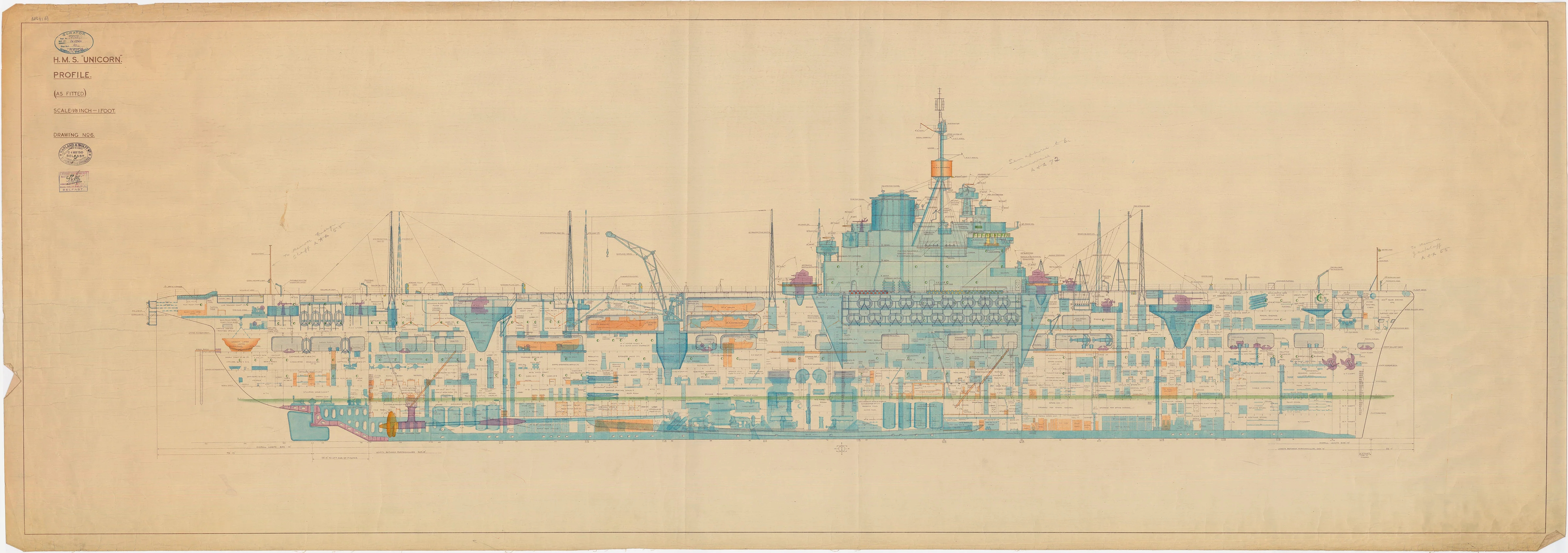

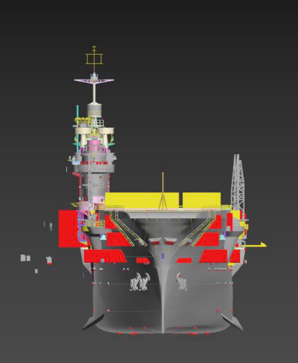

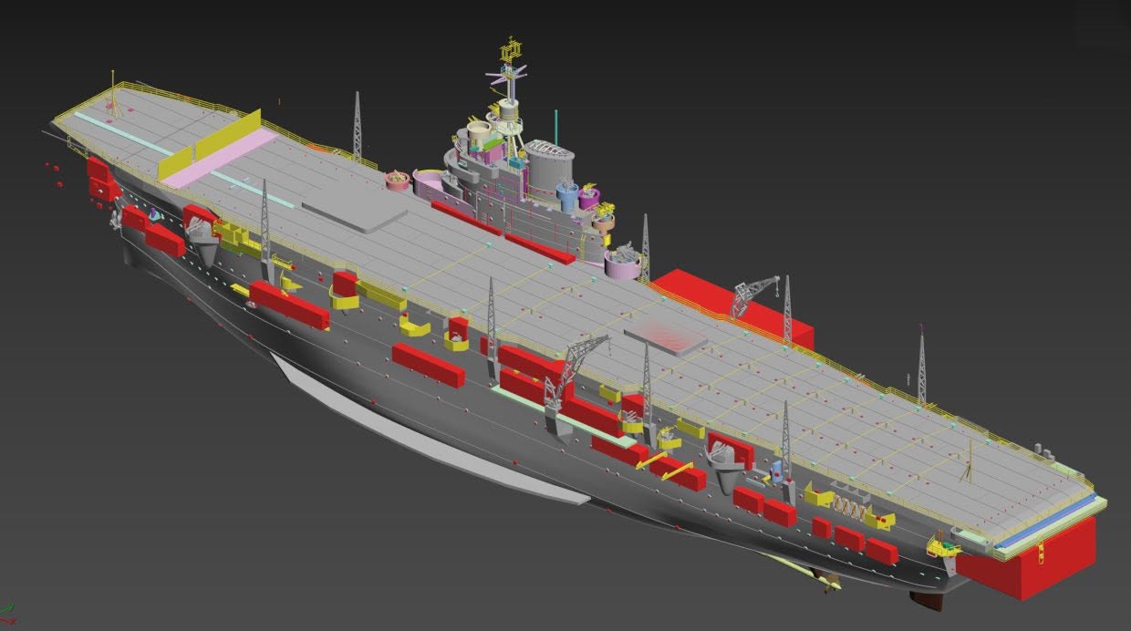

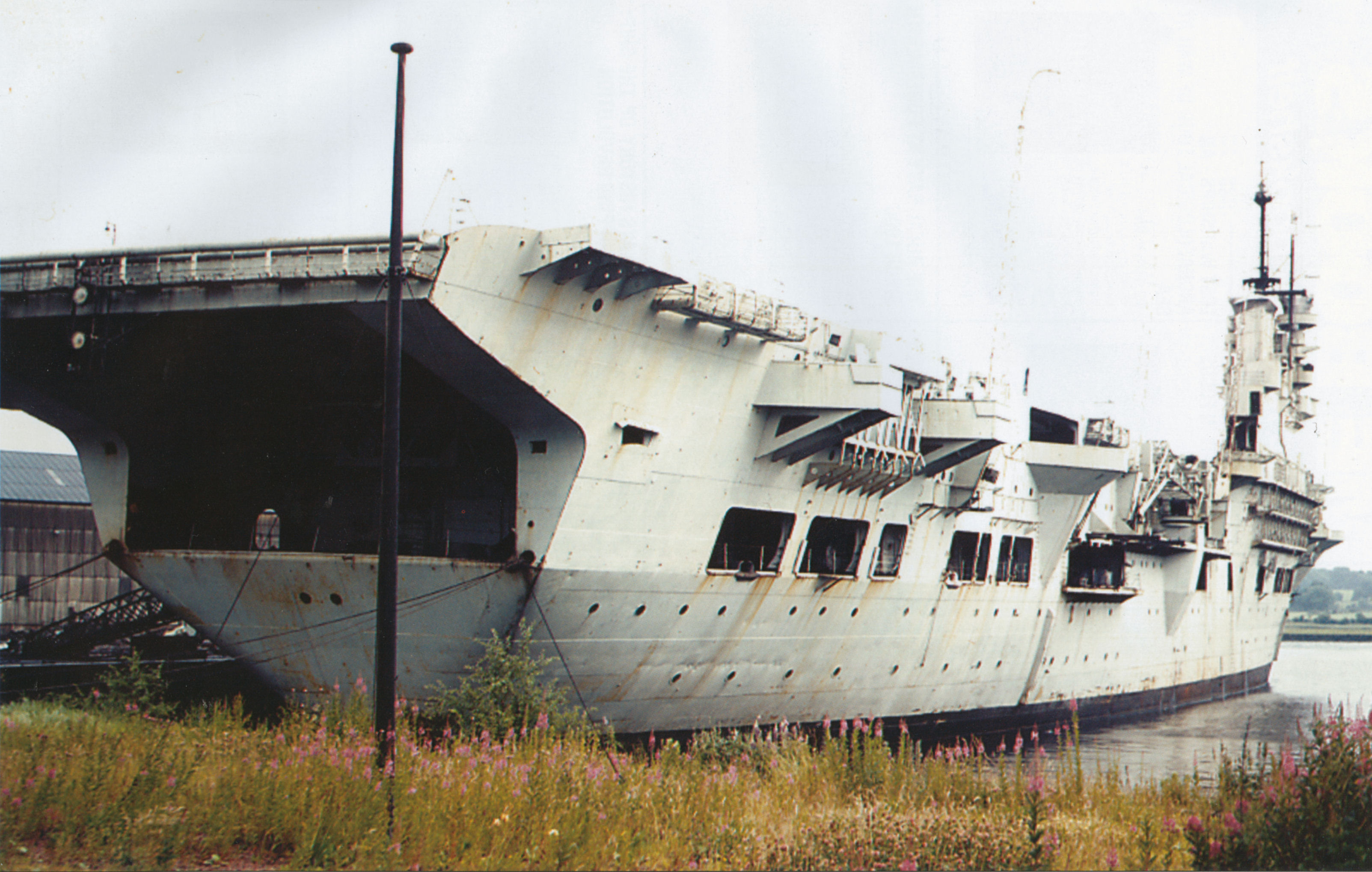

there are problems with that model, bilge keels are in wrong location & to big, the skeg does not look right. look at these pictures for possible more issues. are the red area supposed to represent hull openings?

Re: *Resin* A list of Upcoming Ship Kit Releases
The red blocks are located where openings should be yes.
I don't want to jump the gun here, because that's clearly still a work in progress and subject to change / refinement, but the stern where the hull curves above the rudder and props looks rough.

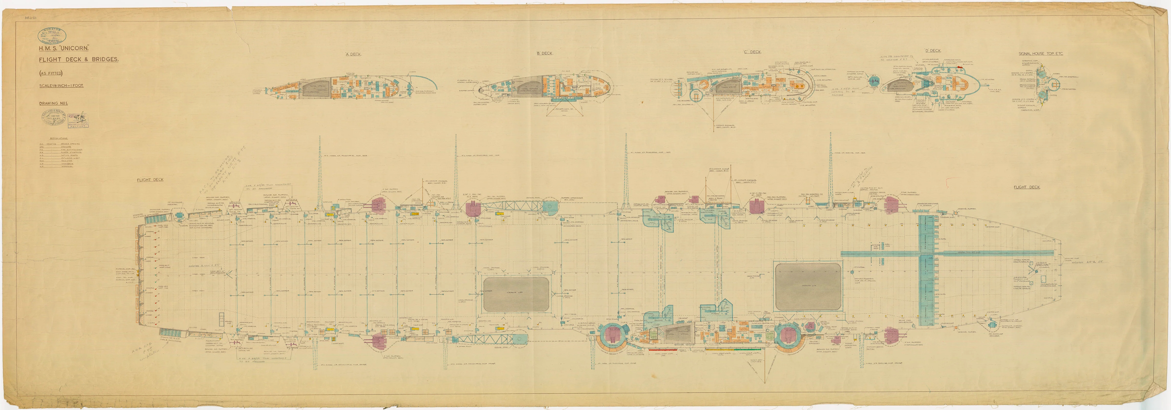

the island's sponson is to low as should be level with the bottom of the aircraft/boat crane sponson other words between the 2 decks of port holes not covering the 4 port holes the cad shows. also the aft end of the flight deck should be rounded as in a ramp not flat like the rest of the flight deck, look at the plan & stern picture.
