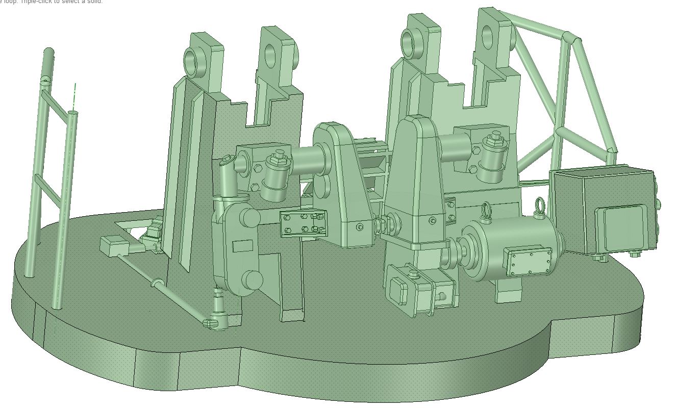

Re: 1/144 Scale USS STODDARD (DD-566) - Kitbash, Revell FLET

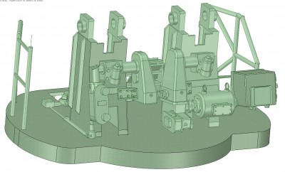

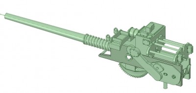

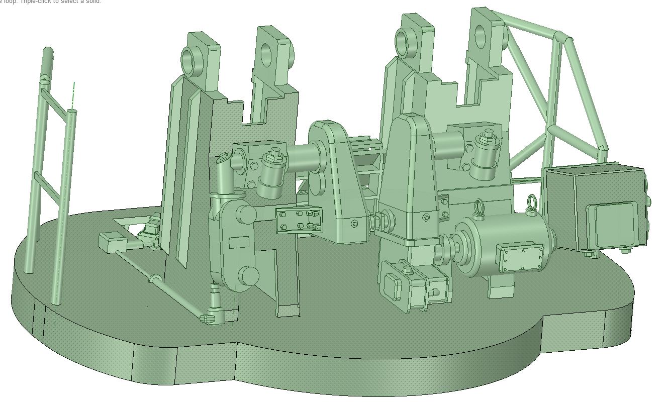

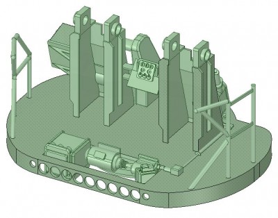

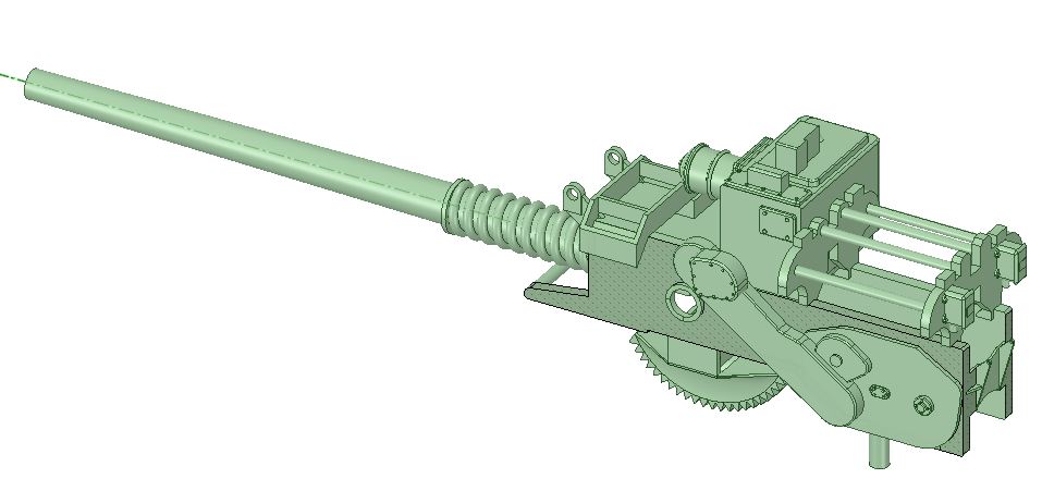

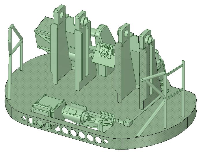

Yesterday I finished the design portion of the 3" gun mount foundation and I now have 2 of these currently printing - so, we'll see what the results are after lunch today. Here are a couple design renderings of the basic mount at this stage:
I'm sure that some people viewing this will think that it doesn't look complete - well, there has to be a compromise of detail and what will print - I think I have that compromise in hand - we'll see
I've tried to include all the important pieces of equipment that make up this very complex unit and making decisions on what to include and how much detail to show - all are considerations.
I have set up the printing file with one piece flat and the other at about a 60� angle to see if both correctly print or one does better than the other, etc. Once I have a successful test piece in hand, I can determine whether the additional platforms (3) and ejection rails will fit and what adjustments may need to be made. After this is complete I will return to completion of the left/right gun assemblies and then the RADAR which was a locally added piece of FC equipment - not all ships were so equipped.
Hi there Hank and all,
Excellent progress so far, and looking very promising for the next steps.
Whatever the process maybe, you are building your own pieces instead of buying a second ship in the aftermarket, and learning a new technique completely --more than I would be willing to do.
IMO, the essence of modelling is to build something that is (a) precise (b) recognizable, and (c) all in all proportionate, and your praphics seem to be all three. I have scratch-built the same thing, three times, and with all modesty, I know what I am talking about, and even in 1/72 it would be no candy to build this.
So Hank keep the good job, and I am really curious to see what comes out of your printer.
Nice going from across the pool,
Willie.
Honestly, I don�t think this will be the case.BB62vet wrote:I'm sure that some people viewing this will think that it doesn't look complete (...).
I absolutely concur. There is a limit even for this relatively big 1/144 scale, and if you are able to actually print the graphics that you show us, this will be a glorious 3/50 mount, and period.BB62vet wrote:I'm sure that some people viewing this will think that it doesn't look complete - well, there has to be a compromise of detail and what will print - I think I have that compromise in hand -we'll seeI've tried to include all the important pieces of equipment that make up this very complex unit and making decisions on what to include and how much detail to show - all are considerations.
Willie.

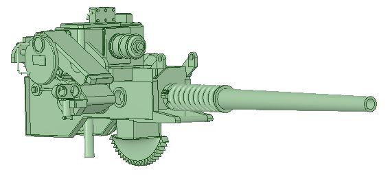

Willie,

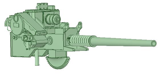

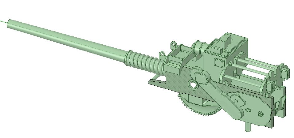

Nice to hear from you again, my friend!!! And thanks!! I've been printing all day and have had various results - I've now got the (what I hope will be) final version ready for printing tomorrow a.m. The next to last version is printing now. Earlier, I did 3 pieces with one coming out acceptable, but it is not a final version part. I will try to post some pictures tomorrow of the final version once it's out of the hopper
I've got further work to do on the gun barrel/receiver assemblies - I've now made separate files for each as they are not the same. Well, they are but have different equipment located on each gun which requires a separate model.
So, hope to hear something new from your build soon, also - fun, isn't it???

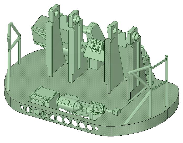

Well Tom, I certainly appreciate the comments!! Thanks!
I was prompted to design a much BETTER part than what I bought in 2017 from Shapeways - it's simply a piece of junk. So, I was inspired to at least try to produce a visibly correct item. So far, it's coming along stage by stage. Viewing Pascal's approach with his various gun mounts and other rather complex parts, I felt that this required several pieces rather than one very busy model which may not even print.
At this point I'm about to print what I hope will be the final version of the mount foundation and then move forward with the individual guns - since neither (left/right) is identical, each is a separate design and will be printed more than likely 100 vertical as other 3D designers have chimed in with advise about orientation. Maybe this week some time!

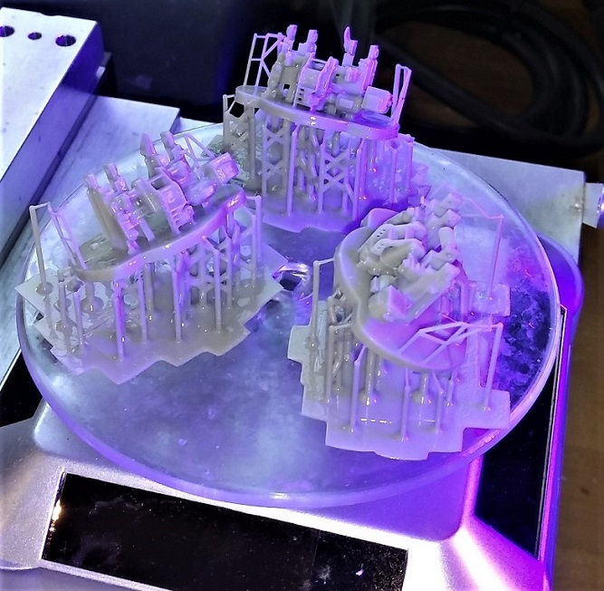

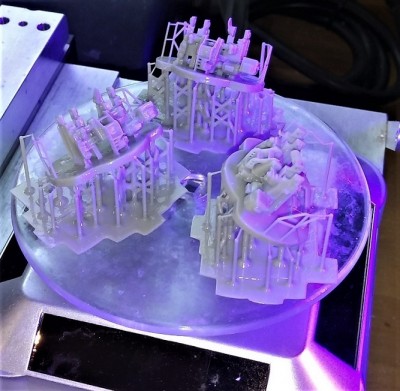

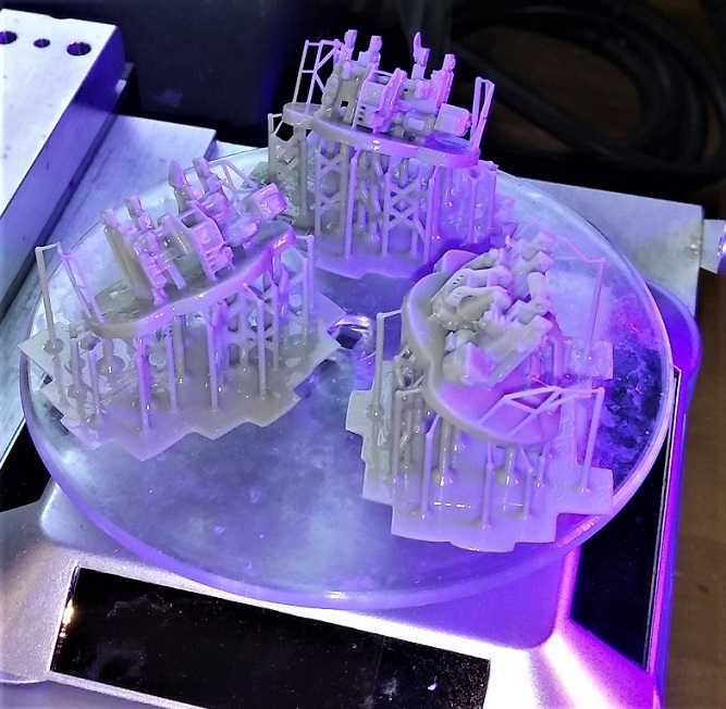

I find it very interesting that 115 people viewed my posts recently, yet outside of the usual gang of pirates (3 or 4 to be exact), no one cared to comment.
Today, after 3 printing sessions being totally unsuccessful, I got a completely correct set of 3 mount foundations and have (due to the earlier success today) reset the printer and have 3 more in progress (spares, etc.). This was all due to the printing orientation of the parts - so, I have to thank Tom F. for urging me to do it "his way" and it worked.
I'm S-O-O-O Happy!!!!
So, after creating a speaking tube this afternoon (tomorrow, I'll print a dozen of them), I'm back to working on the gun assemblies and the Mk. 34 RADAR unit that was installed on the amidships mounts (31/32). Thanks also to Rick E. Davis for providing additional photos for reference. Not a lot of info on this equipment publicly available.
Here is what these mount foundations look like under the UV lamp (sort of like chicks under the hen getting incubated!!!): I'll let these (and the next batch if they come out ok) cure overnight - this'll teach 'em to mess around with a Vet!!!
Nice printing Hank!
However, I find your pieces quite shiny, which is usually a sign that there is still a thin layer of liquid resin on them.
I had this problem at the beginning when I cleaned manually with alcohol. Since I've been cleaning with the Anycubic Wash and Cure machine, my pieces are quite matte after drying and before UV. The details come out much better and you don't breathe in the alcohol as much, it's much safer.
I don't know your procedure, but you can gain in precision by this means.
https://youtu.be/lmJNf5RKKAQ

Pascal (& David P),
Thanks both for the comments. Well, Pascal you have answered a question I was wondering about also!! I had no idea. I wash the parts 1st in a bowl of alcohol, then a 1st water wash, and then a 2nd water wash. I guess I need to use a soft toothbrush and go over each of those pieces to remove that thin layer of liq. resin. I'll also check out the video link you included. The resin I'm using (Phrozen Model Grey) isn't supposed to require the alcohol, but I've been washing them in it anyhow. Years ago (I mean like 1970's ago!!) the company I had worked at had a sale on all their drafting instruments and ultrasonic cleaners (for Leroy Pens) were included. I wish now I'd bought one of them - most of them were NIB, never used. SIGH.....Hank sad.
Well, we learn something new each day - I'm glad that this was pointed out to me. And here I thought the cleaning crew at night had used too much wax on the buffer!!!
The 2nd batch of (3) foundations came out excellent, as well - in fact, they somehow are just a tad bit crisper in detail than those from earlier today. So, I'm now in good shape with 6 useable foundations. Time to get back to the gun assemblies and the Mk. 34 unit.

Pascal - Thanks again for the information and video link. That IS an impressive piece of cleaning/curing equipment - however, I will have to think long & hard before sinking that kind of money into this effort. I will however, make some manual adjustments to how I clean & cure my parts - you've pointed out some very good reasons and also educated me on why this is necessary.Iceman 29 wrote:Nice printing Hank!
I hope to get the parts removed from the supports/raft, cleaned up, and possibly start basic painting and adding the additional equipment - I also drew up the inside foundation hand railings last night and will try printing those in this mornings print session.
You're welcome Hank, prices have dropped since its release and this video, especially since a new, larger model is on sale for large 3D parts.
I don't have any "stock options"in Anycubic, but I don't regret my purchase, I couldn't do without this device now, it would be a bit of a waste of the printing qualities of these printers and the cleaning would be less comfortable.
It is also better to print and clean the 3D piece in a dark place. The polymerization of the thin resin layer before cleaning can be done quickly with very little light, even without sunlight, from the experience.
https://www.ebay.com/itm/ANYCUBIC-WASH- ... Sw~HBgQeQA

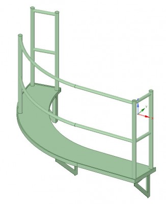

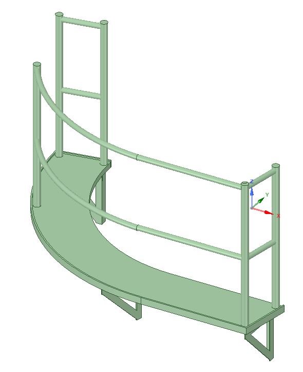

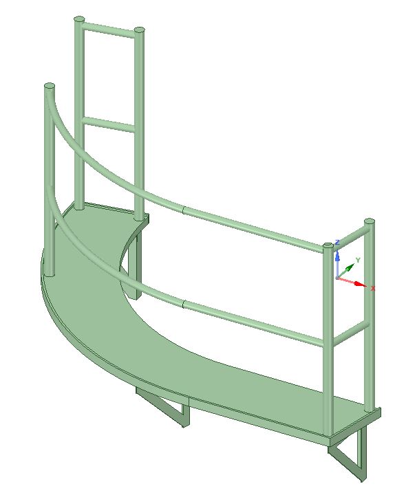

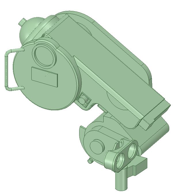

Well, while waiting for the last revision to the Mk. 34 units to print, I discovered a photo of ISHERWOOD that I had and she has an identical access platform on her fwd. stack just like STODDARD's. So, since the BoGP only shows this in elev. view, I make a quick sketch using the kit stack as a guide and created the platform - it's now ready to print this evening:
I'm now starting on creating the antenna wiring box that resides on the side of the stack - it's where all the connections & so forth for the stbd. whip antenna are located. All of this equipment has to be made by hand - or 3D designed. I've already done all the whips. Whip it, Whip It GOOD
- Posts: 5068
Looks good Hank! As you know, being able to print the rails right with the platform is a major frustration saver. Perhaps the most difficult thing is getting the exact curvature of the stack. I did (re did) the searchlight platforms for Alaska but those were luckily against flat bulkheads.
- BB62vet
- Posts: 3145
- Location: Mocksville, NC
Tom,
Well, thanks again!! actually, the platform and conn. box are currently in the printer, due out at 1:30pm today. I resized the stanchions/handrails a bit thicker and also scaled up by 0.06% to see if Pascal's calculations are correct. The failed earlier print yesterday did look to be a bit smaller than I designed. So, we'll know shortly.
I oriented two of the platforms in different postures to see which prints and so forth.
- BB62vet
- Posts: 3145

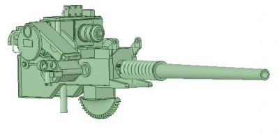

Today's printing (4 times) was a bust - for various reasons that only the 3D resin gods understand, everything had either incomplete parts, or failed to print. So, during these printing sessions I was busy working on finishing up the left/right gun assemblies and this was no easy task. The right gun on the dual mount has the Sight Setting Station which was a b-i-a-t-c-h to design. Here is what I came up with and the final result added to the assembly: (and DON'T ask how I got the elevation gear teeth - that's confidential and no one has clearance to know!!!!)

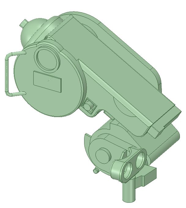

This has taken at least two days to draw up (sight setter). Then, I added a mounting bracket from the left gun and this unit is ready to print. Here is a shot of the left gun:
I have in hand now 6 useable Mk. 34 RADAR units to add to the inside gun on the amidships mounts so those are not part of this assembly. I don't currently have a photo of this equipment that is up to date.
So, taking advice from Monkey Man and Iceman (we sure have a strange assortment of modelers in this crew, don't we
!!) I will make sure the gun assemblies are oriented vertical and hope that the resin gods are in good spirits tomorrow
