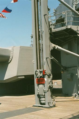

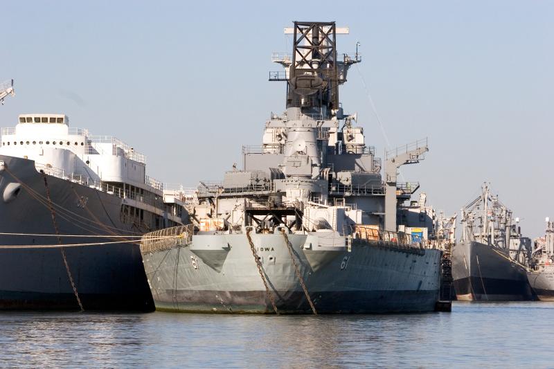

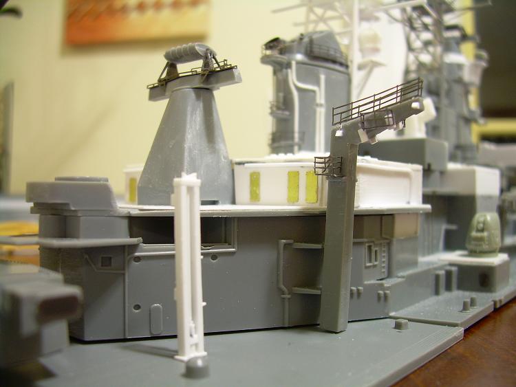

By king post, do you mean the "7" shaped thing with hoses at the starboard-rear of the rear superstructure or the vertical rectangular things between the funnels of the Burkes?

Timmy C wrote:By king post, do you mean the "7" shaped thing with hoses at the starboard-rear of the rear superstructure or the vertical rectangular things between the funnels of the Burkes?

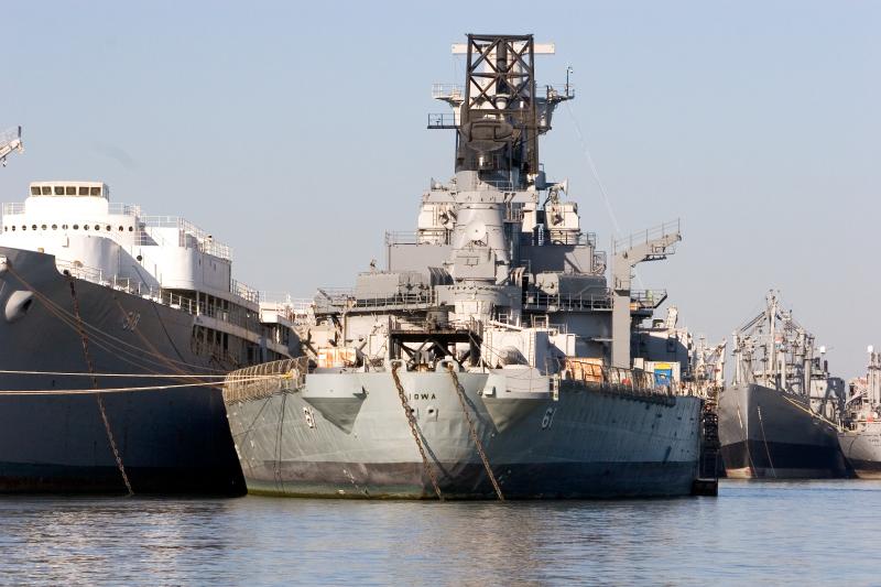

What in the world are you talking about, Timmy? Smoking a little, are we? :big_grin: But seriously, the Burkes have what is below between the stacks.

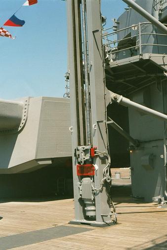

They are tentioners that support and keep the high-line that the fuel line comes over on tight when you are receiving fuel from someone else.
The large "7" looking things are used for when you are giving fuel to someone else.
In the above, you see the "7" thing on the right side of the ship. This was how the battleships filled the mission of "refuling its escorts". They used their capacity of 2.5 to 3 million gallon fuel capacity to refuel its escorts in addition to itself! If you examine the LHDs and LHAs also, they have one on the outside part of the island structure. AOEs have so many they look like spiders!
It's cool this stuff.

So which one is the kingpost, or is that something else entirely? Haha.

Timmy C wrote:So which one is the kingpost, or is that something else entirely? Haha.
The Kingpost is the tensioner, not the "7" arm.

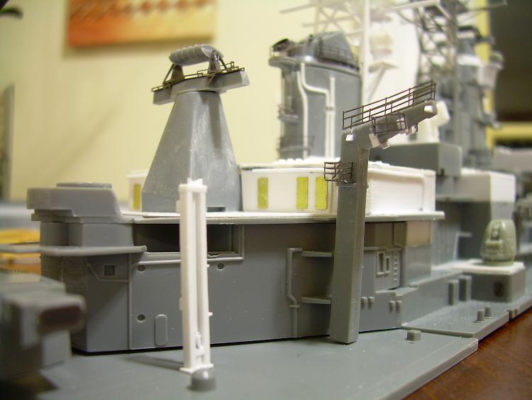

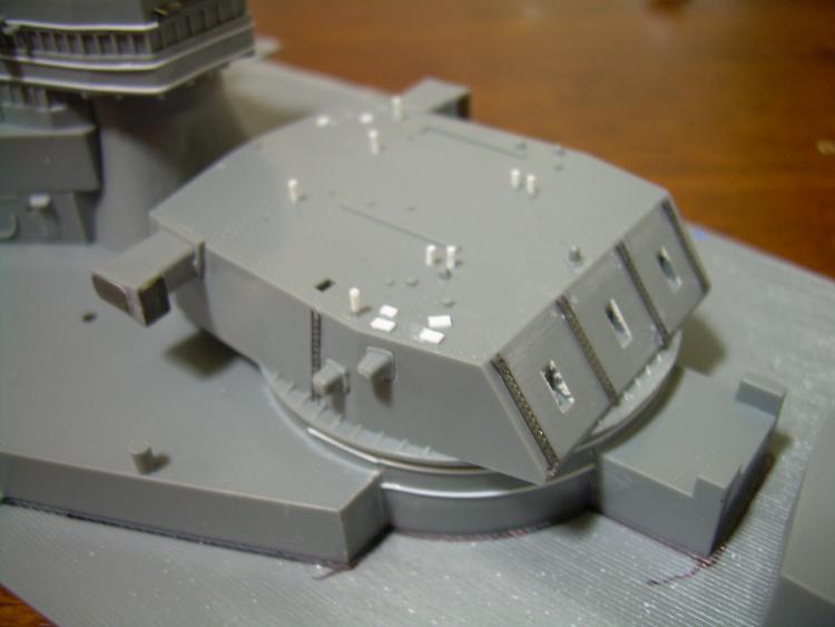

Hi, guys! Here comes the result of the last week! LONG! It take so long to do this stuff! Oh my GOSH!

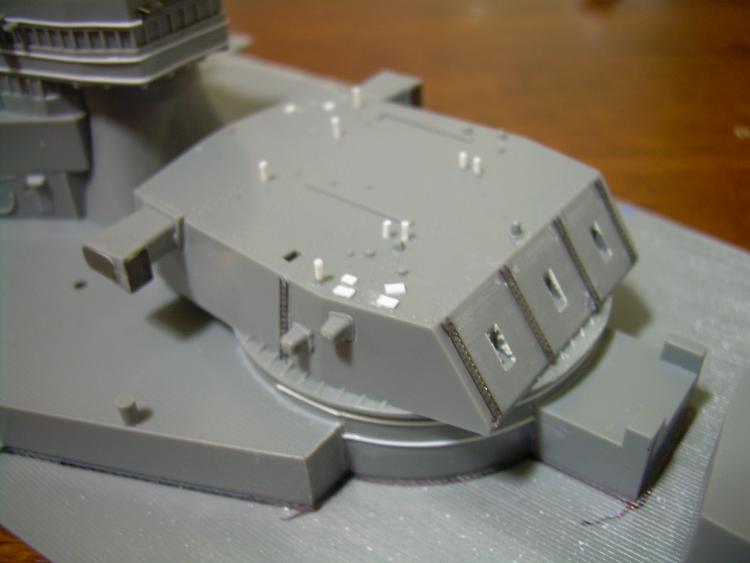

Below: The turrets on all four battleships have different parts and pieces on top of them. The only commonality is the original design. Vents, cleats, replenishment frames, periscopes, I mean, there's all kinds of different stuff, so here, on Iowa's Turret 2 and Turret 3 tops, I have made some mods to make them more accurate.

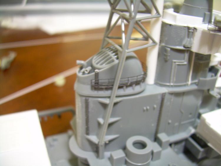

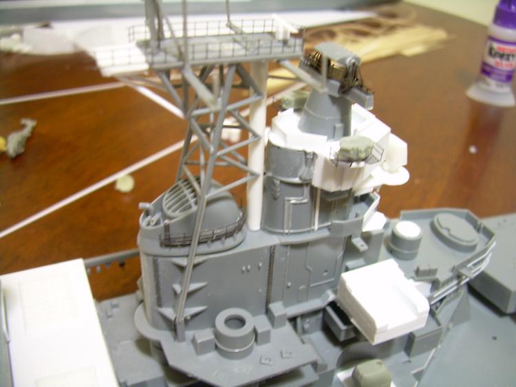

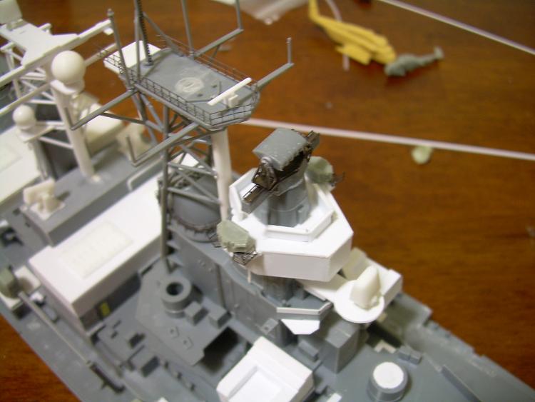

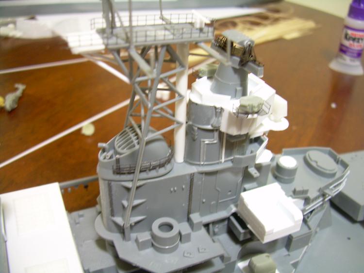

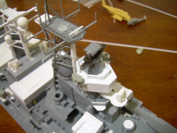

Forward mast with and 18' SPS-67 ( :o ), FC director detailings, SLQ-32 (V)3 I believe and some of the aft stuff.
The extension on the forward mast can be seen here. This extension on the mast is on Wisconsin. I have been told it was built with the TAS23 rotating antenna that was part of the Warfighting Improvement Program authorized for '93 in mind. Instead, it's going to be for a SATCOM dome associated with badassery. Ladders...and look at that forward director! Man, what awesome detail!

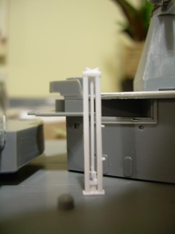

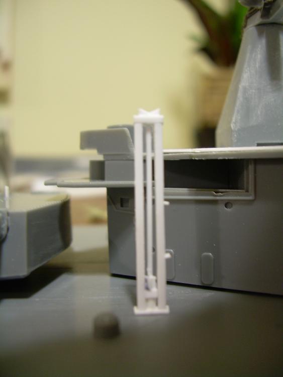

Here's the tensioner used for keeping the high-line tight when your ships is taking on fuel I was talking about, the King's Post if I am not mistaken. All SCRATCH and all night long it took me! Scaling it was a problem, but I got it right.
Here's the entire refueling station.

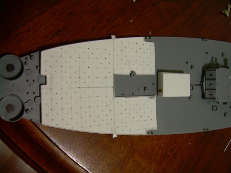

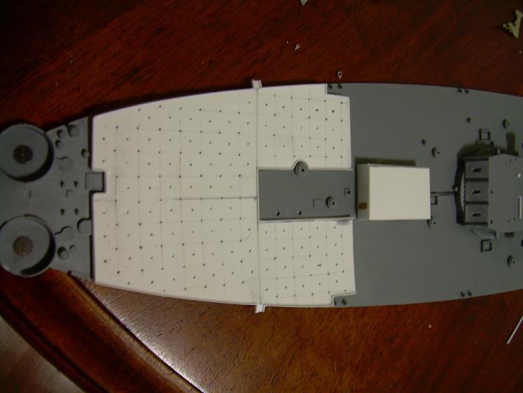

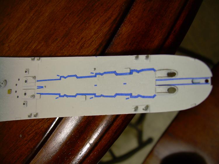

I first marked with sharpy and then pressed in all the little pad-eyes on the helo deck.

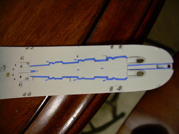

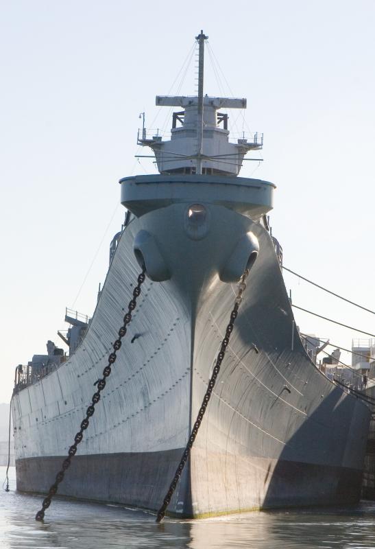

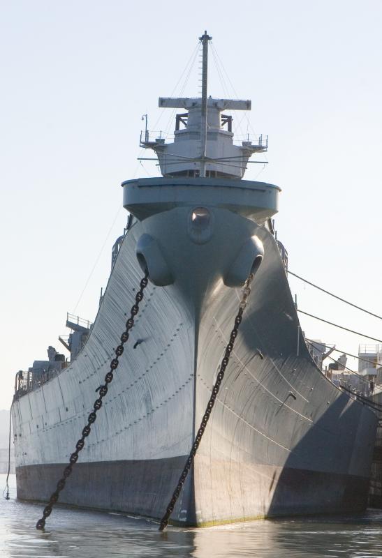

And the bow. Iowa had all kinds of markings on her bow. One of them was a white out-line of the diamond grate that the anchor chain sits on...so the anchor chain plate? Anyway, since the lines are so thin I figured the best way to do this was to spray the white first and mask the design I wanted and then lay the next series of colors down. I have to keep the paint thin so it does not stack up and look layered.

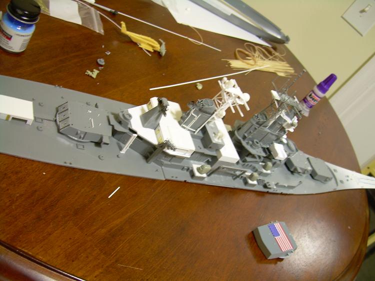

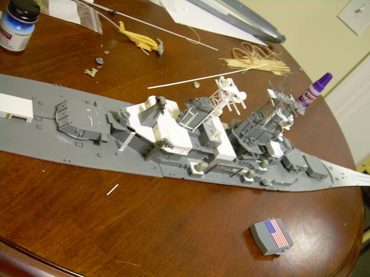

What's this?...an extra forward turret...with an American FLAG ON IT?! What is this?!
Nothing says, "My manhood is SHOCKINGLY huge" like an enormous American flag on top of a 16" gun turret!

Mmmmmmmmmmm pad eyes!!! Looking awesome! Make sure that flagged turret makes it on the ship and isn't left on the pier :big_grin:

I hope that flag isn't glued on, because I think it's flipped horizontally ;) Although it seems that's your fourth turret, so it won't be any problem to make a corrected one.
Here's Iowa's for comparison: http://www.navsource.org/archives/01/016196.jpg
Otherwise, looks awesome!

Muahuhuhu! Good eye! I was wondering how long it would take for people to notice! Not long, my wheelchair-bound friend.
I have been looking for an appropriately sized flag for a long time, and I finally found one, it's just a really thin sticker for Pinwood derby cars instead of a decal. So, to test it out, I cut out the opposite side and stuck it to the top of an extra Turret 1 I have to see how it looked. It fits well, but the rivets underneath offer a challenge. I would prefer a decal instead. So, either I will use the correct side (star field on the left), I will come into possession of a decal, or the turret won't have a flag on it. The flag was a late '80s thing anyway. They might not even keep it if the ship were reactivated.
Now, Dunagain seems to be out of print. If there is anyone out there with one of the Dunagain sheets for the Iowa-class, I would be interested. It has Iowa's flag on it and all the appropriate markings, awards, etc.

I like the Iowa-style flag on the turret. I wouldn't worry too much about being to pretentious with a big American Flag, after all, one of the non-quantifiable assets that the Battleships brings is psychological belligerency - and the big ass flag plays into that very well.
