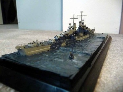

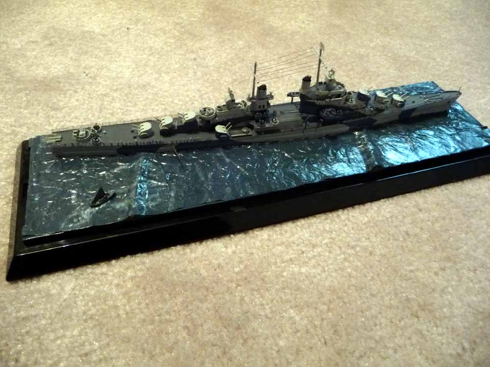

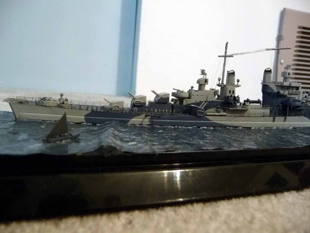

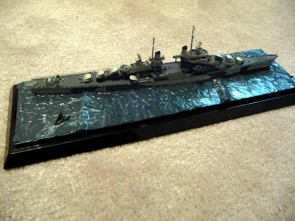

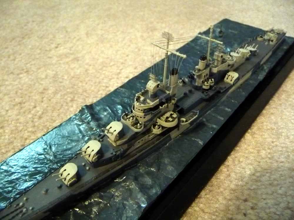

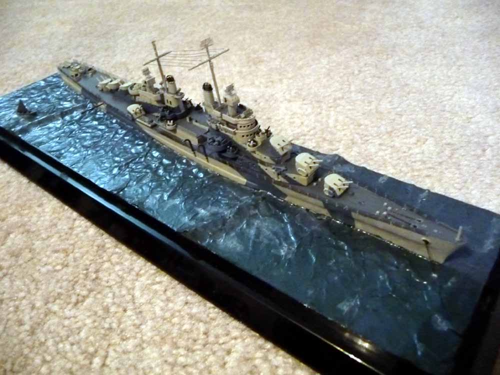

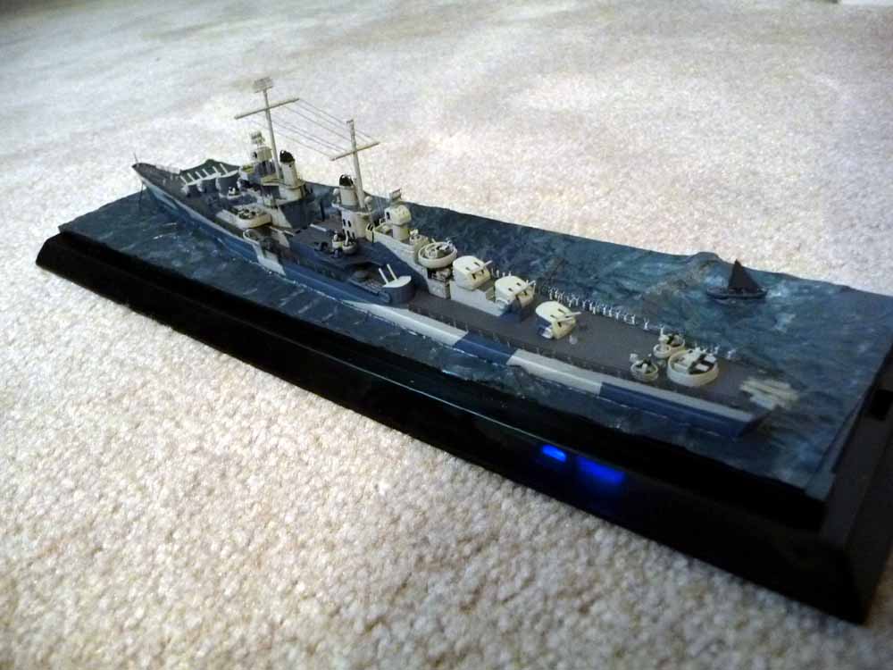

San Diego was finished yesterday at the last minute before leaving my house to hand it over. Some quick shots below - was not very happy with the rigging. The sagginess of the middle 4 horizontal runs was the result of the outer runs being pulled taut (the outer ones being the ones done last).

Hey Timmy, what was the rush to 'handover'? BTW, excellent job on build.

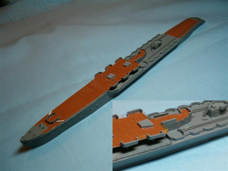

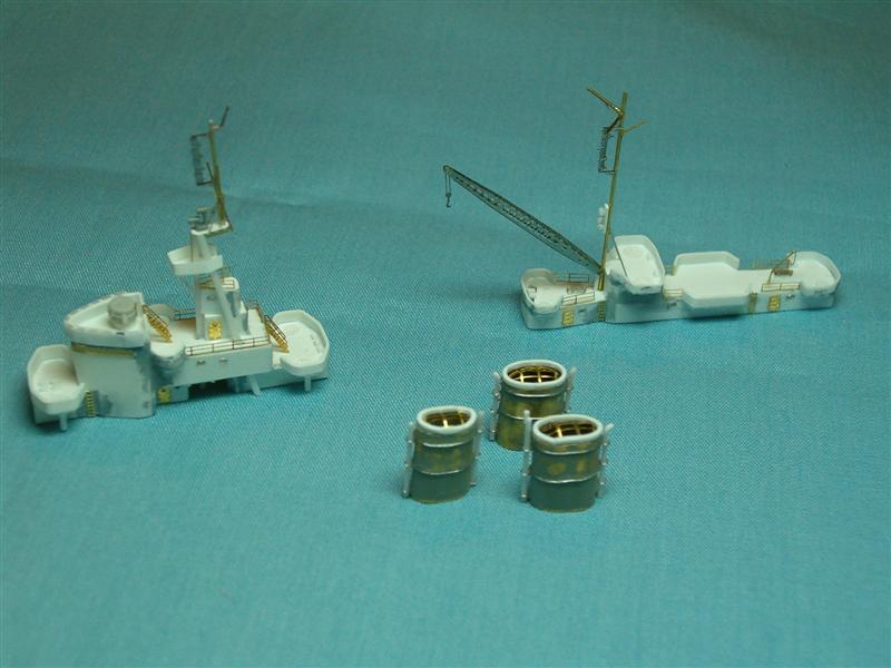

I up'd the pace a bit today and have completed all the major structures (except the mainmast) and some of the deck detail. Secondary guns, mainmast,rest of deck detail and rails tomorrow.
Scott, great bit of scratch-building. I sure wish somebody would release a few of the maru's in 1:350.

Thanks Kym - it was meant as a New Years/Christmas present so had to be done by the 31st.

Timmy I love the water...

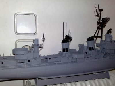

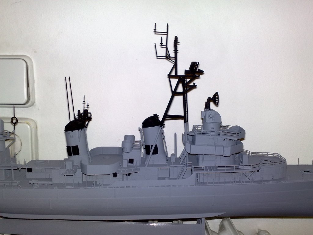

Now it is time for my update...
After much research and thinking and scheduling I decided that if I wanted to build a Greek fletcher right out of the box from the Revell Zerstorer kit it could not be HS Velos, that I set bout building at first. So after a little research I came up with two possible ships, both of which were ex German fletchers that where sold to Greece right after their lease ended. Those two ships where DD 500 USS Ringgold and dd 516 USS wadsworth. They became Zertsorer Z-2 and Z-3 consecutively, and right after they became HS Kimon D42 and HS Nearchos D65.
My main problem with this choice is that I will have to paint the decks, which was not planned at first and that I do not have the decals for the pennant numbers, but I will think of something...
Here are some pics of what I have done in the past two days:
The whole ship has been primed and painted grey and I also painted the vents black, as well as the funnel caps, the main mast and the directors antenna, as indicated by the usual painting practice of the Hellenic navy at the beginning of the '80s... The deck retained its German colour... That will be painted with Humbrol enamel No 27 (sea grey)
Alec... Practice makes perfect.... The weathering is supeb, as well as the pe work... A really impressive result....

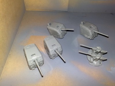

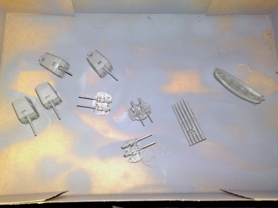

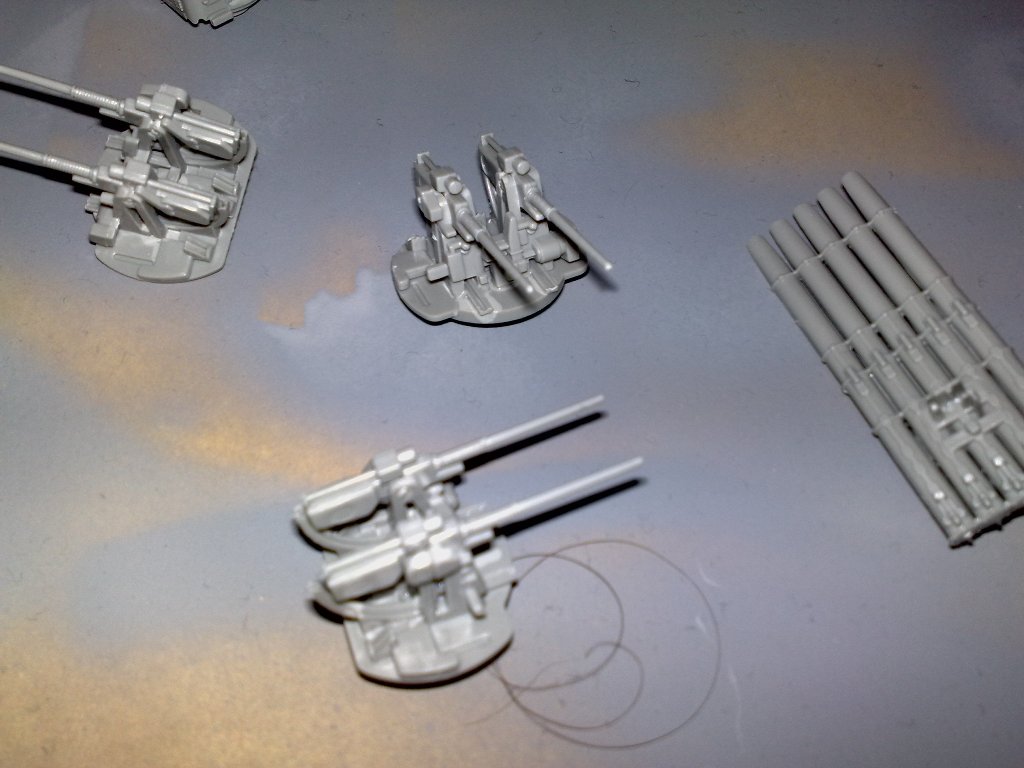

the most tedious task of the build is placing the rails. I have added them prior to painting, as I wanted to use liquid glue for plastic in order to ensure a more permanent and tighter fit. It took me about four hours to install them all, but the result is really satisfactory... Do not ask me how I am going to put the black nylon thread...
I also assembled the main guns, the 3" dual mounts, the torpedo tubes and the ships boat:
Close up pics of the main turrets and 3" mounts:
I hope to have painted them by midnight today...
Greetings from
Greece and happy new year to all....

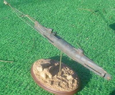

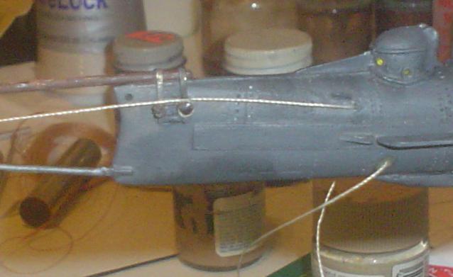

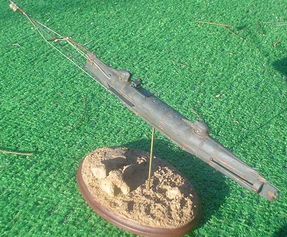

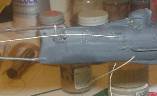

More work on the Hunley. Spent time reading and working with a couple of CAD artiest on the spar rigging. I was trying out some ideas they had on the spar, most of the drawings looked good on paper but didn't work out so well on the model. A lot of talk has been going on about the pad eyes and how they were used for the spar. The first picture was one idea that was proposed.
Like I said it looked good on paper but failed to keep the spar from oscillating. Then it dawned on me to use a yard for support. So I made a yoke that could be added without any trouble and bingo it worked.
I'm working on a paper that will give the details of how it works, and of how the spar was moved up and down by Lt Dixon on his finial mission.
For the boat details I used the laser scan and xrays taken of the boat in Charleston.
As far as I know this is the most accurate version to date. No one knows for sure how it was rigged, but based on the evidence so far this maybe the most plausible.
Whatever the outcome I spent 3-4 days of research to every one day of model building., the kit was easy, but the study was by far the most fun.
I hope to have better pictures for you soon, but these were the best shots I could get to you for now.
Nice work Alec and Kym, you guys are the bomb!
