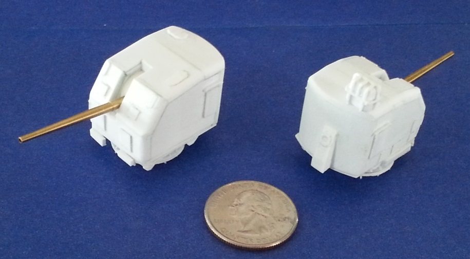

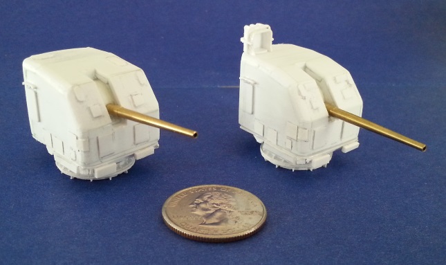

Thanks for the comments! Hope you have all been well. Back from the dead and work resumes.
Here are some photos of brand new turret masters made from more accurate drawings (from Floating Drydock, of course).
- 5in.01.jpg (24.6 KiB) Viewed 1800 times
