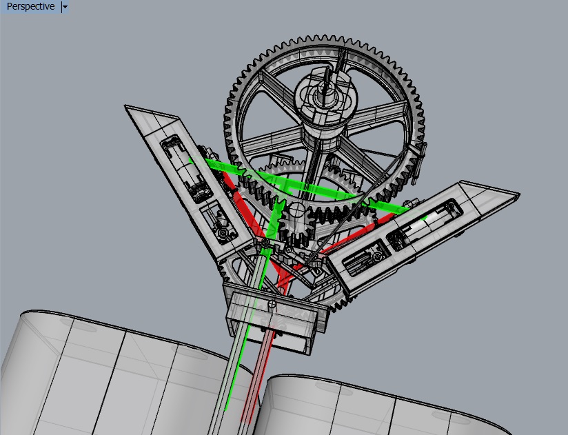

Michael,

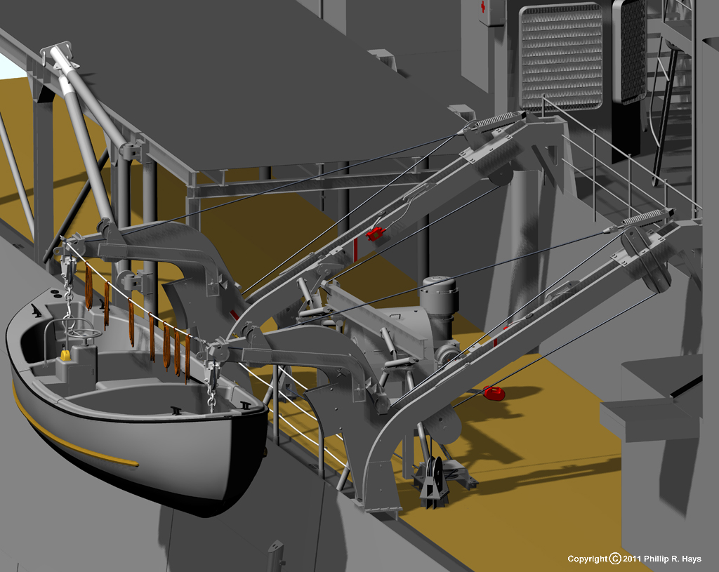

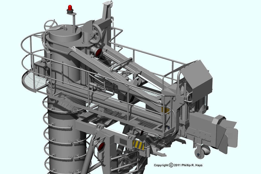

For my full ship CAD models I cheat a lot on things like threads. With file sizes approaching a gigabyte without putting threads on all of the thousands of bolts, screws and nuts, it is totally impractical to include threads. However, I don't want these things to look like plain cylinders on not-too-close inspection. The same is true of cables, wire runs, etc.
My solution is to use 8 and 12 sided "cylinders." Again, these are only in places that aren't visible close up in the images. It is amazing how much an 8 sided "cable" looks like a twisted wire cable, a life line or an electrical cable run when viewed with shading from a moderately close distance.
Here are some examples. All of the cables, wiring, life lines and ropes are 12-sided extrusions. This produces a much smaller file size increase than an extruded circle. None of the bolts have threads.

Makes a lot of sense, Fritz. If the safety valves started blowing off steam in rough seas, it would affect not only the main engines but also the blower and other auxiliary engines. Could be if the USS Monitor had used spring loaded instead of weighted safety valves, she might have survived Hatteras.
Phil, many thanks for this technique. I thought a cylinder, because of its simplicity, would burn less memory. The octagon effect is intriguing and your wiring as I have often noticed, is phenomenal.

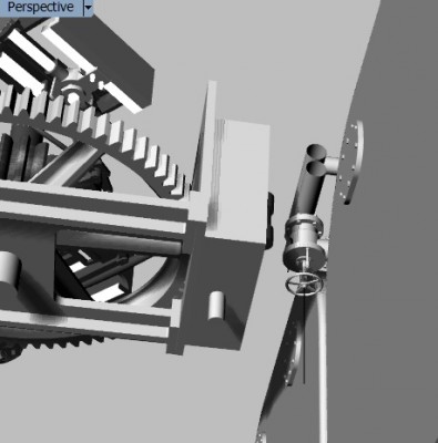

Now we are into the problem of plumbing the turret engines. Here is schematic representation from the Swedish museum overhead view, superimposed on the 3D model of the engines and gearbox. The green is low pressure, exhaust steam. The red is high pressure steam from the boiler. What we can learn from this is just that the drawing is a schematic, not a pictorial. It shows short, direct paths that can be drawn with a pencil to indicate where the steam comes from and where it goes. The practical problem is that these lines run, for examples, straight through the crankshaft and the main spur gear. The real piping configuration must be different -- longer and more curved, probably flanking the gearbox and then looping down to the engines.
We have a couple of other clues.
One is the fanciful Harpers cartoon: This shows what might be an intake conduit running outside the gearbox, high on the port side, and a couple of goofy, swoopy pipes running down to and converging at the level of the steam chest of the port side engine cylinder. This cartoon is very little help except that it gives us a real world artist's subjective impression -- he was in the galley, and he actually saw the thing.
The other image is the photo of the turret engines of the Comanche: The photo shows the intake and exhaust pipes doubling back in 180 degree curves from the steam chest. The other cylinder follows the same pattern.
In trying to work this out I will take the initial approach that the steam lines run above the engine, at about the same vertical level at which they enter the galley. Another option would be to route the steam pipes down underneath the gearbox, but I think this would take too big a bite out of the crews' space -- notably that of the cook.

I should have said that the eight and twelve sided "cylinders" use less memory in the program I use (DesignCAD). It is not a parametric CAD program, but works like AutoCAD in generating a what-you-see-is-what-you-get drawing with all surfaces generated in the file. This may not be true in other programs.
For simple objects a true cylinder may use less memory. But when a circle is extruded through a curved path (like piping, wire runs, ropes and cables or life lines) the result is not a cylinder, but an object with complex curved surfaces. The program generates a series of intermediate "slices" along the curved path and patches these together with some number of planes to create a grid surface - so it really is not cylindrical. The default for DesignCAD is to put 120 planes around each section, and to put 100 sections between each point defining the curve - 12,000 planes between each point!
To illustrate the problem I once created a simple hand railing for an inclined ladder by extruding a circle along a curve using the program defaults - it added 13 Mbytes to the drawing! This was a long time ago on a machine that could work with drawings no larger than about 40 Mbytes - only three hand rails. That was when I learned to pay attention to file sizes. I redrew the hand rail using cylinders for the straight sections and swept 36 sided polygons for the curved parts, and it added only about 12 Kbytes, or about 1/1000 the memory use of the original, and looked just as good.
You can reset all of the program defaults to something sensible like 36 planes and 5 sections, or 180 planes between each point on the curve, and it will use 1/66 as much memory. Even this is just too many planes in drawings with dozens of cable runs. The defining curves for the cable extrusion will have dozens of points to get them to wrap around, through and over all the other stuff. For these I use 8 planes and one intermediate slice to get only 16 planes between each point. That's 1/750 as much memory useage as the default values.
For pipes I normally use 36 planes and 1 to 5 intermediate sections. Where cylindrical objects will be added or subtracted to create "T" and "Y" shapes and such I may use even more planes (up to 72) in order to get smooth joints.

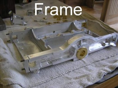

The bearing type that seems most pertinent to the turret mechanism is a split flanged bearing. In the case of the turret engine crankcase this is a conjecture -- we have no very informative drawings. In the case of the gearbox it is pretty definite, since a split flanged bearing was clearly identified by Rich in a Stevens collection drawing.
Rich created a number of split flanged bearings for the main engine, as shown in this photo:This photo of the engine frame, with two bearings installed, suggests how the bearings were secured.Photos reproduced permission of Rich Carlstedt

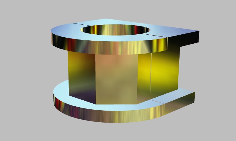

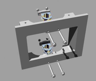

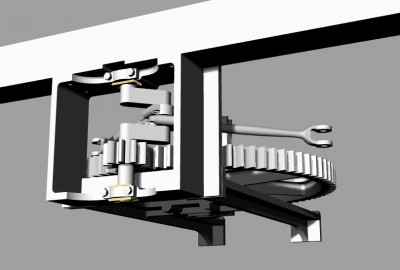

With the bearing type understood, it was possible to model a more realistic crankcase. Here is the casting.The split flanged bearing looks like this:Here is an exploded view of the assembly, looking forward.And looking aft:Some bearings of this type used caps secured by studs, with the studs immobilized by wedges. Rich suggested that these caps should be secured using though bolts, which had greater strength than studs in that era. These bearing caps take significant loads from the engines. Here is the finished crankcase:The deck beam from which the crankcase is suspended has been milled to make room for the flanged bearing. Still to be added are four lock washers of an unusual type. Here is the unit shown in the context of the gearbox frame.Many thanks to Rich for his time and patient help in solving this. Michael

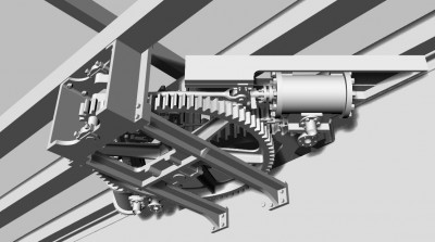

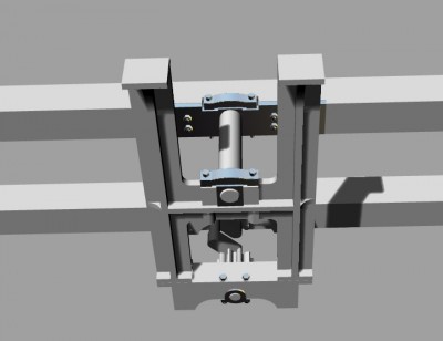

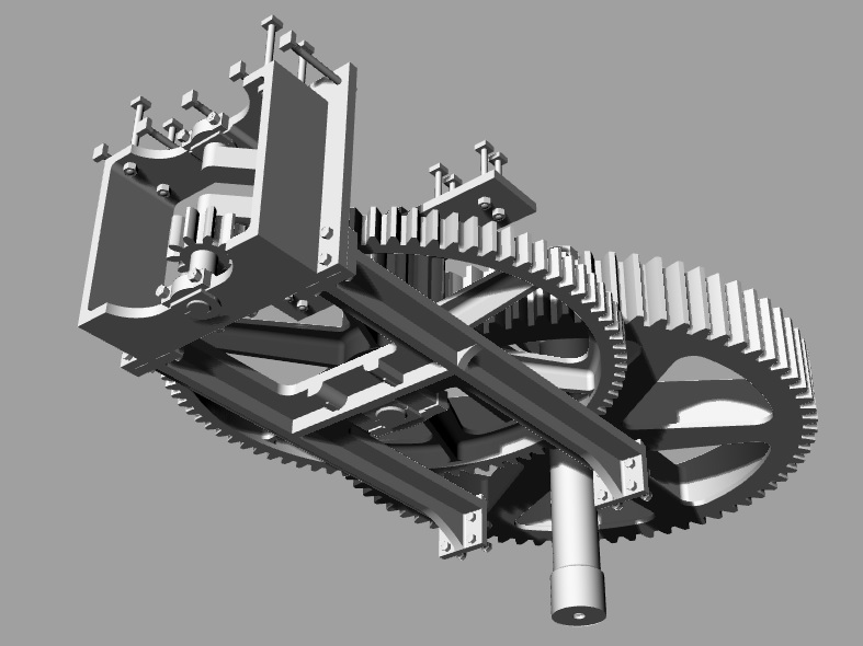

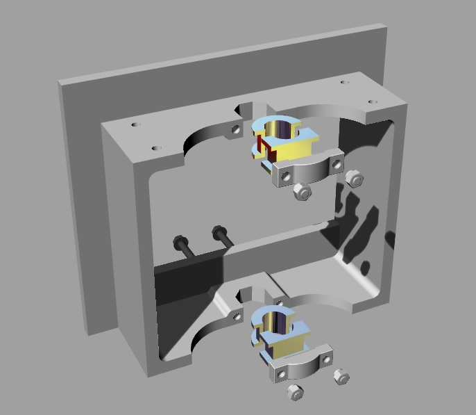

The next bearing problem is the gearbox. The crankcase and gearbox were suspended from 10" x 10" overhead deck beams. Here is a view of the gearbox from below.The lower bearing takes the weight of the shaft, spur gear, and a large pinion. The mounting for this bearing is straightforward. I put crossmember under the bar of the "H". I am not finding it in drawings but I think it needs to be there. Conjecture.
The upper bearing takes no weight, but it does take loads from the accelerations and decelerations of the gear train. It is assumed that the upper and lower bearings were identical split flanged bearings. The drawing for these is from the Stevens collection.

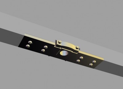

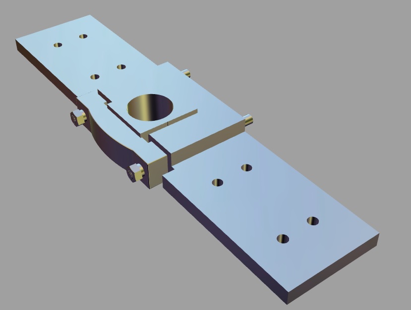

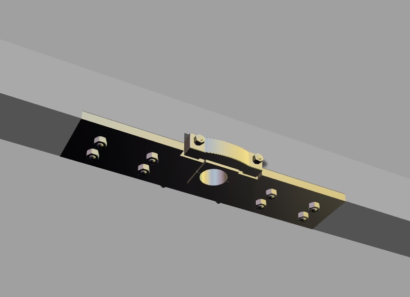

The upper bearing was mounted into the 10" square deck beam. Here is my guess at how it was done.The split flanged bearing was mounted in this casting. The casting was mortised into the oak deck beam and bolted through it. The casting is 1.5 inches thick in the wings, and twice that deep in the middle where it supports the bearing. This technique of mortising and bolting castings and oak is consistent with several other structures, most notably the through-deck casting for the turret shaft.This image shows the gears mounted on the shaft. It occurred to me to use an "L" for the casting, to provide greater strength to the beam, but since I am guessing I am inclined to keep the structure as simple as possible. Detailing, adding in nuts and bolts. Admiral Porter, when he inspected the Monitor under construction, called this machinery "the coffee grinder." Here it is with the engine restored. Changes to the crankcase and gearbox are complete. It should now be possible to get back to the problem of running the steam lines. Michael

Hello Cliff,
This is one of the early experiments in animating the gearing. This is the final stage of the turret drive. The basic problems I am working on are meshing and synchronization. The spurious "hitch" occurs when the gif video loops. Michael

Cool! Is that an actual physics simulation of one gear driving another, or is it synchronized motion of the separate gears?
mcg
- Posts: 201
- Joined: Thu Apr 28, 2005 8:46 pm
Re: USS Monitor turret drive machinery
Hello Cliff,
Bongo's authors are quick to point out that the program cannot "do physics." It is more of a curve follower. However, given a gearing problem, the program seems to me more than just an animator. It does the math. It works from the ratios of the tooth counts to achieve synchronization. You key in a little equation, and from that point synch is assured.
Precise meshing, however, requires that you rotate the gears "by hand," zoomed way in, to achieve an intial mesh. It will then hold the mesh. To be candid, this drive gear is probably the easiest thing to animate in this model. The motion of the twin engine's valve gear is a bit of a head breaker. Michael
