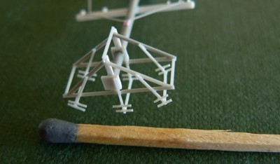

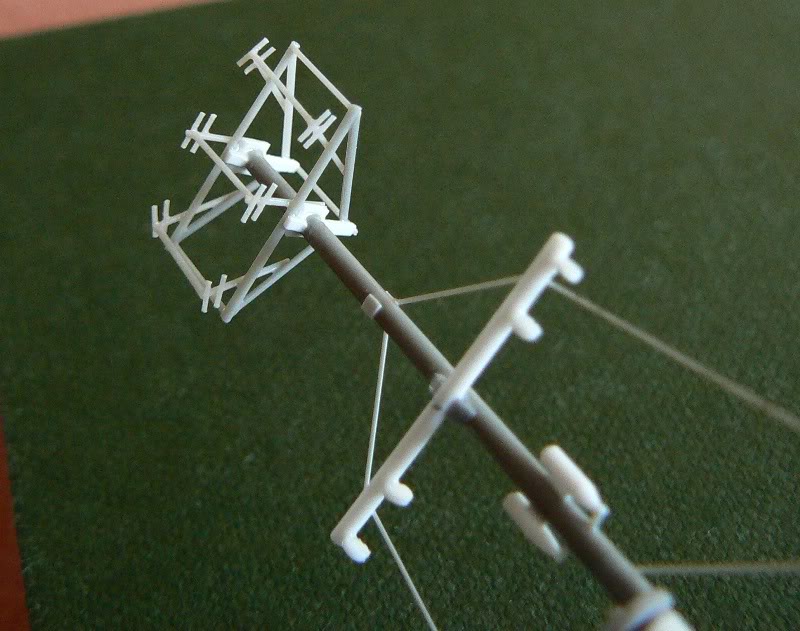

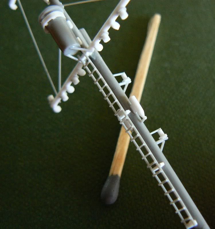

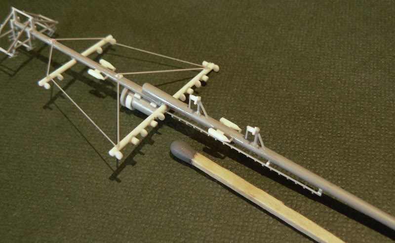

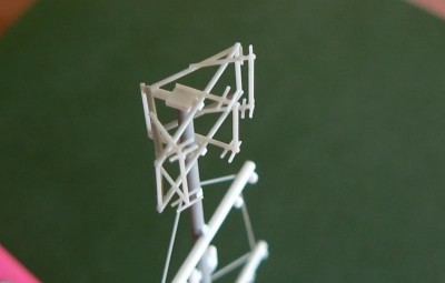

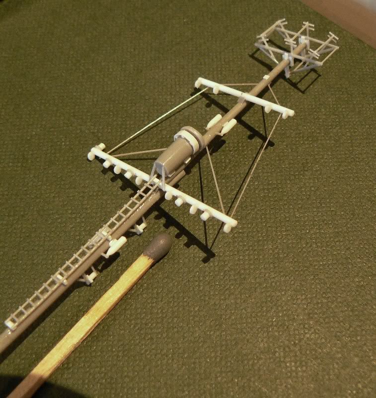

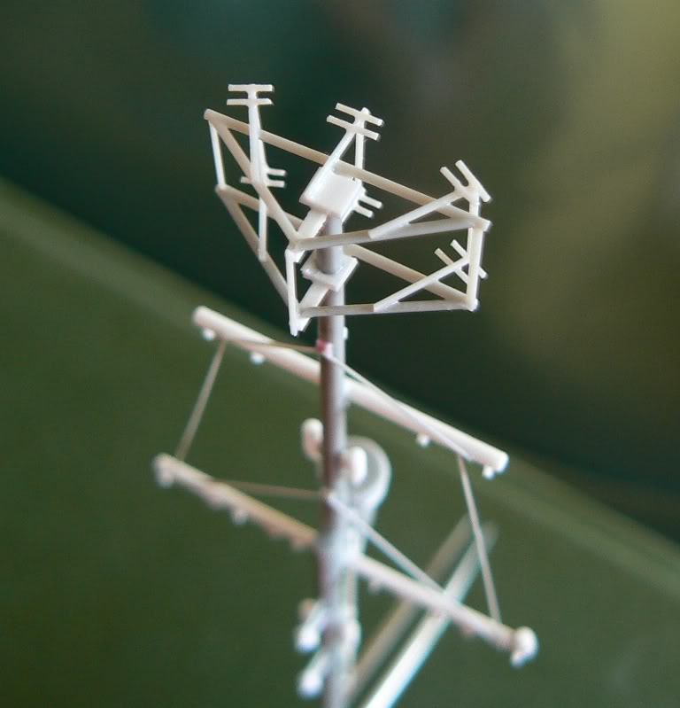

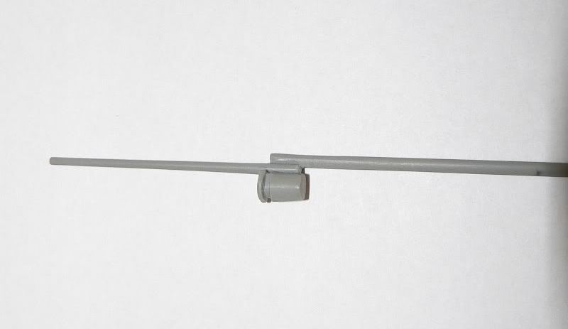

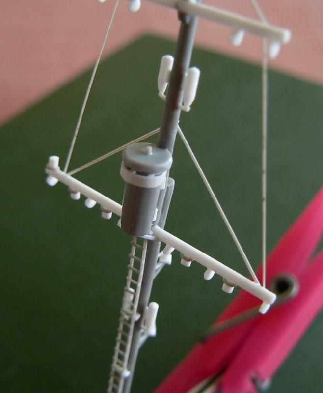

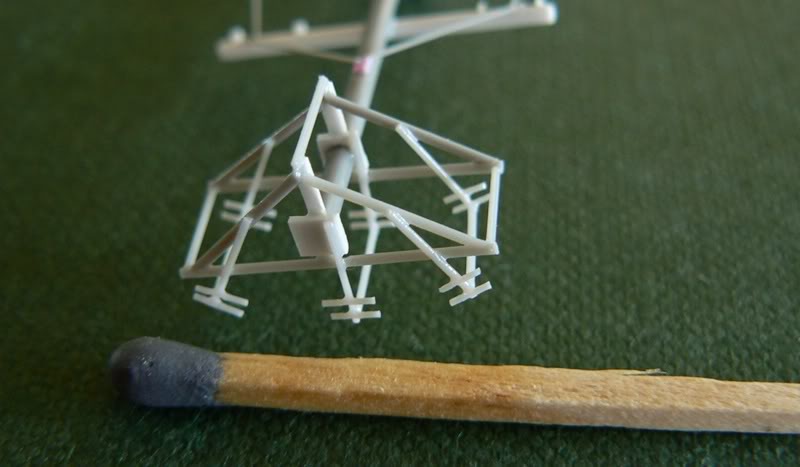

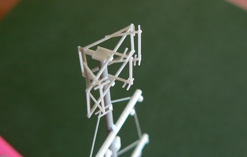

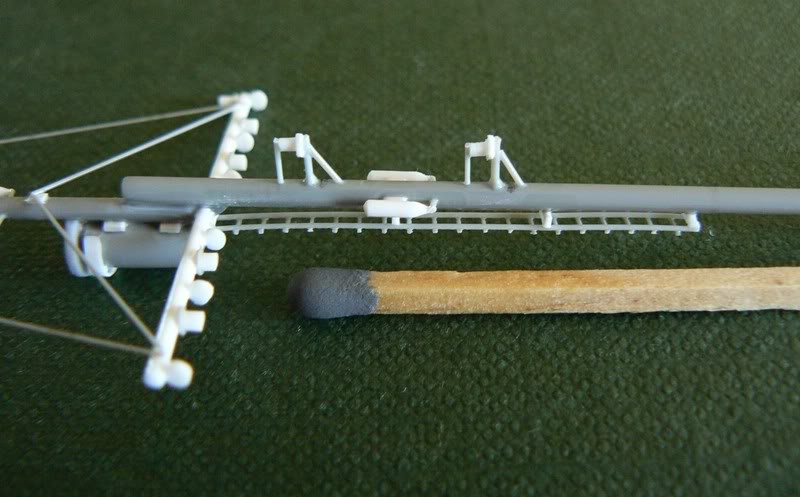

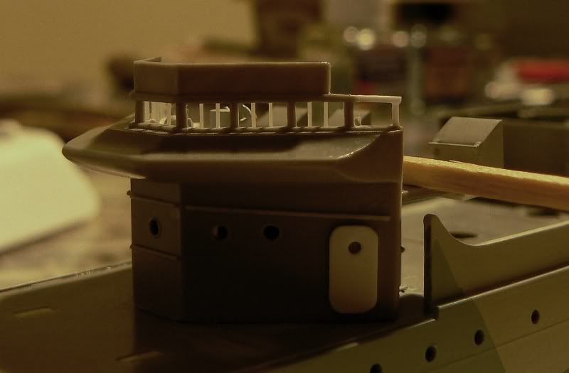

Hi all,
Yesterday and today I was busy with the main mast, someting that gives much life to a ship, and adds a big deal in realism.
The mast that Revell offers is not too good -- the crow�s nest in too low and is far too thick. Here you are two general views of the new mast, fore and aft : I was trying to use the crow�s nest anyhow, but it was not too convincing. My grandfather used to say, things should be well done or not done at all, so I removed it altogether, and made another from scratch, with the wind deflector and all the trimmings. It looks like this now, in its correct shape and thickness : The new mast has all the lights, that have to be painted yet, and all the trimmings to place the signal flags halyards. All the additions to the original mast were made with stretched sprue and Evergreen rod, both in slices, little cylinders or carved with an X-acto.
The radar that HMS Campbeltown had in late 1941 -- more or less the period of my model -- was a mod.286, that had to be made from scratch using stretched sprue as well. I hope you like it, and very best regards from Spain,
Willie.[/size]
Willie.[/size]

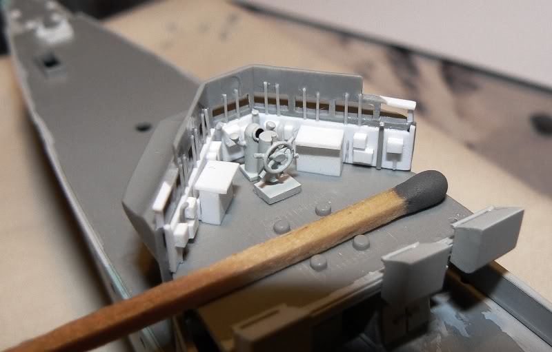

Hi all,
As I was preparing the mast for the fix rigging, I thought that the inside of the bridge was somehow poor in detailing, I mean, it has all the outer details, as can be seen in other pics, but lacked some interior equipment.
The bridge is partially covered but both sides are open, what means it is partially visible too. I thought it could be improved, so I have added some elements, eg., voice tubes, telephone boxes, lockers, boxes for binoculars and so on. Now it is a bit more realistic without having taken a big effort. All elements but chart tables, compass and wheel are of course completely invented, but this is not too important as they are not very visible either. As can be seen in the previous pic I have completed the window gallery with plastic from a yogourth container and I have also added the sliding windows, which give the bridge some expression, to say so. This is obviously very subjective, but I have always thought that the bridge windows are something like the ships' eyes.
Seen from outside, some inner details can be also seen, and this also gives the model some added realism as well. I hope you like it, and very best regards from Spain,
Willie.[/size]

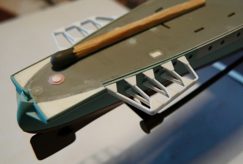

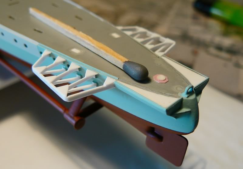

Hi all,
The propeller guards have been quite exasperating to make, as they had to be placed on the stern that is already painted, without putting too much glue and spoiling the paintjob --and painting this hull was a kind of nightmare this time-- and without putting too little and letting the pieces fall after the slightest pressure or simply because of gravity
They are made with plastic from a yogourth container as Evergreen stripes are too thick even in the thinnest caliber that they offer -- or that I have...
Each triangle support should have two holes drilled in the side that is closest to the hull, and each support should have another triangle attached to the hull in the base, but honestly, I lack the ability to make these fine cuts without letting the whole lot look like made by Fred Flintstone.
I have tried to reproduce Guido�s fine work upper in the thread, but no way.
I think I will have to imitate the drills with a ink point done with a 0.1 mm Staedler technical pen, and it will have to suffice ...
