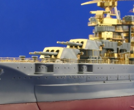

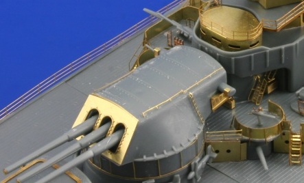

Yes, the glacis plates were modified in the 1929-31 modernization. Different outlines are shown in Paul Stillwell's "Battleship Arizona" book in the rear plans drawn by Alan Chesley.

Re: At 'Em Arizona Fans!
Ah Tracey , you even know what they are called ! great . I was looking at the Edward set photos and the "glacis plates " in that set look right for the early version (1916/1917 ). The whole turrett will need re-working , but I might do one and mould the rest.Tracy White wrote:Yes, the glacis plates were modified in the 1929-31 modernization. Different outlines are shown in Paul Stillwell's "Battleship Arizona" book in the rear plans drawn by Alan Chesley.

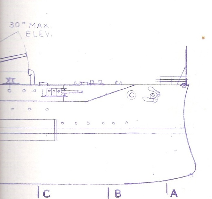

This drawing I sourced off evilbay shows the elevation at 30 deg
This was the max elevation of USS Nevada and USS Pennsylvania class, after the modernizations of the the battleships during the 1930s, the old 35.6 cm guns were constructionally upgraded and their chamber volumes enlarged to allow larger charges for an increased muzzle velocity. Marks 1, 3 and 5 became Marks 8, 9 and 10, respectively. The Mark 12 was a further conversion which added chromium plating to increase barrel life. Guns had either a horizontal or a down opening Welin breech block and used a Smith-Asbury mechanism. These guns were interchangeable and most battleships had a combination of Mark numbers.
In contrast the IJN Fuso an IJN Ise class had a maximum elevation of 43 degrees, USS New Mexico class and USS Tennessee class had a 45 degrees maximum elevation.
