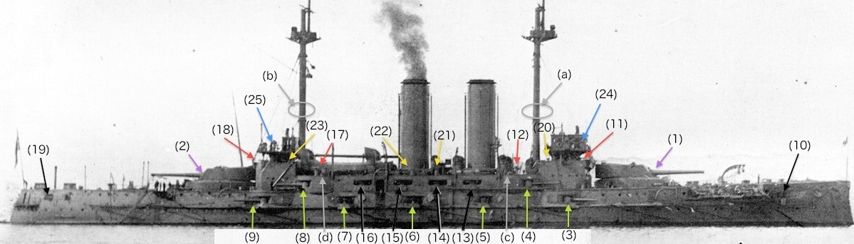

Before battle of Yellow Sea there were 2.5pdr on both mast platform, after battle complete platforms were removed , because mast were hit hard by Russian gun fire. The text at your drawing means at least that these "Ex-Platform guns" were installed there and date when installed. The inner one were in 02/1905, the outer one before battle of Tsushima installed. Point is that only 4 of the 8 guns survived the mast hits, because aft mast platform was smashed to bits at Yellow Sea battle as I read somewhere (where ever this was, damn it :-( ). So the left 4 guns from platforms were installed on both bridges with 2 right and left next to pilot house and 2 in front of wheel house on aft bridge. Before Tsushima further 2 x 2.5pdr (coming from where ever) were installed on aft bridge as shown on drawing left and right to the 2 one still installed in front of wheel house before ... and so we have again the in sources evvery where named 6 x 2.5pdr 47mm guns in sum too + story about them. ;-)
So the drawing shows the placement for Tsushima and only 1 point is not yet clear left. How much 47mm 3pdr were installed in center / midship (at high between both funnels) at the level above the 76mm in casemates ... 1 or 2 each side?

errrr slow down a bit Christian, you are getting some things wrong and some things mixed up :)
1 - if you look at this photo again:
you will notice that aft mast platform doesn't look "smashed to bits" at all. And 2 RF guns also appear to be undamaged. So, wherever you have read it, it doesn't appear to be correct does it?
Maybe what you read was about Tsushima rather than YS? Mikasa lost upper part of her aft mast there.
Remember also that Mikasa's masts platforms didn't have to be damaged to be removed. After Yellow Sea those platforms were removed from ALL Japanese ships that had them.
2 - up until August 1904 8 guns (2x4) on mast platforms were "heavy" 47mm 3 pounder RF guns, the 4 midships were "light" 47mm 2.5 pounders RF guns.
3 - during the repairs and modifications after Yellow Sea 8 "heavy" 47mm guns were moved to following positions: 2 to main bridge, 2 to aft bridge and 4 to midships (port and starboard) to where 4 "light" 47mm guns were. Two 47mm "light" guns from midships were moved to the main bridge wheel house platform and two to aft bridge wheel house platform:
8x3 pounders (yellow circles) and 4x2.5 ponders (blue circles)

some more information from http://warship-mikasa.blogspot.jp
Mikasa's armament at Tsushima (for IJN Mikasa (Tsushima 1905) fans)
Hello IJN Mikasa fans,
I am happy to know that foreign people who are interested in Mikasa exist.
Although my writing speed is very slow, I will provide information about Mikasa as far as I know.
I consider that Mikasa's armament at Tshushima (1905) was below.
(1), (2) 12 inch gun
(3) 6 inch quick firing gun #1
(4) 6 inch quick firing gun #3
(5) 6 inch quick firing gun #5
(6) 6 inch quick firing gun #7
(7) 6 inch quick firing gun #9
(8) 6 inch quick firing gun #11
(9) 6 inch quick firing gun #13
(10) 12 pounder(76 mm, 3 inch) quick firing gun #1 (on central pivot mounting, with shield) in crew space.
(11) 12 pounder(76 mm, 3 inch) quick firing gun #3 (on pedestal mounting, without shield) on fore shelter deck.
(12) 12 pounder(76 mm, 3 inch) quick firing gun #5 (on pedestal mounting, without shield) on boat deck.
(13) 12 pounder(76 mm, 3 inch) quick firing gun #7 (on central pivot mounting, with shield) on upper deck.
(14) 12 pounder(76 mm, 3 inch) quick firing gun #9 (on central pivot mounting, with shield) on upper deck.
(15) 12 pounder(76 mm, 3 inch) quick firing gun #11 (on central pivot mounting, with shield) on upper deck.
(16) 12 pounder(76 mm, 3 inch) quick firing gun #13 (on central pivot mounting, with shield) on upper deck.
(17) 12 pounder(76 mm, 3 inch) quick firing gun #15 (on pedestal mounting, without shield) on boat deck.
(18) 12 pounder(76 mm, 3 inch) quick firing gun #17 (on pedestal mounting, without shield) on aft shelter deck.
(19) 12 pounder(76 mm, 3 inch) quick firing gun #19 (oncentral pivot mounting, with shield) in admiral's saloon.
(20) 3 pounder(47 mm) Yamanouchi(*1) heavy quick firing gun #1 on fore shelter deck.
(21) 3 pounder(47 mm) Yamanouchi heavy quick firing gun #3 on boat deck.
(22) 3 pounder(47 mm) Yamanouchi heavy quick firing gun #5 on boat deck.
(23) 3 pounder(47 mm) Yamanouchi heavy quick firing gun #7 on aft shelter deck.
(24) 2.5 pounder(47 mm) Yamanouch light quick firing gun #1 (on pedestal mounting) on fore bridge deck.
(25) 2.5 pounder(47 mm) Yamanouch light quick firing gun #3 (on pedestal mounting) on aft bridge deck.
*1 "Masuji Yamanouch" (Imperial Japanese Navy officer (1860-1919)) who improved existing (maybe "Hotchikiss") quick firing gun.
According to the log of Mikasa, on 29th(and 30th), Dec. 1904, eight 47mm Yamanouchi heavy quick firing guns on the fighting tops were removed and relocated to the shelter decks or the boat decks. Previous to this relocation, four 47mm Yamanouchi light guns on the boat decks were relocated to the bridge decks.
(a), (b) Fighting tops were removed after the battle of Yellow Sea (1904).
(c), (d) Officer's conning(?) towers were fitted with on four casemates on upper deck January, 1905.
Posted by Yasaka at 21:52

You are a diamond peppe! :thumbs_up_1: I have managed to work most of it out by myself but English translation is a great help!
Just a quick correction: when Mr Yasaka writes "(c), (d) Officer's conning(?) towers were fitted with on four casemates on upper deck January, 1905" he means "sighting hoods".

What caught my attention on that blog post was this:
Notte: One Japanese claims that two 2.5pdr (47 mm) guns relocated in front of wheel house on aft bridge deck at first, and then, they were relocated to the wings up to Tsushima.
Probably it comes from the report which Mikasa's captain had submitted after the battle of Yellow Sea. But the report was merely his wish, and there is no reliable evidence to decide the matter.
That seems to refer to the blue/red diagram of the bridges posted earlier.

Image Where did you get your information about that from?
Christian M.
Posts: 967
Joined: Sat Oct 06, 2012 4:34 pm
Location: Cologne / Germany, sometimes Poznan/ Poland and Chessington/ UK
Re: Calling all IJN Mikasa (Tsushima 1905) fans
Post by Christian M. »
Yep, I read about this incident too. It is a Little bit natural that People search reasons for a defeat they got and in this behavior it is easy to claim that defeat was only because some Kind of conspiracy.
However,
the Details here you take and show are very interesting I must say. for my Mikasa too late and not really important in some of the things, but maybe some time later I build her again. :smallsmile:
The advantage of wisdom is that you can play dumb; conversely, it is more difficult.

I have discovered Mr. Yasaka's blog only when doing some extra research for your model Christian and there were over 2 years of posts to go through. Besides, process of researching those old ships is never really over so, if somebody would want to wait for final results, no model would ever be made :)
DariusP
Posts: 941
Joined: Mon Jan 10, 2005 2:08 pm
Post by DariusP »
Thank you Mr. Yasaka!
I have just noticed that drawing of Mikasa's damage at the Battle of Yellow Sea show a door leading to casing of engine room hatch.
Now, when you say "shape of forward ventilators of the engine room", by "shape" you mean shape of their bases correct? What is the difference between the 2 variants?
As for the hatch #7... Location right under ship's boat might not have been a best place for it and, if so, I wouldn't be surprised if it was moved at the first opportunity.
