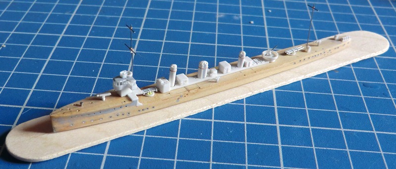

1/700 Kaba-class WWI IJN destroyer
Post by moomoon »
Pics please Quincy :big_grin:

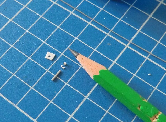

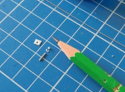

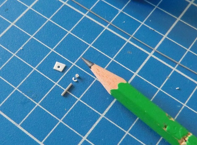

Slow progress here... spending lot of time waching pics to search details and rigging arrangement.
searchlight
searchlight

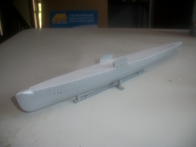

Not a lot to look at yet, I have the hull together and the deck stripped off and the first layer of styrene on. I will add the detail plating later. I used the kits prop guards, which I sanded down to reduce the profile on the lower horizontal section by half the width it was molded in. Now it looks much better. I plugged the 7 portholes per side that were not on the Reuben James in 1939 and I have added the Anchor ramps. I need to do a little putty work and sanding on the hull, then it will be ready for paint.

Fletcher,
Historically speaking, is there anything that would involve your ship and sub designs? Looking at your hull, makes me think of a submarine with the shape of your bow and your prop guards.

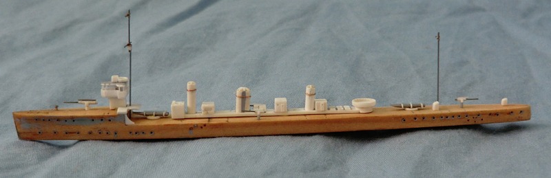

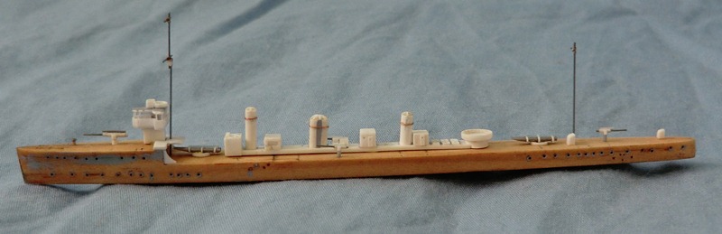

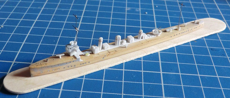

Hello,
I'm slow but I also worked a bit...
General view
General view

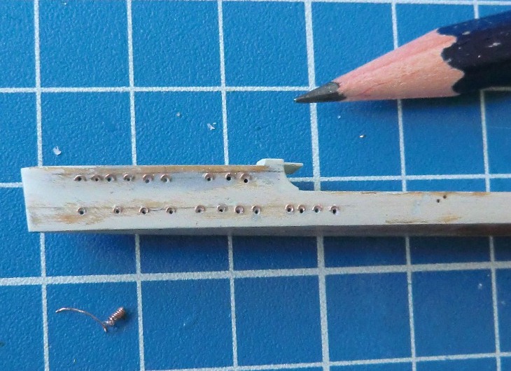

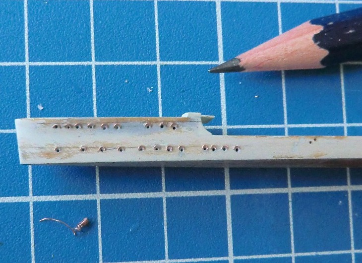

Eybrows to portholes made with electric wire

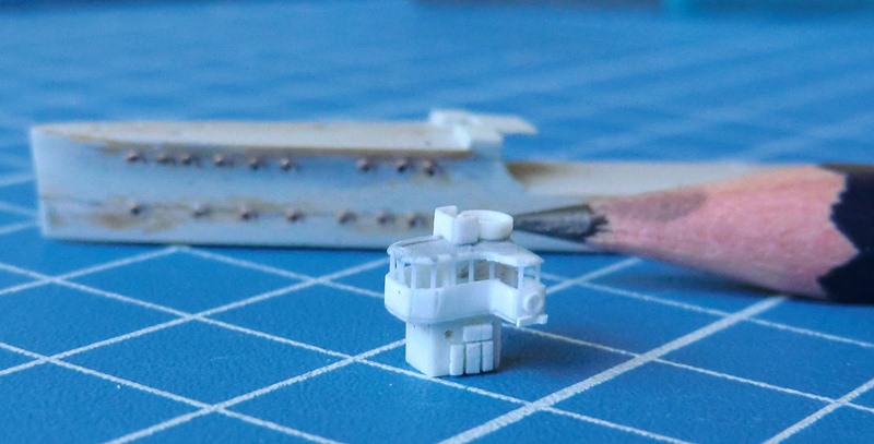

added details to the bridge
