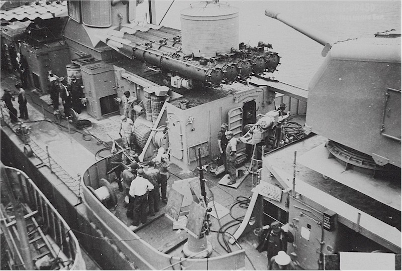

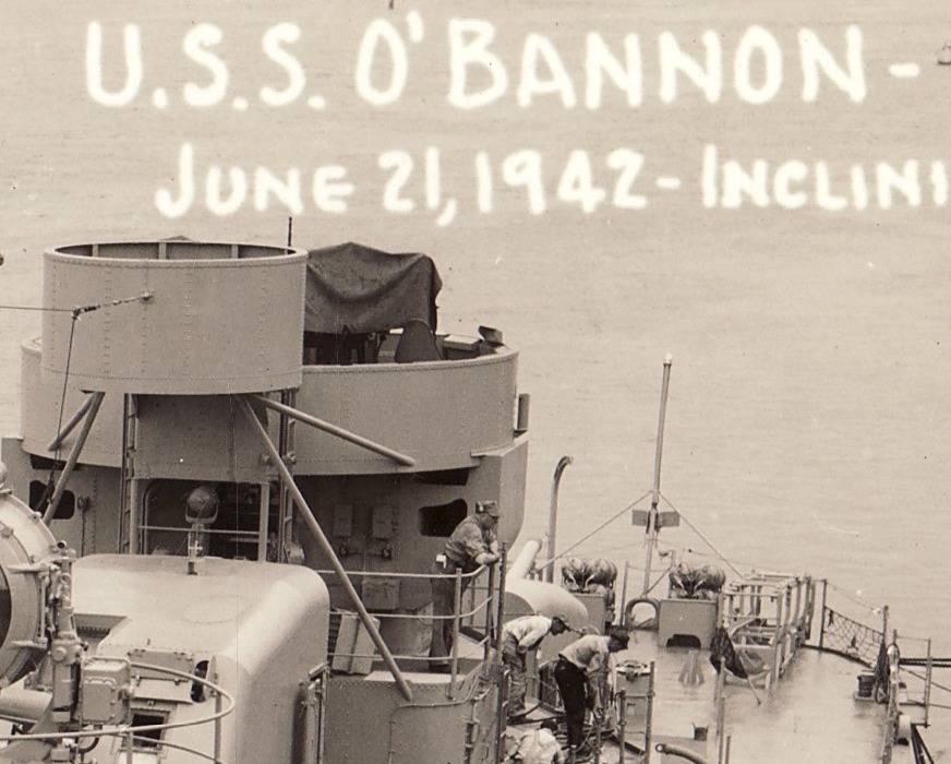

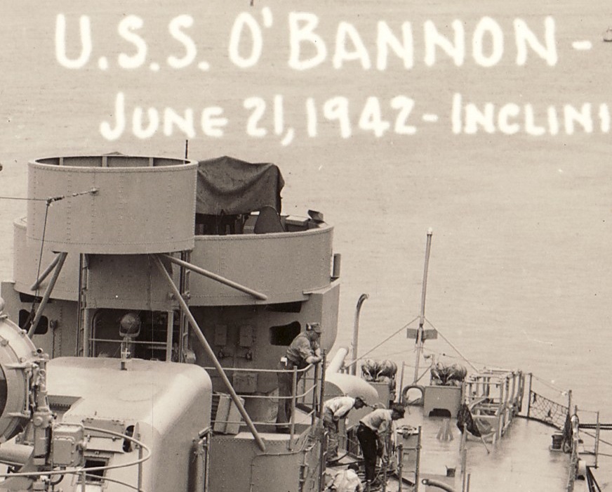

Rick E Davis wrote:Pete,
O'BANNON would have had smoke generator tanks in November 1942.
Wow, Rick. Do you live at NARA? :woo_hoo: Many thanks for posting this little gem. First time I see the smoke generators from behind, no matter how distant.
That area below is the auxiliary steering, right? what is that device that kinda looks like a pelorus? And also, the enclosure where the Mk 51 director would have been doesn't have a cut-out where it could be accessed from the 1.1 gun. I'm assuming there were steps on the outside?
Posts: 3869
Re: Calling all USS Fletcher class (DD) fans
Post by Rick E Davis »
The area under the quad 1.1-in mount was the aft (emergency) con station. When they lowered this mount, the aft con station was relocated to the front of the forward stack. I'm really not sure what all was on the "Aft Steering Station" pedestal. I assume the pedestal was a multi-function device for minimal control function.

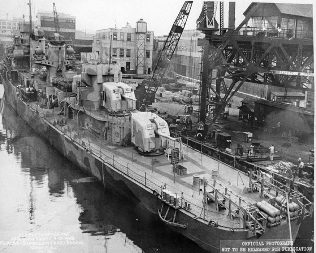

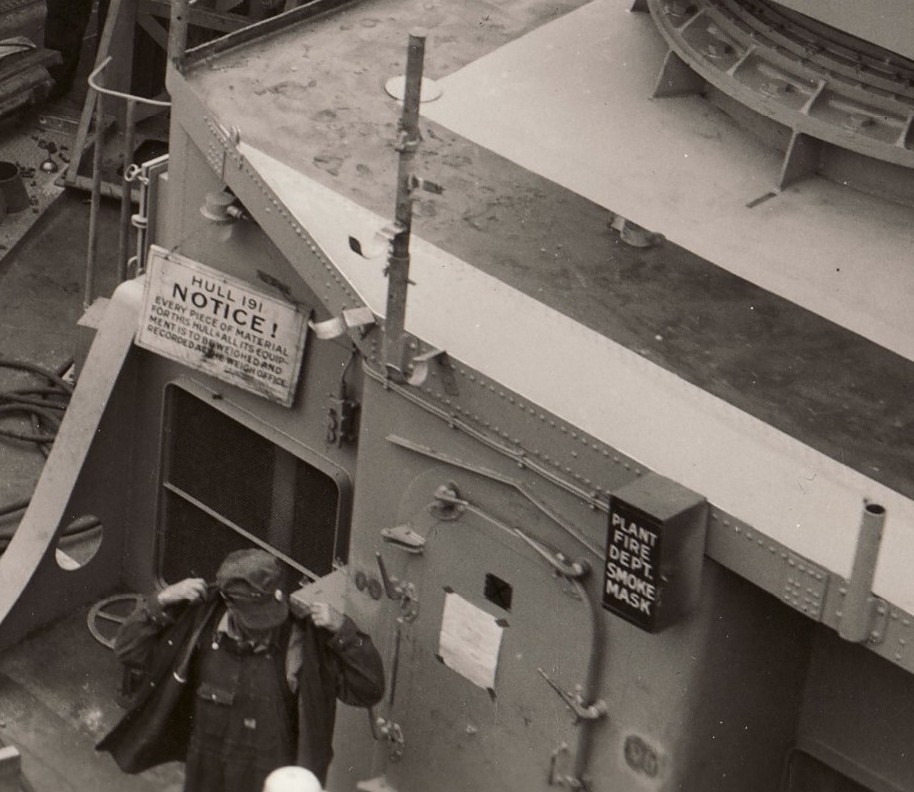

Access to the director was from the 1.1-in mount "tub", via a ladder "up and over", as seen in the attached image of FLETCHER during final fitting out by the builder.
I have made 33 trips to NARA, plus trips to NHHC and other locations from Ohio and have over 3000 images of FLETCHERS alone. :cool_2:

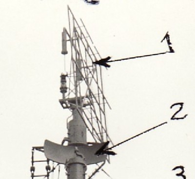

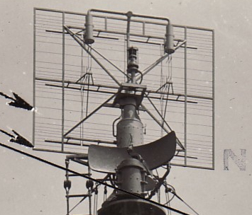

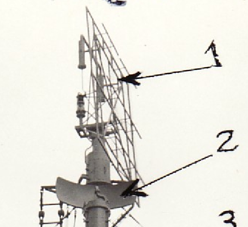

Rick,

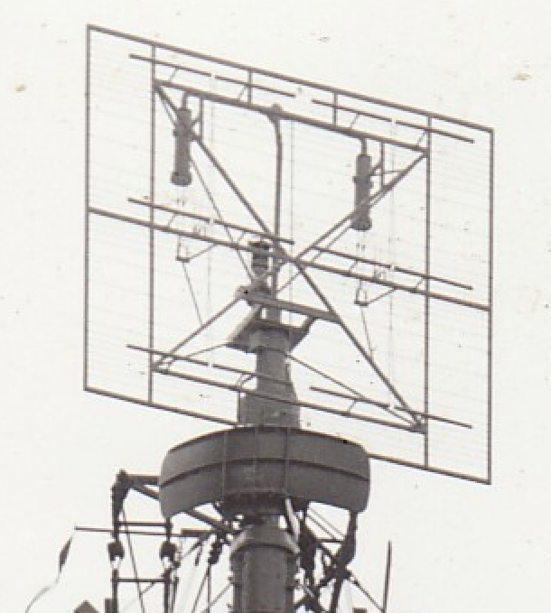

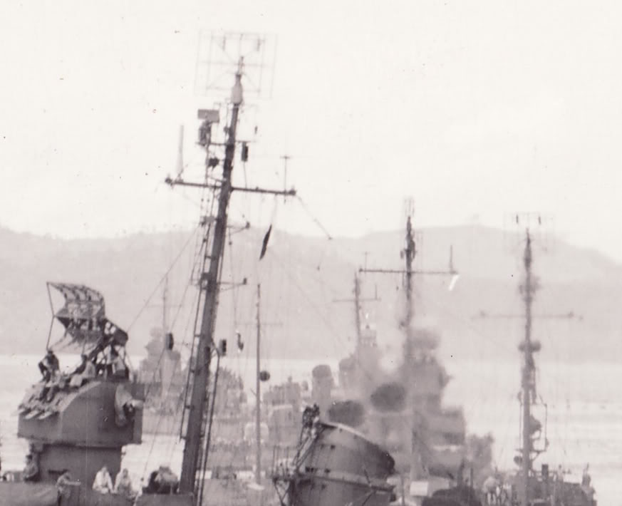

In this photo of Nicholas in 1943 showing her mast, I see the SC-1, SG radar antennas. I know -thanks to you, that the BL did not apply to O"Bannon, but would this be a good representation of a 1942 mast? Thinking of O'Bannon, of course.
I received the TOMs US radar set, which I believe is the only one in 1/350 that has the SC-1 -all others, including WEM's give you the SC-2. Don't have a photo of the SC-1 up close, if you have one, would you please post? I think the SC-1 has some depth to it -i.e. not just a flat, mattress-like profile.
Posts: 3869
I'm not sure when the BL IFF was installed during 1943, but it wasn't installed during 1942. It appears by July 1943 photo that BL had been installed.
The NICHOLAS mast, minus the BL is representative of the early FLETCHERS equipped with the SC-1. For a short period before the SC-2 was installed, the SA radar was installed. The SA looks similar to the SC in shape, but had rounded corners.
As for photos of the SC-1 radar, I have not found close-up detailed photos yet, but thanks to New York Navy Yard practice of taking the same series of photos of new destroyers, I have a series of shots on DD-445, 446, and 447 which end up showing the SC-1 antenna from thee different aspects. The SC-1 was a mattress type antenna that was spaced away from the mast rotating motor. The photos below show the early SG radar.
Notes on the images in order below;
DD-445 FLETCHER showing backside of SC-1 Antenna
DD-446 RADFORD showing the front of SC-1 Antenna
DD-447 JENKINS showing the side aspect of the SC-1 Antenna

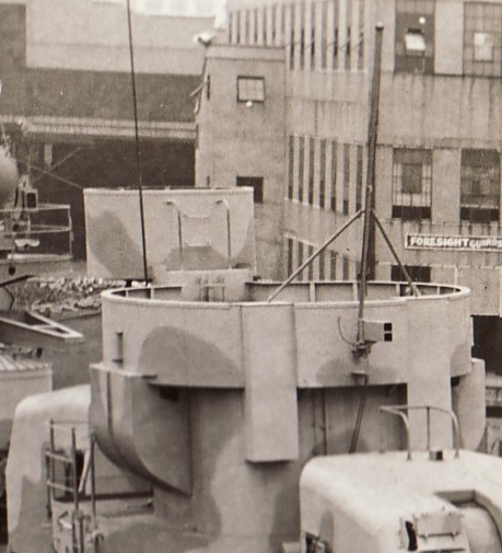

Rick,
Thanks for these photos. An important gap in my visual map of the O'Bannon has been addressed.
Would you happen to have close-up photos of this area for an early Fletcher? and really the whole first level of the aft con tower (this is the USS Kidd)
Posts: 3869
Pete, could you be more specific as to what areas you are looking for? Did you check all the images I have posted already in this thread? I know it is some 74 pages long, but there have been a lot of images posted over the years for these early ships.
Some areas I can cover somewhat more, others are next to impossible to find photographic coverage due to blockages (aka 5-in mounts in the way). In general photographic coverage available for the early units is somewhat limited anyway. The "as delivered" views don't include fitting-out "stuff" as is and are more wide area views, rather than close-up detail views.
You already have the best view of the aft con station its self.
Views of the Federal-built units after the 40-mm guns were installed will have some minor differences from the BIW-built units to support the different guns in the "tub".

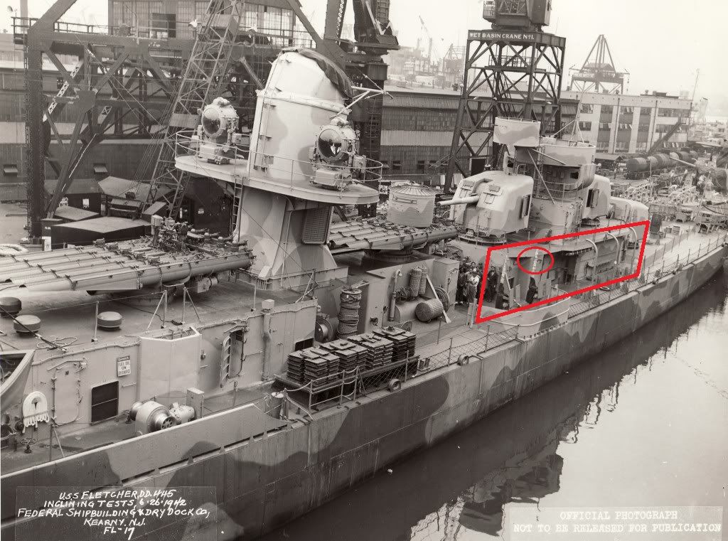

Sorry Rick, I should have been more specific.

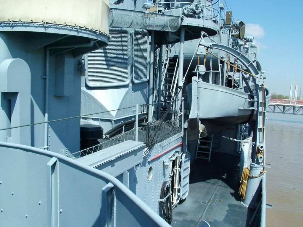

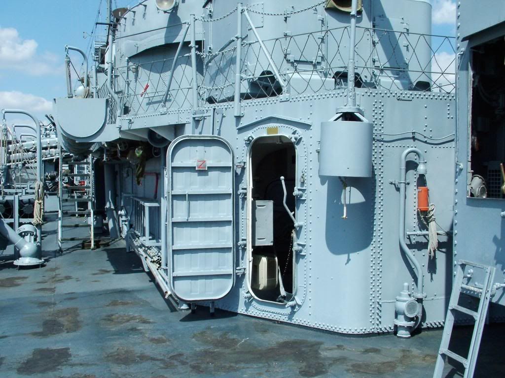

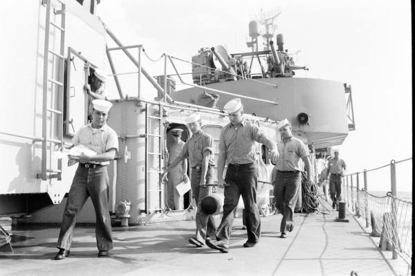

What I need is the port side (though starboard would also be helpful) of the aft deck's first level, the area enclosed in red in the picture below.
I was inspecting the plans on a Kearny-built mid-war Fletcher and noticed that on the port side the first protrusion (smaller red circle) extends outwards past the floor of the second level. Not by much but would be noticeable in 1/350 scale. However, the picture below (of USS Fletcher which was also built at Federal) matches Tamiya's depiction of this area, and I'm thinking it would also apply for O'Bannon but not sure. This and the fact that I suffer from AMS is prompting this request :crazy:

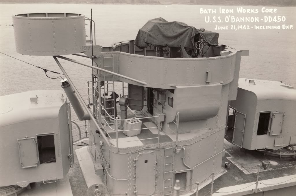

Slowly putting the pieces together. I did find these -I have gone thru all 74 pages, it's possible I missed some so will go back again is this one (the beauty is that it is DD-450). The detail showing below the 5 inch gun is the focus of my current search. Wish I had this kind of detail of the rest going aft.

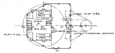

Posts: 3869

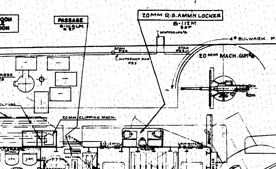

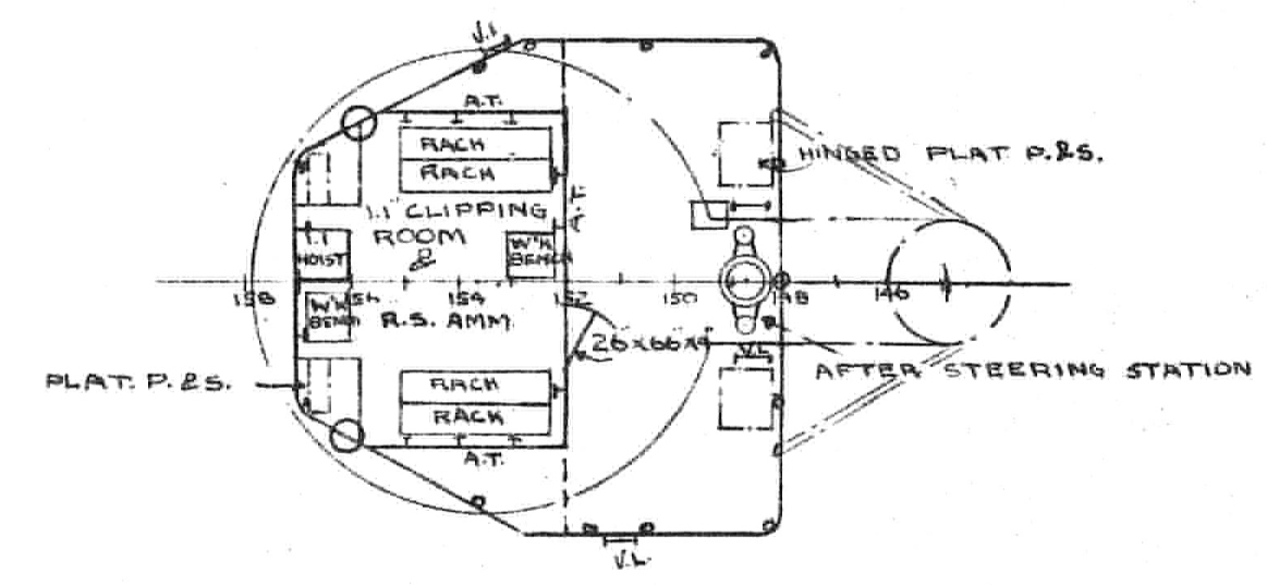

First off I wouldn't depend on the 1963 photo for much help in her 1942-43 configuration. O'BANNON was one of the converted DDEs and the aft deckhouse was revised quite a bit during that conversion.
If you want to get into this kind of detail, go to destroyerhistory.org ... http://destroyerhistory.org/destroyers/store/ ... and order the BIW FLETCHER Class Engineering Drawings DVD, all of the FLETCHER class configurations that BIW built are on this DVD. It is a little hard to navigate and find what you want, but it is likely there. Changes to the ships after delivery are not covered and would have to come from photos, but the basics are all there for the standard configurations. Well worth the $30.

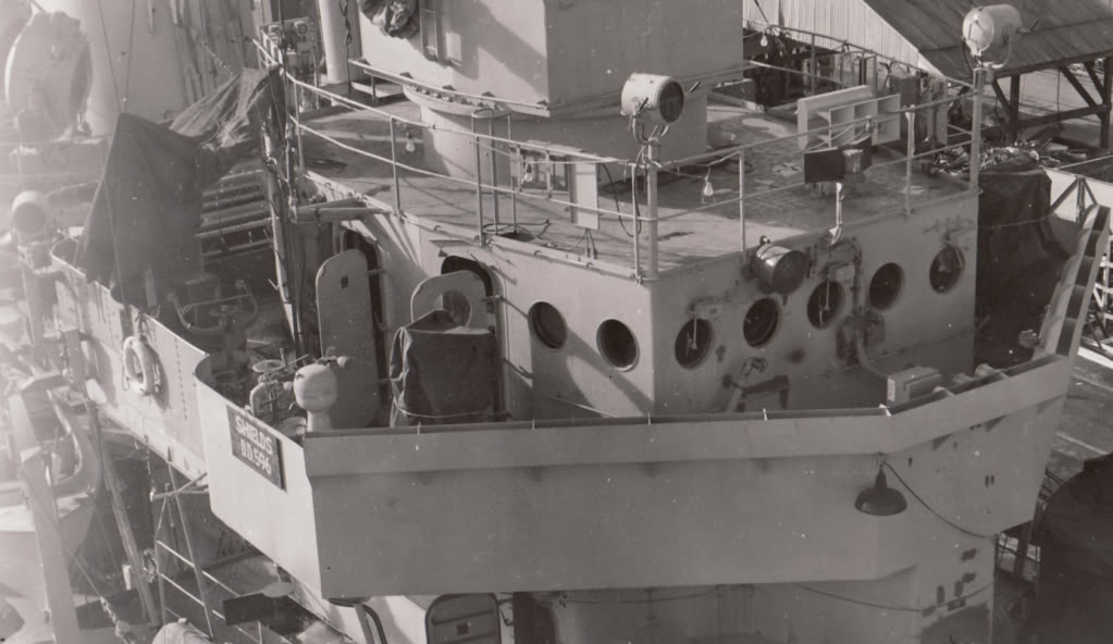

Here are a series of images of the aft deckhouse area, first one is of FLETCHER, the other two are of O'BANNON followed by a drawing of the deck layout;
The area you asked about appears to be a 20-mm ammo locker.

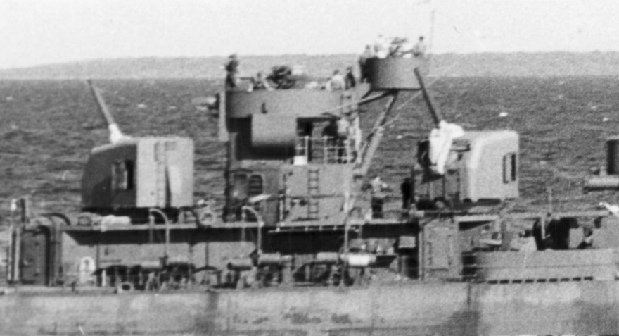

Reproducer?
I have seen a photograph of a device looking very much like the one with the "speaker horns" on the pilothouse roof of the USS Shields (DD 596) pictured below that is mounted on the mast of a Gearing Class Destroyer and identified as a "reproducer." The best info I could find on the function of a "reproducer" was that it was some type of countermeasures equipment. Is there a better description of its function?
I also note that the date of the 596 photograph is February 1945. Would this type of device have been present on DDs off Okinawa during the Kamikaze attacks?

Posts: 3869
Reproducer is a loudspeaker and the amplifier for it/them. Nothing more.
It was on at least some destroyers off Okinawa ... check photos for specific units so equipped.
