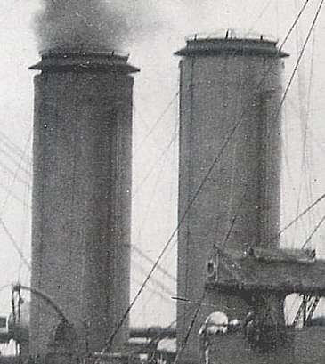

Hi everyone,
need a little help on a matter discussed on the first page of this thread.

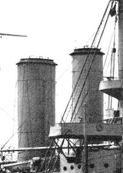

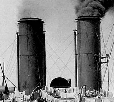

I recently checked about the Mikasa�s funnels until 1905 and compared those to the Hasegawa 1/350 kit.
The kit part shows quiet prominent something, the after market PE manufacturer like Eduard, LionRoar or WEM interpreted as footrails/funnel rings.
Those prominent funnel rings / footrails arround the funnels are not visible to me on temporary photos.
If I look at the given photo of Click: Mikasa in 1905, I can see nothing even close to the many funnel rings the kit provides.
Here is a close up:
Mikasa 1905 - Funnel Crop<br />SRC: Wikipedia
SRC: Wikipedia
I did check close ancestors and alike to Mikasa to get further clues at no avail.
Here is Click: IJN Asahi
Here is a close up:
IJN Asahi - Funnel Crop<br />SRC: Wikipedia
SRC: Wikipedia
Japanese_battleship_Asahi_funnel crop.jpg (30.26 KiB) Viewed 14807 times
Here is Click: HMS Prince of Wales (Formidable Class)
Here is a close up:
HMS Prince of Wales 1902 - Funnel Crop<br />SRC: Wikipedia
SRC: Wikipedia
HMS_Prince_of_Wales_(1902)_funnel crop.jpg (17.15 KiB) Viewed 14807 times
If I am not mistaken, those funnel rings were not common practice in the Royal Navy nor for the ships built in the United Kingdom.
I am aware, the Mikasa museum ship does show those funnel rings. I am just not confident, those were present in 1905 and before.
So, could please someone else check and give further input?
Thanks in advance.

I commented a bit on the funnel rings discrepency in my build, but it probably doesn't help you all that much since I also could not find photographic proof of their presence.
Posts: 9116
Re: Calling all IJN Mikasa (Tsushima 1905) fans
Post by Dan K »
Every now and then I check in on this thread. AFAIK, the funnel rings seem to have been added later, post 1905. Looking thru the KMM volume on IJN BBs, it seems that funnel rings were more typical of other navies, particularly the Imperial Russian Navy, as evidenced by those ships captured by the IJN and pressed into service.
The armored cruisers Ibuki and Kurama appear to be the first Japanese built ships to feature the funnel rings. FWIW.

Timmy, Dan,
Thank you so much for your kind reply. :thumbs_up_1:
Dan mentioned a KMM ? volume of IJN BBs - Sorry, I do not fully understand "KMM" ...

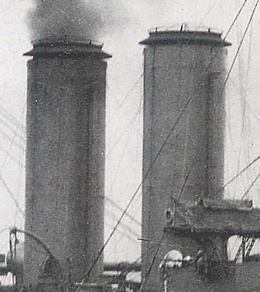

However, this reminded me I do have Japanese Naval Vessels Illustrated Vol. 1 by Shizuo Fukui.
There are two photos on page 41, that show nice close ups of Mikasa�s funnels as they are reworked, painted or alike. Those photos show no funnel rings -like those coming with the various PE sets - either.
Instead, two rings are clearly visible. One at the lower third half of the funnel and one at the upper third half of the funnel. Timmy did that with his Mikasa as shown in the thread he pointed to.
Those rings sit quiet close to the funnel with a couple of attachment points going presumably all around. They are situated so close, that they even do not interfere with the small pipes attached to the funnels.
Looks like those rings were used as attachment points to secure the funnels by rigging. The ring itself is quiet thin though.
However. the captions of the photos in that book come all in Japanese language. Problem is, I can not read Japanese language. From what I figured, each photo is given a date. I am unfamiliar with Japanese date system, so can not say which year those photos were taken.
This has been frustrating with a couple of Japanese publications I own.
Maybe someone can shed a light on this matter so I can determine at least the year, those photos were taken.
Thanks to anyone who can help out.

This is the photo you wrote about Dr.Who? If so, it shows Mikasa at Sasebo in 1905 undergoing repairs of damage sustained during the Battle of Tsushima.
And you are right about funnel rings. Those multiple, and quite prominent, funnel rings were a very late addition. There is a photo of Mikasa at Sasebo in 1908 (if the date can be trusted) which still doesn't show any rings. The earliest photo of Mikasa with funnel rings that I have seen is dated 1918 but it could have been done earlier. Still, during the Russo-Japanese War there were no rings but just 2 (much less prominent) bands:
(drawing showing damage to Mikasa's funnel sustained during the Battle of the Yellow Sea.

Dan, DariusP,
Very helpful information indeed!
Dan, thank you a million for the thorough introduction into the Japanese date system. That alone will save me a lot of time when I look further through publications in Japanese language. I will have to learn the proper symbols for the according emperor so I get my math right. Will from now on put some low tac adhesive smart labels beside the dates in my books.
DariusP, yes, that is exactly the photo in my book. There is one other with a more total view but about the same scene, as far as I can say. Date fits perfectly to the time frame I am checking.
Quiet interesting to me is the fact, that this click: Painting of Admiral Togo aboard Mikasa does show those prominent funnel rings for 1905. If I recall right, a color printed copy of that painting was included by Hasegawa in one of their limited edition offerings.
Also, the big model of Click: Mikasa at Yokosuka Naval Museum does show the funnel rings as well. Could not figure though, which configuration that model shows.
However, to me, the funnel issue is solved.
Thanks everyone for being so generous with information and confirmation.

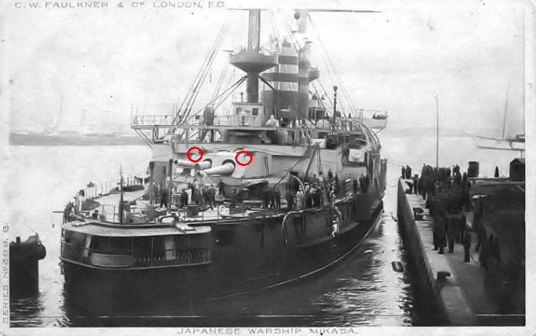

I found a click: photo reported to be taken sometime before or close to the battle of Tsushima. So that would be around 1905.
The origin of that photo is unknown to me, but I could find out, that it was published in click: (Wikipedia about) The Illustrated London News for a short feature about Admiral Togo. The Headline reads:
TOGO AGAIN CHALLANGED BY RUSSIA: THE JAPANESE ADMIRAL ON HIS FLAGSHIP "MIKASA"
On that page are 4 pictures. One of them being the one I linked above.

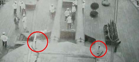

It shows the stern of Mikasa. In the lower section a small part of the aft turret is visible.
What I can not figure is, what the purpose of those metal pieces on top the turret are. I marked them in red to avoid confusion.
Stern Mikasa possibly arround 1905 - crop and edit<br />SRC: http://navgunschl.sblo.jp
Anyone an idea?
I'm not certain. My first thought was periscopes for the turret but, the shape doesn't seem right. They might be mounts for some small caliber guns.

3- I think that those little pedestals are aiming aids. They appear to have been located right in front of the sighting hoods (in fact, left sighting hood is visible in the photo) and might have acted in the same way as front sight of a rifle.

3. First I am happy you took the time to figure a use for that equipment. I am not confident about them being iron sights though. While an iron sight makes sense with a rifle because you can move the whole rifle to your needs while aiming at a target, it would make not much sense to me on a turret, where only the barrels can be moved but not the whole turret. I am not ruling out your explain though. Maybe some details about the inside of the turrets can give further clues about this idea of yours.
If it is an iron sight, then I assume a kind of notch / device inside the turrets observation station / lookout. Not much room in there though.
