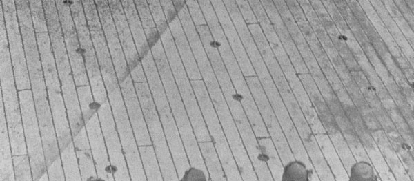

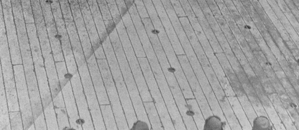

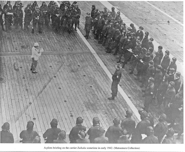

I had forgotten to post an excerpt of the information discussed on the new Flyhawk Akagi flight deck thread under MFG regarding planking.
Starting with Soryu, the planking pattern for IJN CV wood flight decks is a staggered four plank pattern; it repeats on the fifth plank. This is clearly true for the Shokakus, as exemplified by the Zuikaku images below. Planking pattern image is courtesy of Ed Low
Deck planking pattern b.jpg (20.31 KiB) Viewed 6497 times
Posts: 9067
Re: Calling all IJN Shokaku-class fans
Post by Dan K »

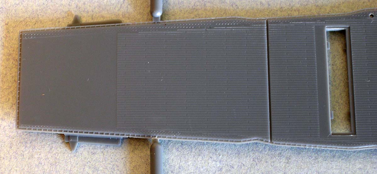

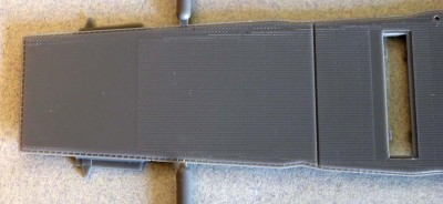

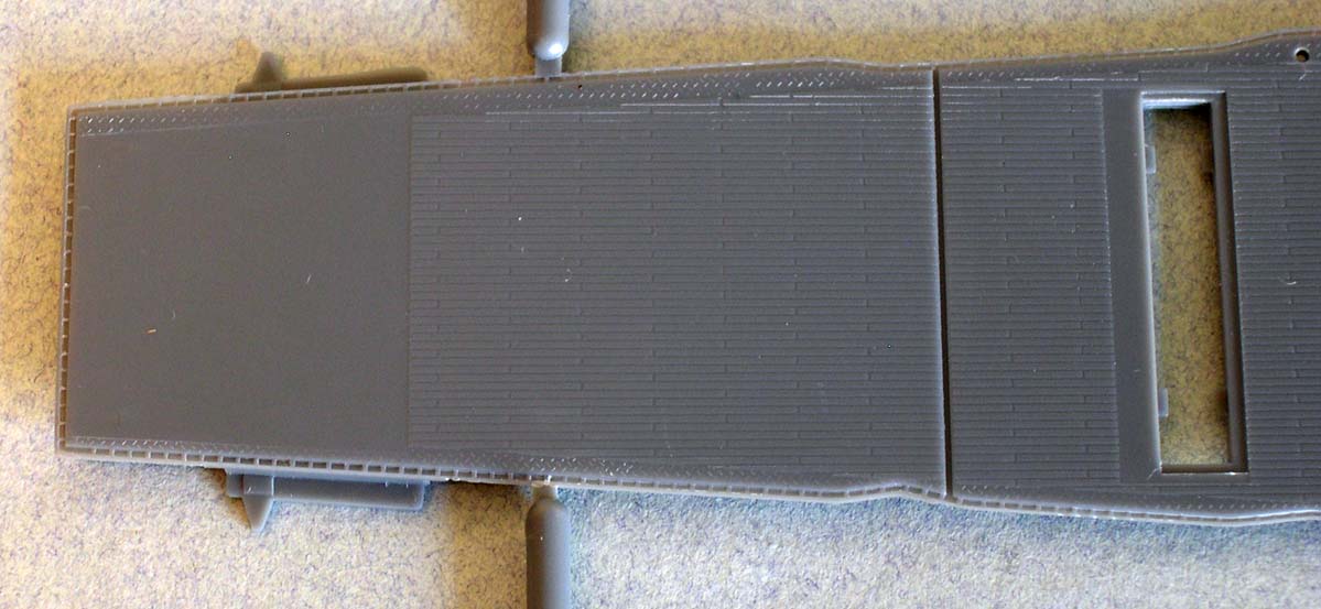

I have been re-examining the Fujimi 1/350 and 1/700 kits, and it seems that I have erred in stating that the new kit's planking pattern repeats every other plank. Actually it's a three plank pattern that repeats every fourth plank, though the pattern doesn't seem fully staggered. Still, it's a little better than I previously thought.
The origin of the Fujimi specific pattern is a bit mysterious but I did realize that this same pattern appeared about 10 years ago when Fujimi released new Cartograph flight deck planking decals to dress up their original Shokaku class kits.
I compared the Tamiya and Fujimi 1/700 decks for plank width, again out of curiosity. The Tamiya deck contains 20 planks within a 10cm span, width-wise across the deck. The Fujimi deck contains 16.5 planks within the same 10cm span. Not as bad as I originally thought, and the ratio would have been closer if the channels separating the Fujimi planking were thinner. Still, it doesn't bother me as much as does the channels that serve as the butt ends of the planking. These are same width as the legthwise channels but they seem to stand out more when segmenting up the planking.
Incidentally, because the butt ends are part of a three plank pattern, they will not work well as a template for the tie-down holes, as I originally thought they might.
I haven't measured the 1/350 deck again for plank width but I do note, on a very postive basis, that there are no buttends in this scale, which appears much better than does the 1/350 Hiryu deck, which does have these butt ends.

I did measure the 1/350 Shokaku and Hiryu. The # of planks per 10cm of flight deck width is 10, which means the 1/350 flight decks are actually scaled better than that of the 1/700 versions. The 1/350 planking is identical to Evergreen .040 V-groove sheeting with 1mm/.040 spacing. The planks are actually narrower at .030" each, and the channels taking up the remaining space.
It's worth pointing out that the Hasegawa managed to get the planking width on its 1/350 Akagi kit much more correct at .025" wide.
