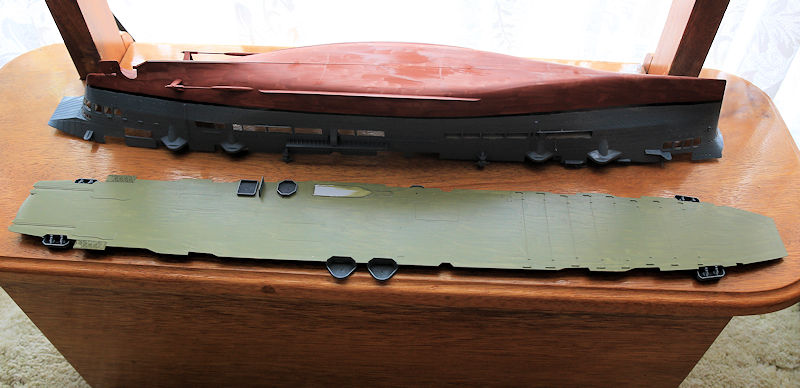

Please don't be too critical but here is the mix I did for the flight deck based on the formula Dick posted above. I have a light 1st coat painted on the ship with Colourcoat paints. The flight deck is the only mixing I had to do. The high quantity of ochre yellow gives it the green appearance.

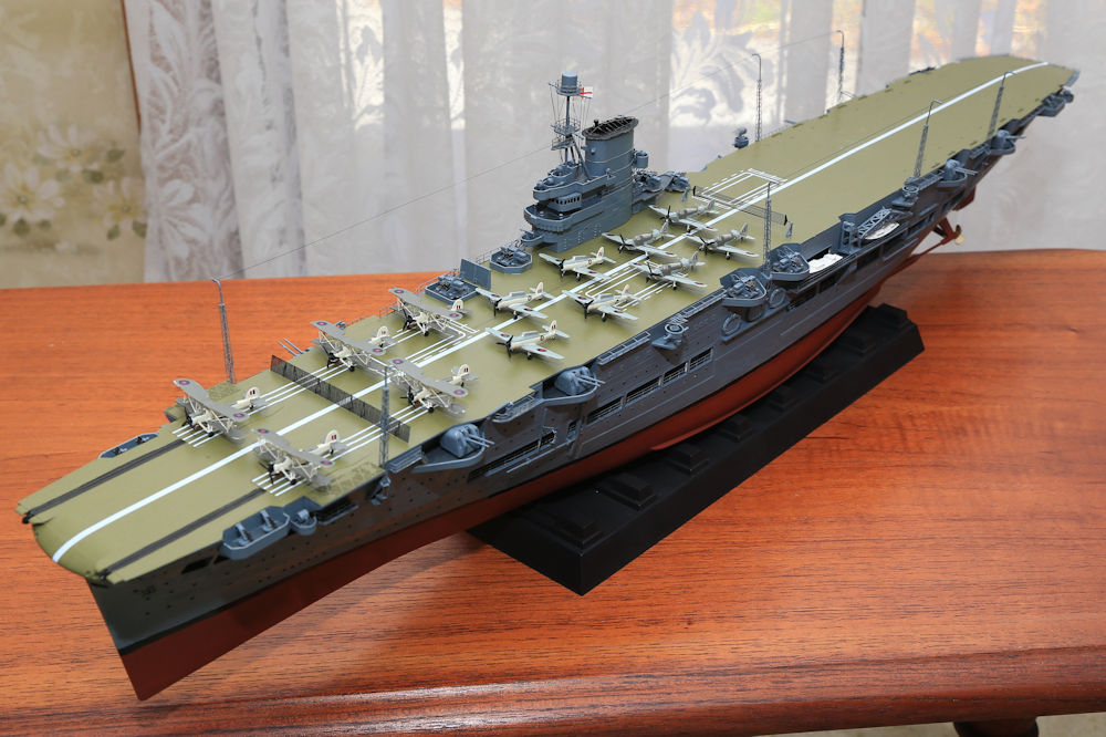

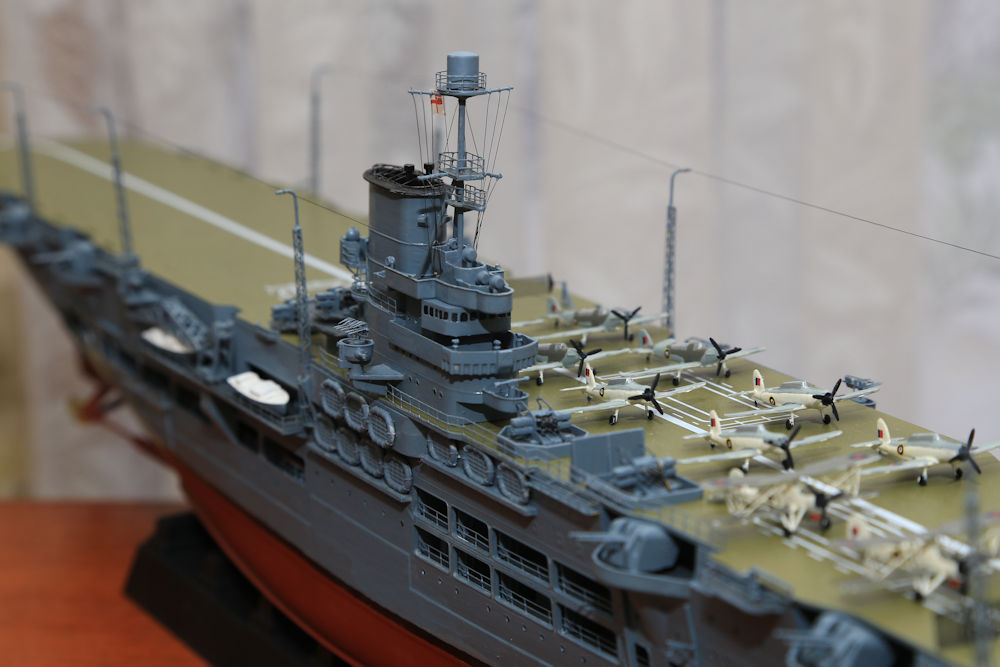

Looks good to me! Googling the models of the Ark there is a wide range of olive greens to choose from!
Thanks for your efforts.

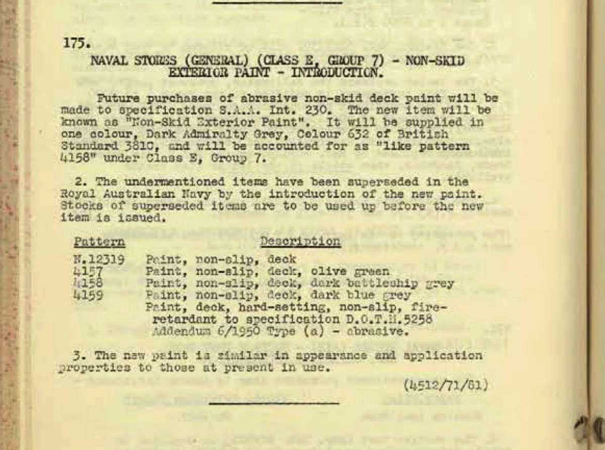

632 Dark Admiralty Grey has been a deck colour for years in the RN and RAN who still use the Australian Standard equivalent Pewter. The RAN first listed 632 in 1955 for all vessels replacing the following Admiralty Patterns:
4157 Olive Green
4158 Dark Battleship Grey
4159 Dark Blue Grey
We know 632 used to be 32 Dark Battleship Grey. Is it a coincidence that there is a BS381 colour 220 called Olive Green and 695 called Dark Blue Grey?
Dick has had success finding Stores Records/Rate Books, I wonder if these numbers have cropped up in any of them before or during WW2. I know that 4164 was yellow paint for flight deck markings and 4165 was white paint for the same use.
FYI, The RN used Dark Sea Grey as an alternative for Dark Admiralty Grey. Extra Dark Sea Grey has been the RN deck colour since about 1992. They also use (used?) Medium Sea Grey on Lynx helicopters.

So I wonder when did the RN stop holding stocks for these colours even though they had been replaced by newer colours? Could the older colours have been used for harbour craft or work boats?

Excellent!
Thank you
Thank you

Great work Sutho. It seems the Ark pre-order on HLJ keeps getting delayed month after month, June now...

The Tamiya XF66 is nothing like the old WEM tim now Sovereign Hobbies Colour coats.Jack G wrote:Great work Sutho. It seems the Ark pre-order on HLJ keeps getting delayed month after month, June now...
A question from a fellow Aussie - with no colourcoats, or paint chip charts: AP507B, is Tamiya XF66 Light Grey anywhere near it? In some of the colour footage you can see of Hood and other RN ships, it looks similarly dark and blue-tinged; yet on some of the models finished on the net, the paint looks like a much lighter bluey grey. Is this scale effect? Which is most accurate?
Colourcoats being stocked again in Oz would be a total blessing, can Sovereign advise where these might be available?
According to the experts the colour coat range for 507B is not in dispute unlike B5 so if you can get your hands on the paint it may help. it definitely does have a blue tint to it.
I do have some old tins that are empty that I kept with the colour lid if you would like them sent to you to try and match up your own colour I could send.
I am down to my last tin of 507B now and only have half a tin left so am not that well stocked up in it.
Regarding Tamiya I believe their dark grey looked close to 507A which is used for decks. It was different by negligible.
I mixed up the flight deck colours myself.
