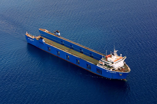

FAC/Strike Craft/Missile boat support: The modern LPDs and LSDs are too expensive to to serve as tenders and cannot provide inter-theater transport for these vessels. The Navy ought to buy small commercial flo/flo vessels , sometimes called yacht transporters to do the job. 12-15 man crew, some have real cranes to actually do maintenance, and yes, they cost a tenth of what an LPD does.
This one has been used to transport submarines (two!) This one is a flo/flo, has an articulated deck macking it a roll-on roll-off, and she has two cranes that could lift something as large as a Visby-class.

The lift ships as they exist today are perfect for transport to and from the operational area, but don't have the self defense or support capabilities I'd like to see, including shops. Modifications could be made of course, but that will take away much of the cost savings.
One of the reasons I mentioned LSD-41 as a possibility is that they are potentially coming to the end of their lives in their current form. They already have heavy cranes and a massive amount of space. The well deck would not really be able to move the FACs, I was thinking of inserting what would essentially be a 'light floating dock' for transit in the well which is deployed alongside the tender at the support location. A refit of those existing assets could be a good re-use of sunk costs to get a large support platform.
LPD-17 is too expensive to contemplate as the basis for a new build support ship in its current form, and it may only become affordable if it could support two squadrons of 6 or more, but that is certainly possible considering its size
I do not think every squadron would have to have a full LSD/LPD sized support ship - some squadrons could be shore supported, and I still like the Absalon idea for half squadrons or shorter term deployments of a full squadron. An area could be rather well covered by a converted LSD-41 (with the folding dock) as the primary support point, and two Absalons farther forward with all three supporting 2 or 3 squadrons of FACs (12-18 total), rotating forward and back to the LSD for refit/stand down time.
Lift ships for transport of these FACs to and from the area is 100% on.

LSDs are an inferior choice compared to a modern commercial hull. The well decks are useless for any larger platform like a Skjold or Hamina, the cranes are antique, unsafe for the operations required, and are dwarfed by the modern 700-metric ton crane capacity of the Roll Dock vessel which can dead lift a 600+ ton Visby. Base crew size is ~15, service life is 20-25 years and the cost would be ~$150 million.SumGui wrote:One of the reasons I mentioned LSD-41 as a possibility is that they are potentially coming to the end of their lives in their current form. They already have heavy cranes and a massive amount of space. The well deck would not really be able to move the FACs, I was thinking of inserting what would essentially be a 'light floating dock' for transit in the well which is deployed alongside the tender at the support location. A refit of those existing assets could be a good re-use of sunk costs to get a large support platform.
