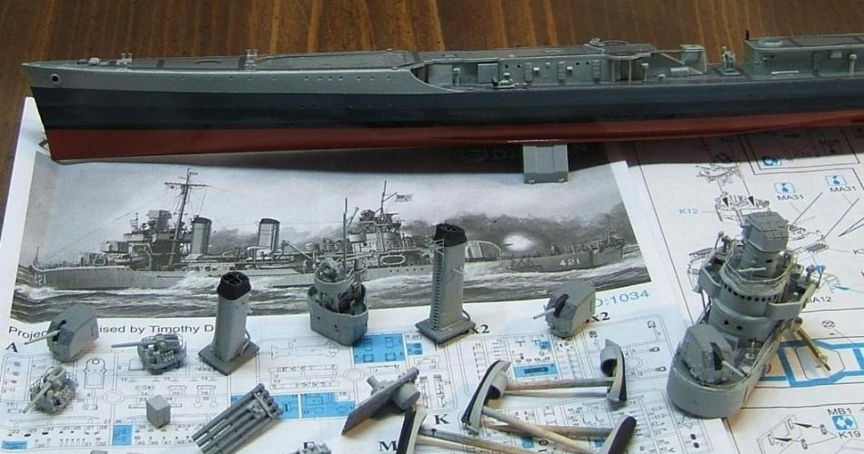

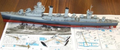

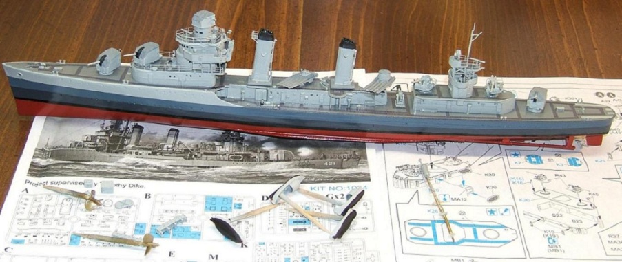

Good day to all
It�s about time for an update of my build of the DML�s Benson class prewar destroyer USS Charles F. Hughes. I have attached two photos on the completed sub-assemblies for the ship. It took me three times painting and stripping the hull to get the camouflaged pattern right. That�s finial done and the walkway decals have been applied. I have also fabricated the mast out brass rod and piano wire; it can be seen in the second photo. I tried using the kits open 5 inch 38s, but the trienniums are way too low. I had a couple of the L�Arsenal open mounts left over from another project and am using them instead of the kit ones. I hope to have the project completed by the 5th of July.

Nice! Especially like the camouflage pattern.

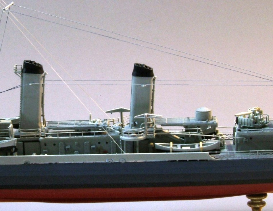

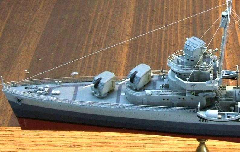

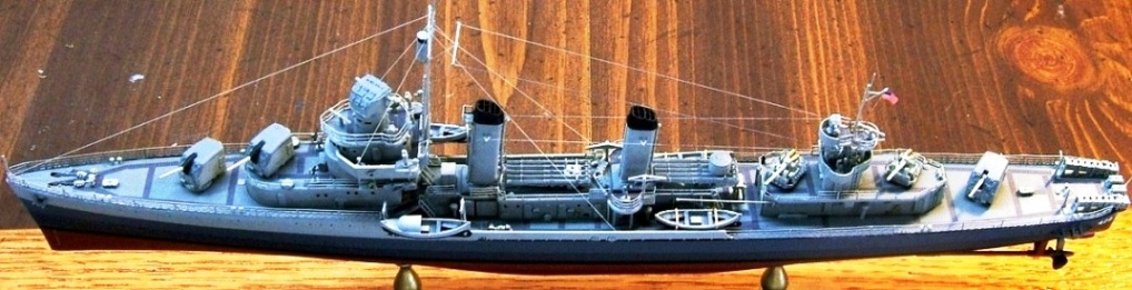

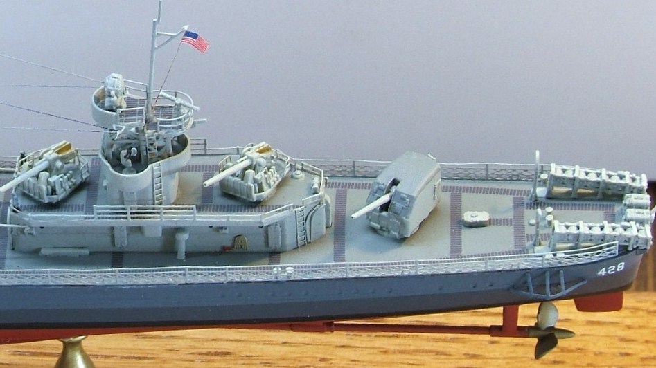

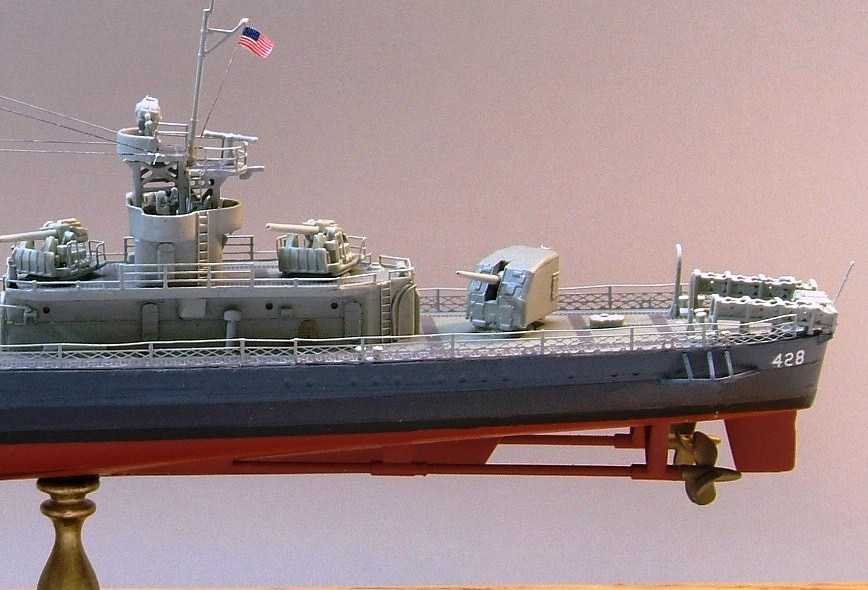

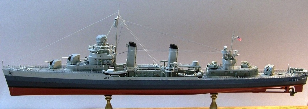

Build Complete
USS Charles F. Hughes (DD-428)
I have completed my build of DML�s USS Benson (Prewar) kit. Since I don�t like to build a cookie cutter model, I always change something. In this case it�s the color scheme, I went with measure 2, the 3 tone grey scheme used in late 40/41. My inspiration was this picture from Navsource.org. It shows the Charles F. Hughes (DD 428) just after she was painted but before they installed the lift rafts on the Bridge 02 level.
The kits open 5inch 38 mounts are incorrect so I substituted L� Arsenal�s mounts. The rails are from my scrounge box. I scratch built the mast since I�ve had problem in the past with DML�s masts bending over time due to the weight of the rigging. I used the kits depth charge racking just adding the cross members on the top of the racks.

Gary,
Very nice! :thumbs_up_1:

Looks fantastic Gary!
You've certainly set the bar for the rest of us. :thumbs_up_1:

Gary, a very impressive build. Very nice indeed.

Nice build. I'd really like to do one of these in Ms 2 - it's a neat looking scheme. The hull number amidships is an interesting difference as well.
Gary Griffith wrote:The kits open 5inch 38 mounts are incorrect so I substituted L� Arsenal�s mounts.
Just curious, what is the issue with the kits weapons?

The kit's open 5 inch 38 mount trunnions are to short. The gun would be unable to evevate past 45 degrees not to mention having to evevate to 90 degres as required.

The kits open 5 inch mount trunions are too short. The gun would not be able to elevate past 45 degrees not to mention reaching the required 89 degrees of the real weapons. The L'arsonal 5 inch 38s are much closer in the required trunion hieght.

Your DD looks great Gary, the camouflage you chose is nice and original. It reminds me the one worn by some 1500t french destroyer at the end of 1939.

Nicely done Gary,
Did you have to paint all those little rectangles on the deck, or were you able to use decals?

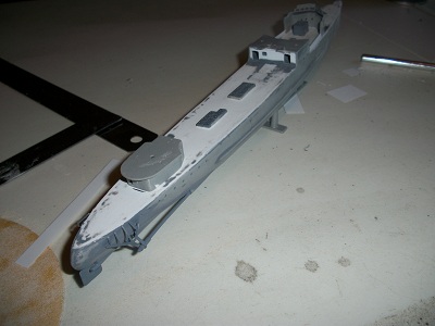

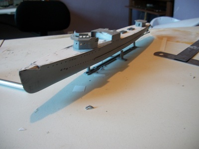

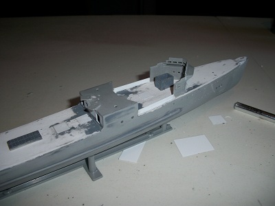

USS Reuben James, 1939
A bit of a progress update, the rear deckhouse has been assembled, striped of the molded details and the wood planking removed from the top. The portholes have been drilled out to the larger size used above the weather deck. The front and rear walls of the galley section have been added, and the top sanded smooth and installed. The engine hatches have been removed from the kit deck and are setting in place. The front wall of the bridge is in, and the two solid sides of the railing between the bridge and galley have been replaced by strip styrene (By 1939 the RJ had lost the curve on the forward section of these rails) Also the 4 base plates for the stacks have been added to the deck. A coat of filler primer was put on the hull, and then sanded back smooth, most of it being removed. Next up is to begin plating the deck and building the stacks and the more of the bridge.

Nice flush-deck taking shape up there :thumbs_up_1:

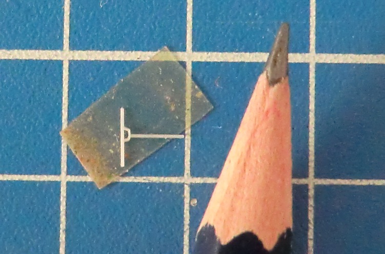

@ California Bound:to handle small part I use the wet tip of a toothpick.
First, with a needle I put a bit of gel cyanoacrylate glue ever the porthole, then pick the eyebrow with the tooth pick. The final positioning of the eyebrow is make with my nail or a blade.

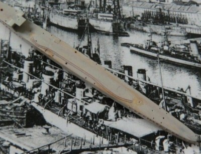

According to the text of my documentaion there were sinuous rails on the port side to handle torpedoes. This is my interpretation of this and the only pics I found showing a bit of it...

Thank God no, they came as decals with the kit
