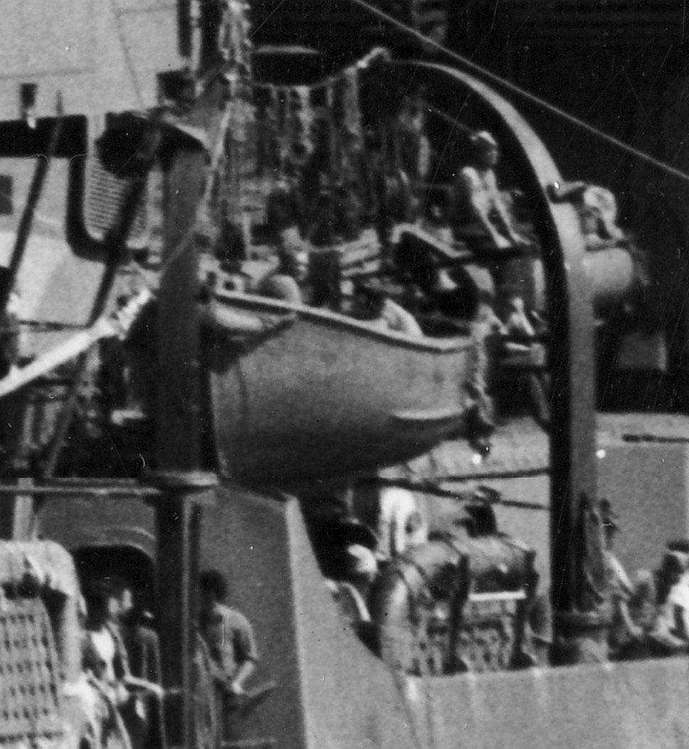

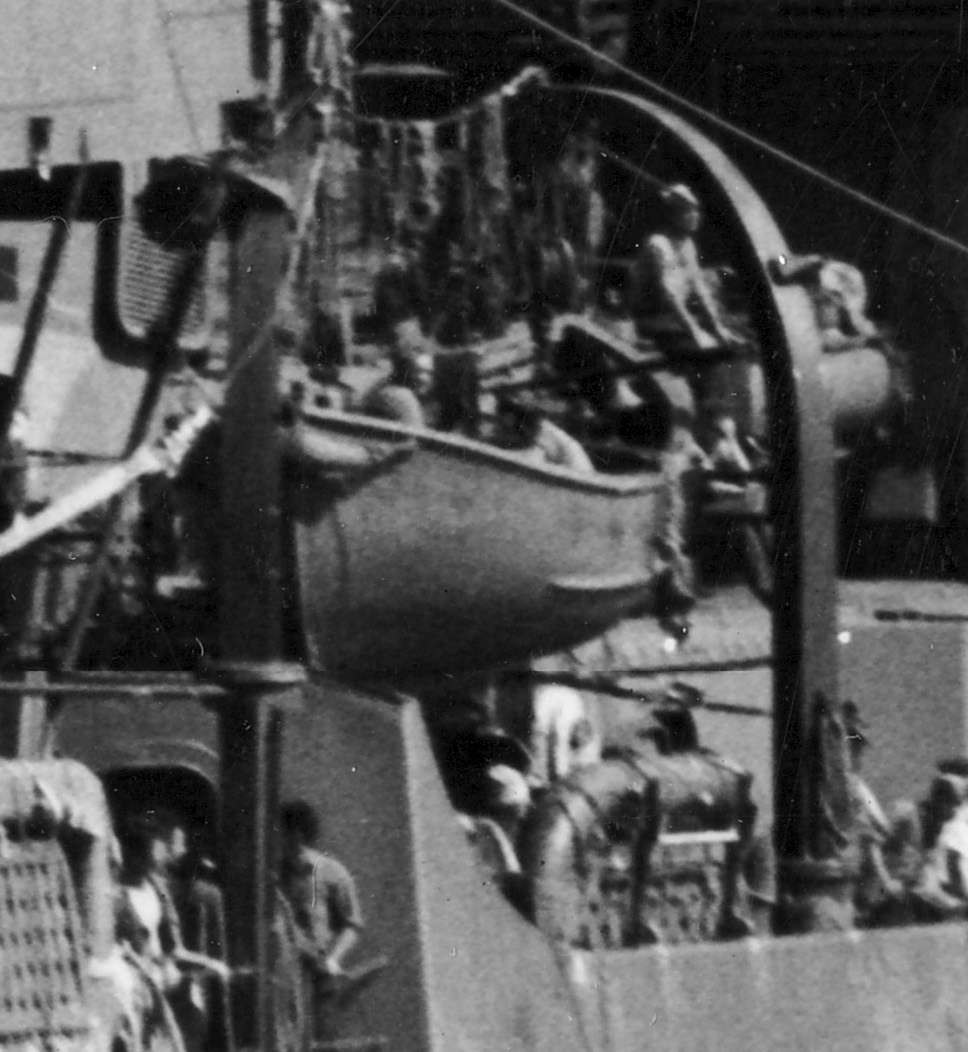

That's an interesting head-on view. Why would the whaleboats be outboard with the ship at speed?
I don't want to upset you too much, but at the moment you have an excellent chance of being hanged. Barney Greenwald in The Caine Mutiny
- Posts: 3880
Well yes and no that the ship's boats hung "freely". The boats in the stowed position had the aft end of the boat swung inboard behind the aft davit and then was secured with ropes and many times the front keel of the boat would rest on the passageway bulwark (it was open on the aft side, the Tamiya kit is in error enclosing it).
It was common "practice" in the South Pacific (Solomons) in late 1942 into 1943 to cruise with the boats deployed outboard and ready to be lowered. The reasons seem to be to respond to either the own ship being hit or to provide immediate assistance to another ship that was hit in a sudden air attack. During carrier escort missions, this wasn't as common of a practice unless the destroyer was the plane guard.

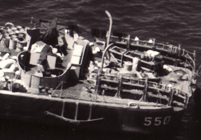

Spanish destroyer "Lepanto" (ex DD 550).
- Posts: 3880
LEPANTO {former USS CAPPS (DD-550)} was one of the Anti-Kamikaze Mod units. She received six Mk 24 twin 20-mm mounts. The 1957 photos of her I have prior to transfer clearly show that she had Mk 24 Twin 20-mm mounts still installed.
Perhaps a nit, but for accuracy the 20-mm guns should depict twin mounts.
A September 1945 view of the fantail area of USS CAPPS;

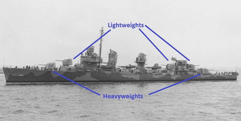

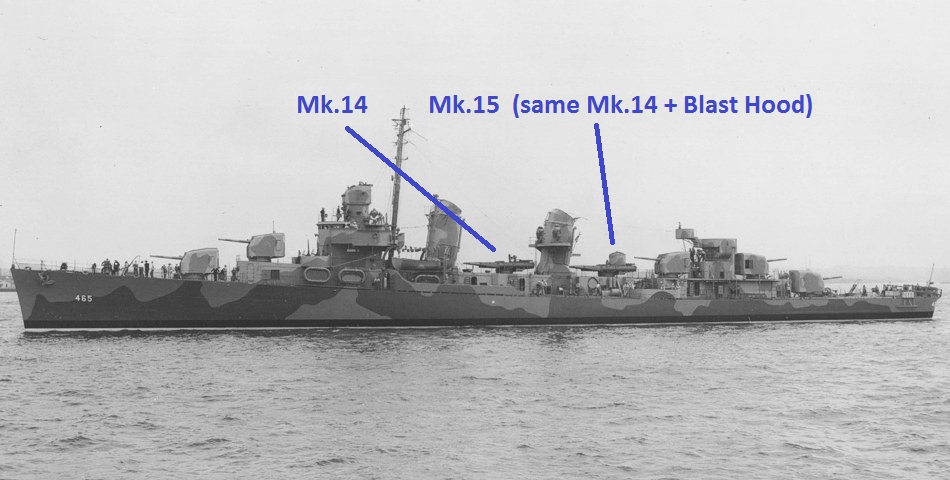

Although I like to use the terms "heavyweight" and "lightweight" (for simplistic marketing purposes for customers world-wide - those terms translate better into other languages), the mounts are more properly referred to as "double knuckle" and "single knuckle" at least during wartime. Rick could say with more certainty.
But the photos below may help show what was what for the 5" mounts and the torpedo mounts during WWII.
Lightweight = single knuckle
Heavyweight = double knuckle
- Posts: 3880
I have a heartburn with using "lightweight" in this context. The USN in an effort to save weight introduced 5-in gun mount shields for destroyers that were made with lighter gage steel. They offered less protection to the gun crews, but allowed for more armament of other sizes to be installed.
I think the USN simply referred to the two different types of gun mounts by their Mod numbers. There were a large number of Gun Mount Mod numbers installed (I made an effort to list ALL of them that I could find for the SQUARE-BRIDGE units in the Square-Bridge book - something like two dozen without looking and counting
) on FLETCHERS. A new Mod number was assigned to new production mounts as improvements were made to the total 5-in/38cal mount. Many units had a mount replaced when there was a hang-fire or other breakdown. Mounts with the right-side gun captains hatch and those with left-side gun captains hatch had different Mod numbers. So a given FLETCHER could have FOUR or FIVE different Mods of mounts installed by the end of the war.
In reality for modelers, the different Mod numbered mounts don't mean much. The only visual differences are the single and double knuckle and whether they were early or later "lightweight" shields.
