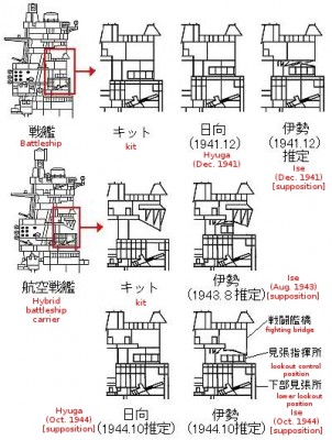

Atma wrote:By the way, can anyone can help me and translate this one(Gernot) ?
Thanks in advance.
Done!
Annotated diagram for Atma.
Gernot Hassenpflug

Post by Atma »
Thanks in advance.
Done!
Thanks Gernot :thumbs_up_1:
I found that picture on internet, it seems it points the mistakes in the old IJN Ise and IJN Hyuga battleships released by Hasegawa.
