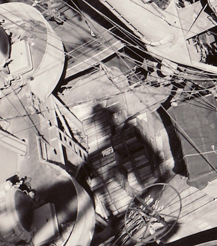

I don't have similar images for THE SULLIVANS in this area taken from overhead at MINY, because they had yet to load shoring lumber onboard. But, some of her sister units also at MINY do show shoring lumber stowed in that area. The amber appears to be strapped together for easier loading and more secure during stowing. It doesn't appear to be stowed in a "standard" way, so you likely could copy these images as examples.

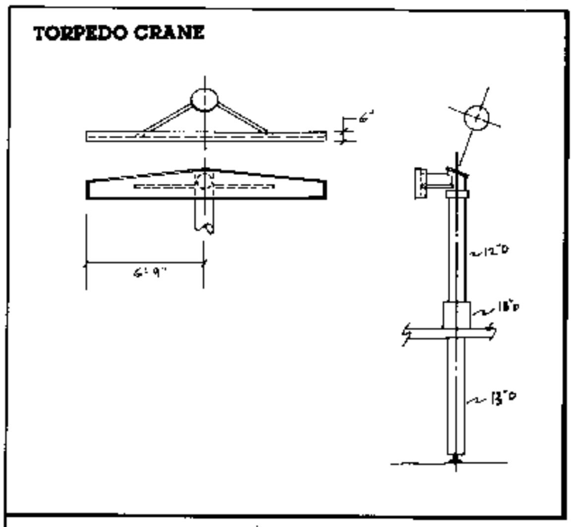

Hi, everyone. I'm currently trying to build the Trumpeter Sullivans kit as the USS Heermann as she would have appeared off Leyte in October 1944. This will be a full-hull build on a display stand. I've got Warship Pictorials - Round bridge Fletchers in hand and am awaiting the Square Bridge volume from Sprue Brothers. First off, Rick, your work is wonderful and a truly great reference for those of us trying to recreate these ships. I've learned a ton from the RB edition and I'm looking forward to getting the SB volume in hand. Thanks for your efforts!!
That said, I've got the L'Arsenal and Toms Modelworks PE sets to go along with the base kit. I've scratch-built the teardrop 40mm aft gun tub, I've added hawseholes and bollards (I think the correct term) in the proper places, scratch anchor chains, and I've added a sonar dome. I've also sanded off the anti-slip walkway and tweaked the shape of the gun director platform on the rear funnel. At this point, I'm building her with the SC2 radar, but without the Mk22 height finder, based on this pic from navsource: http://www.navsource.org/archives/05/pix1/0553204.jpg
I've scoured the web and this forum for pics of the Heermann and have found a decent number of useful shots. But, I'm not an expert on Fletchers, so I'm curious if there's any other major items I need to be aware of before I make too much progress. At this point, the hull is the only thing permanently attached. The rest is dry fit, so I have room to tweak.
Also, does anyone have any recommendations on how to recreate the non-slip walkway? I was thinking of small strips of Tamiya tape, but there really shouldn't be any relief at this scale as the real things were just painted on.
Edit: I see that I'll have to scratch-build a torpedo crane next to the forward stack, and I'm guessing that means I can omit part number A4, which appears to be a different style torpedo crane mounted on the walkway between the aft and midship deckhouses. (?)

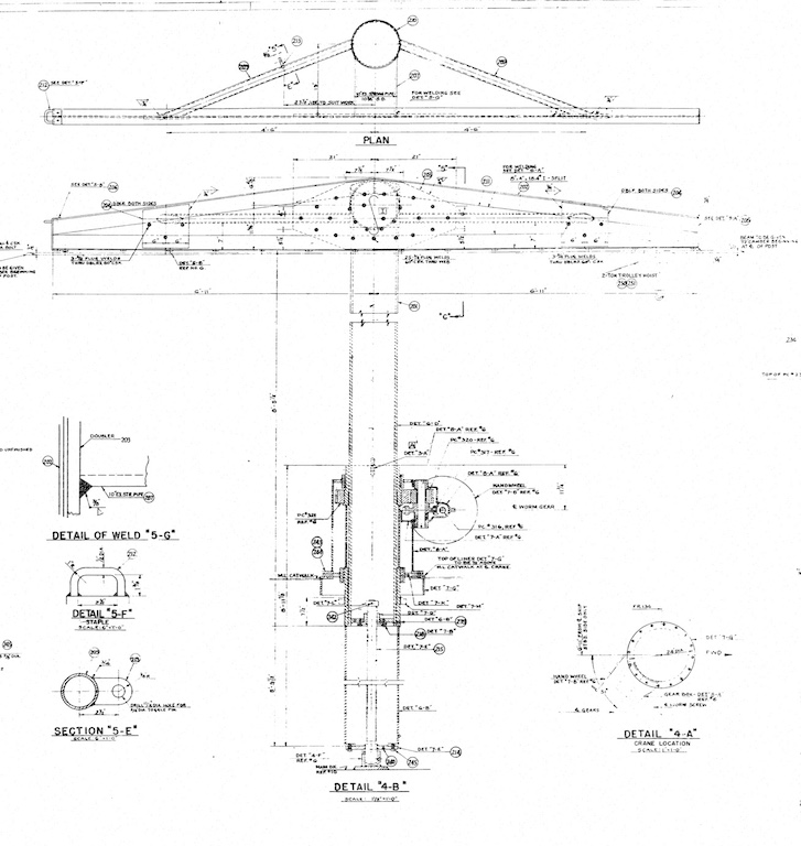

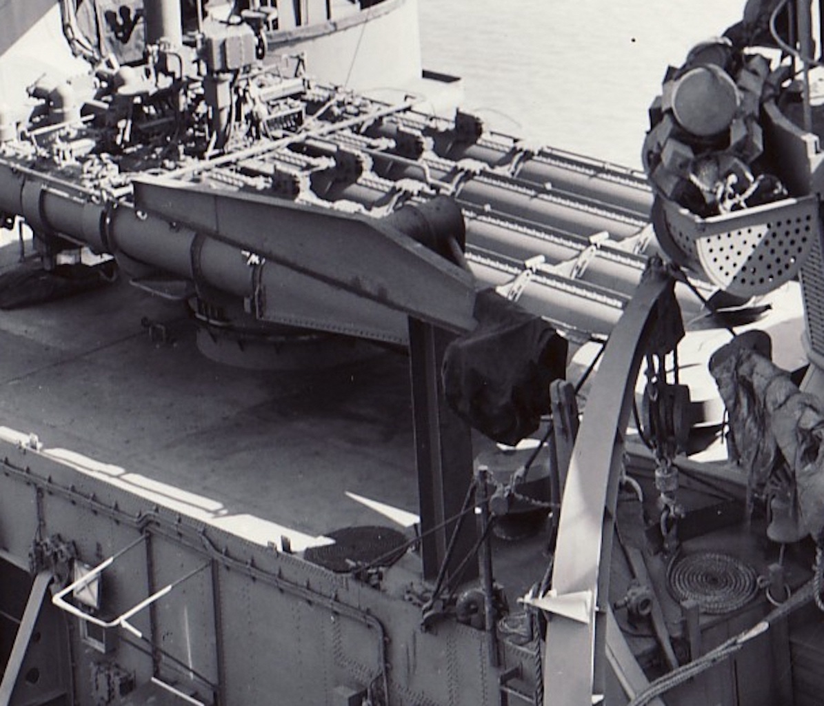

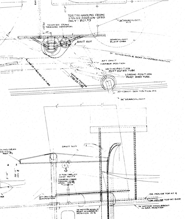

As for Torpedo Cranes, the five twin 40-mm configured FLETCHERS, had two torpedo cranes; one forward by the forward stack and one aft on the elevated walkway. The Trumpeter kit has mistakenly omitted the forward crane from their kit for the five twin 40-mm configuration option. The aft torpedo crane (part A4) was on the HEERMANN. The aft crane was a telescopic crane that could be lowered when not in use. The Forward Crane, was a fixed height unit. OH ... by the way, do NOT use part A10. Trumpeter has used a Paravane in the location where a boat winch should be located on their model. Again this is an item that can be gotten aftermarket, 3-d printed or otherwise. Their K-Gun depth charge throwers reloads need PE framing wrapped over them to represent the reload racks used.
The anti-skid walkways were mostly separate series of rectangular shaped mat like material cemented to the deck. On other ships a painted on or a roll of material was used. Frankly I can't tell from photos which type was used on the Beth-SF built units. But, it does appear that they used the "painted-on" type. Plus it appears that they were pretty liberal its application with upper decks almost completely covered. The best way to represent the non-skid areas would be to use a slightly different shade of paint or one more flat. Because it was rough, it appeared more "flat" than just painted steel deck and stayed "darker" that the painted steel decks after aging.
Again, if you can use or do whatever you like and can afford for your build.

Yes that is the pilothouse, but you will need the navigation bridge as well ... https://www.model-monkey.com/product-pa ... ck-and-cic ... that was the kit part that was off in shape.
There were two types of forward torpedo tube cranes. The early type was the original one arm crane located abreast stack #2 before the waist twin 40-mm mounts were installed, that was relocated forward and the telescopic crane installed aft. However, the majority of Square-Bridge units and the Beth-SF class units had the second type that basically was built to the same design as the telescopic crane except that it was fixed in height. Attached is an image of the telescopic crane with a few dimensions from the Floating Drydock FLETCHER CLASS PLANS BOOK. A side note, Floating Drydock has been sold to another person, base in Maryland, who is still trying to sort through the stuff he acquired. Plus a couple of drawings from the BIW FLETCHER CLASS ENGINEERING DRAWINGS DVD. I couldn't locate a dimensioned drawing of the forward crane in the BIW drawings, but I did locate an Assembly drawing showing the installation. It appears that the arms of the crane were "similar in design" to the telescopic crane arms, except that one arm was longer. See image onboard USS HAZELWOOD, sister to USS HEERMANN.
I asked what your goal for your build as to accuracy because I didn't want to drive you down a path of replacing every part except for the hull and main deck. :big_grin:
