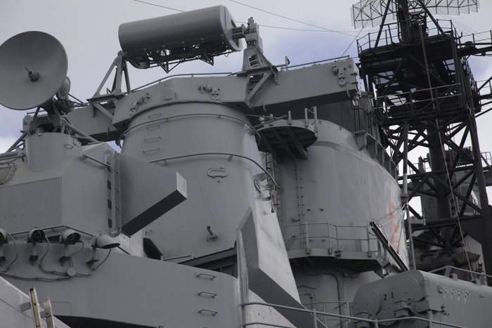

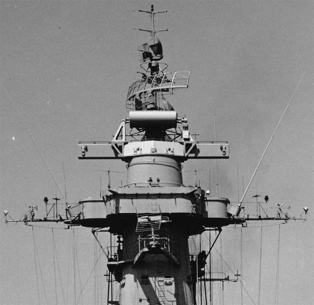

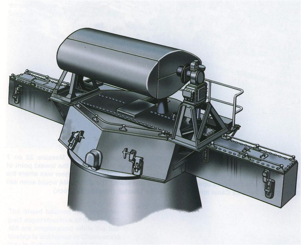

Awning looks better now!! One other things I noticed (and not your doing!) - the Main Battery FC Rangefinder at the top (Mk. 13 radar housing) is molded with 3 vertical ribs - this is NOT correct. See photos:
The actual photo is NEW JERSEY in 1950 - her FC radar has not changed since then - same units forward & aft.
If you can, remove the radar housing and file/sand off those 3 ribs and you'll be correct on that.

BB62vet wrote:Brett,
Hope this is helpful,
Awesome, thanks for the info Hank. That should be easy to remove those lines and smooth it out. Plus, now I can correct the aft rangefinder before I even assemble it.
