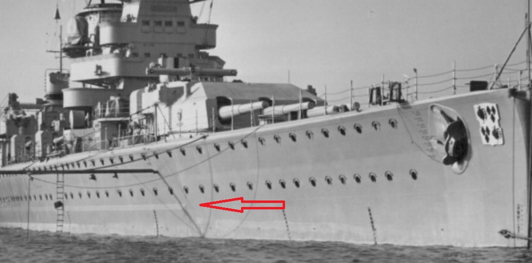

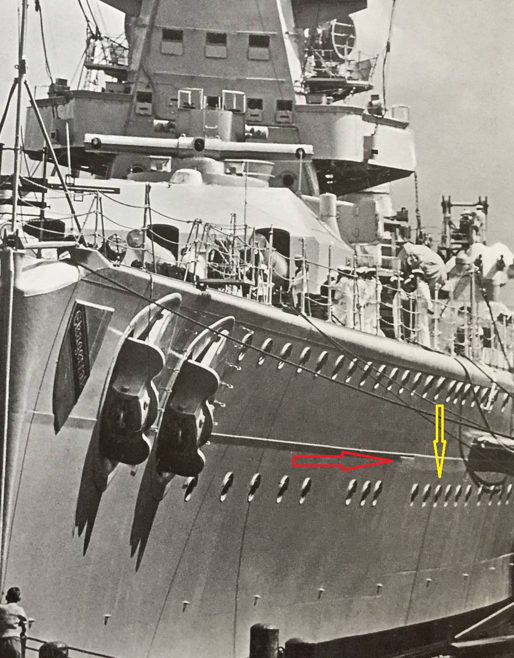

well I nearly missed the armour belt but Dan Banks fortunately directed my attention towards it.
The armour of Graf Spee is more or less well represented on the Trrumpeter kit:
But on the Scheer it was higher reaching the top of the lower row of scuttles - strangely enogh those openings are actually piercing the upper part of the belt:
So my plan is to sand off the original belt, replace it with plastic sheet and re-drill the scuttles, well it will be a long job to do...

totally_random_man wrote:Hello Pascalemod,
Now I follow. It looks less pronounced though? But also, how would you manage to get the bevel edge so well?! I find that is the biggest challenge. Im a bit off put now building Scheer by this inaccuracy, but this is modeling, just a good challenge! :)

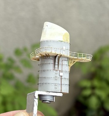

after a brief pause Scheer is back again :-)
the funnel is taking shape, I love the handrails but soon there will be no place left to handle the whole thing...

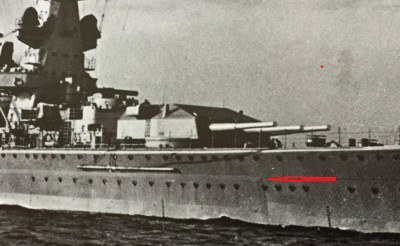

Hard to believe that they would pierce the main belt with scuttles. Perhaps this is a thin upper belt to prevent riddling by splinters?
totally_random_man
Posts: 71
Joined: Tue Mar 05, 2013 2:31 am
Re: Wunderland - Admiral Scheer 1942
Post by totally_random_man »
Fliger747 wrote:Hard to believe that they would pierce the main belt with scuttles. Perhaps this is a thin upper belt to prevent riddling by splinters?
Checking reference material - M.J.Whitley: German capital ships of WW2 and Koop-Schmolke: Pocket battleships of the Deutschland class - did nothing to clarify this issue. There was no data on the height of the belt in the respective ships and the detalis presented in the two books are somewhat inconsistent.

another miraculous resurrection of this thread is here :smallsmile:
The handrails are on, I had to remove the previously installed ones, because the leg spacing was too small and every second one had to be cut out. The rails of the searchlight platform were also installed made of stretched sprue - it is tilted outwards so I coud not use photoetch here.
The miserable job of removing the glue spots is the next step...
