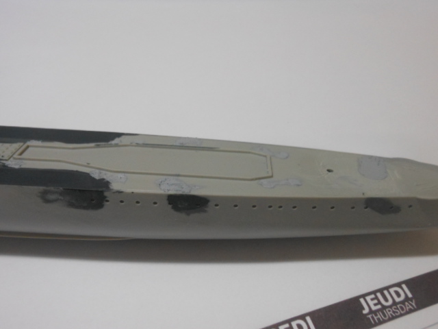

Breakwater finished, forecastle structure ready, and foredeck finished too.
ammo boxes are included in blackcat's set, and also capstan
various vents are leftovers from IJN models slightly adapted, or scratchbuilt
bitts are resin generics

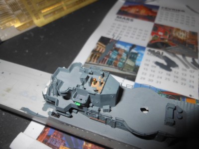

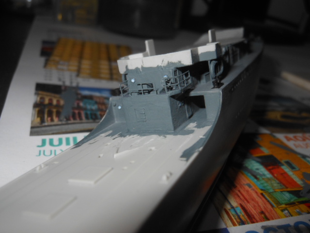

Indeed, everything has to be corrected or relocated, portholes+doors added, etc... !
here, bridge had to be cut/lowered about 1,5/2mm
and then, more corrections to bridge/nav deck :

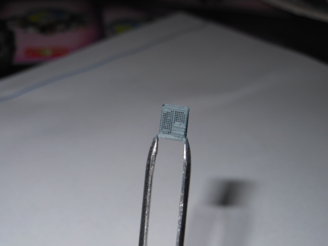

Here some early progress on wind deflectors made with some shipyardworks photoetch leftovers from Dunkerque ship retailored for my needs,and some bulkheads not modeled by trumpeter :
and a better view on finished deflectors :
so I managed to almost finish the bridge and forecaste upper deck but still missing a "covered table" and searchlight directors.

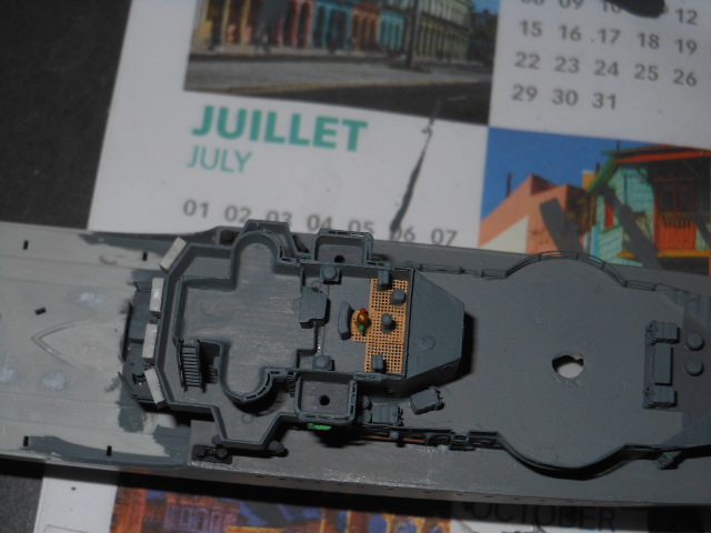

After a "no mood for work" period, I managed to finish bridge and forecastle, with some scratch, 3d printed stuff, and PE leftovers.
next step will be trying to redo the semtex way, as it is normally more outward, and 16ft dinghy position more inward.

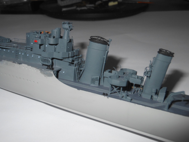

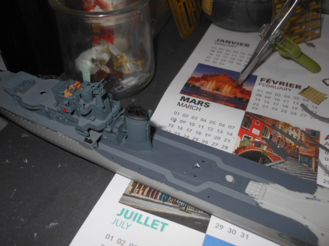

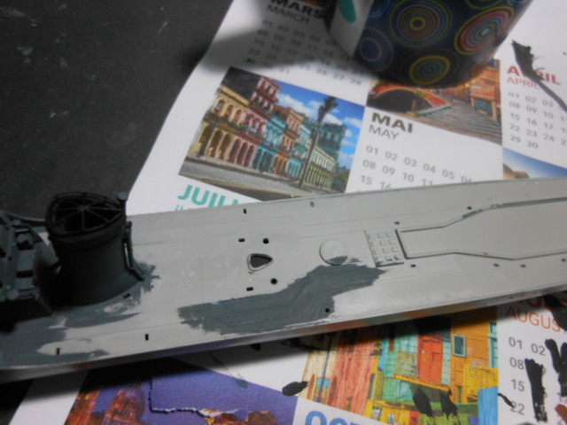

by the way, funnel #1 in place, after adding some scratchbuilt tubing, as Trumpy once again had wrong ones.
and semtex gangway on main deck has been also reshaped.
pretty happy with results. made with paper and very thin CA glue.
Obviously, it will be clearer when properly painted and contrasted with dark deck color.
current paint is just for quality control.

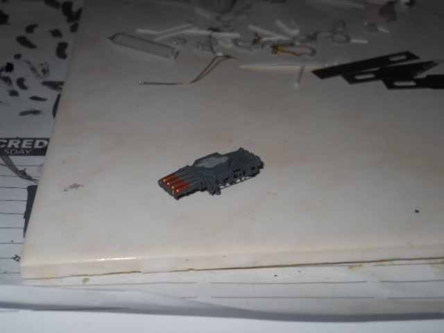

I also had to add a skylight forgotten by Trumpy :
and blackcat 3d armament included in dedicated Tribal early war set :

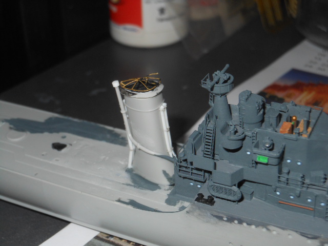

rear funnel ready for painting

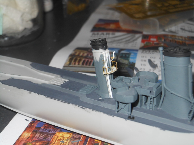

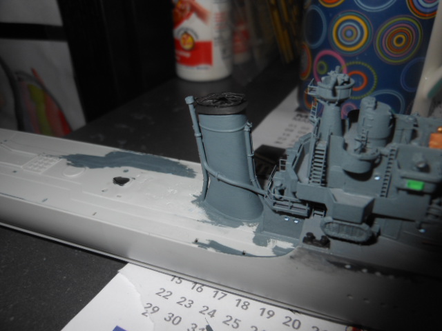

ok second funnel done, and various deck equipments in place
note that winch is scratch (not included...), and small crane is a leftover from an earlier project, as shape is far more better than inbox one.
the "hood" (?) at the rear of the last funnel is done in paper soaked with thin CA glue, and again, was not included.
timber reserve is done with not used inbox funnel piping (yes !).
and here, rear part ready to be sanded, as each locator hole has to be filled, as every ammo box, hatch, door,... has to be relocated or even replaced.

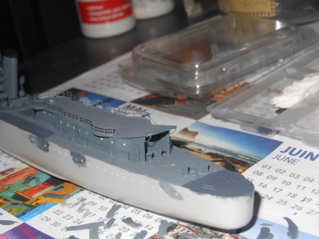

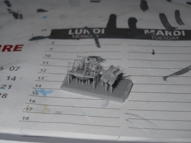

not really a detailed building blog, but at least some pictures of progress so far.
rear structure done. i am still wainting for some 3d printed stuff from micromaster for a vent.

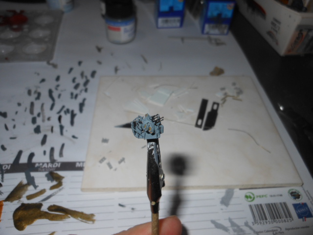

and here, 3d printed quad pompom from blackcat's set.

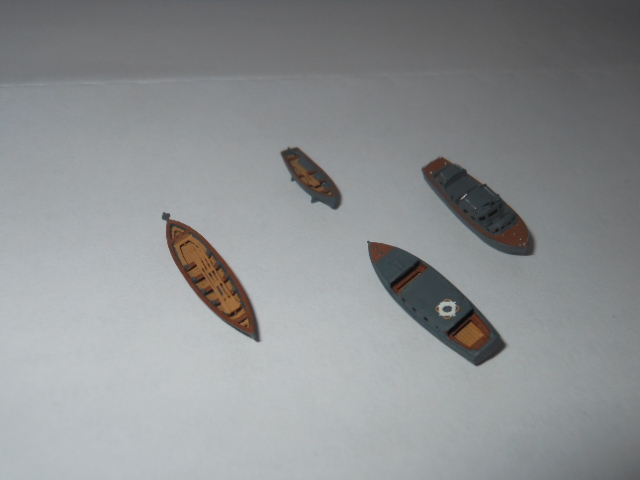

Re: Tribal class (1/350 Trumpeter)

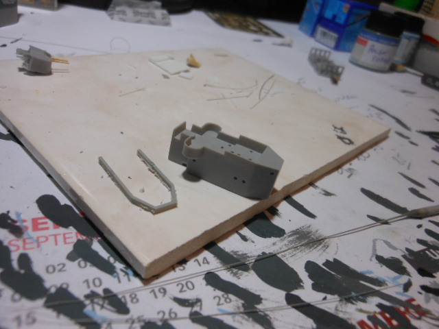

again, not so much "during build" pics, but at least some progress :
ship's boats are done (black cat set + some old generic PE (WEM i think) rows) : and I received bitts & chocks + engineers workshop vent from micro master :
