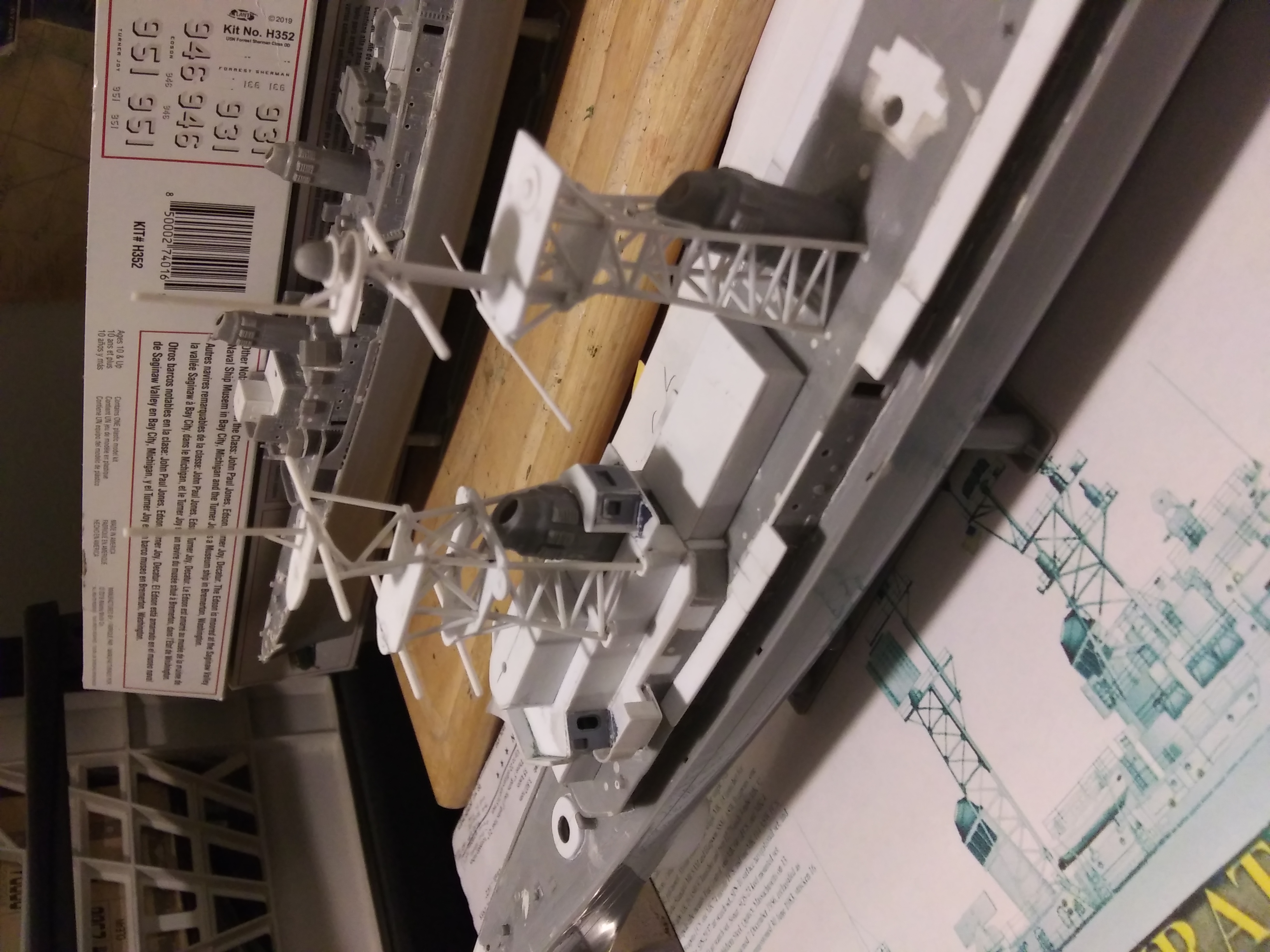

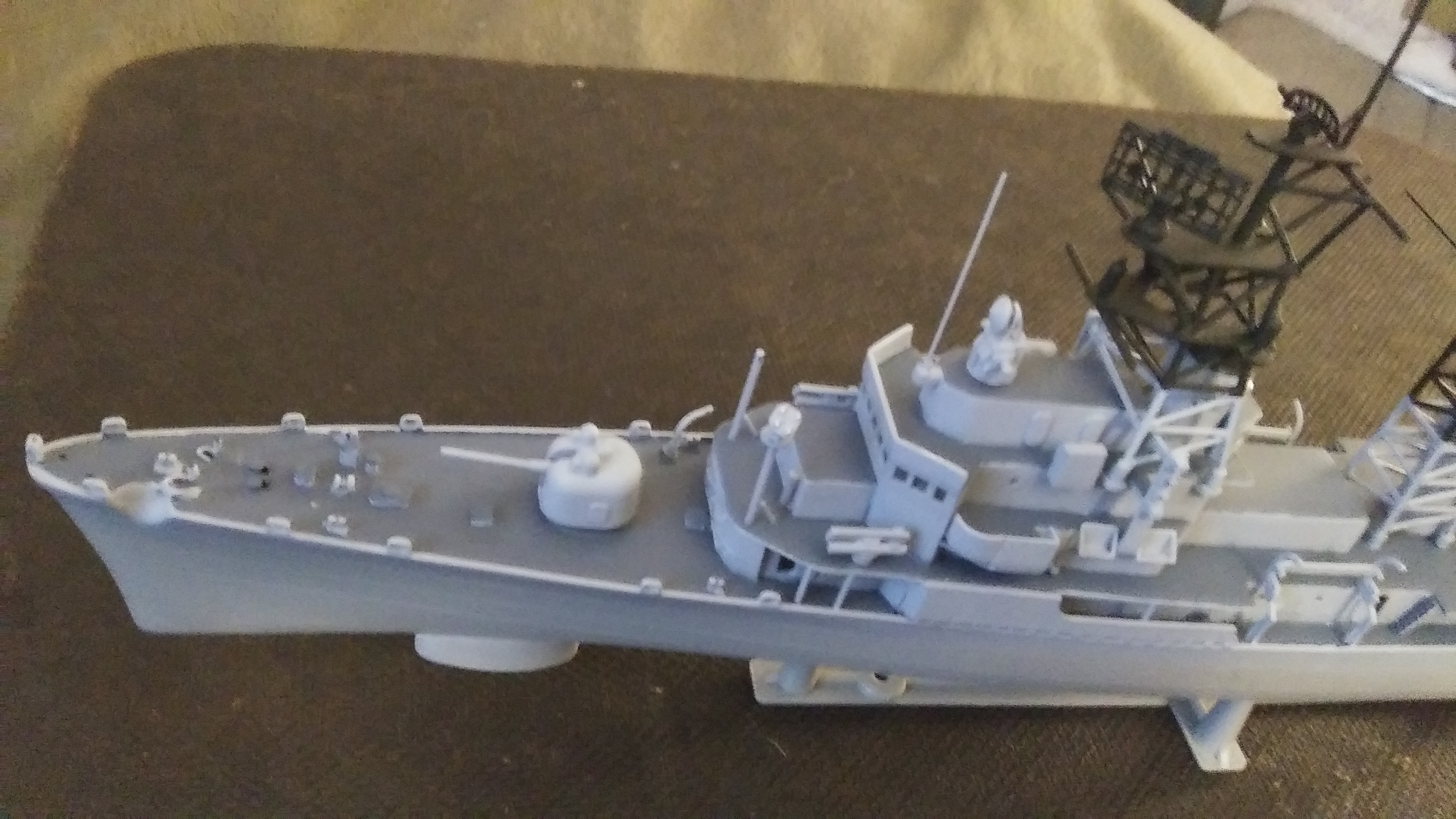

Modified the two mast's, made changes to the layout of rigging-poles and the brackets that connected to them. Thanks to DavidP for his input.

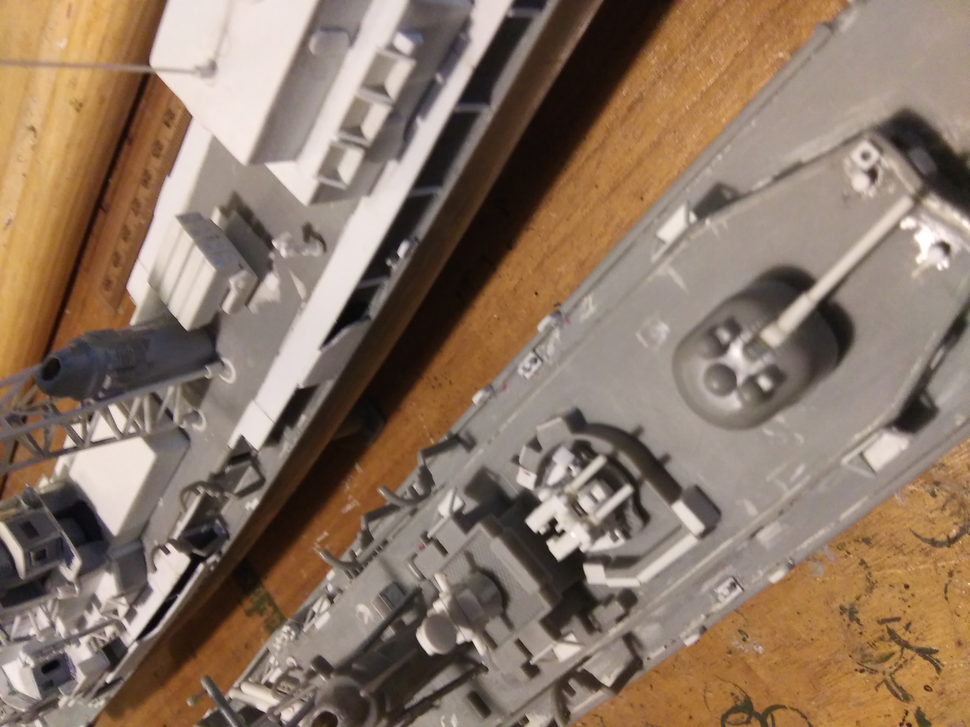

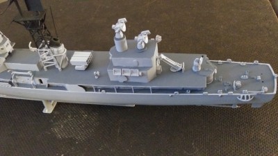

Scratch built few more items to add to the build: FAST replenishment crane, Asroc crane, antenna/mast poles in front of the original fwd 3"/50 location, lengthened the upper deckhouse that above the bridge/pilot house, set of ULQ-6 DECMs, the one in the photo is not glued down there to show.

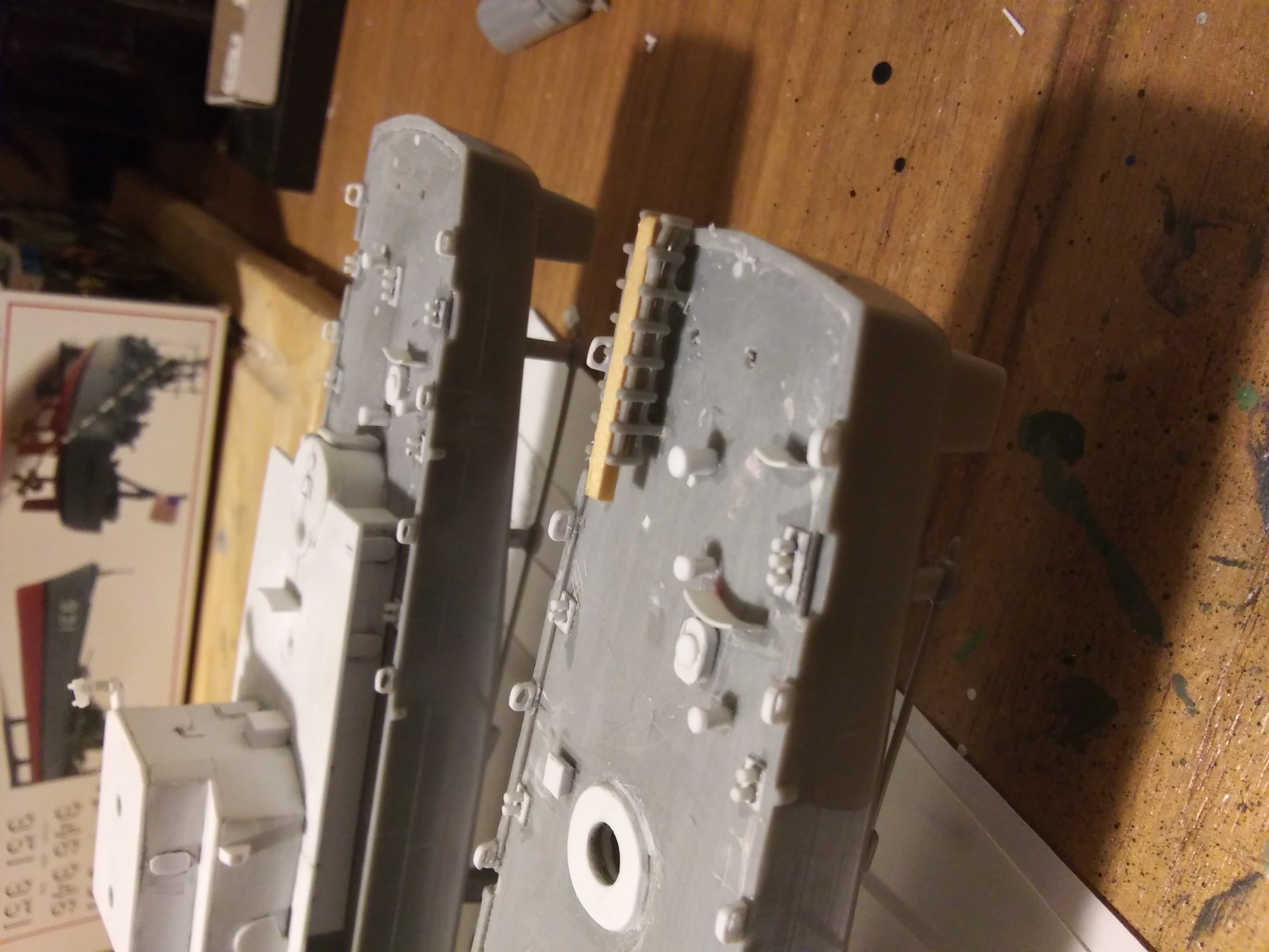

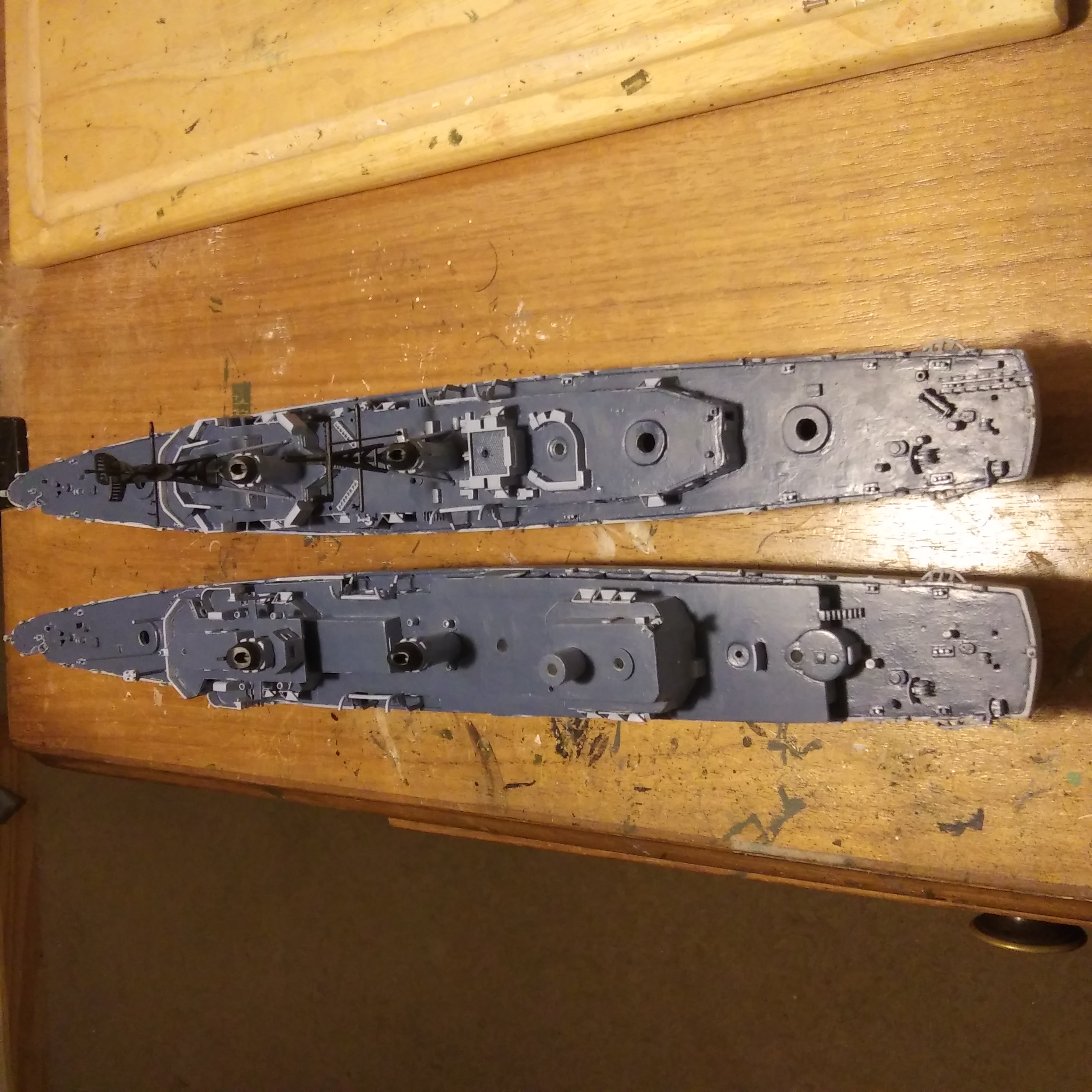

detail work on deck, added bitts and chocks (not know size ? using bolard/bitts height as twelve inchs = 1 mm 1/320 scale), added doors, did some repairs, added satcom antennas to the DDG (OE-82 earlier version with square shaped antenna, as opposed to later version with circular antenna) based on online photos, next step is do some painting in selected areas before gluing the mast down, scratch built a few life raft racks,(was confused on this part thought ships had floater net racks, looking online see that there was a change after WW2, racks with a raft, this is before the egg shell types used today, not in photo, next post should have the mast glued down and radars and other ship systems in place before overall primer/painting.

Re: Forrest Sherman class DD/DDG 1/320 atlantis-revell

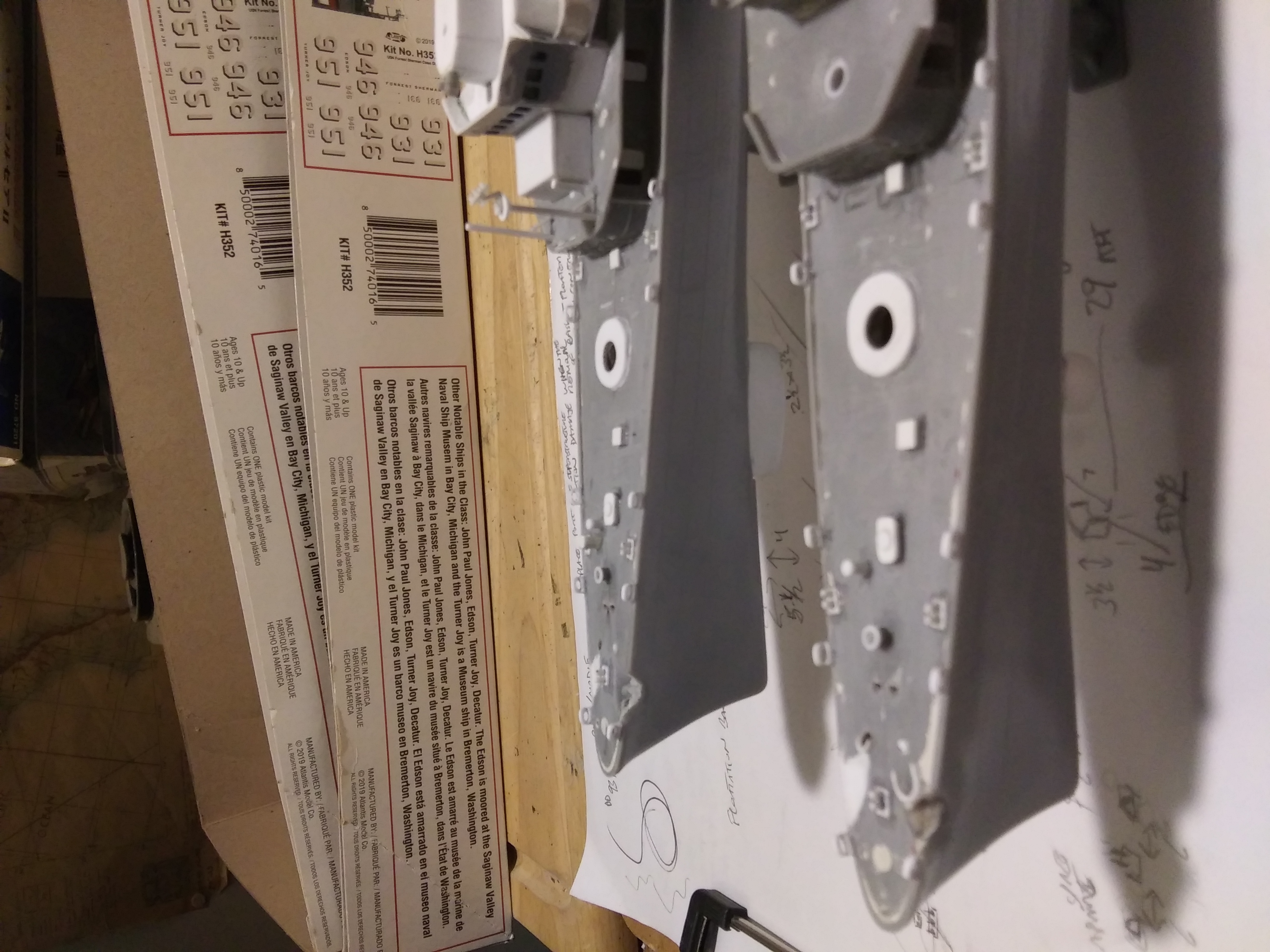

update" did not like the way the bollards and bitts looked so removed all of them, and replaced them with thicker and longer ones, and removed deck hatches/misc stuff and replaced with different ones.

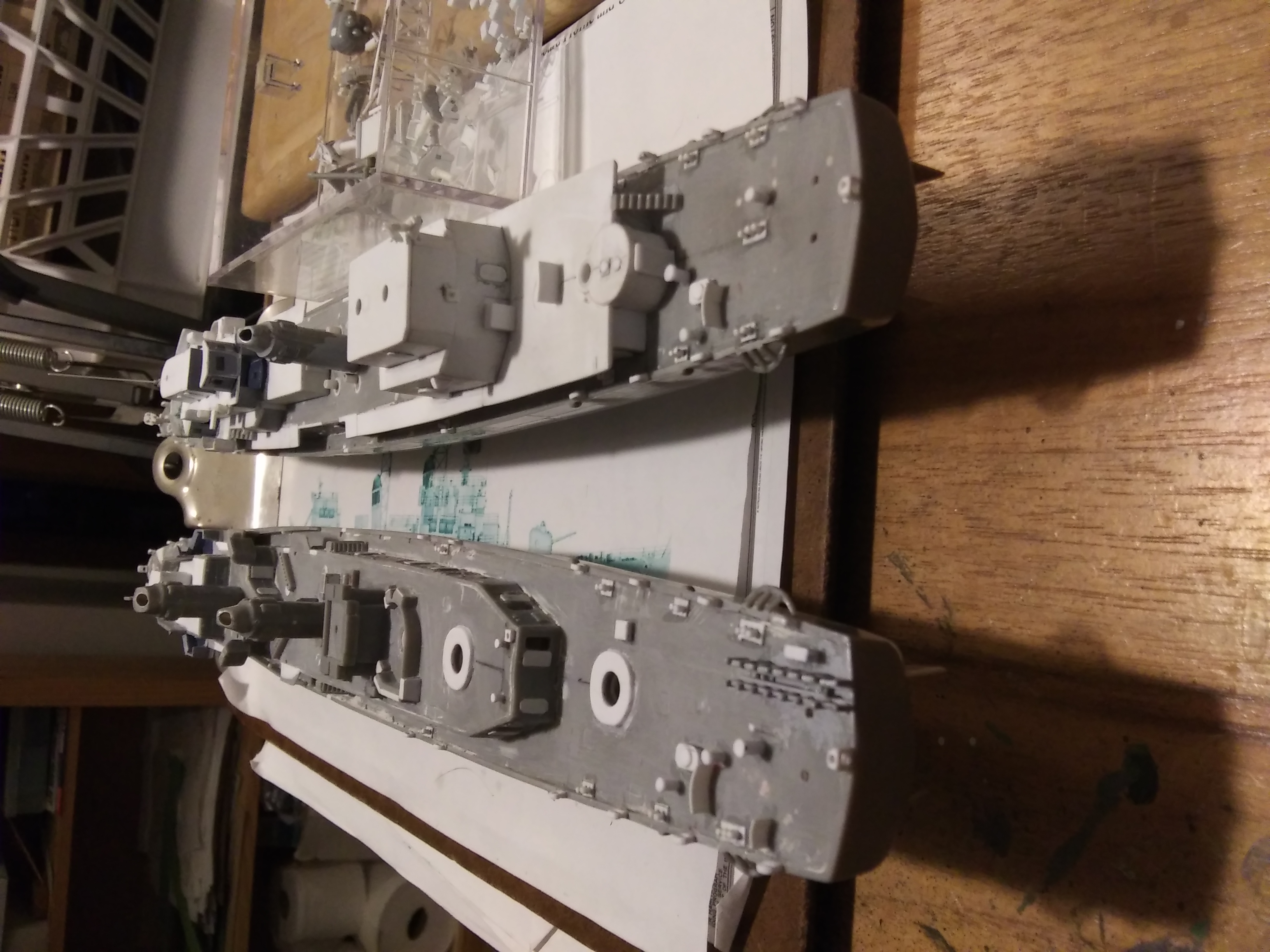

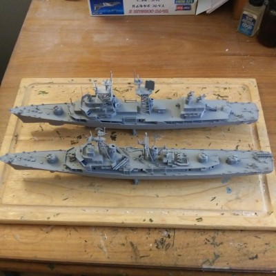

posting last photos before overall primer/base coat, added bridge to DD, and more deck fittings to both, reduced part of L2 deck on DDG to make room for stairs by boat davit area, now plan to spray primer/base coat overall and then add remainder of the ship's systems.

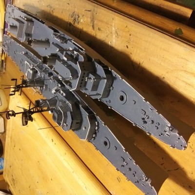

getting there, closer to spray overall primer, more systems glued on, and did some repairs

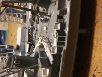

Added few more details to the DD, replaced the mk4 dropside ASW torpedo lchrs, first set was damage tried to repair them , made mess with super glue, so I scratch build another set, added some detail to 3"/50 gun mounts they had a void below the guns, detailed the whale boats, to look more like a motorized whaleboats, next step is to detail the rectangles that represent the liferaft bungles, the add them to the life raft racks, add flagstaff/jackstaff *Not decided on the railings, was thinking of scratchbuilding the railings instead using a photo etch set.

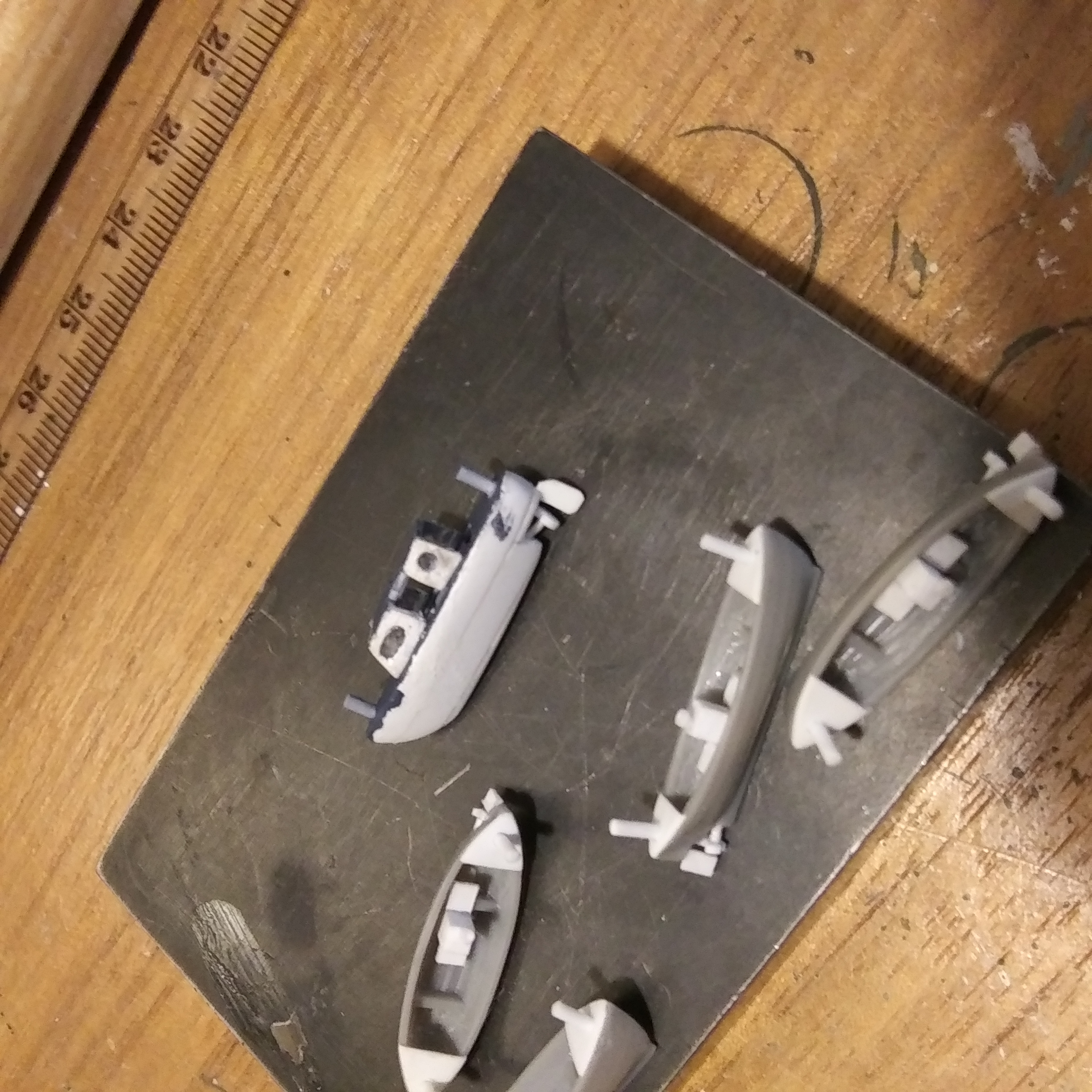

scratch built a ship's boat to add to the DDG

For what it's worth, the holes for the anchor chains are called "hawse pipes" going from the deck to the anchor mounting locations, and the holes going from the deck down to the chain locker are called "chain pipes". No matter what you call it, you have them looking right.

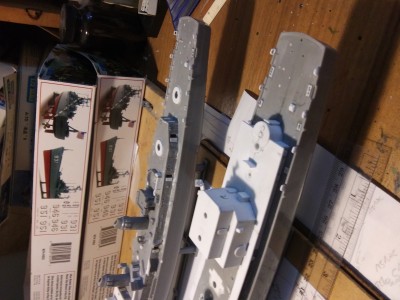

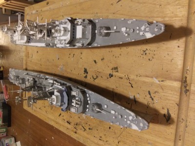

Started to paint the DD.DDG builds, included photo in the is Monogram 1/228 Skipjack SSN waiting on overall primer, and 1/700 scale CF.Adams Class DDG over 20 years old in need of repairs/replacment parts, 2nd photo my stack of ship models Under the work bench in waiting: two Revell 1/542 Forrestal class CVs, four Renwal 1/500 DDGs(King* this kit is incorrect looks more like an Mitscher class, has the aft mk42 5"/54 replaced with crude Terrier Msl lchr, has no fire ctrl, this will be a interesting scratchbuild correction), one Atlantis/Revell 1/490 Pittsburg CA, three Renwal 1/500 Springfield CLGs(*this more of a Cleveland/Galveston class with aft 6" gun turrets replaced with crude Terrier msl lchrs, and no fire ctrl another kit in need of scratchbuild correction), one Monogram 1/500 Chicago CG, one Revell 1/253 George washington class SSBN, five Revell 1/530 CVs Essex class 27A-C/125, one Renwal 1/500 Essex class 27C/125 CV, one Lindberg 1/525 Tanker. * the kit corrections needed for the Renwal DDG King kit and Renwal CLG Springfield kit might be a interesting post for discussion?

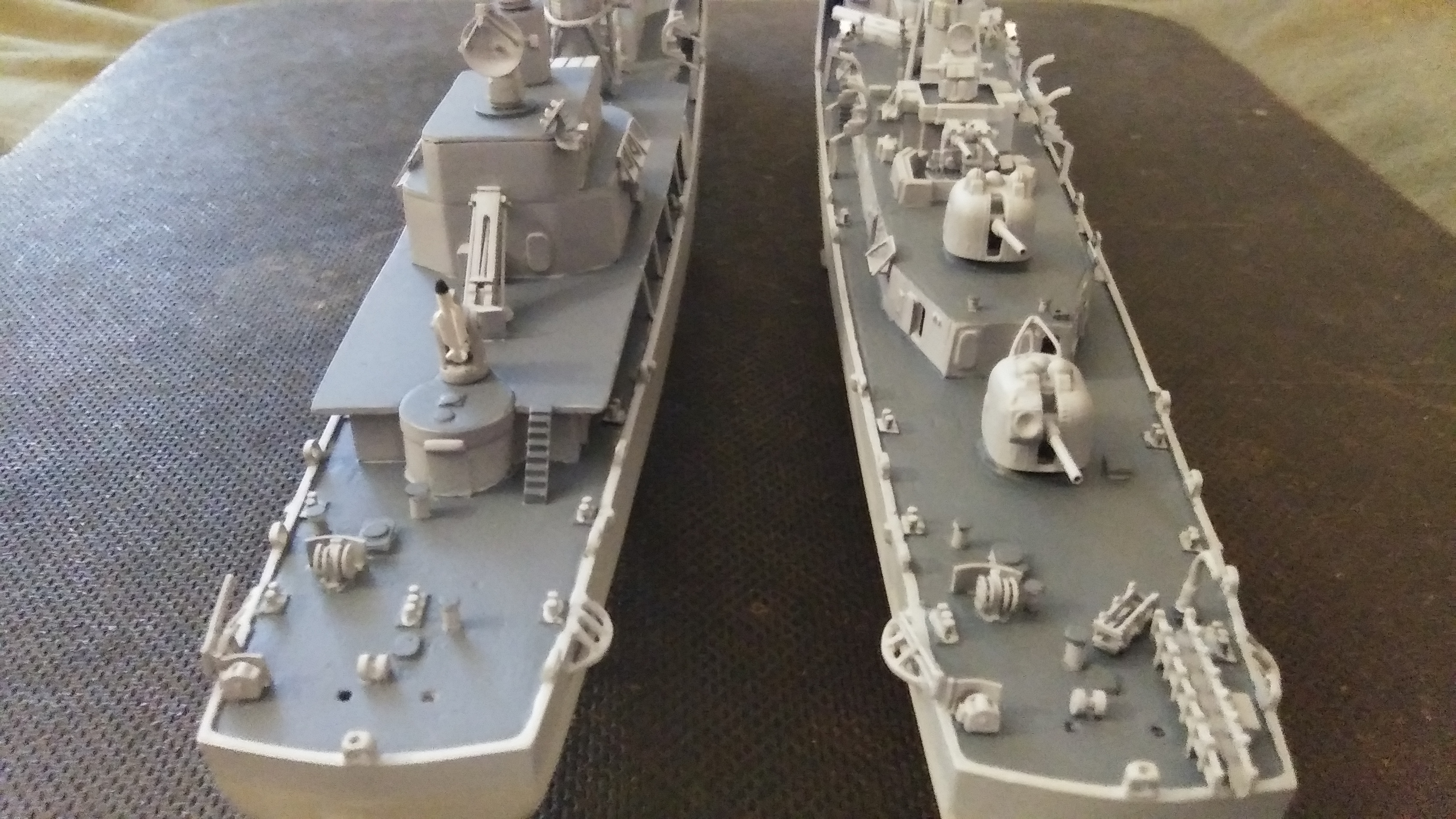

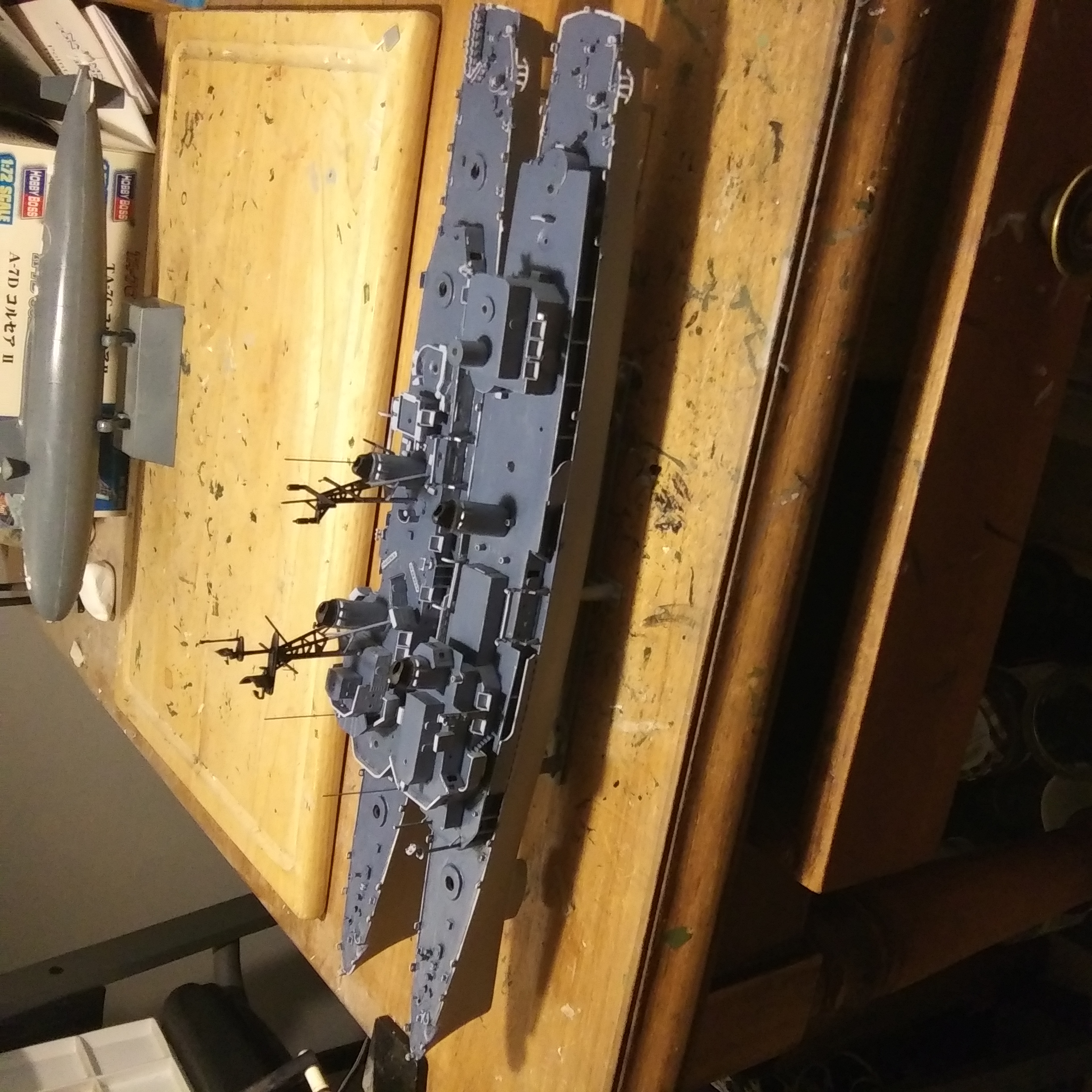

Main deck and higher mostly painted, still in the painting phase

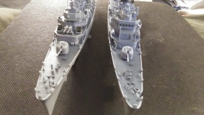

build status: about done from main deck and up, next is to paint the hull below the main deck, will add the flag staff/Jackstaff, ship's boat, and life rafts after done with painting the hull.
