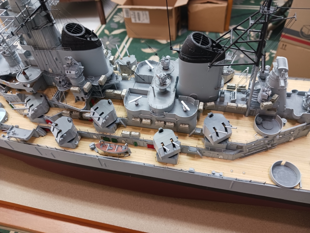

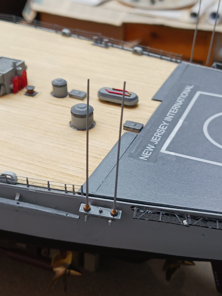

My Yard Availability period is now complete - a resounding success!! :thumbs_up_1: The following items were replaced during this short period:
(10) 5"/38 Dual Gun Mounts
(6) Mk. 56 Fire Control Directors
(4) 5" ZUNI CHAFF Rocket Launchers
(2) 6 pdr Saluting Cannon (added)
(2) UHF Antenna Platforms
All of these parts were 3D Design/Printed with a much higher level of detail than my own scratch built, original kit, or 3rd party purchased parts had which has given the model a much more detailed look. This was one of the main goals of this mini-project. Here are some photos of the completed overhaul -
Compare these photos with the earlier photos I posted prior to the replacement of these parts. Only thing left now is for requesting assistance from "The Admiral" for help in replacing the display case and then moving the model back to its proper location. I'm hoping that after self-DOGEing, the processing time for this request will be in days rather than weeks! :doh_1:
