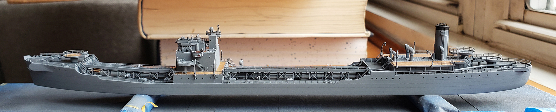

Looks great as always, Dan. Couple quick questions:
1. What size tape are you using to simulate the hull strakes? 6mm?
2. Are those cowl vents after market or stock kit parts?
3. How do you bend the plastic rod so precisely for the oil feeder pipes on the deck? Do you heat the plastic first?

Hey, Greg -
Strakes - Hmm. Probably 2.0mm or 2.5mm tape. I'm out of town, so I will measure when I get home.
Kit cowl vents. Drilled them out slightly.
Bending rod - I'm embarrassed to say that it never even occurred to me to heat the rod slightly.
Bent slowly by hand. I don't recall the diameter, either, but I can measure that as well.

Greg, it turns out I used Micron tape that is 1.5mm wide for the strakes.
Next came the catwalks. Note that these were not quite the same lengths as those carried on the Kawasaki class. The front catwalk is shorter while the aft walk is longer.
I used the Fujimi trestles from one of their Kawasaki class kits, plus V grooved styrene for the extended walkway and U-shaped styrene for the base of the original pathway. There was enough railings to do line some of the catwalks, but more had to be sourced from the GMMM IJN railing set. The forward section required some trimming of the trestle footers to fit properly. It might be possible to use the catwalks from the Tom�s PE set for the Kawasaki type tankers, but adjustments would have to be made, particularly for the aft catwalk.
Description and drawings indicate that these catwalks were much like those on the Kawasaki types after their conversions to UNREP capabilities. As opposed to the following 1TL tankers, which utilized only an aft section and the basic catwalk structure with no outer walkway addition.
