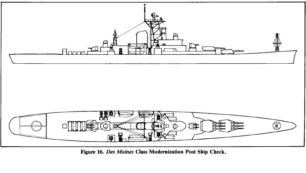

Sauragnmon wrote:If you notice, all the ABLs are facing the same direction - I have a feeling they're double-stacked off the broadside like the midship Iowa position. As to trying to justify it, well, let's just say that Shipbucket's forum is populated with 95% Carrier Humpers, 4.5% Sub humpers, and me as probably the Only Gun Club member when it comes to warships. They all think carriers are the greatest thing since sliced bread, sipping the wrong koolaid. It's gotten to the point I don't even bother posting on half the stuff there, since they can't wrap their heads around the reality of a true, armored gunship in the modern world.
Well, the nature of the Shipbucket post-ers might be aside, who ever made that drawing must have seen the article I have read. It is very accurate to the modernization Configuration 3 that was proposed.
I think the problem was that they were trying to fit the same weapons payload aboard the Des Moines as they did the New Jersey. At this point, they were operating under the belief that they were going to have to have 8 ABLs and 8 Mk141s in addition to everything else. Because the Des Moines only has 57% the deck space of New Jersey, that was a real challenge. Also, because the proposal was before the days of VLS and a knowledge of how to apply VLS to a ship not built around it, this version of the ship was initially and officially proposed. I am sure that as the project evolved, arrangements would have changed, maybe all the way to Mr. Grubb�s concept. The arrangement in the illustration, however, was done by the same guys who came up with New Jersey's arrangement. So, I would cut the Shipbucket guys a little slack on this one. They got the modernization right on the money.
I know there is a belief out there that the Des Moines were going to act as "consort ships" with the Iowas, and that was going to call for an entirely different modernization. It would have still replaced Turret 3 but instead of with Tomahawk ABLs, a massive helicopter hanger to host all kinds of helos both support and attack. She would also have the Sea Sparrow of the date. Beyond that, I don't know what kind of missile armament this version would have had.
A logistical problem with these ship, it seems from this article, is that they were designed without a lot of margin for upgrades. They are near their top-side weight and internal volume (more volume than top-side weight). This coincides with my discussions with NAVSEA about a modernized Des Moines in 2006 and how we arranged the VLS, flag, ECM, and CIWS arrangements. We would have used the hanger instead of making office spaces out of it.

So, since the Sea Sparrow is fine for the Des Moines, where would you suggest we put Sea Sparrow launchers? Say if the Newport News was refitted instead of decommissioned or either Des Moines or Salem were reactivated in her place, how would you make the following modifications:
8-16 Harpoons,
2-4 Phalanx
SPS-49
Sea Sparrows
I am curious what such an austere modernization might look like and not the big daddy VLS modernization I did with NAVSEA.

For the NATO Sea Sparrow, the following would be needed:
1. A primary search radar -- AN/SPS-49
2. The Mk23 Target acquisition system (a smaller 2D radar)
3. Illumination Radar sets -- 2 Mk91/95 pairs.
4. Two Mk29 guided missile launch systems.
5. Magazine for 16 additional NATO Sea Sparrows
Probably the stern pair of wing 5"/38 guns should be removed for the NATO Sea Sparrow systems.

For a 1980s fit...
I see where the Harpoons, Sea Sparrow and illuminators, SPS-49, and Phalanx could go aboard the Des Moines-class, but what about the aft hanger? I know the hangers were poo-pooed on the Virginia-class cruisers, is there any reason to the knowledge of the posters here why they could not be used aboard the Des Moines?
Also, specifically for Seasick, to your knowledge, would any kind of 3D radar be needed in order to que the Sea Sparrows?
Thanks, guys!

navydavesof wrote:...what about the aft hanger?
Do you know the size of the hangar opening? Remember, the Seahawk is 65ft long and those hangars may have been designed for a smaller helo. Just a thought...

The hangars on the heavy cruisers were designed to accommodate the float planes of the time; OS2U Kingfishers and SC-1 Seahawks. Both were 33' 10" and 34' 5" in length respectively. The SC-1s could fold their wings and by the time the Des Moines class commissioned were the only floatplanes still in service for the newer CAs. Each CA was designed for 2 cats and at least 2 if not 4 floatplanes. Whether or not the hangars were designed to accommodate 1, 2, or 4 is the big question. Do any photos of the interiors of the hangars exist? Did they extend the full width of the fantail or were they only wide enough for one floatplane? I'd guess though if you wanted to fit an SH-60 inside they would have to enlarge the hangar hatch and possible the hangar itself. That means cutting through deck armor, not always a good thing to do but definitely not impossible. You just have to know what you're doing. Even an SH-2 Seasprite is 52' long so I don't know if one of those would fit either. Just my 2 cents. Hope that made some sort of sense.
Drawing Board:
Slipway:
navydavesof
Posts: 3127
Re: Modernized USS Des Moines/Salem/Newport News
Post by navydavesof »
Cliffy B wrote:I'd guess though if you wanted to fit an SH-60 inside they would have to enlarge the hangar hatch and possible the hangar itself.
so what about the SH60 with its tail folded? :smallsmile:
