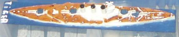

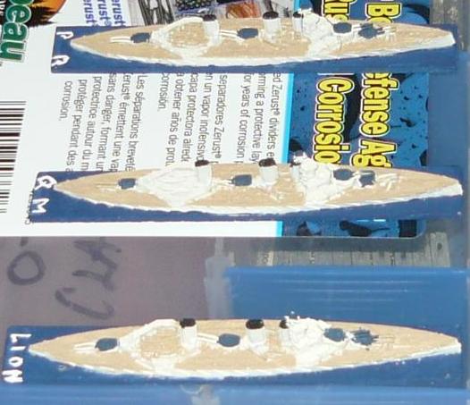

I don't know of larger models but I brought picks of my 2400 scale - Lions & Tiger (the tan & brown I traded for) - sorry, the glare from the White makes the detail hard to see.

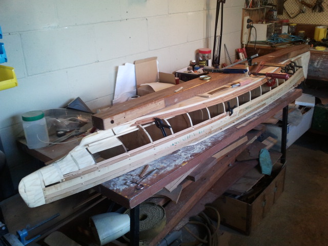

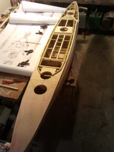

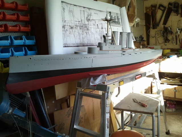

Photos: I hadn't included other progress photos as they look pretty old-hat, but here are some showing the hull construction
- Planking is underway. Apparent are the block structure for the bow and stern, and the many frames. I have about 30 spring clamps and used them all at times, plus some quite heavy carpenters clamps. All were called into action at some point or other to get the planks to conform to shape. The hull base is screwed to a 100*50 hardwood (old bed rail) to keep it straight
- This one shows the fo'c'sle deck on and the structure of the removable deck which extends from 'B' to 'Y' turrets.
Just forward of 'Q' turret ring can be seen the bulkhead that separates the motor room from the old boiler room which I hope will house some sort of smoke generator. The quarterdeck will be fitted once the rudders are in and set up.

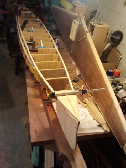

Rudders: yes, they were inclined.. it seems to have been a battlecruiser characteristic as they needed to fit the mechanics around the top of the shaft within the narrowing hull at the stern... to fit them in they needed to incline the rudders.

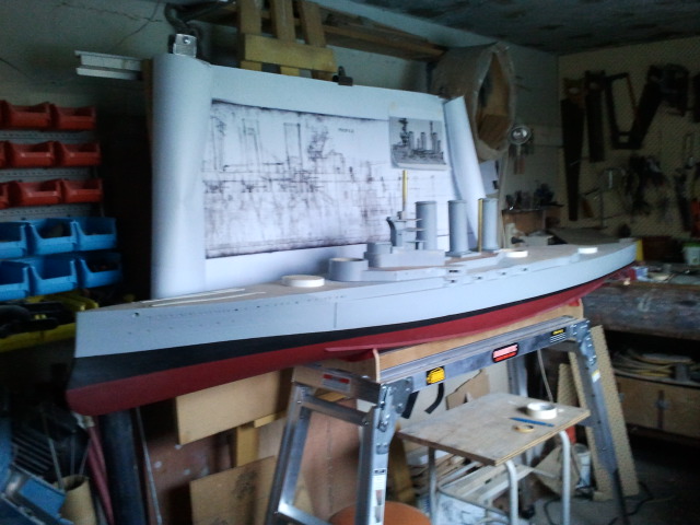

Initial paint done, the grey is too light I think. The basic structure is complete ports are drilled ( I have made so far some 60 portholes; ie about half) and all machinery is fitted.

p.s. I think the grey is OK. You don't want it too dark.

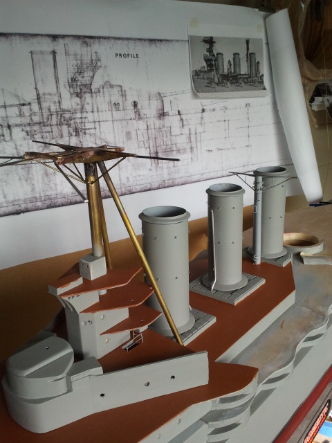

New progress pictures
I changed the grey, making it a little 'greener' rather than darker. I have seen models of battlecruisers at the start of WW1 and they are very dark, too dark I suspect.
The mast spreader or 'starfish' was a bit of work, but is looking ok. Next job are turrets
Right on target for Dec 15th launch. I have had motors running but need to beef up the power controller.

Well at least you found it. The model looks good! I like the conning tower area!mauricejob wrote:Turret Designations; For "Tiger" I guess I have the definitive answer. The barbettes are marked AB and Q on the Main deck plan. The fourth barbette is below the main deck and I hadn't looked, but it is marked as "X" on the fo'c'sle deck plan. This is odd, as it does not of course belong on that deck but the plan convention is to show internal and external detail of the deck in question and the outline of the next deck down. The fo'c'sle deck shows "A barbette" and the shelter deck shows "B barbette" and "Q barbette" (The barbette is the armoured trunk below the turret) with the outline of the fo'c'sle deck. In the case of "X", it is labelled in the turret or gunhouse, ie different to the others. So I missed it, I don't have deck plans below the main deck and it's not marked on the profile.
Re: the grey: I always think the dark grey models look odd, but that is personal taste.
You have to take into account the phenomenom that as the model is smaller than the original, if you want an accurate tone you need to make the paint a touch lighter in tone. You can't use the same shade of grey as the original it they then become 'too dark'.
What scale is yours, Mo? Mine is 1:144, it's 57-ish inches long. As soon as I think of moving it something breaks off. I made things with this in mind so things like the flagstaffs have 'give' in them before breaking. Yours looks to be quite big. What year or era are you depicting? With the mainmast you've made, I take it you are going for 'as built' or early WW1?
