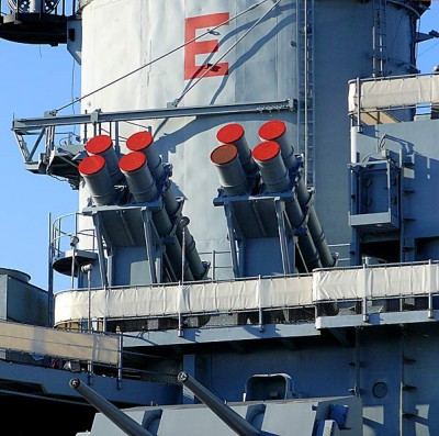

Canted would be the way to go. You don�t want to have a Harpoon rocketing past the entire structure when you fire one. The issue with the Mk141 canisters is that they are rather vulnerable to all kinds of weapons fire. As they are, a strafe from one of my .50s could take out a whole launcher, and fragments from missiles being taken out by the various CIWS mounts would likely shower exposed launchers and damage the missiles inside. The way to protect against that is to build splinter protection around the launchers so at their angle the missiles still clear the walls on launch. Essentially you would build a splinter tub around the launchers.Russ2146 wrote:I was thinking that VL Harpoons would be an assumed reality...Otherwise, how about going Russian with them or on 01 Deck, on the outboard edges, parallel to the centerline or canted outboard, between 8" mounts.
Like I said earlier, amidships between the funnels would be an excellent place for a battery of Harpoons and on either side of the aft stack, I would put two more launchers on the back half of the stack. I say the last half, because that way when you shoot the missiles you hopefully won�t blast a bunch of exhaust inside of the rear air intakes.
Amidships: I would have two or three of these tub structures and Harpoon arrangement positioned between the stacks. The walls in there protect the surrounding missiles from a sympathetic detonation (a detonation caused by a perfectly lucky white hot fragment to the warhead) of a missile in its tube. These 8 round batteries you see here separated by these walls would prevent the blast and fragmentation from the above case from damaging or destroying the ones next to it, or all of the surrounding missiles in that case. Here, only 8 missiles would be affected. Aft: The aft arrangement I would double the arrangement Iowas had during their last reactivation in similar tubs, so 2 launchers in each tub for 16 on each side. This would give the ship between 32 and 48 Harpoons.
Overwhelm with missiles. I know the Russians have gone to the trouble to put decoys and jammers inside the missiles. I don't think that's a Harpoon thing. Unfortunately, overwhelming with Harpoon is done with �more targets� so more missiles. If the Harpoons have ECM jammers on them, great! However, I don�t think the Harpoon is cool enough to have any decoy systems. You have to overwhelm the targets defenses in order to score a hit, so lots of Harpoons are necessary."It will require quite a few Harpoons to overwhelm the target ship's defenses." Overwhelm with decoys??
Absolutely I would keep them. They are enormous armored tubes that can hold all of the electrical conduit that runs up to the radar and range finders. Keep in mind, redundancy is essential if you expect to take hits, so both forward and aft ones would be a very good idea. If it were nuclear and the helo deck overtook that area, I would arrange a new aft range finder either in front of the hanger in its own structure or on top of the hanger. I would keep both original optical range finders, too, but replace the range finding radar with something current like a SPG-60 or something. In the nuclear version the optical would move accordingly. I would expect battleship to need its redundant systems.Are you going to need both of the main battery director towers?
