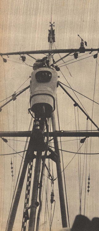

Can anyone point me to a clear photo or illustration of what appear to be an enclosed crow's nest with a big forward window that Kagero class carried high up on the fore mast before radar installation?

Not sure that the opening was enclosed but ........

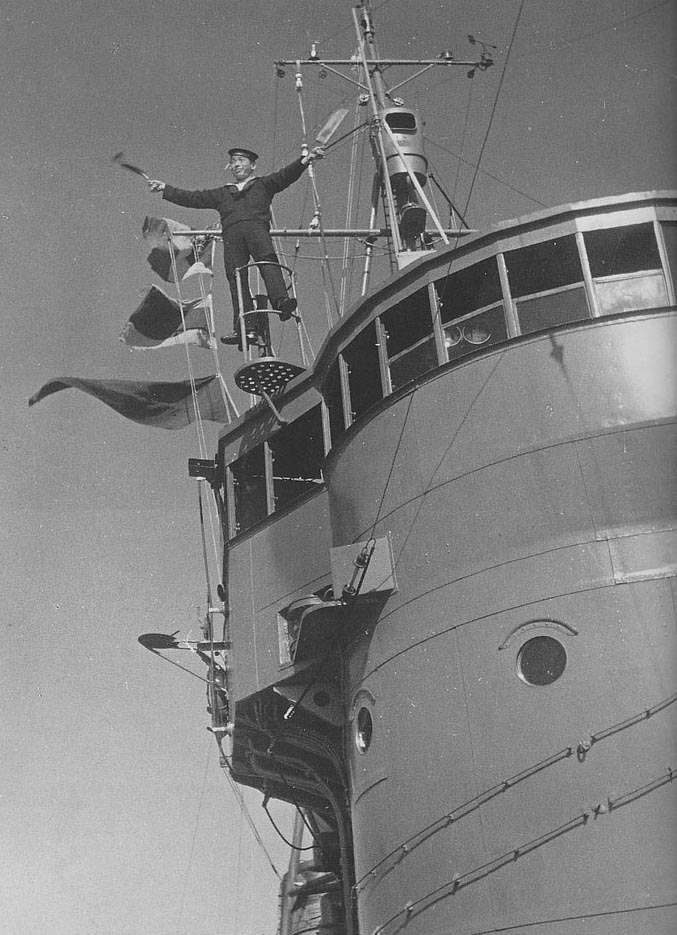

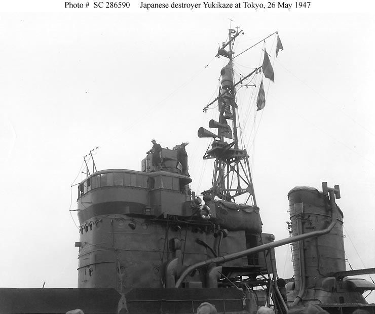

The lookout position design appears to be identical for all DD types. First photo is of a Kagero type foretop circa 1942, the 2nd is of Hibiki prewar, via Fukui. Lastly is Yukikaze postwar via NHC.

I am also not entirely sure it was a crow's nest. The single large window forward would make it hard for the lookout in it to see out to the side and immposible to see out to the rear. Who would perch a lookout so high up on the mast and then allow him to only look straight to the front?

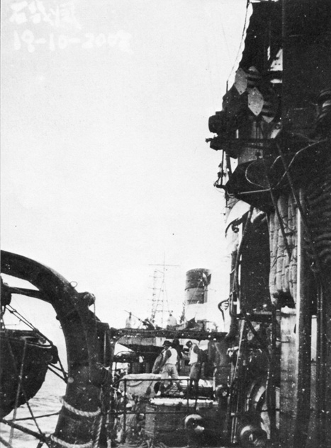

Below is a view of Isokaze in Oct 1944 at Brunei, right before Leyte Gulf. View is looking aft from the starboard side of the forecastle, right next to a cutter and the bridge.

I'm not certain that any of the 25mm singles have splinter shielding at the sides of the main deck until after Leyte Gulf. I believe this was a development afterwards for the remaining DDs.

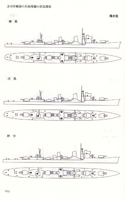

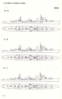

To help with her AA layout as of late summer 1944, below is a sketch of 3 of the Kagero types by Shizuo Fukui. Nowaki is at the bottom. To paraphase what I just wrote about a similar sketch for Fuso:
>As a naval constructor, one of Fukui's assignments was to sketch the AA layouts of various remaining IJN ships during the summer of 1944. These were all published in a series of very hard to find ship type historys in Japan. These sketches are considered authoritive as they were made first hand by someone whose job it was to know.<

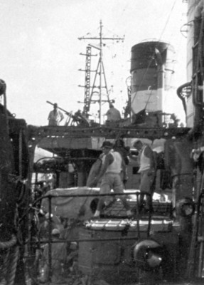

One more thing, if you really, really want to be accurate. Contrary to misinformation perpetuated by virtually every 1/700 & 1/350 IJN DD kit (except the new Ayanami), none of the late war ships had metal splinter shielding around the twin and triple 25mm AA emplacements EXCEPT the Yugumo and Matsu types. Prior to those, everything is canvas and rope splinter shielding. The kit manufacturers keep mistaking taut, stretched canvas for for metal shielding.
View the crop below from the same Isokaze 1944 photo. This is a closeup of the starboard triple 25mm AA mounted in front of #2 funnel. Take a good look at the sides of the emplacement. There are several other examples available from various ships and classes.
Bonus, if you look under the left edge of the emplacement, you can see the front ends of damage control lumber stacked on a light scaffold attahed to the aft deckhouse, starboard side. Also, the men in the foreground are standing atop the starboard bank of forward TT reloads. The #1 TT mount is the larger, tarp covered object behind them.
Isokaze-Hamakaze-Nowaki official refit drawing, Shizuo Fukui v#5, DD story, p273.jpg
