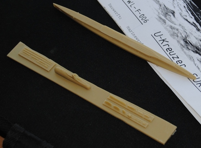

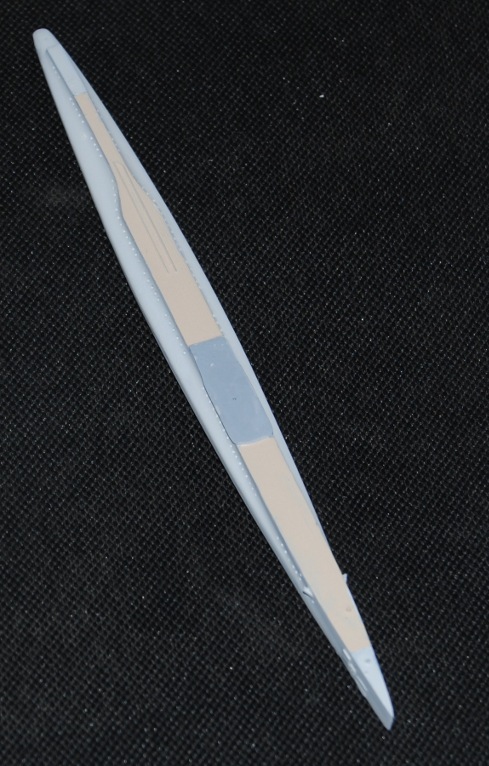

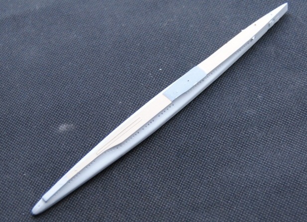

Surcouf after the first weekend.
The kit is really primitive, it came in a zip lock bag which Hans provided and consists of a hull and a thick layer of resin on which the kit parts are cast. Hull and superstructure seem to confirm reasonably to the drawings of the "service historique". The aircraft 27mm guns look beautiful , I have my doubts about the rest of the small parts.
After cleaning up and priming I've started to paint the hull. The kit seems to be based on her early 1930' configuration so I have painted her accordingly. Still looking for good references for the boot topping.

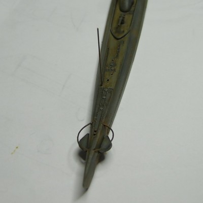

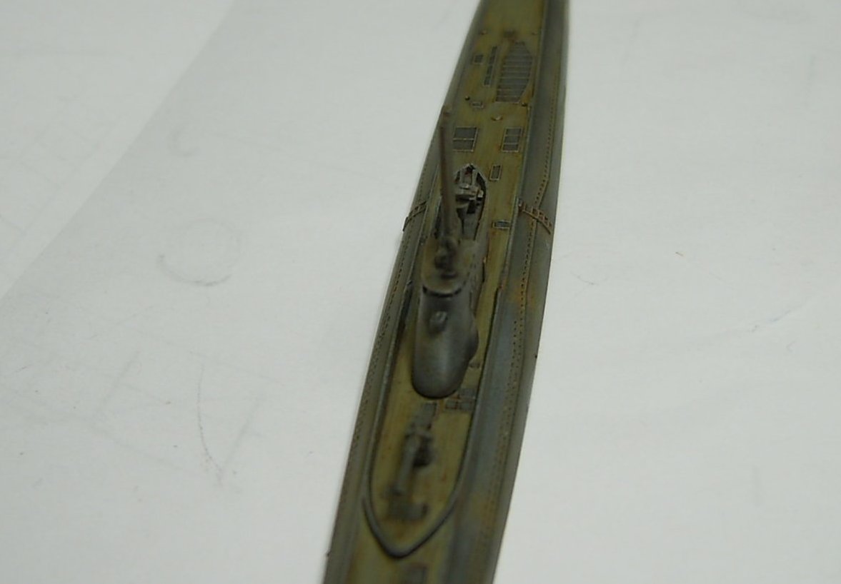

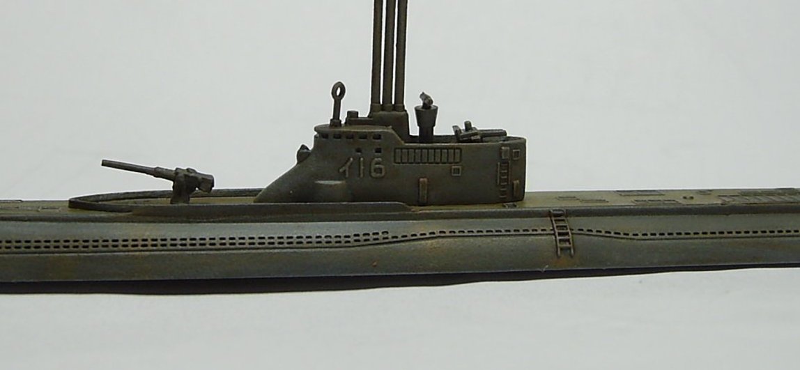

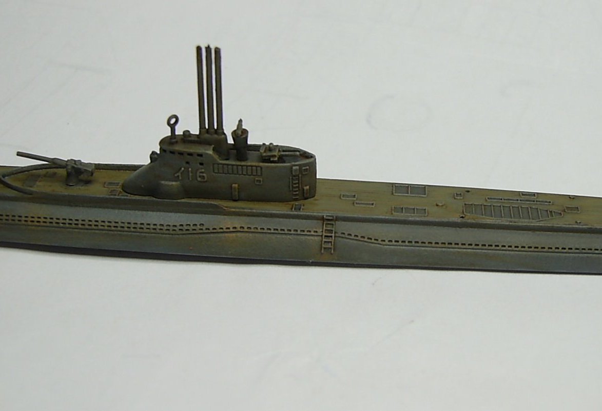

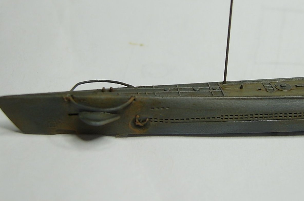

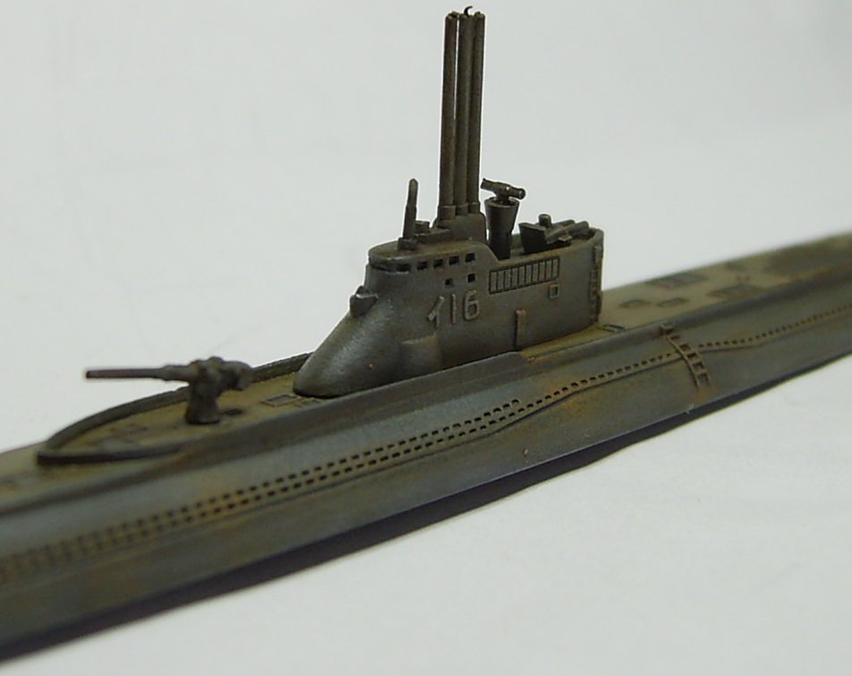

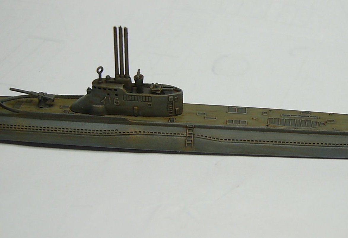

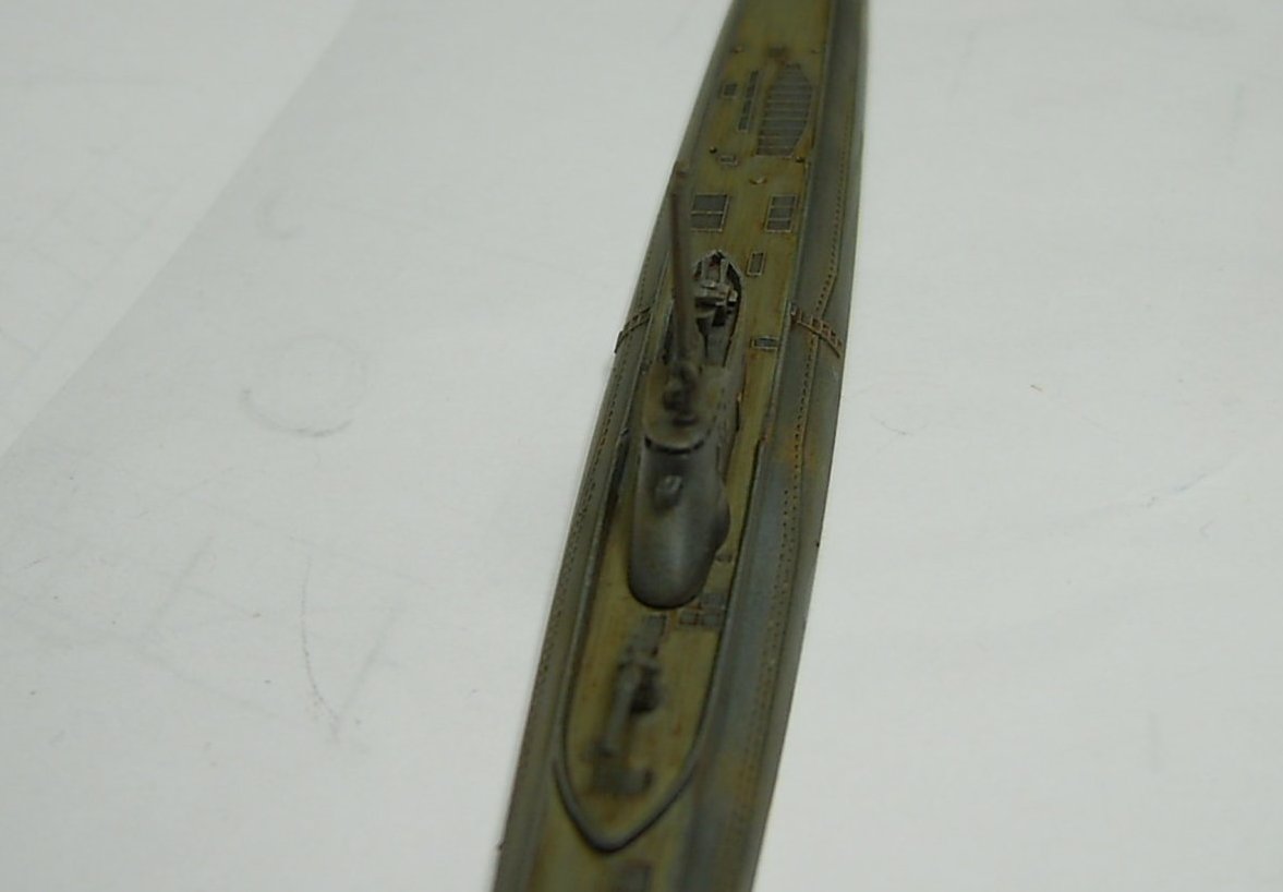

Finished the painting of the hull and have added a wash of burnt umber plus used oils to bring out the deck.
Next job is to locate her onto a sea base so that i can get on with the smaller items.
Roy

Roy -
Love the wash and the distinctive but blended coloration. Well done. Any thought to sanding down (not off) the I-16 designation to lower/lessen the relief? That's looking a bit overscale - but maybe given the weathering, you don't want to go back to that.

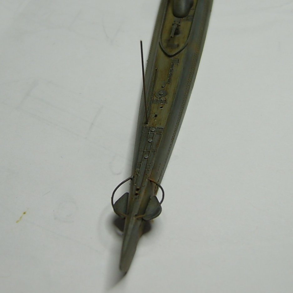

What did you do (what tools did you use) to get the consistent curve to the alloy diving plane guards on the bow? Can you share what thickness/dimensions the material is?
Any plans for rigging?

Ok, dimension of tube is 0.03 i think, used the last i had for this will restock this weekend at the Scale model world show, Telford.
Yes totally agree that the i16 pennant No is not good when seen using a macro setting on the camera, i will have to reduce it's over scale appearance asap but would rather do that once she is fixed to her sea base which i will do tonight.
Rigging, well if time allows i will attempt to put loop arials on to her but my main concern is going to be adding stretched sprue to the diving plane guards. On the same issue, the guards were shaped using the handle of my snips which are slightly oval, takes a bit of time getting both sides identical but well worth the extra effort. The aft-end guardes were shaped with a smooth nosed plier.
Thanks for your comments and questions, :thumbs_up_1:

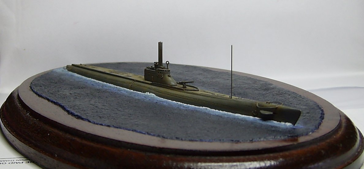

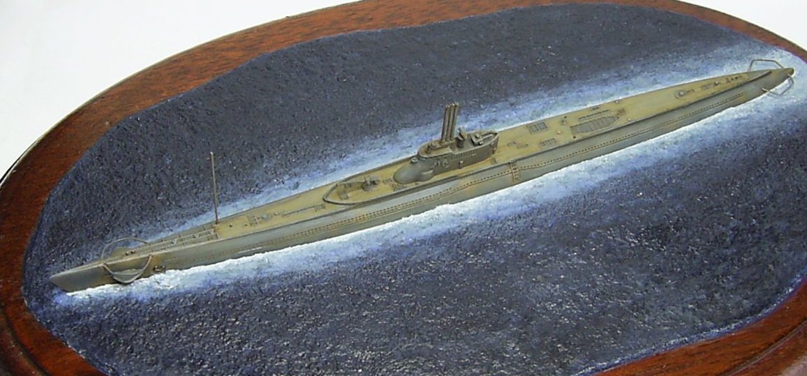

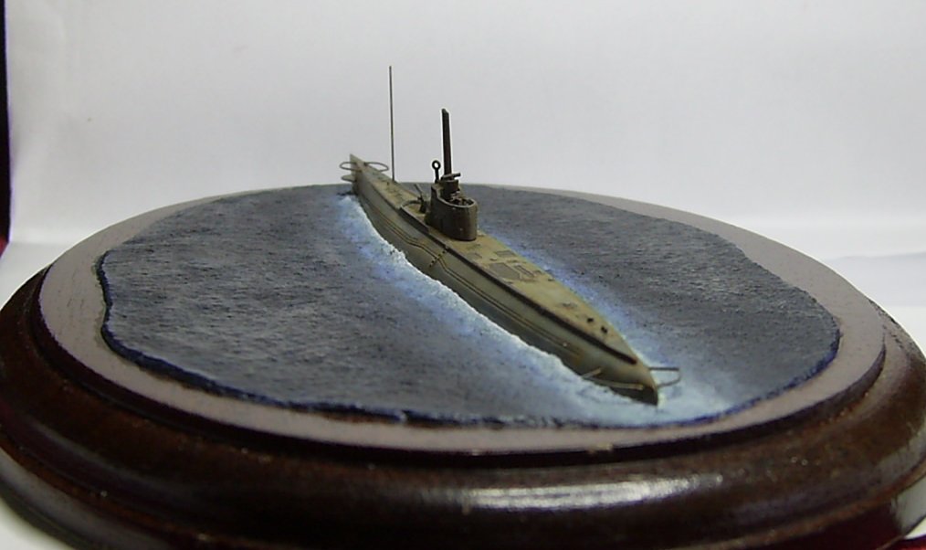

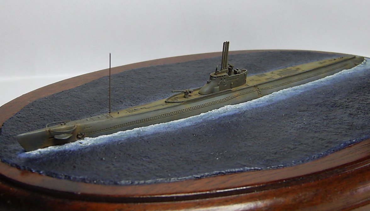

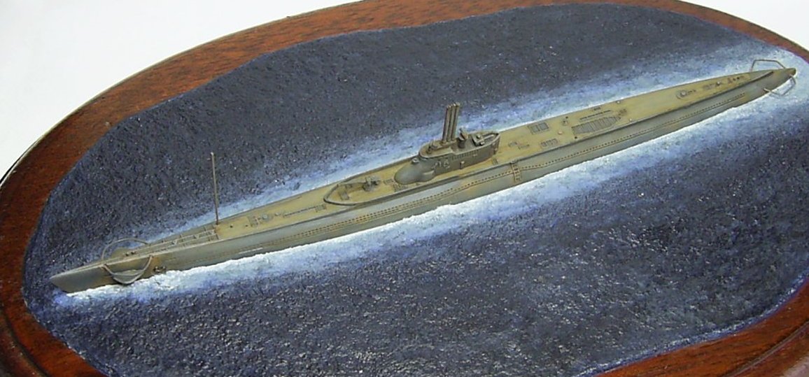

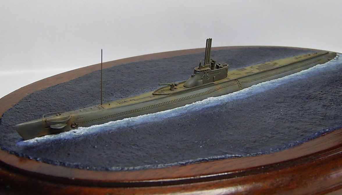

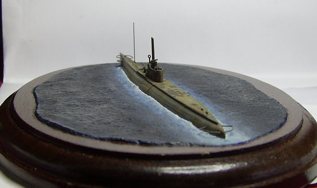

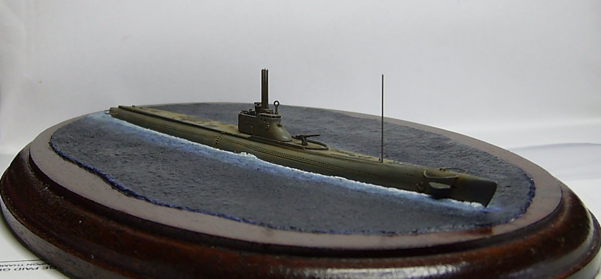

Managed to do the water last night, it is made using a standard light weight domestic wall filler and is approx about 2-3mm thick.
Leave to dry over night in a warm room then it's ready to paint.
Painted the water this morning using Valejo acrylics from the model colour range and minature paints which is a game workshop type of paint again acrylic.
Please ignore the large mast, i leave it like this as it stops me from handling the hull when painting, it will be cut down to the correct size shortly.
Roy

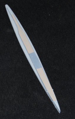

Inasmuch as the Typhoon class submarines are the largest among submarines it is interesting to compare them with other congeners. :eyebrows:
That's the way the completed hull looks like compared to the UB-1...
�and few other 1/350 submarines. :whistle:

Can you say more about your painting on the Typhoon to date - are you pre-shading with white as the counter-color?
