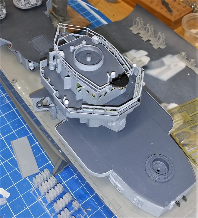

I actually did get the 3"/50 mounts finished today and seated them in their respective locations. So, here is a mock up of the mounts and their various deck houses, etc.:
Mt. 33 -
Mts. 31/32 -
And the Pilot House/Nav Bridge atop the fwd deck house:
I'm currently working on a 3D design for a Mk. 56 GFCS director replacement as I'm not happy with the purchased item & it's paint job - this is close to being ready for a test print (3 pcs.) so maybe later this week. Also, will be printing some new deck mtd. tool boxes for the gun tubs that I did in 3D, as well.
