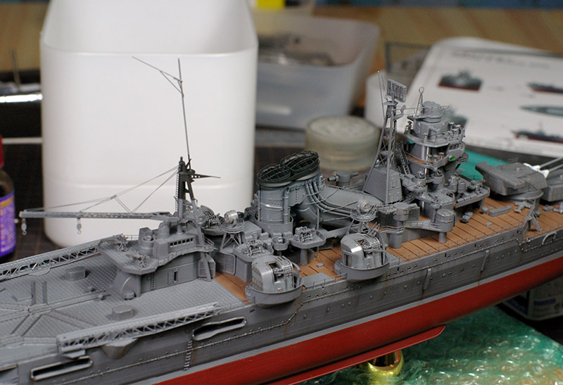

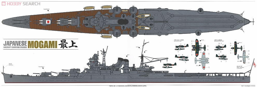

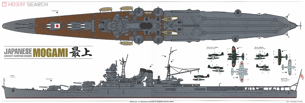

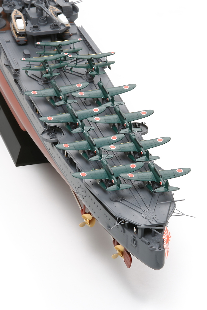

Actually, Tamiya erred with its 1/700 kit, yet corrected properly with its 1/350 kit. The linoleum extends aft to where the mainmast and aft boat storage begins. You can just make it out in the attached image of the 1/350 model.

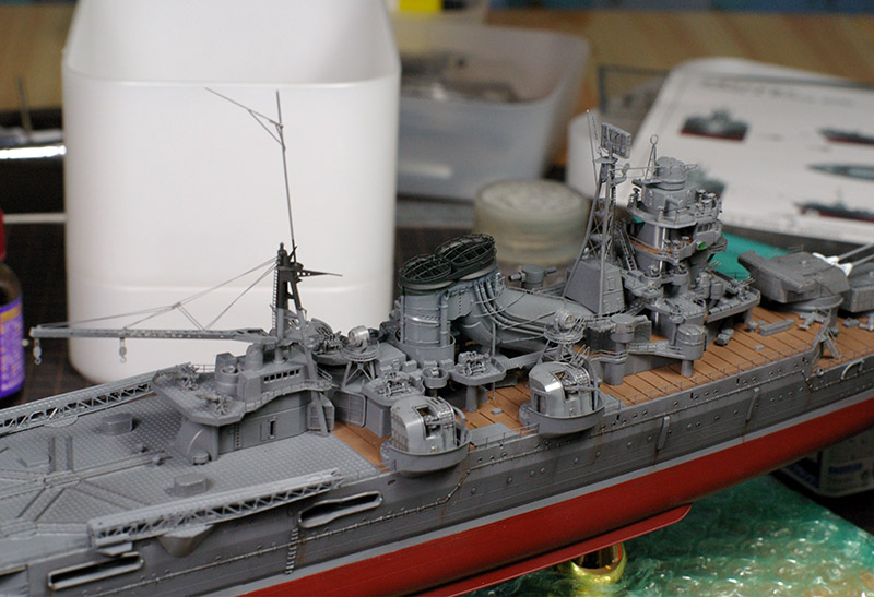

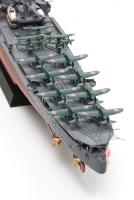

Well, I would carefully mark the dividing point between the end of the linoleum covered area and the start of the treaded steel. Then, I would scrape off all the treading from the linoleum covered area, probably lightly sand it as well. Then decide whether or not you want to depict the brass tie-down strips. Truthfully, these are always over scale in 1/700 (the real ones were barely an inch wide and a 1/4" high). Then paint with linoleum colored paint (Tamiya Acrylic XF-79 Linoleum Deck Brown is an excellent match).
Here are two pics to help show the delineation between the two surfaces. The model is from a Japanese modeler's site: http://d.hatena.ne.jp/hakurai/20120603

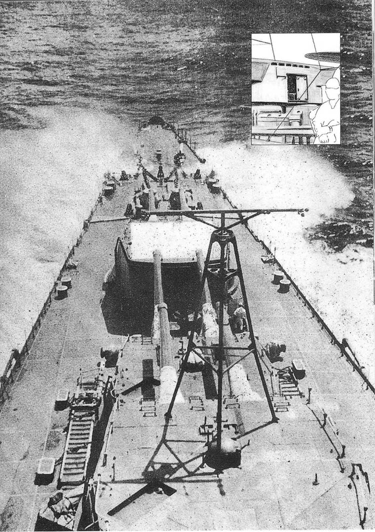

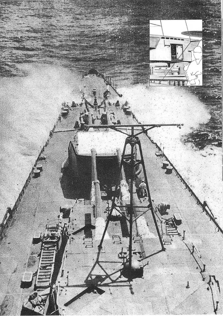

Another question, the third turret has some kind of tower and it's rigged to the superstructure, isn't the rig would be a problem when the turret rotate?
Work in Progress:
- Vlad
- Posts: 1559
- Location: England
Re: Calling all Mogami-class (最上) fans
I always assumed the mast at the top was placed central with the rotation point of the turret, and the turret just rotates under it but the attachment for the rigging stays in the same orientation.Nopefield wrote:Another question, the third turret has some kind of tower and it's rigged to the superstructure, isn't the rig would be a problem when the turret rotate?
Vlad
- Posts: 9063
That's basically correct. There's a rotating spreader bar atop the mast, which keeps the aerials in place as the turret rotates beneath it.

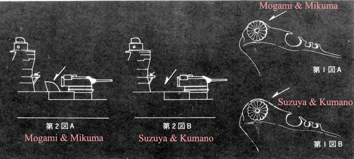

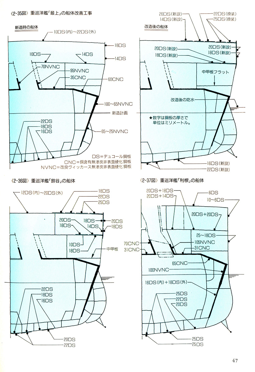

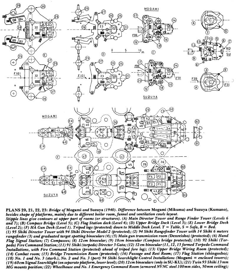

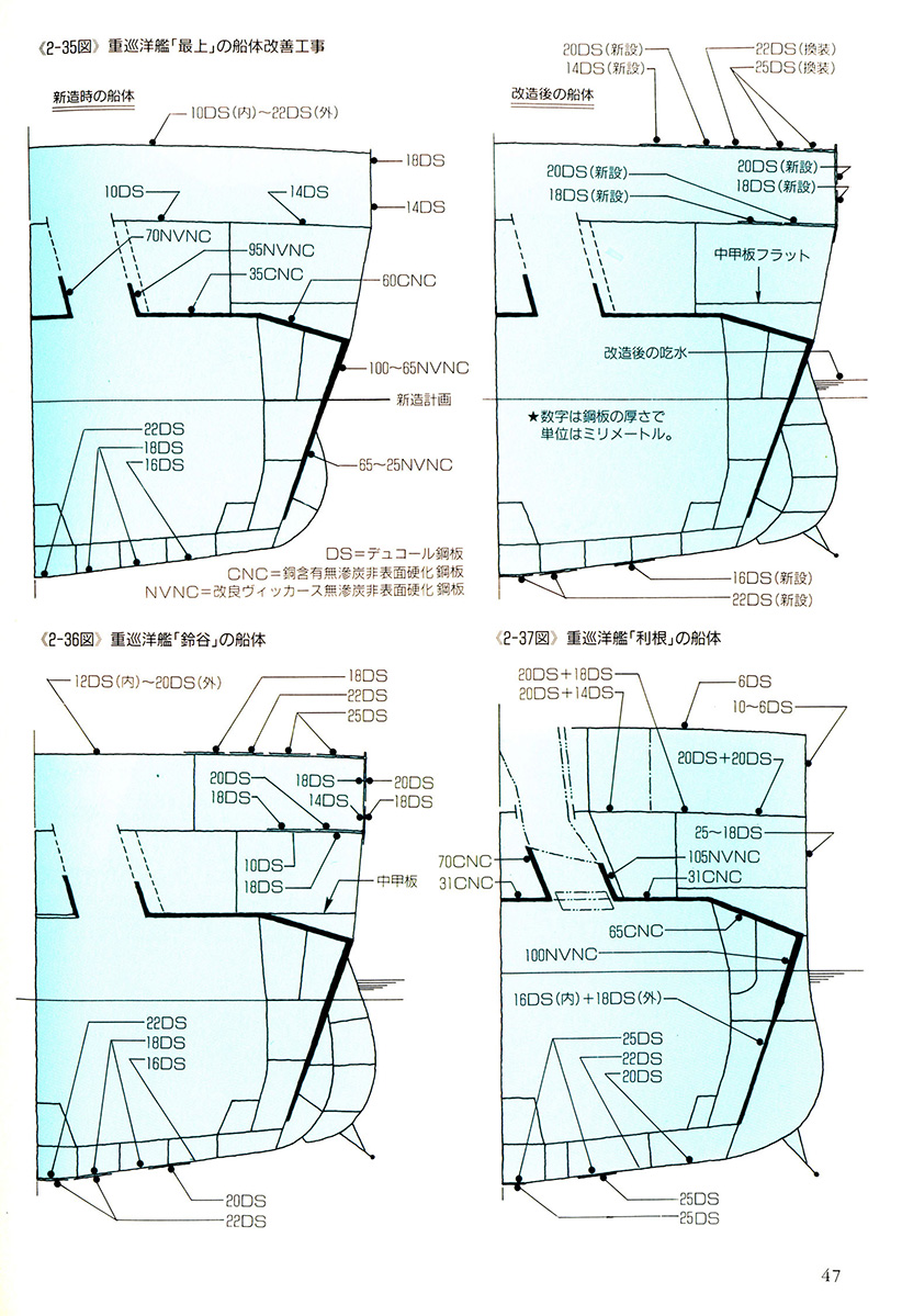

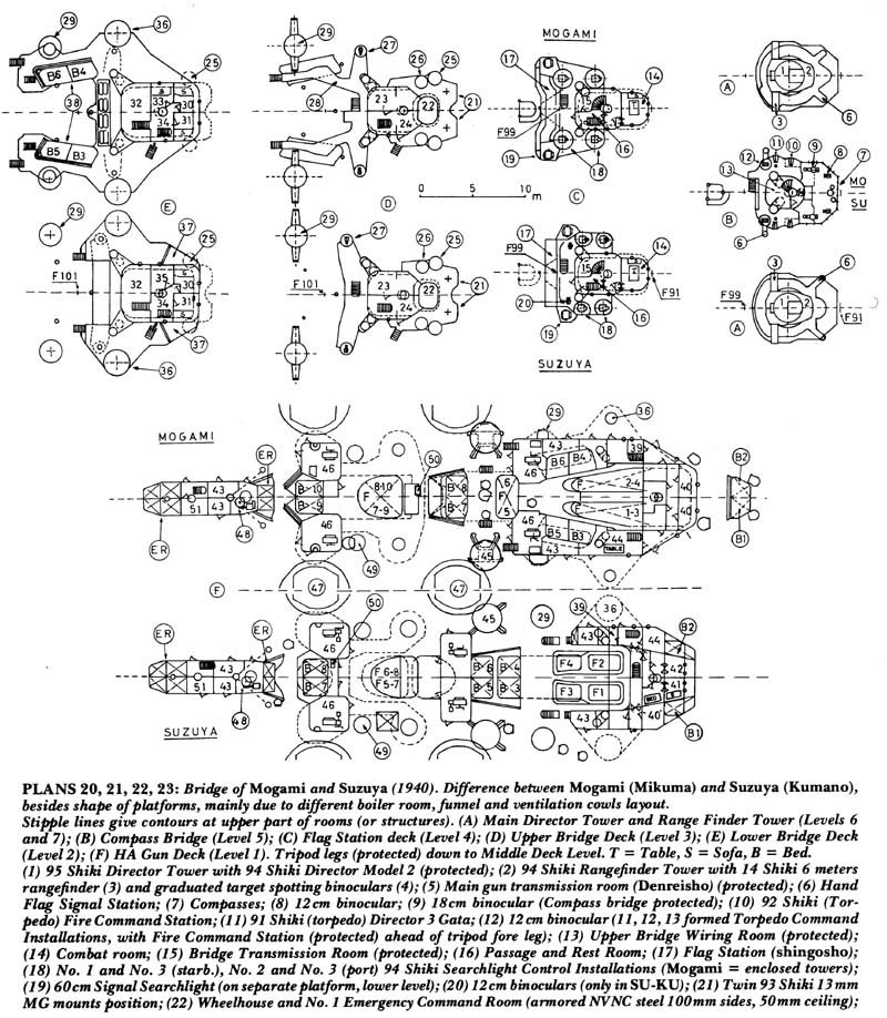

- Posts: 9063
Well, a conversion is possible, though there are differences that need to be taken into consideration. The upper hull and 01 High Angle Gun Deck are different, as are the arrangements at the base of the superstructure. Some of these references have been posted previously, but these should be a little larger.
