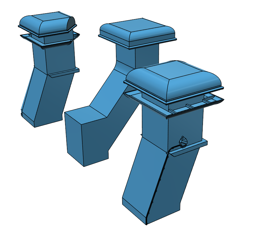

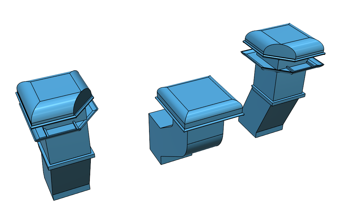

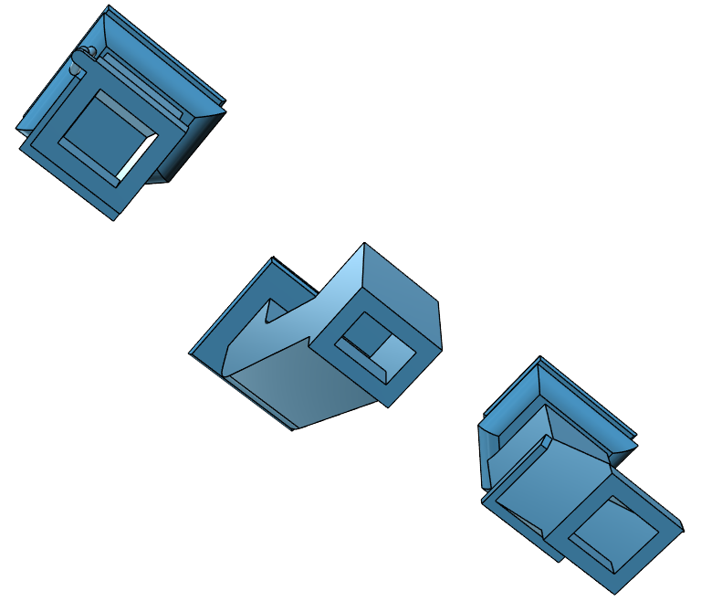

Port side vent cap. I need to remove the fillet on the chamfered corner of the design.
Open the *.tif in Microsoft "Paint" or "Paint.net", reduce it in size (because the hi-res photo is a whopper) and save it as an *.jpg.BB62vet wrote:....Once I figure out how to convert the original .tiff file photo to a .jpg I'll post it....

Steve,
Thanks for the conversion info - hadn't thought of using "Paint". And thanks for posting that photo. As I mentioned in my email, I'll revised the drawing to include the vent pipe on the Port Vent Shaft as I described to you.

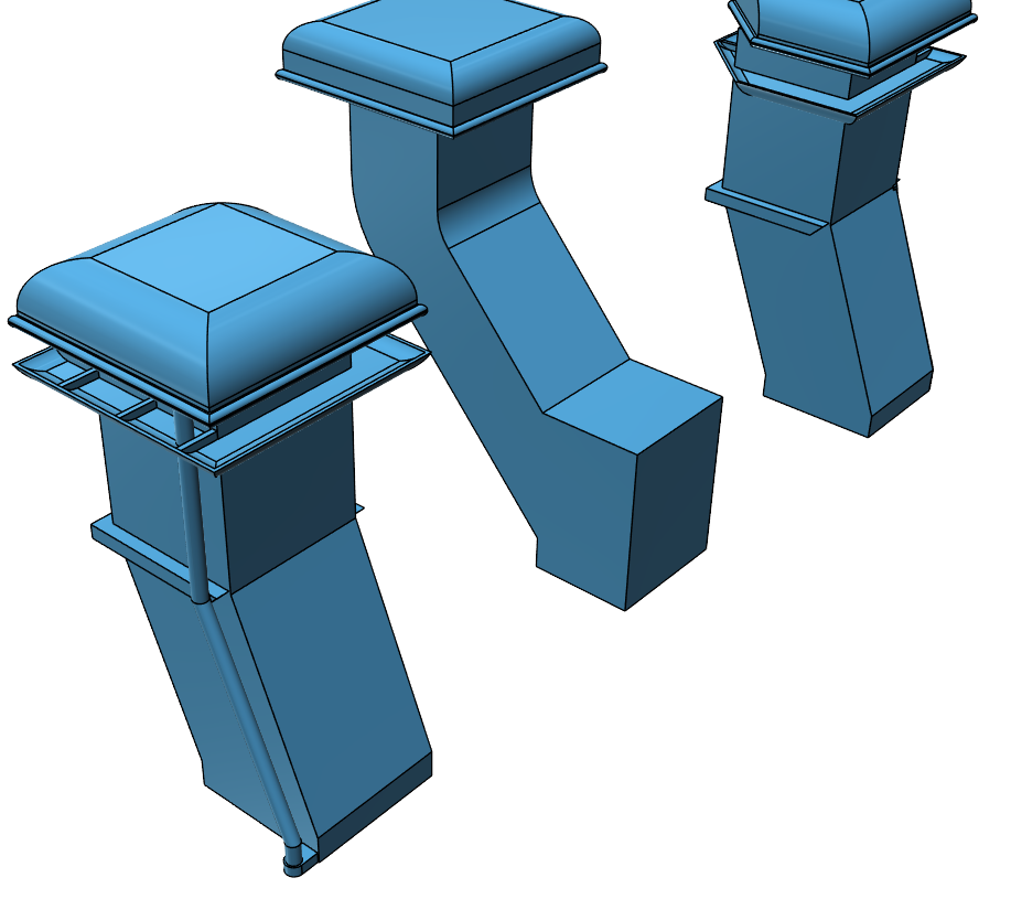

Thanks, Hank!

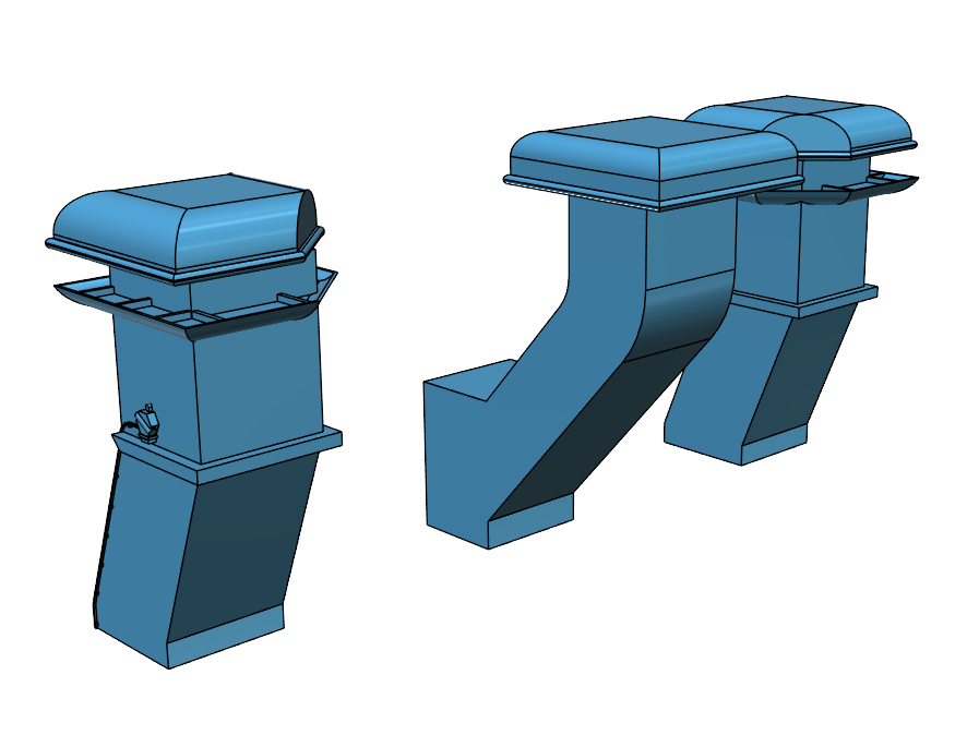

Here's the revised design, except the pipe.

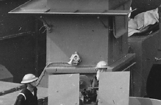

David P wrote:
It is NOT an elec. or air tool, it is an alarm - see blowup below: Remember, this is 1940's era and many mechanical/pneumatic items were utilized in conjunction with newer electrical switches and activators to produce things such as a powered air alarm. This alarm is also mounted on the outside of the port vent shaft and a similar one is mounted below an elec. panel box on the stbd side of the main deck break bulkhead. I've shown this on my vent drawing in red.
As for the vent shaft lip that DavidP describes, it could be up to 2 1/2w x 1" deep. It's a 90 deg. angled lip connection and probably has a neoprene seal inside.
Not to get into a pissing contest over who has more or what experience as a draftsman, I have been a facilities board/CAD draftsman/designer for 46+ years and currently work in piping, HVAC, and P&ID CAD drawings in a project engineering group designing a new plasma fractionation facility at our N.C. location. I'm quite familiar with how HVAC ductwork is engineered/designed/drafted and these items in a shipyard would be pretty std. items for the time. Things today, however, are done quite differently as a matter of info. I'm not sure whether or not these are intake or exhaust vents, but I'm leaning towards exhaust due to the hinged deflector panels. The BoGP for ARIZONA only calls hers "vents" with no further description.
Hope this helps,
David P wrote:
. See my comments below about altering the width of that flanged joint.that "ledge" or seam cover that partially wraps around the bent joint of the starboard vent trunk, make it wider as there is an electrical or air driven hand tool sitting there in the red circled picture
Hope this helps,

While we're looking at this great blow-up of the starboard vent, note the folded-down forward deflector flange - definitely has a diagonal clipped edge. I'd lay the probability at 99% that the vent cap follows suit.BB62vet wrote:Steve,
David P wrote:. See my comments below about altering the width of that flanged joint.that "ledge" or seam cover that partially wraps around the bent joint of the starboard vent trunk, make it wider as there is an electrical or air driven hand tool sitting there in the red circled picture
Hope this helps,
- Sean F.

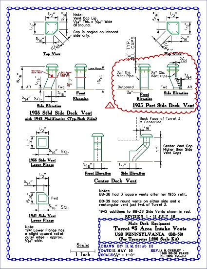

OK, here is an update version of the 1935 Vents drawing (1:200 scale) including the 6" dia. vent pipe outboard of the Port Side Vent Shaft.
The addition of the vent pipe simply adds a bit of detail - it was added in the 1935 refit.
Hope this helps,
Hope this helps,

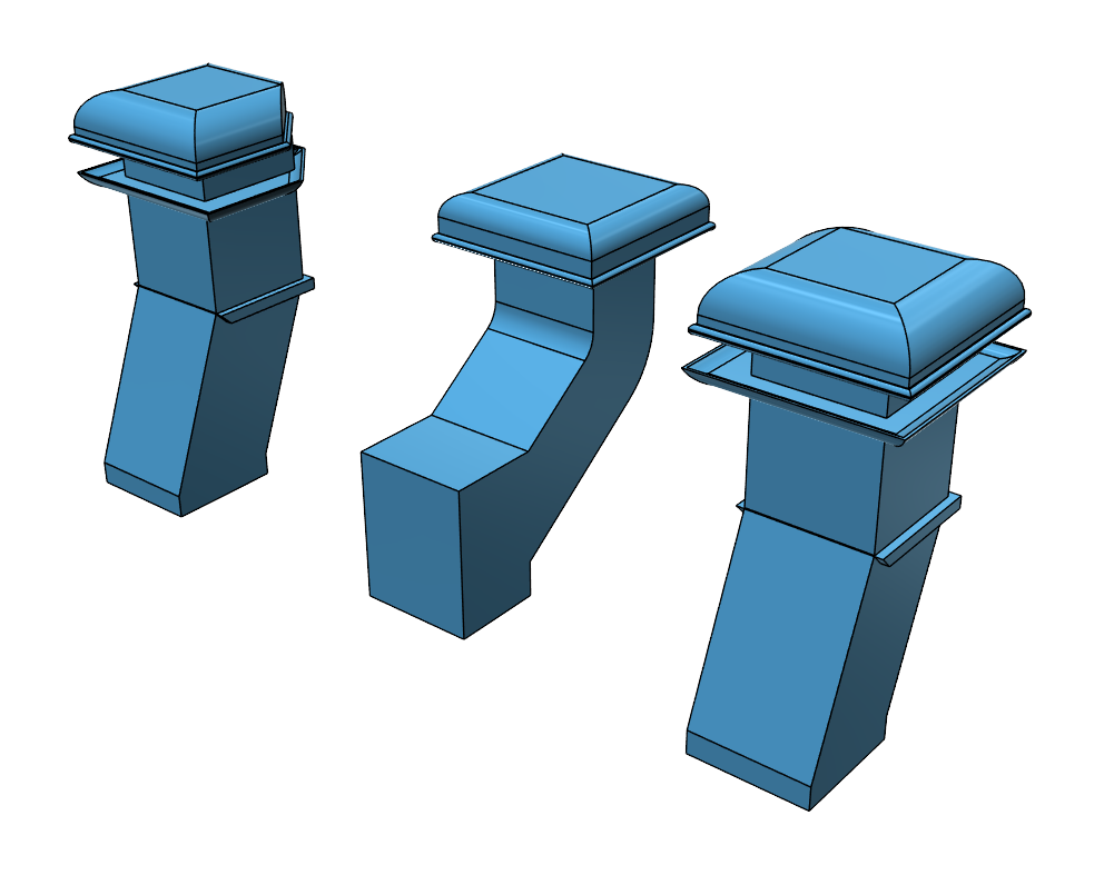

Great discussion and drawings. Here's the final design.
In 1/200 scale, they are quite big, therefore, they are unfortunately, expensive.

I ordered a set of these vents in 1/350 as soon as Steve posted them on his shapeways store. Got them in the mail Saturday morn and must say that was the fastest shapeways delivery to date! 5 days.
These look fantastic and the rough surface is not as prevalent on these as it is on some of the other items and they should clean up very nice with a touch of a sanding stick. The angled vent caps look spot on and so too is the little electrical conduit? running up the side on one vent. From what I see very little "extra detail" would be needed..
Overall impression?... fantastic!
thank you much Hank and Steve and all others who contributed.

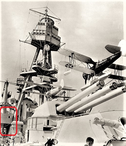

Something we've all missed on BB-38 - Until Now!
Yesterday, Mark Krumrey emailed me with a "discovery" he had made while working on his AZ to PA Conversion - a small shed or deckhouse that was added to PENNSYLVANIA sometime after her '30s refit. It appears in quite a few photos up to 1941 but not after her Mare Island 1942 refit. This small raised shed appears in one of the following photos to be supported by two round poles as it probably extends over the lower main deck at the break. I've circled in red the following three photos to show where this item is located. It is not shown on any current renderings/plans/drawings, etc. that I've found. So, WHAT IS IT?
I have a possible thought on what this is based on a similar type of deckhouse that was temporarily installed on DD566 during our 1966-67 Westpac Cruise for a 3 week period by the CIA. While that organization wasn't even thought of in the 1930's, radio espionage (tracking) was handled thru the U.S.N. Communications Dept. and while a 'secret' comm. shed may have been thought of back then, who can say? It could also have been a small BBQ Smoke shack installed by the Commissary CPO if he had been from North Carolina
Nothin' says lovin' like a pig smokin' in the oven!!
If anyone has any ideas, info, credible evidence - please share.
Thanks, Hank
Thanks, Hank

There's an opening in the back.....a movie projection booth similar to Arizona's, just up higher?
Bob
Bob
