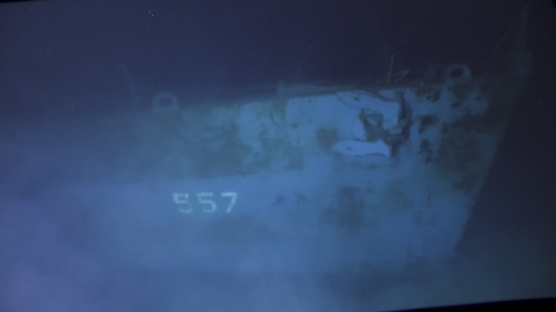

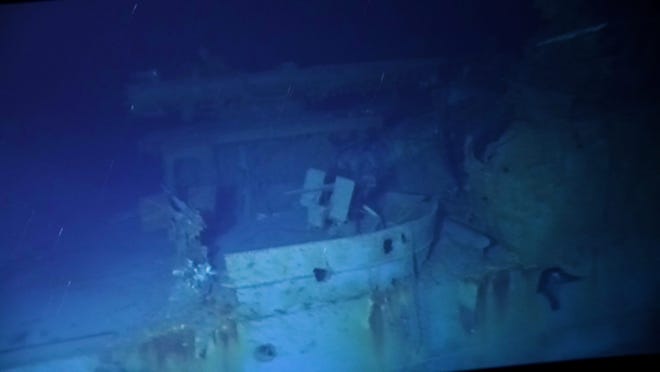

Im building the Trumpeter Sullivans kit as the Johnston DD-557. As expected, there seems to be a dearth of information on her. I've only found 3 photos of her, only one of which is useable, and nothing as to what color or camo measure she might have been painted in when she met her demise. From the one B/W photo, which looks to have been take not long after launch, possibly during trials, she appears to be in a single overall color, a dark grey possibly 5-O or 5-N? Anyone have any knowledge about it?
Posts: 8593
Re: USS Johnston colors
Joseph Dunlap wrote:Im building the Trumpeter Sullivans kit as the Johnston DD-557. As expected, there seems to be a dearth of information on her. I've only found 3 photos of her, only one of which is useable, and nothing as to what color or camo measure she might have been painted in when she met her demise. From the one B/W photo, which looks to have been take not long after launch, possibly during trials, she appears to be in a single overall color, a dark grey possibly 5-O or 5-N? Anyone have any knowledge about it?
She was most likely in overall Navy Blue (5N), with Deck Blue (20B) decks.
Posts: 3881
Post by Rick E Davis »
USS JOHNSTON (DD-557) was definitely painted in Ms 21 when lost and never appears to have been painted in dazzle. The Wreck photos proved that she was painted in Ms 21.
One of several articles that can be found online ... https://www.warhistoryonline.com/instan ... l?safari=1 ....

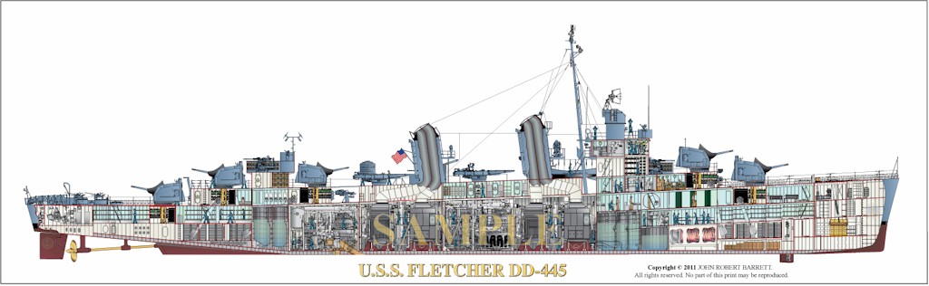

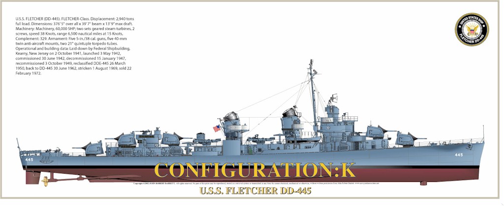

I have a question about some drawings of USS Fletcher.
On Destroyer Photo Index DD-445 / DDE-445 USS FLETCHER (http://www.navsource.org/archives/05/445.htm) are some drawings shown made by John Barrett with text written by Robert F. Sumrall (see attachments).
The website where these drawings were available, is not available anymore (Navy Yard Associates).
So now to my question, does anybody has an idea if these drawings are still available somewhere ???
Another question, is also does anyone has these drawings and is willing to contact me for an eventual copy of the drawings. I cannot believe that this kind of beautiful drawings suddenly disappear into nothing !! I am also wondering if someone still represent these drawings !!
I also posted this on several other fora, but with zero result !!!
Posts: 3881
The "Navy Yard Associates" drawings are handsome to look at, but have to be realized for what they are. With the FLETCHER class, they drew-up a VERY LIMITED NUMBER of "standard" configurations and then divided the class of 175 destroyers to "fit" into those categories. Unfortunately, sometimes they put square pegs in round holes and the actual destroyer looked little like the configuration selected for that unit. The only configurations they chose to produce, were for the five twin 40-mm mounts that most units did eventually get modified to. But, several units were completed with a different initial configuration and some modified with other configurations adopted before the five twin 40-mm mounts configuration was made universal and were LOST in one of those configurations.
The cutaway drawing pretty well illustrated the general arrangement for the class, but there were refinements below decks as the units were upgraded. Hence, I would not suggest using these drawings as a guide in building a model of a specific ship.
However, if you just are interested in have a "general" illustration, a consideration of what you are asking for could be a problem. The Naval Yard Associates may no longer exist, but their copyrights do. If your intent is to have these illustrations for your enjoyment, you may get by asking for a copy. However, if you intend to use these illustrations in a published work, you could be in trouble.
I never got any of these illustrations, because of the issues of "not accurate" configurations being called out. An example was USS CHEVALIER (DD-451) was "illustrated" as having the same "Configuration K" as is USS FLETCHER. However, CHEVALIER was lost with the original design configuration she was completed with, aka one quad 1.1-in mount. She NEVER carried any 40-mm guns!!!

Here is a photo I took of a colorized illustration onboard USS CASSIN YOUNG (DD-793) museum ship at the Charlestown Navy Yard NPS Park. This illustration is of CASSIN YOUNG more or less as she appears today, and modified during the 1950's for service. The photo is less than perfect being taken inside with flash causing reflections.
Posts: 5068
Post by Fliger747 »
Interesting that she has the extended rudder which was fitted post war to improve the fairly dismal tactical radius and the tripod mast to support the evolving radar and electronics suite, retaining the five gun configuration. As ASW was becoming increasingly important for these ships as a role, the chance of future fleet actions becoming vanishingly improbable.
