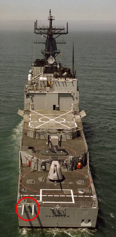

Can anyone identify this item on the stern of Spruance and Kidd Class Destroyers?
I would appreciate any help!
-Rob <><
FFG-7
Posts: 699
Re: Spruance/Kidd Class Stern Item Question
Post by FFG-7 »
they are "dual whip tilt antenna" as per Sheet 11 Main Deck - 4 of the plans I have. too big to post as that sheet is 6.23mb at 6223x3223 pixels.
Rob Jansen
Posts: 117
Post by Rob Jansen »
Thank you so very much for the help!!!
-Rob <><
