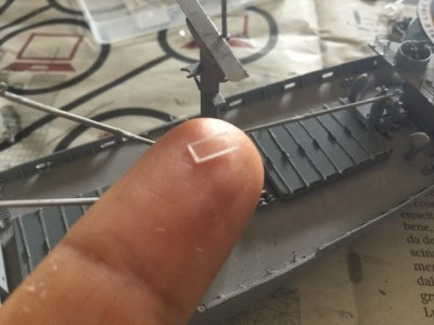

Today the cross tree extension and the support for 2 booms received their attention. Very useful was the picture of the Arthur Huddell (shown below) that shows how such supports were made.
Once extended (with a brass photo etched plate), the cross tree needed some thickness
And also handrails (really crazy to put them in place)
The boom needed a support to stay in rest position
And therefore i made them
And they appear realistic

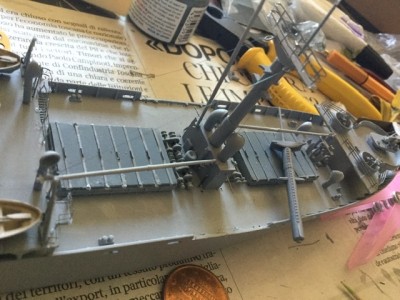

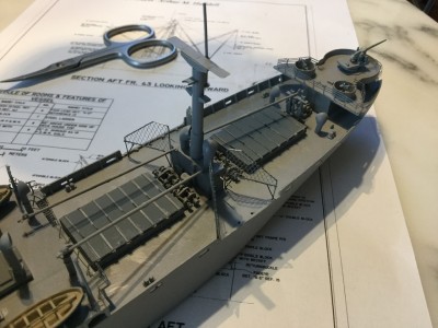

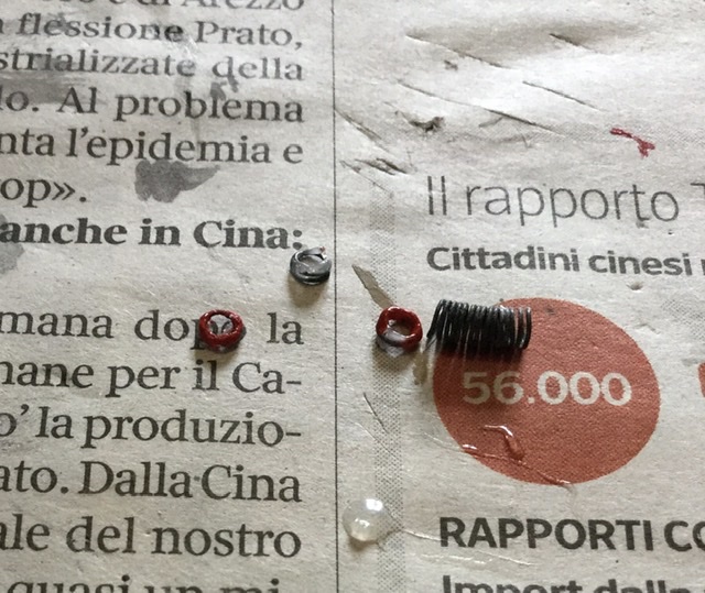

Though i spent many hours on the model, very few progresses are visible. I decided to make my own lifebuoys, doing more or less as car steering wheels. They have an inner steel circle with foam around. So i made a spiral of steel around a 2mm plastic tube and then i added vinilic glue, bit after bit, to give volume. In two days i could not finish four and at least 6 are needed (2 close to the front lifeboats, 2 that are already in place, two close to a rear ladder). Another 2 seem to be between the lifeboats.. Does anybody know how many should they be usually on a Liberty? Ok, it is a stupid question, so many are the different versions, but there was probably a minimum set and i found 6-8 for now.
I also ended the booms positioning and their riggings.
And tried something for washing, better say i gave some transparent cover to start some washing.
Lifebuoys in process
Winches, rigging and booms almost completed

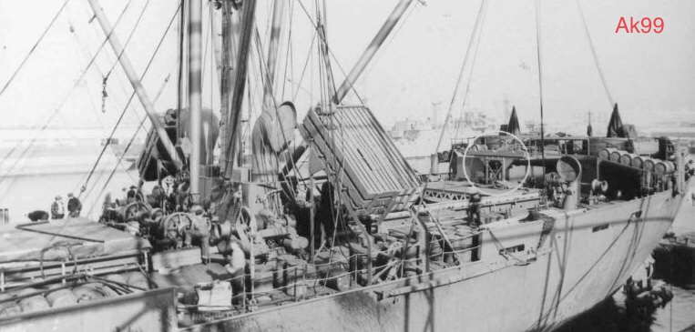

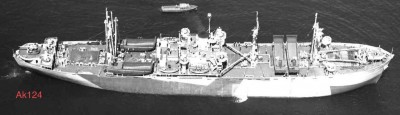

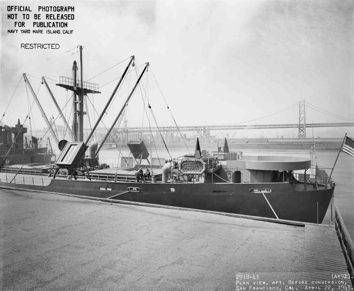

I am not sure i understood the question. If the winches you mention are the ones highlighted in the drawing below, they were used to manage the booms, like the other winches (overall 10) in that position. In the Trumpeteer 1/350 (o�Brien) i have i do not find winches in excess. Anyway i found a picture of Ak92 of that area before its conversion and the position is the usual one. On the other hand, Ak114 picture after conversion shows them in a different position.
Eugenio
The ak92 rear part
The ak92 rear part
In ak114 their position is different

Intreno, if you look close at your pic of AK-91 you'll see part of a winch between the #5 hold and the aft deck house.
Much clearer pic than what I have saved.
This is the cast winch I was referring to. I cannot tell for sure if there is one under the 5" tub aft.
Paul

Thanks Intreno, from your pic I can see the multiple winches between the #5 hold and the rear deckhouse.
Obviously this is different equipment than the standard Liberty.
I can see where the extra winches suits the AK version of these ships for the extra lift capacity.
The cast winch on the model I was referring to originally will be replaced with these dual winches.
