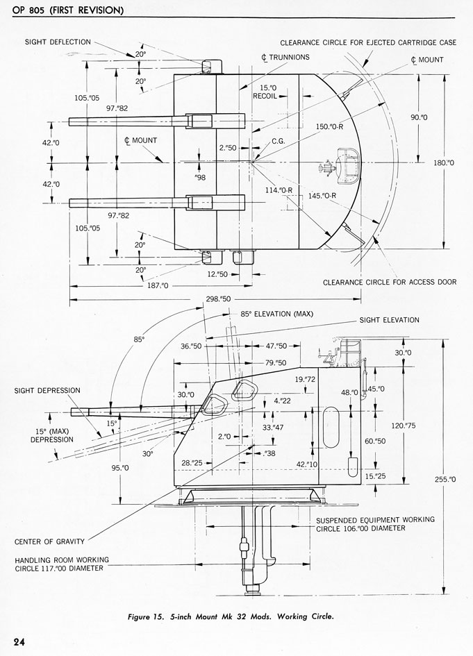

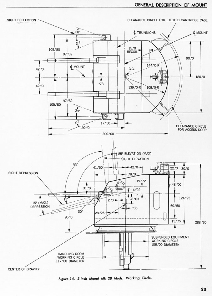

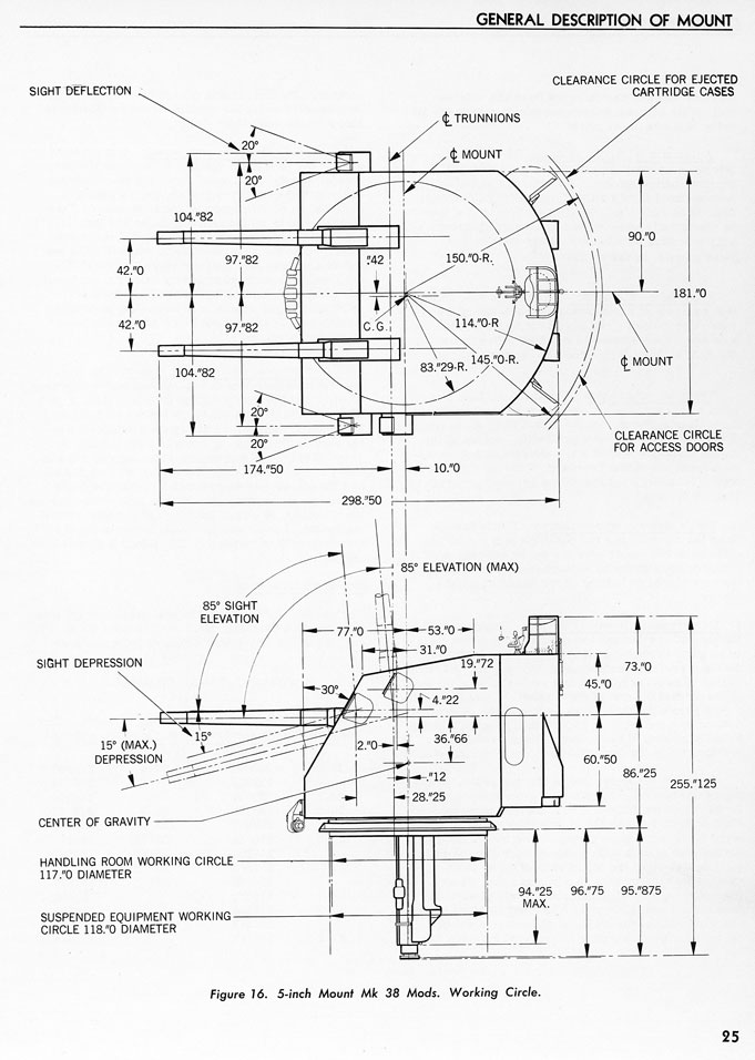

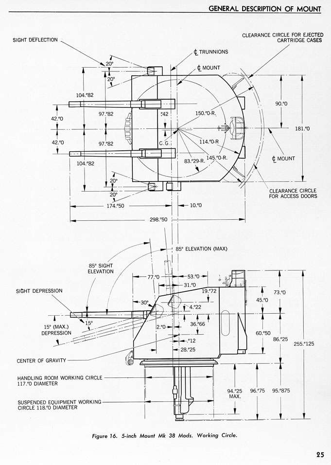

The dual 5"/38 mounts were all very much alike, but there were quite a few mark/mods. I looked at the Miami drawings and you are right about the vertical front face, but the diagonal faces appear to the the same length (see below). I think this is just carelessness on the part of the draftsman. I agree with Rick that these "general" drawings are just sketches. They do not have accurate dimensions, but just approximations.
Go to HSNA and look through OP 805 5-INCH TWIN GUN MOUNT MARK 28, 32 and 38 ALL MODS:
http://archive.hnsa.org/doc/fiveinchtwin/index.htm
This 622 page document will tell you everything you wanted to know and a lot more! It includes dimensioned drawings of the mounts (see attached pages). The HSNA version is hard to use (HTML page with embedded page images). Look around and you can find the complete pub in PDF form - it is MUCH easier to use.
The overall dimensions of all models were almost the same, but the Mk 28s did have shorter angled faces than the other Marks. There were 16 mods in all. I think they were all pretty much interchangeable with the 5" handling rooms they sat on. Note that these Mark numbers refer to the gun mounts but the shields (the gun houses) had different Mark numbers. There were 11 Marks and 15 Mods for the shields.
It is really the shields we are talking about. OP 805 Chapter 19 (page 533) tells about the shields. Cruisers, battleships and aircraft carriers had shields made of 1 inch to 2.5" thick STS steel. Destroyers had lighter weight shields of thinner metal (0.25 inch). OP 805 page 548 gives the specs.
When the Clevelands were being built the shipyards used whatever they had sitting around at the time. Some mounts had external training stop buffers on the front, some had external buffers on the rear and some had internal buffers. It is quite possible that some ships had a mix of short faced Mk 28s and the longer faced Mk 32s and Mk 38s.
PS: These drawings show the gun barrels to have a tapered step just forward of the front of the shield. In reality the barrels were a smooth taper without that step. No idea why the draftsman put that step on the barrel but it has fooled a lot of modelers into making inaccurate gun barrels (including me)! What is shown as the step is where the bloomers attached around the barrels (if bloomers were installed) just forward of the maximum extent of recoil - the guns recoiled 15" when they fired.

Thanks for the plans from HNSA for the 5"/38 turrets.

It would appear to be a good guess that the CLEVELANDS had various Mod's of Mk 32 Mounts.
Also, the USN continuously was upgrading mounts with OrdAlts to fix issues or to improve performance/safety.

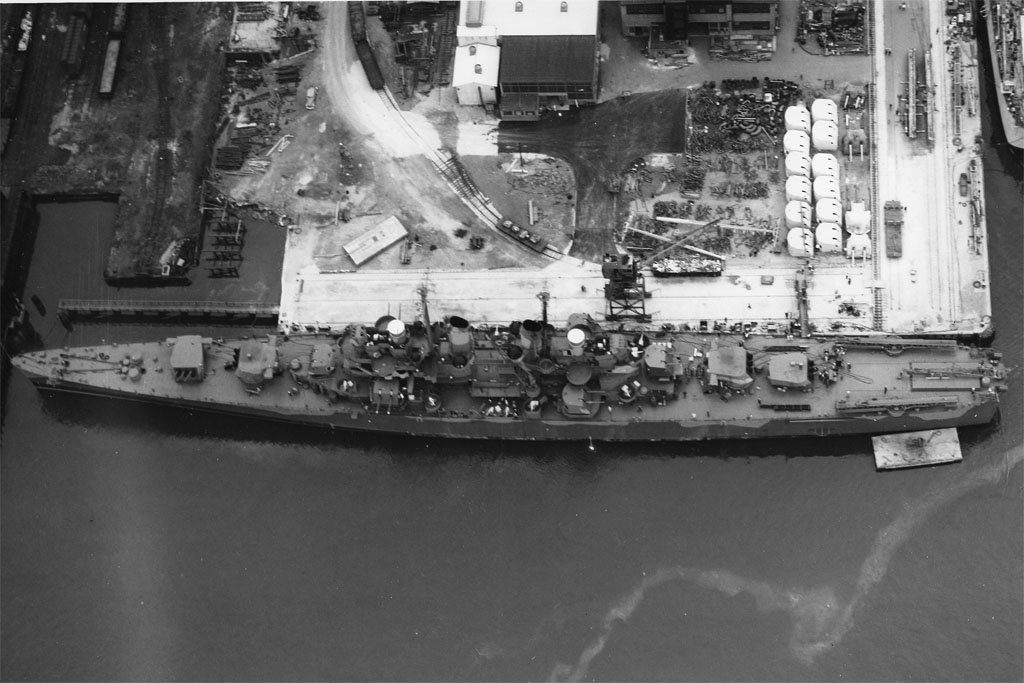

- DrPR
- Posts: 1689
Re: Calling all USS Cleveland class (CL) fans
Matthew,
Right, the dual mounts do appear to be under tarps, separate from the shields. I should pay closer attention!
Rick,
Do you know the date of the photo you posted of the guns and shields at the Philadelphia Navy Yard?
I knew I had seen it somewhere. I have six photos of the Cleveland CL-55 at that pier (see attached). The 5" mounts were already installed, so obviously they were for another ship(s). Notice that the Mk 34 directors had not been installed.
Looks like there was another CL/CA at the pier to the right in this photo (the stern looks like a Cleveland class - more or less square at the waterline and round at the main deck). It might have been the Columbia CL-56 - it was commissioned about a month after the Cleveland.
There were four gun assemblies under tarps and twelve shields. These would have been for PNY projects, and not removed from CVLs because the 5" mounts would never have been installed on the CVLs. All nine CVLs were constructed by New York Shipbuilding at Camden, New Jersey.
Rick,

Those are "Cruiser" mounts. They have the long angled face plate and the short vertical plate.
http://www.navsource.org/archives/04/057/0405713.jpg
http://www.navsource.org/archives/04/095/0409513.jpg
"Battleship" mounts have the taller vertical plate and the gun port opening almost touch the knuckle.
http://navsource.org/archives/01/061/016177.jpg
"Destroyer" mounts look the same as "Cruiser" mounts but the sheild is so thin they had to be reinforced later on.
http://www.navsource.org/archives/05/0571505.jpg
Here is picture of several types of 5" mounts together
The far two left shields are lighter "Cruiser" mounts, the next two are the heavier "Battleship" mounts.
There are even Single mounts.
http://www.navsource.org/archives/01/016243b.jpg
This is an easy way of trying to identify the type of mount installed on a ship.
It doesn't mean that "battleship" mounts were found on battleships and "cruiser" mounts were found on cruisers.
The fast battleships had "Battleship" mounts as well as the first four Atlanta's
The reconstructed Pearl Harbor battleships had "Cruiser" mounts installed.
The Alaska class had "Cruiser" mounts
The Essex class had "Cruiser" mounts
There main difference between them is the weight.
Battleship mounts had thicker armor and weighed considerably more.
Destroyer mounts were sheet metal and were light weight.
You would need very good pictures of the entire mount to determine the correct Mk and/Mods and a lifetime of research.
As Rick said earlier, he gave up trying to figure them out because there are so many variables.
Hope this is of some help. It's the method we use when building 1/96 model ships.

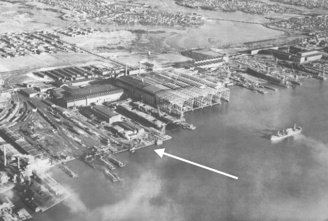

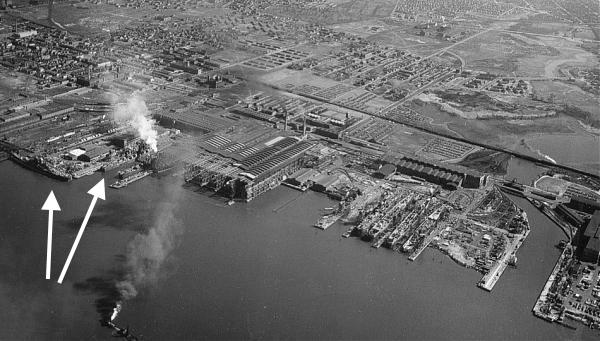

- Posts: 3880
I really have to wonder if these photos of USS CLEVELAND fitting-out were taken at Philadelphia Navy Yard or at New York Shipbuilding, Camden, NJ?
I suspect they were taken at NYSB prior to commissioning on 15 June 1942. I scanned a series of aerial photos of USS CLEVELAND taken at the same time, but they were undated and the location wasn't specified. If memory serves me right, I scanned them in 2008, the Philadelphia Navy Air Field was credited with taking the photos. So I may have assumed they were taken there. But with the other cruiser near by and the "Mk 32" 5-in gun mounts, it would seem that NYSB makes more sense. I compared this image to what photos I have scanned of PhilNY and what I could find on-line of NYSB yard (see attached thumbnail images) and it sure looks like this is a match to NYSB Fitting-out basin area. The white roofed building stands out along with the larger buildings behind it and beside it. Nothing along the PhilNY waterfront looks anything like this.
With this pier being the "fitting-out" area at NYSB, stockpiling of mounts and shields makes a lot of sense.
This also helps to date these aerial photos as being in early June 1942.
