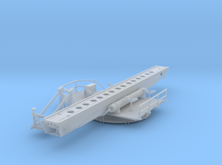

I'd like to add these parts:tjstoneman wrote:The Fujimi 1/700 scale kit of Scheer represents her in pre-war configuration, with the original bridge tower, pole mainmast with aerial spreader and vertical stem. In late 1939 she was taken in hand for a major refit, in which the bridge structure was replaced by a cylindrical structure similar (but not identical) to that carried by her sister Deutschland, the bow (as stated) was replaced with the so-called "Atlantic Bow", a funnel cap was added and a tripod mainmast fitted, as well as other minor changes. As always, study of contemporary photographs and other references is recommended.
https://www.shapeways.com/product/XV85J ... arketplace
https://www.shapeways.com/product/Z3TR6 ... arketplace
BTW,

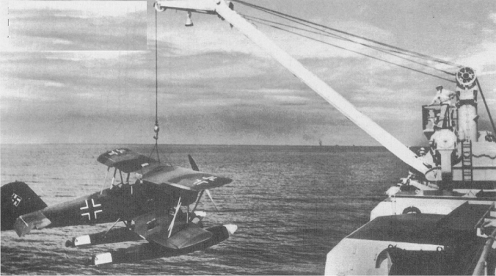

Would the cranes that Hipper carried be the same as on the Deutschland class? I would assume so, as the same aircraft were carried.
These look better than the kit parts,
https://www.shapeways.com/product/FC7KF ... arketplace

How much difference was there between the cranes, and why?

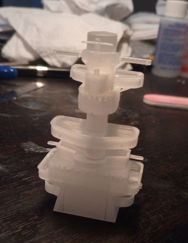

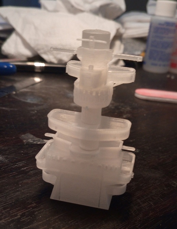

I am also doing that conversion ,but using the Trumpeter Graf Spee in 1/350 scale and the DiStefan pieces (bridge ,funnel and directors)so far the main issues for me are :
1) The bow
2) the main belt need to be raised up to the middle level windows
3) the stern anchor is backwards(in the Trump model)
But same as Bill ,I can not find any good info about the crane ,because AFAIK ,the Adm Scheer after her modernization carried only one crane in port side.
So far I corrected the bow and the stern anchor,need to work on the belt,but I believe is a nice conversion,my favorite Panzerschiff is the Scheer
BTW I did some surgery to the printed bridge to set the telemeter traversal instead of along side as it comes from Shapeways and was a pain in the butt

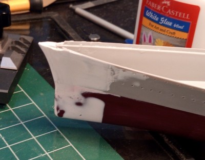

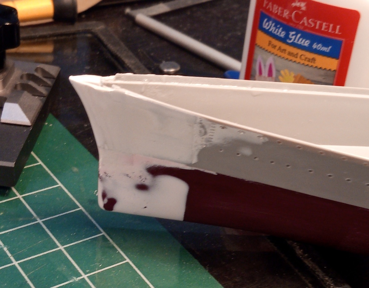

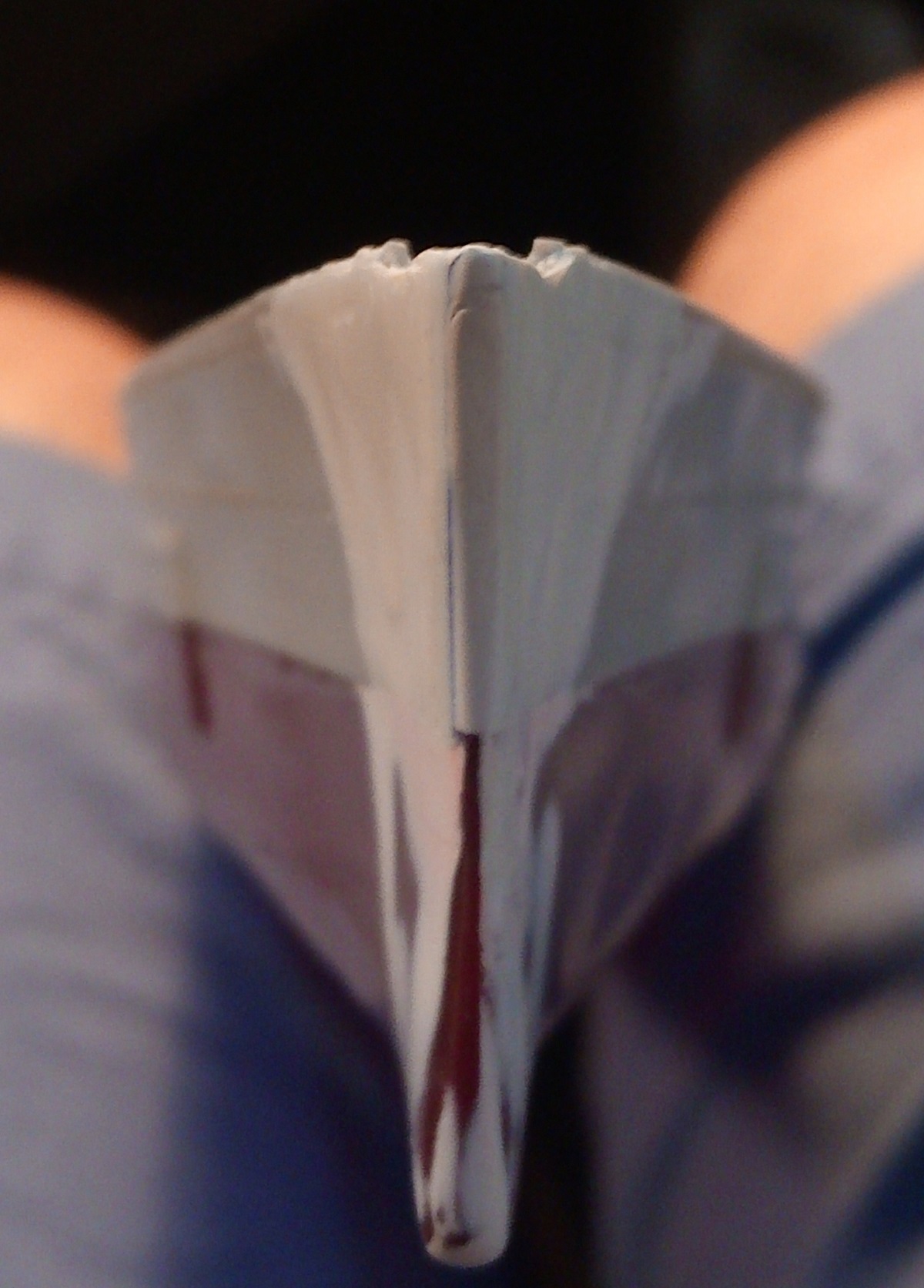

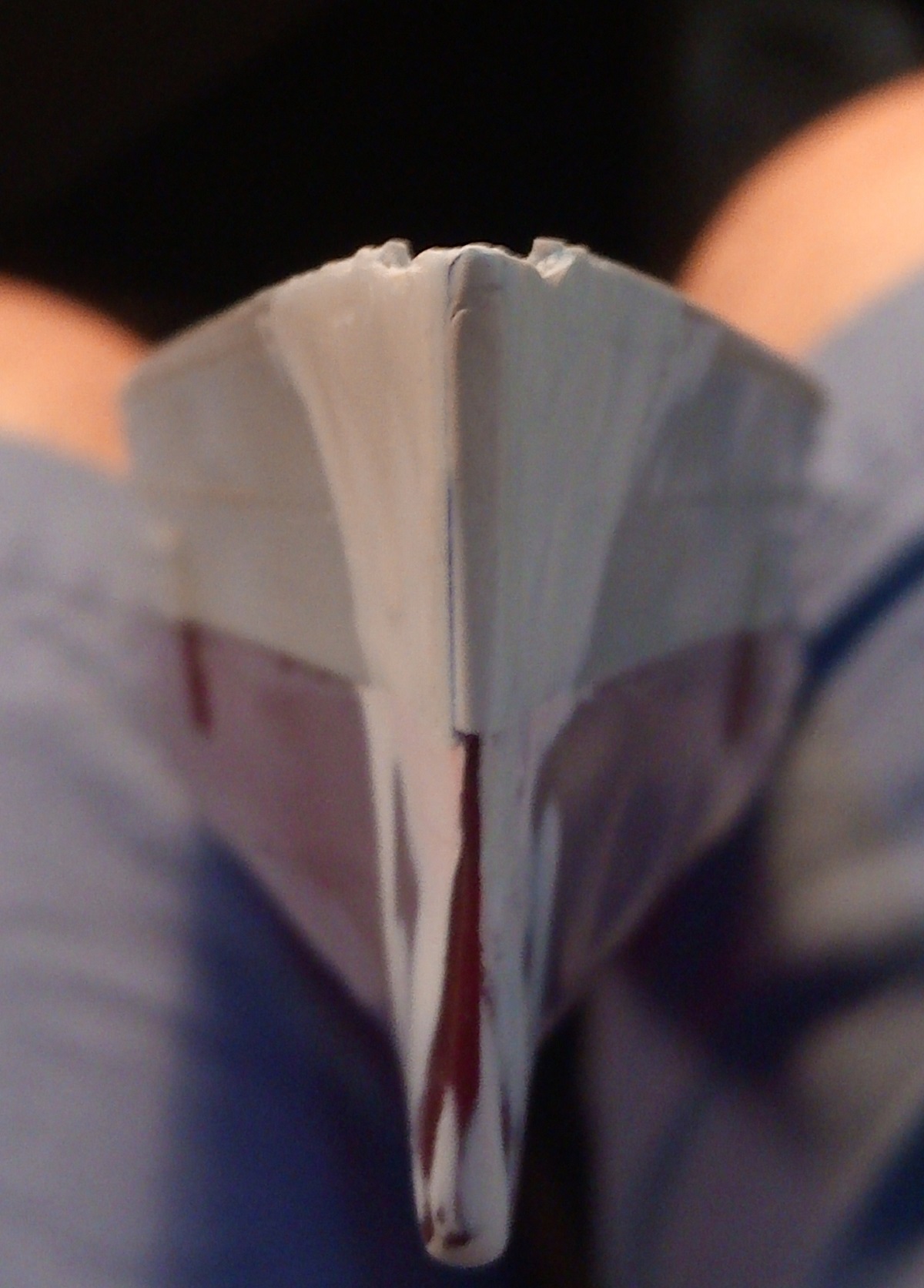

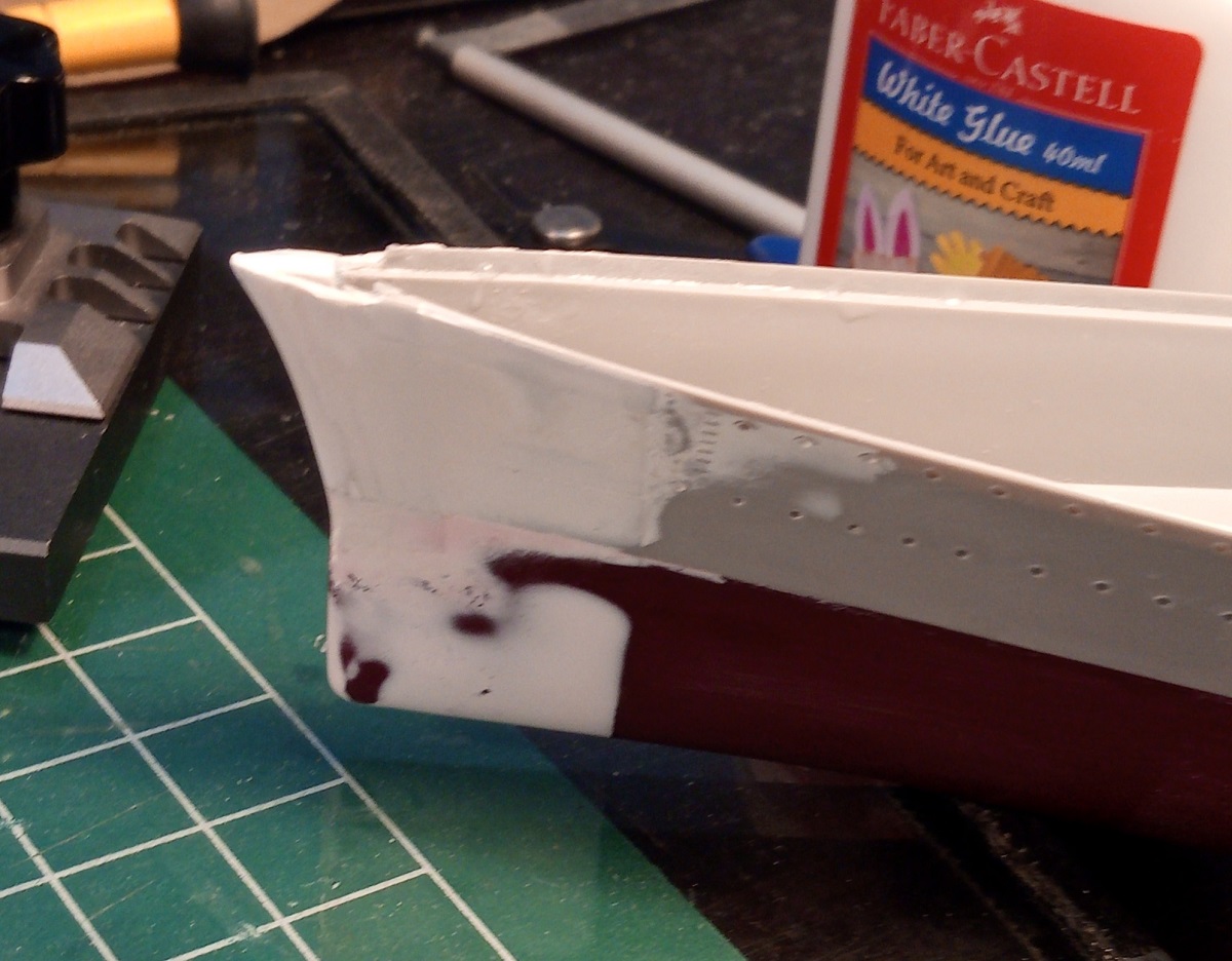

I cutted the tip of the vow and attached a triangle of styrene of .080 thickness and used .005" strips of styrene in layers to cover and give volume then shape with wetsand paper,finished with primer and more sanding,but my main tool were my eyeballs.DavidP wrote:Miguel, what did you use to buildup the bow to correct shape?

Nice job MiguelMiguel wrote:I cutted the tip of the vow and attached a triangle of styrene of .080 thickness and used .005" strips of styrene in layers to cover and give volume then shape with wetsand paper,finished with primer and more sanding,but my main tool were my eyeballs.DavidP wrote:Miguel, what did you use to buildup the bow to correct shape?

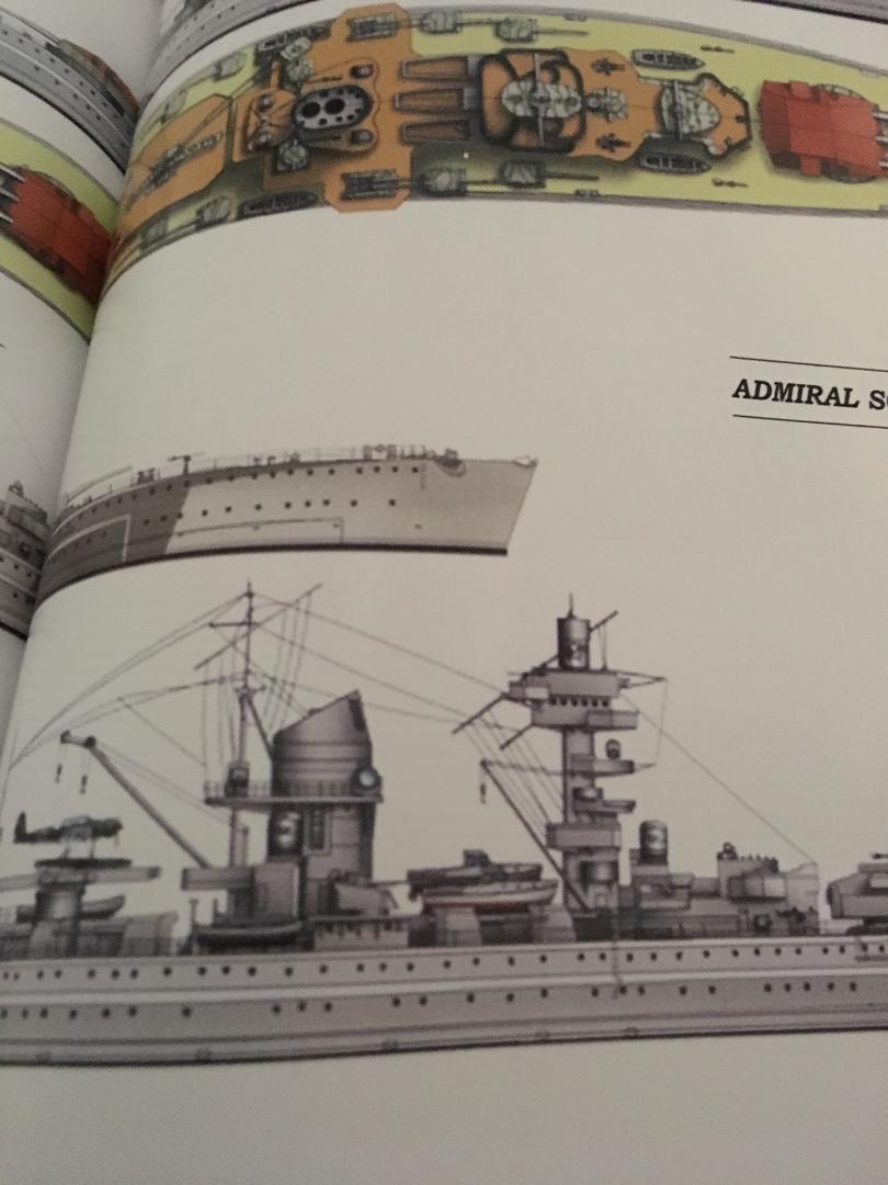

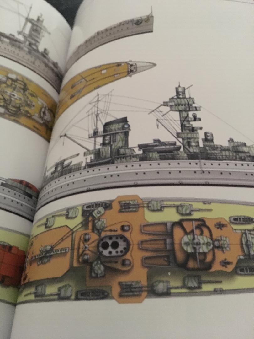

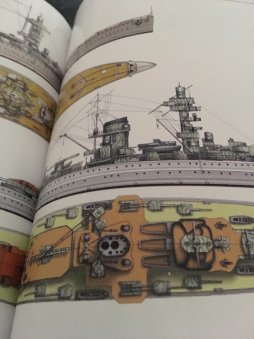

Ok, from "German Pocket Battleships" by Roger Chesneau.
Refit Summary: Admiral Scheer:
1935-1936 Catapult and aircraft handling crane added, aircraft embalked
1939 Wilhelmshaven Handling crane abrest funnel replaced
01 Feb - 31 Jul 1940 Wilhelmshaven Bows lengthened by 1.9 meters and remodeled to incorporate a raked stem, Handling crane renewed.

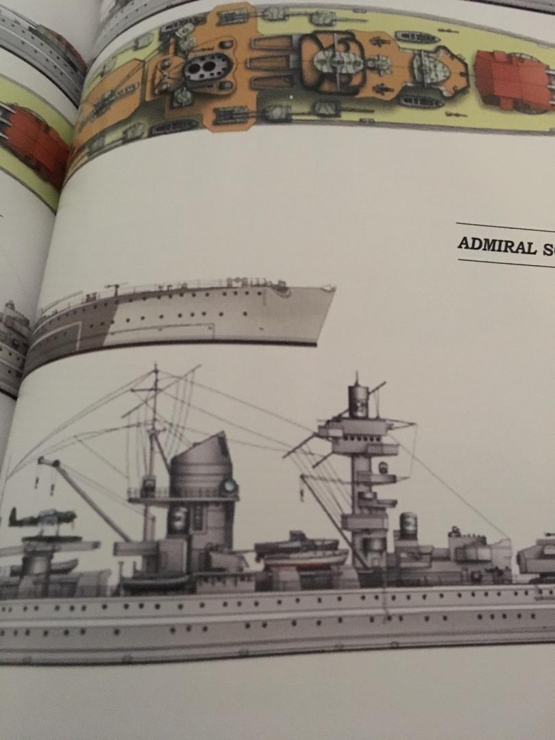

Looking at a color plate of her in 1940, she has only 1 crane port side, and a derrick for the ships boats, however, this is not supplied in the fujimi kit.

and found a good picture of the Scheer crane maybe using part of the Di Stefan Hipper crane and bashing the kit crane can work to set that issue

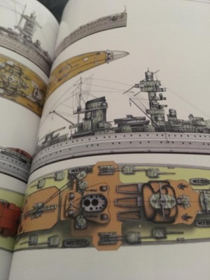

here's two of the color plates from Chesneau's book, note the boat boom/derrick

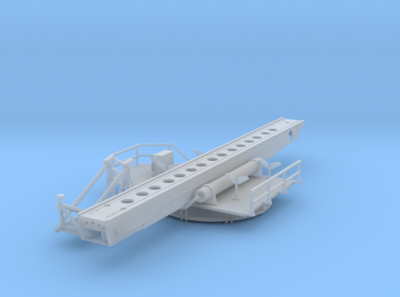

Thanks Miguel, I might also have to kit bash the catapult to look like this.
