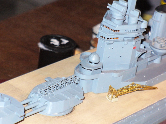

Just a single picture to show a little of the progress with my 1/350 scratch built Rodney.
I'm more and more amazed how badly documented her configuration on May 27th 1941 was (in my view her 'finest moment', when she pounded Bismarck into a blazing wreck), all I can do is just arguing and guessing what had been already installed or removed, and what was to be added later in her life.
The catapult is completely scratchbuilt from pictures, the aircraft crane was of almost the same type as installed on the Repulse, and I am going to use one from the Trumpeter kit's PE set with some small modifications and additions. In due course I will supply a complete list of the sources of the parts I used, but 90% or more is really built from scratch. The pom-poms you see are from Tamiya's KGV, I will certainlty replace these with better detailed parts later on.
People keep saying to save my time as a kit will surely arrive in due time. They might be right, and when that happens I will model her again in her spendid camo scheme, but this current model wil be in AP507B medium grey, showing all detail to good effect.

Looks great, Maarten!!
Of course, you do realize that the moment you finish it, either Trumpy or Dragon (or maybe even someone else) is going to release it as a kit! (At least, that is the way it seems to work.)

Hi Dick,
Yes, I do realise that. When that happens, I'l be in the prime position to spot all the errors in the new kit
Or otherwise, let's hope that the entrepeneur who's planning to produce such a kit reads this forum and contact me in the design phase, when corrections still can be made.

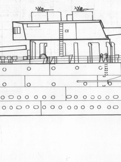

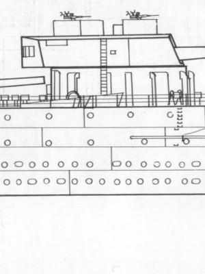

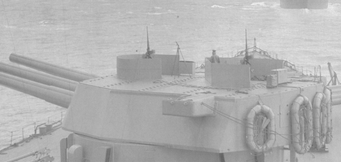

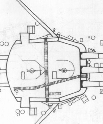

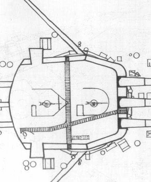

I'm thinking it's about time I built my Tamiya 1/700 Rodney and I just want to do a final check on the details before starting the model. The Tamiya kit looks to represent the ship in the early 30's but I want to model her as many have or do, in May 1941. So I'll list the modifications I know of and I ask that if anyone knows anything I've missed, please let me know.
So by 1941 Rodney had a catapult on X turret (with Walrus) and the associated crane on the Port side of the bridge. 3 8 barrel Pom Poms, 2 20mm Oerlikons on B turret and type 279 radar antennas atop the masts. She was painted in 507B grey.
I know of 2 bits of information I still need that my own resources can't answer - first of all, what was the colour of the steel decks and turret tops? Secondly, has anyone got a pic or diagram to show the 20 mm guns on B turret - I assume they would have been in some kind of 'tub' rather than just randomly stuck on the turret roof.

from a polish book EOW 014 - Brytyjskie pancerniki Nelson Rodney - rodney in 1940

Thanks for that Peppe. I should be able to fabricate something similar from plasticard strips.
Anyone else want to add something?

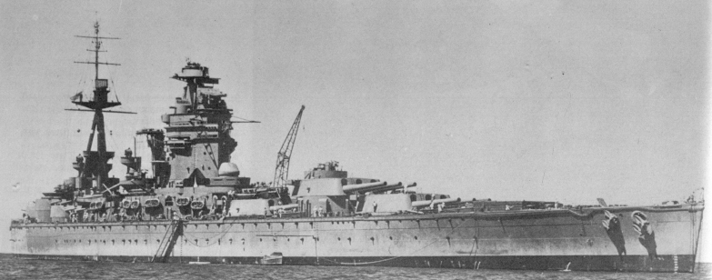

Here a picture showing both: the degaussing cable, and the cavity in the bridge. Unfortunately I can't load a larger version here. This picture can be found in Raven&Roberts Battleships of WW 2, page 270. On page 268 the cavity can be seen even better, on the well-known picture of a line of matelots scrubbing the deck.
Although the external degaussing coil was never mentioned in any book about the Rodney (at least I never found it anywhere, apart from the caption with the picture shown here), it must have been applied in December 1940, and removed in Spring 1942, when the camouflage paintwork was put on. I believe it was replaced with an internal coil then, similar to the King George V.

I think I've found that pic of the sailors scrubbing the deck. There is something tha looks like a round tub, similar to those that housed Pom-poms or Bofors guns. It's on the Starboard side, just forward of the first 4.7' gun, on the same deck level as the conning tower.

Right, Mike, that's the thing.
Funny that is was never used for any weapon though, that it was ony made on the starboard side and that it was only built on Rodney (not on Nelson). And it stayed with her for the rest of her life.

A couple of questions for you guys,
What colors were used for disruptive schemes..........
Nelson 1942.........
Rodney 1942............
Also, the bus shelter opening below bridge, stbd side on Rodney, was this ever plated over, or did she have it for her entire life?
Thanks Guys
